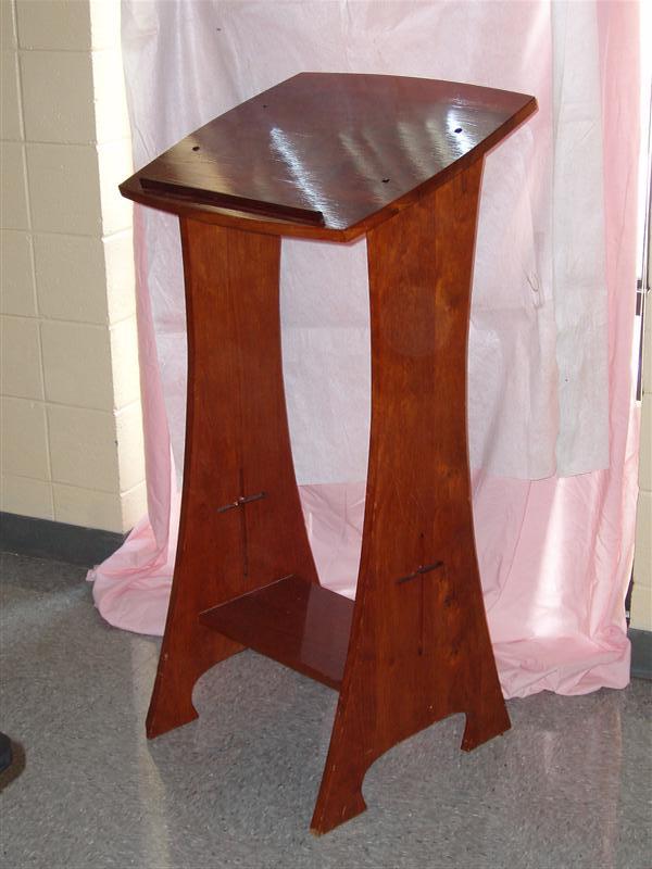

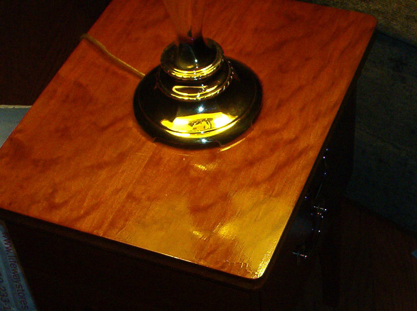

July 28, 20179 yr comment_118486 More tidbits. I saw recently in I think Flexners column in Popular Woodworking that the new Eco alcohol is better than the old denatured for shellac solvent. I picked up from Mickley on the old Wood forum that garnet shellac is good to even color out on cherry even when sapwood is present. I used to store in canning jars and due to the constant problem of getting lids off I switched to medicine bottles. Plastic such as 3 to 4 oz antihistamine bottles (advantage being a pharmacist) and the plastic tops do not stick. Ask at your pharmacy for through aways or as for RX oval. I have done a french polish on a few items, such as a side table and deco bookstand. It is a learning curve and sometime need to back off and start over. Report
