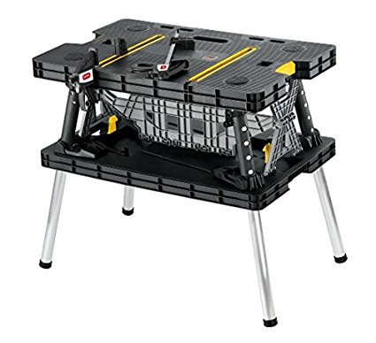

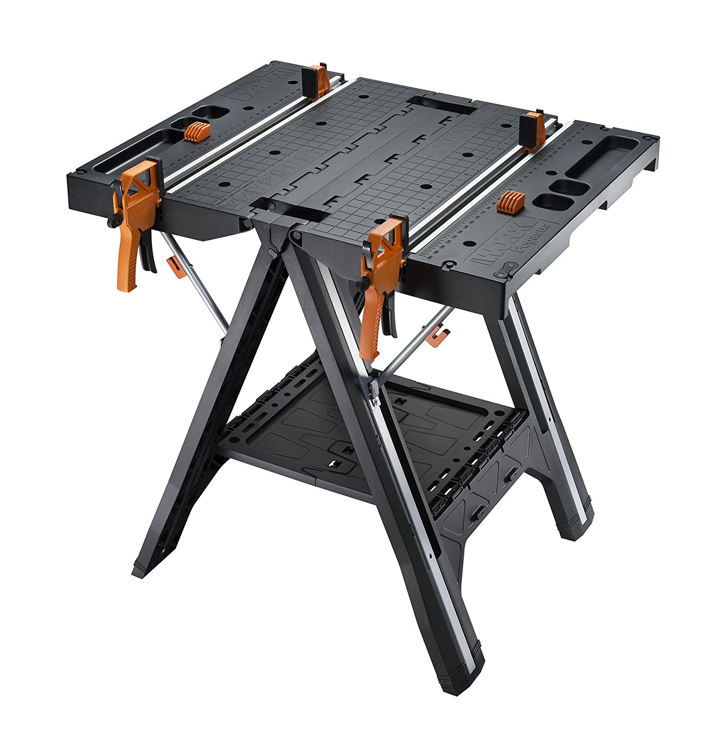

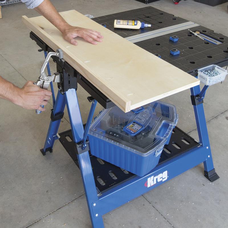

kmealy Posted July 18, 2017 Report Posted July 18, 2017 Kreg , Keter, and Worx have such offerings. A friend of mine bought the Keter a few years ago before the Kreg was available and he likes it. Then there's always the standby, WorkMate. p_toad 1 Quote

Joe Candrilli Posted July 18, 2017 Report Posted July 18, 2017 I had the Keter thing and killed it putting too much wood on it (OK in fairness it was WAY to much wood for most temp tables). I found a Vika table at Woodcraft. It doubles as a long work table and also as a type of short scaffolding. Also has the ability to plug in an extension cord with 3 outlets. Thought that feature was cool at first, but I have yet to need 3 things plugged in on a worktable at once (two yes, three not yet). it is sturdy and durable, but does not fold up much. It is still a 2x6 beast that has to be stored. Grandpadave52 and HARO50 2 Quote

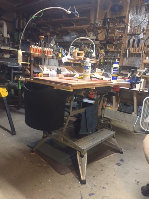

Ron Altier Posted July 18, 2017 Report Posted July 18, 2017 Years ago I picked up a heavy duty Work Mate at a garage sale for $25. It is really sturdy and folds for storage. . I then built a table top that clamps in the table vise. It can easily be removed to use the table vise or to put another size top on. Mine has become my permanent small projects table and I have it modified somewhat like a jewelers bench. It is still removable, if I want p_toad 1 Quote

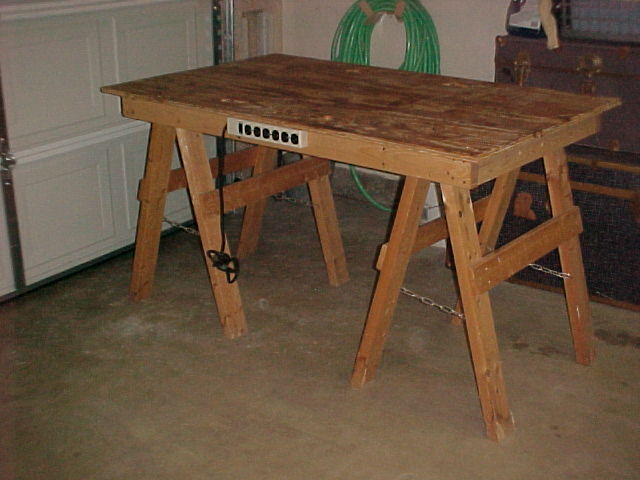

Popular Post Allen Worsham Posted July 18, 2017 Popular Post Report Posted July 18, 2017 Here is a photo of my first mobile workbench that I made back in the later 1990's. At that time we were living in a condo with a 2 car garage. I needed a work bench that I could tear down and hang on the wall when not in use and that was the same height at the top of my table saw to be used as a run out table. It was very simple to make using 2x lumber and some plywood and then added in a power strip to plug in tools. I also cut out 4 hand holds into the table top and routed the edges to make it easier to lift and carry. I was able to toss it into the back of the pick-up when I did off-site work. This was a very heavy-duty table and I got a lot of use out of it and passed it along to my bro-in-law who still has it today. The quality of the photo is not up to today's standards, but you get the idea. Stick486, HARO50, kmealy and 4 others 7 Quote

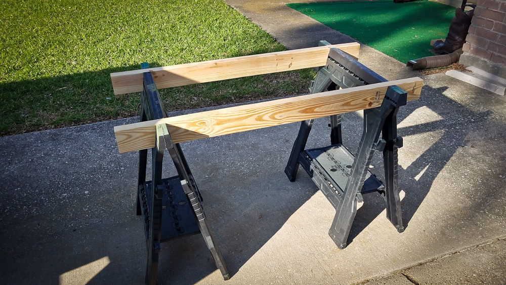

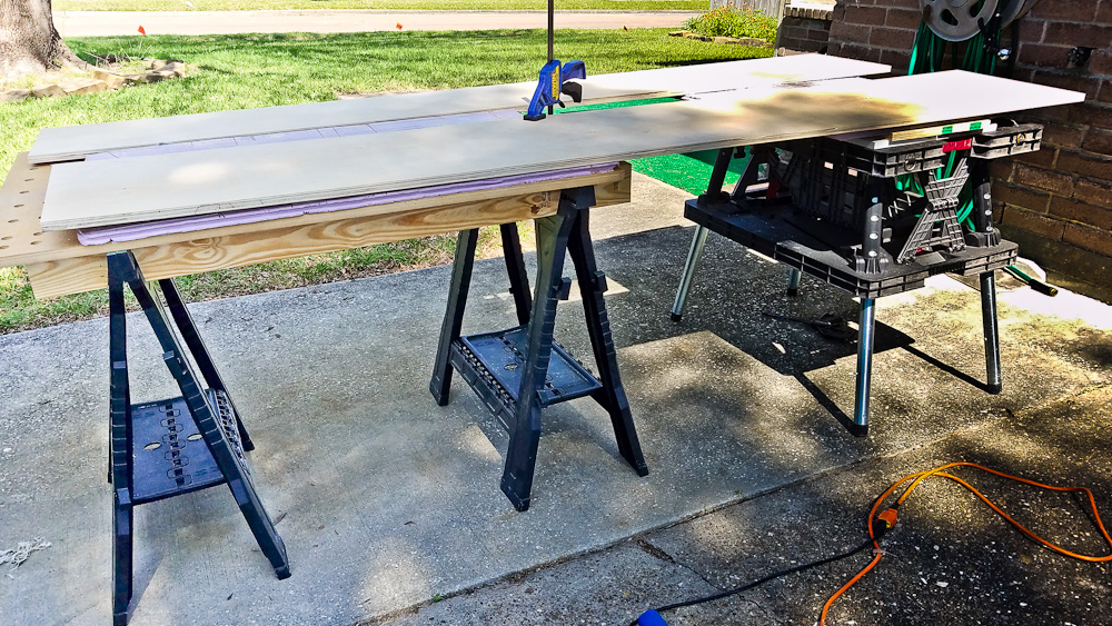

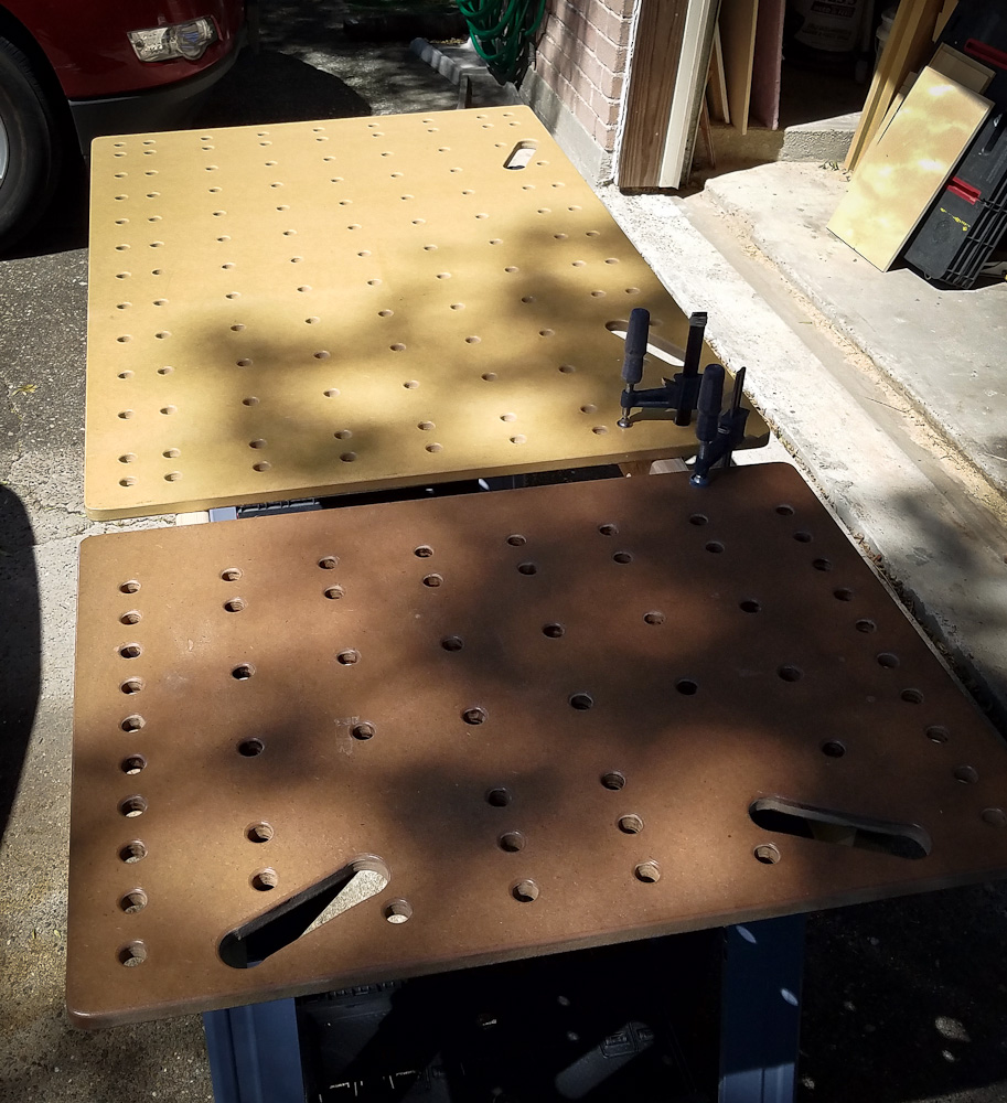

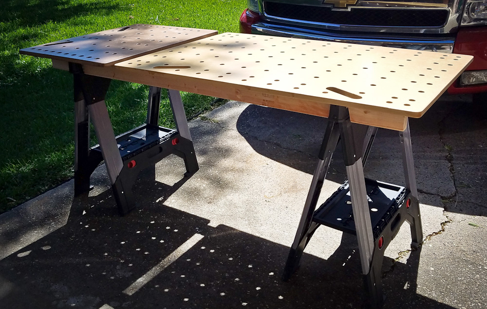

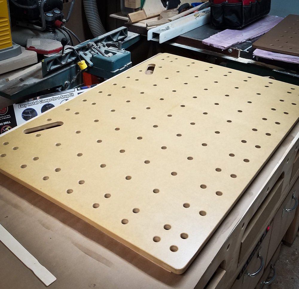

MT Stringer Posted July 19, 2017 Report Posted July 19, 2017 (edited) Pat, the work table doesn't have to be level, just flat. Right. I bought a solid core door at the Habitat ReStore once upon a time for $8.25 (discount Friday). I cut it down and made a work bench that got used and abused for four years. Many projects were built on that thing. But, it was heavy! I have a portable work station (and one of those Keter portable tables). My work table is a pair of saw horses that have adjustable height legs. I also have some 3/4 mdf that a fellow carved 3/4 inch dog holes in for me. I have since made my own to give me some additional work space. Here are a couple of pics. It works well, and I plan to use it tomorrow to break down 4 sheets of prefinished birch for some cabinets I am building. Edited July 19, 2017 by MT Stringer Grandpadave52 and HARO50 2 Quote

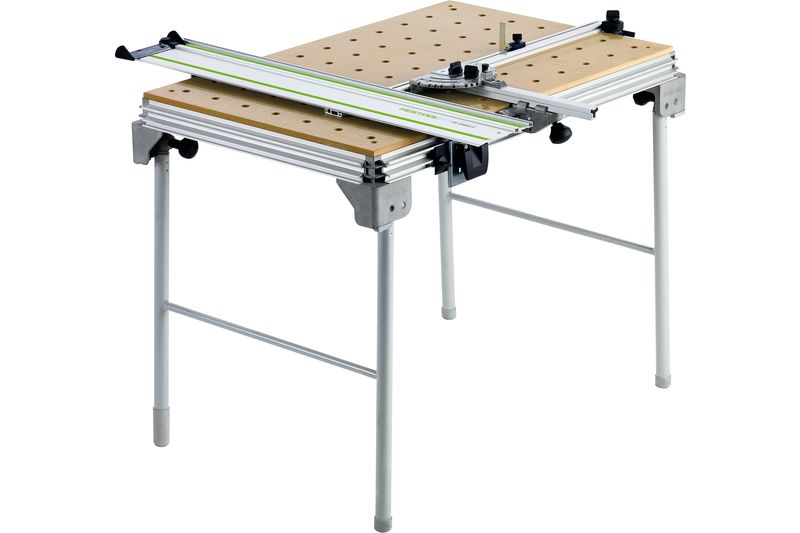

kmealy Posted July 19, 2017 Report Posted July 19, 2017 Gee, you guys must be cheap frugal. No one's mentioned this, just $685. Might need two, though. Grandpadave52 and HARO50 2 Quote
