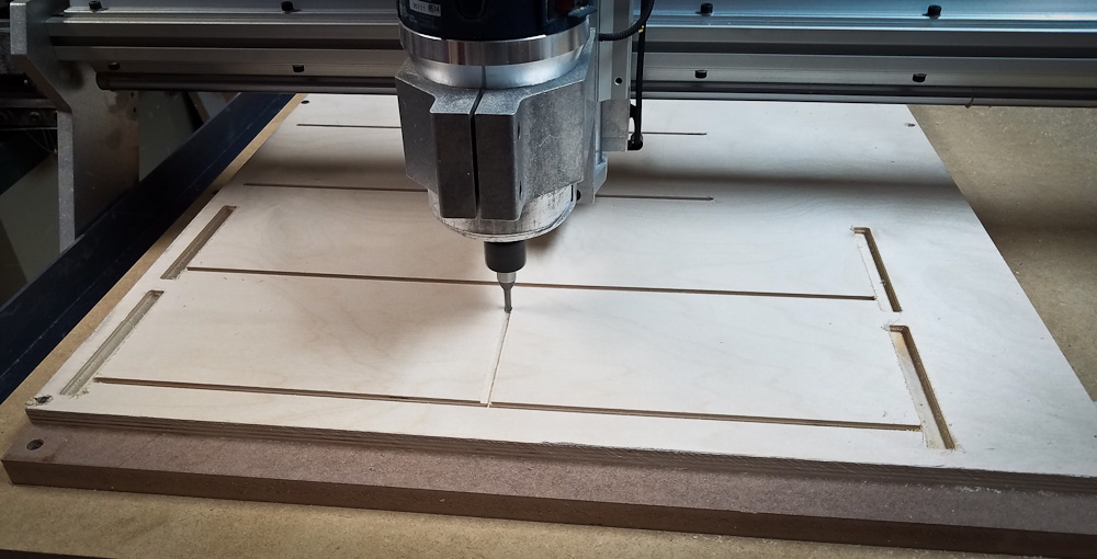

Fred. After making a test cut or two, I made some bench angles that fit the spoil board on the CNC and also fit on my work bench. Always nice to have a right angle to position a work piece against.

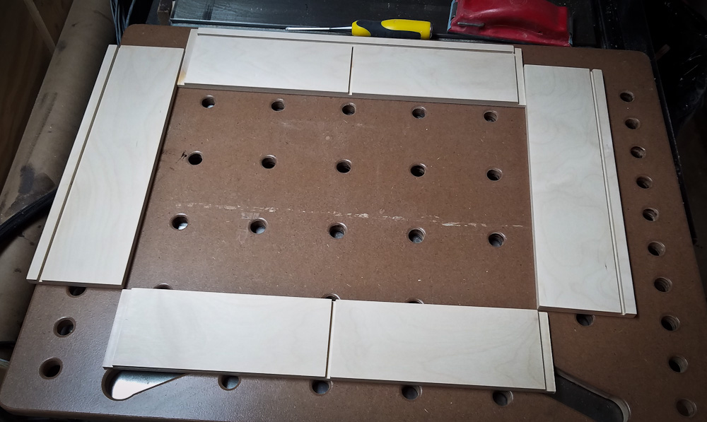

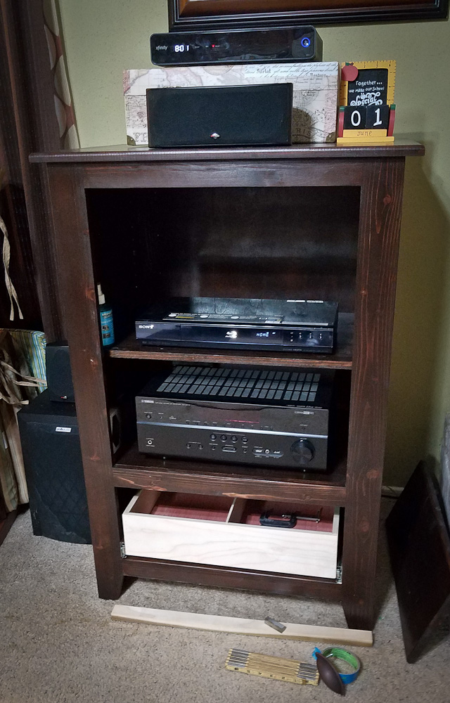

Now to answer your question. I cut out the drawer pieces for the entertainment center I was building. The front and back piece needed to be 21 15/16 wide and that is exactly what I got. After assembling the drawer and attaching the hardware, it slid in place with no effort. I like that a lot.

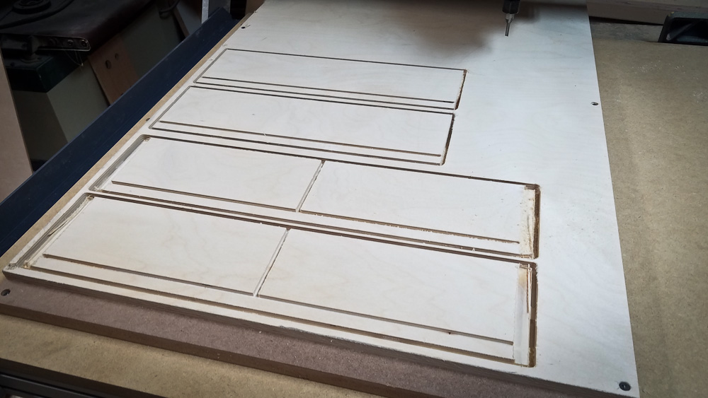

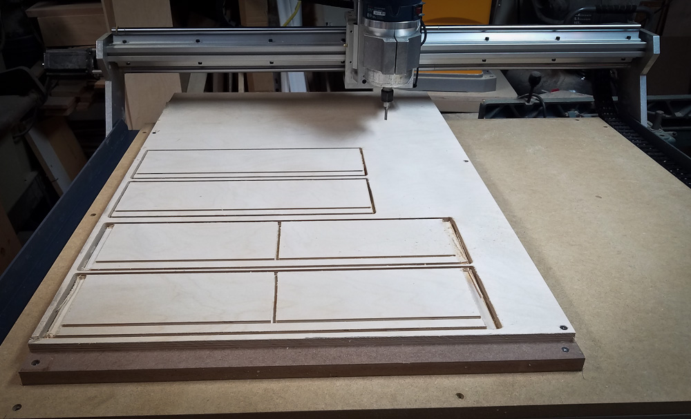

Here are a some of pictures of the machine in action cutting out the  drawer parts. I usually use my table saw for drawer parts but  I just couldn't resist.

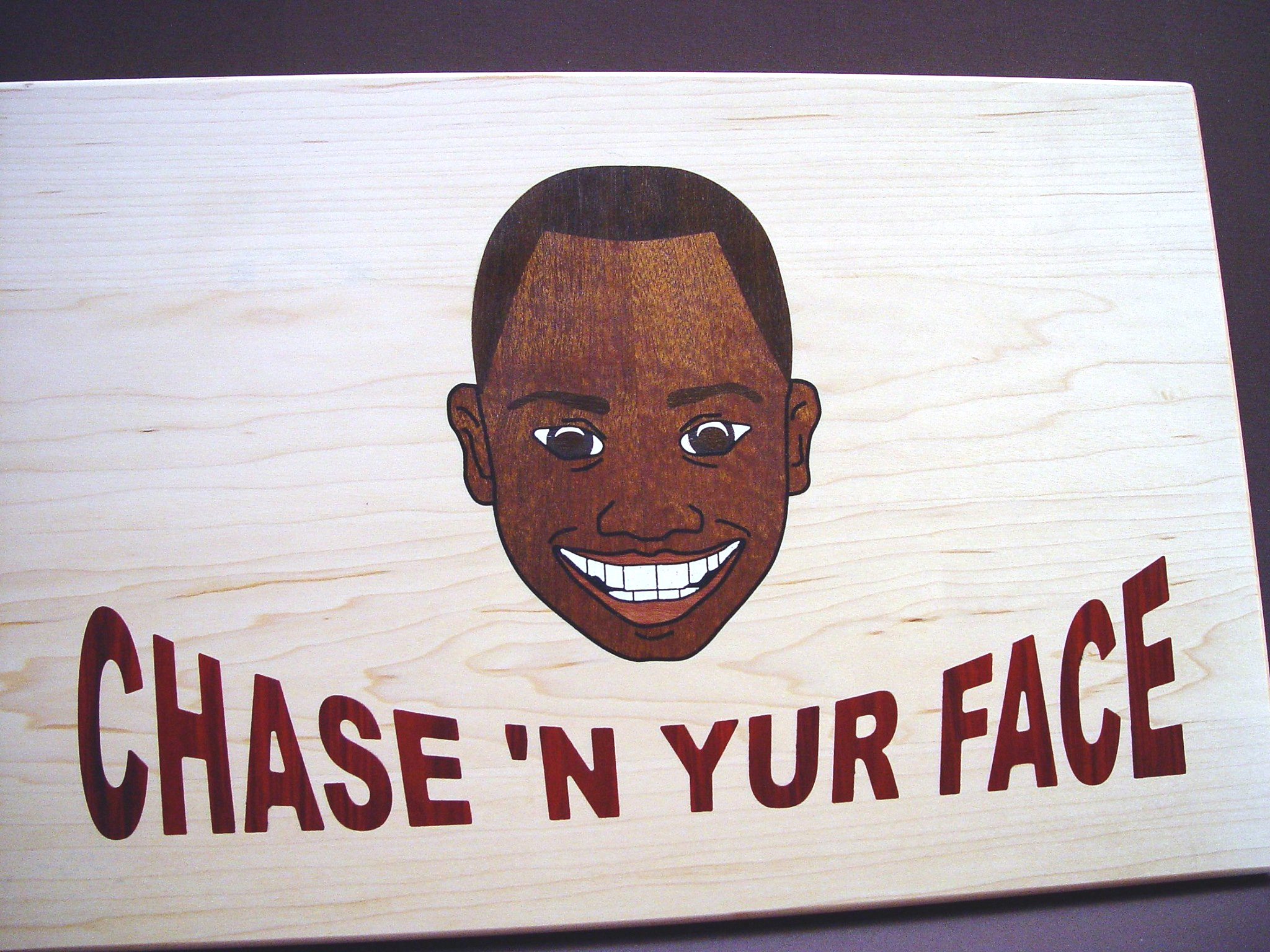

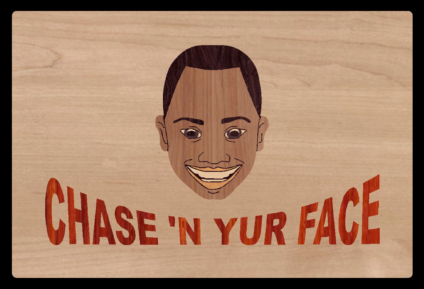

Here is  an inlay I did in a cutting board.  My customer ask if I could do it and I've yet found something I couldn't do, got to try or you never know where you can do it or not.  The first picture is the logo they sent me in an email.  The second picture is out of Aspire design program.  And the third picture is the actual cutting board.
