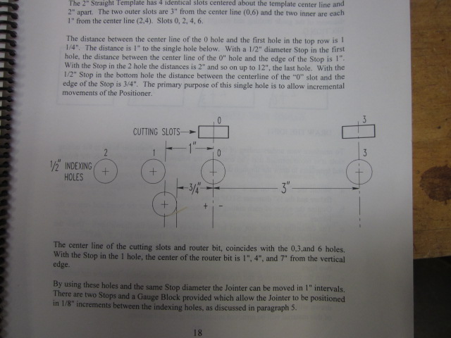

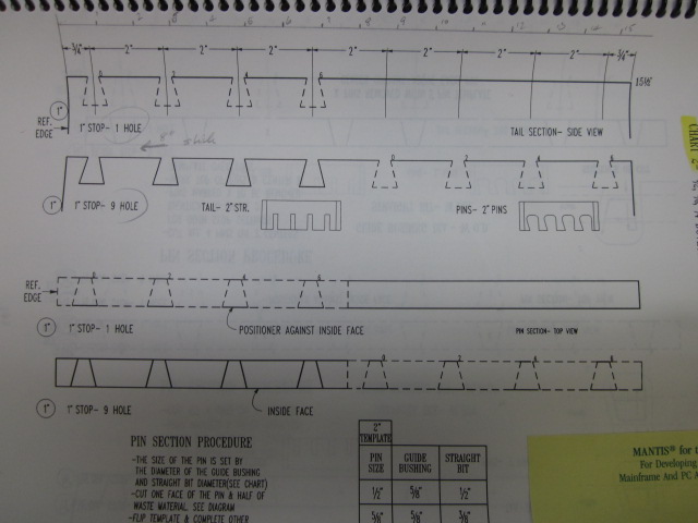

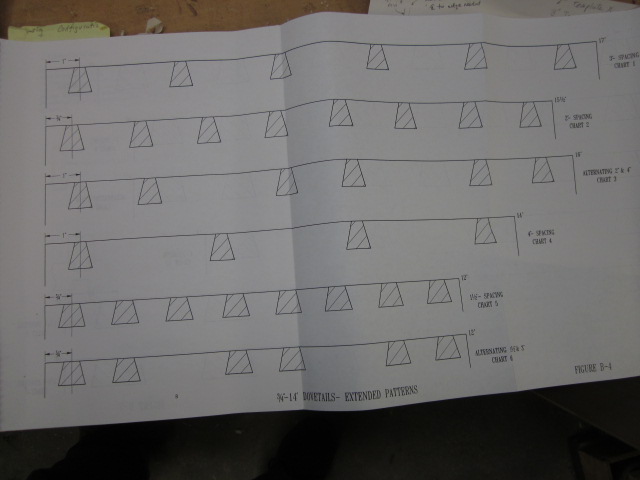

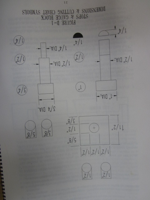

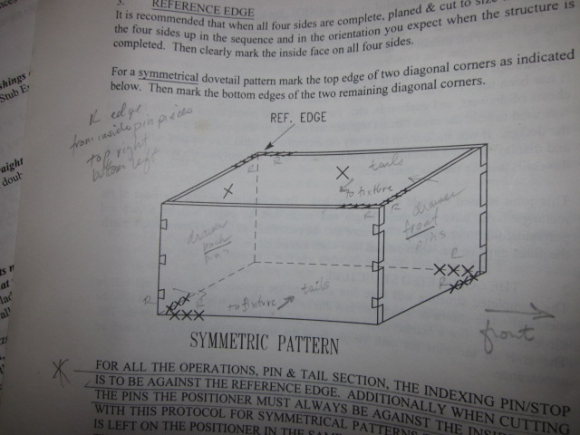

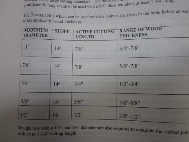

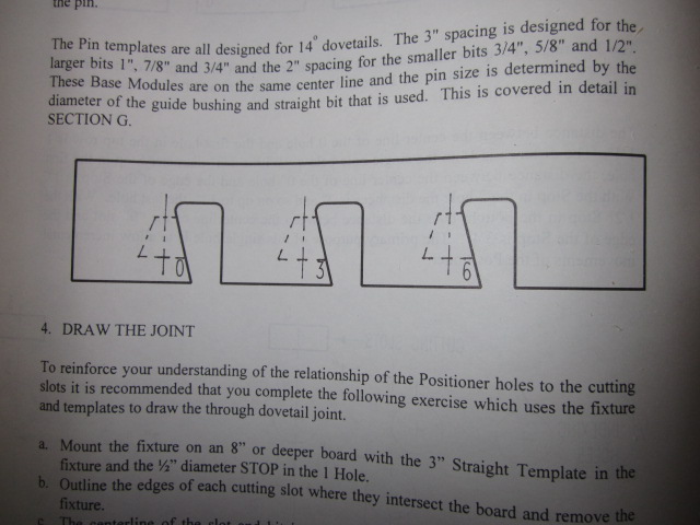

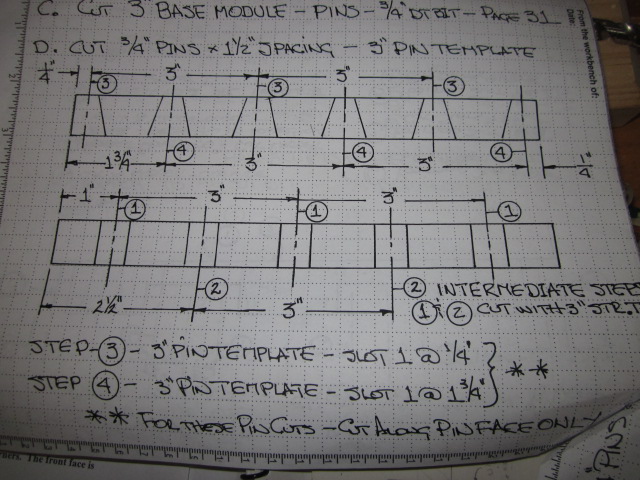

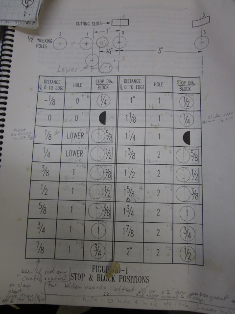

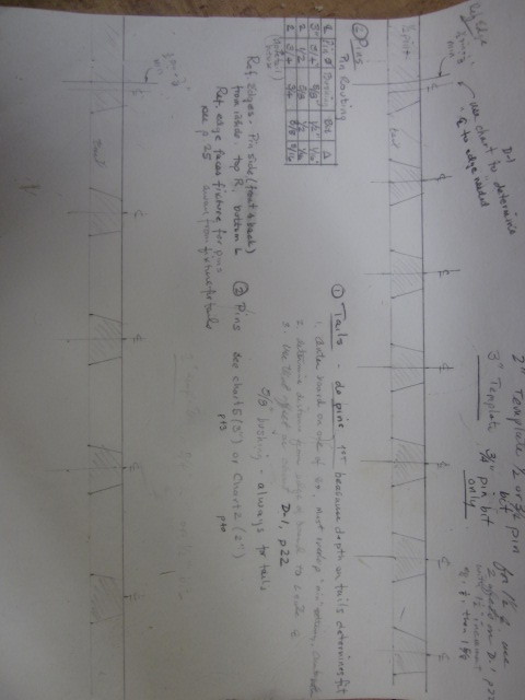

June 22, 20179 yr Popular Post comment_113898 Trying to get a drawer box together today. My dovetail jig is so frustratingly complex, I'm ready to toss it. Finally figured it out with the help of the manual, class notes, personal notes based on the three days it took me to figure it out. So I decided, what the heck, I should just brush off and hand cut the dovetails. Figured out the dimensions and got the wood cut. Got all 4 corners done (last one went a lot faster and better than the first). Then I realized I did not allow enough height allowance. No problem, trim 1/8" off the top and bottom of each side. D'oh, er, just sawed off the orientation marks. Ok, there's only 2n ways they can go. Sat down and got that recalculated. Glued and squared them up. Then realized they were going to be too wide as I'd measured the wrong clearance. Oh well, I got some hand-cutting practice in. Time to hang up the apron for the day. Edited December 5, 20178 yr by Ron Dudelston tags added Report

June 23, 20179 yr comment_113945 1 hour ago, kmealy said: https://www.google.com/patents/US5318082 What!!!!!! No pictures? Report

June 23, 20179 yr Author comment_114026 12 hours ago, schnewj said: What!!!!!! No pictures? If you click on the images, you'll see the various parts. It's out of production now, so no web site or anything. Report

July 1, 20179 yr Author comment_115148 Well, had to re-do some of the dovetails because I'd used the wrong bit. One spacing can use two different bits, the other only one. I don't know how I messed, up, I have a 120+ page manual, class notes, hand-outs, and my own notes. I'm doing 4 3/4" high drawers and it takes 4 different settings to do one end's tails. Report
