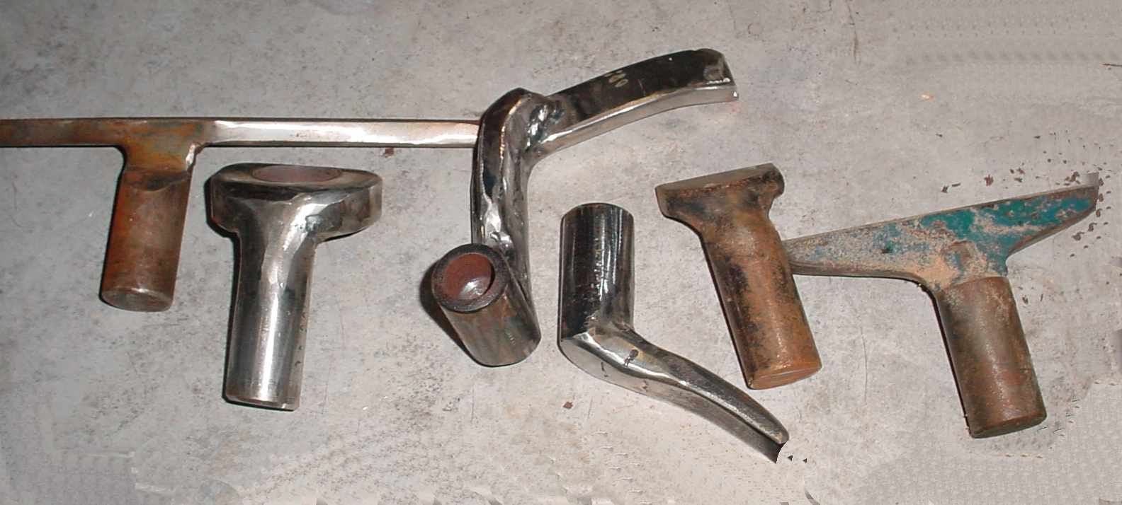

April 18, 20179 yr comment_106691 I also have a modular type tool rest- post and top can be interchanged- similar to these- http://bestwoodtools.stores.yahoo.net/tmotoresy.html Can't remember where mine came from. If you know a welder (or have a local vocational school) you can get custom rests fabricated for a reasonable price. The kids at our local school made me several styles for material costs and doughnuts. Report
