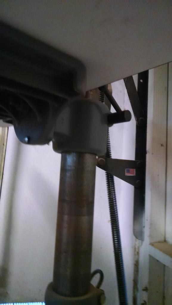

April 17, 20179 yr comment_106513 Yes,I made a platform box to set on the base, then set the scissor jack on that ,I had to make up a wooden plate to flatten out the bottom of the upper table because of the cast iron ribs etc.for the jack to lift on. I also found that the jack has to be mounted tight against the column,sideways, as it binds the table when raising and lowering, and I had to apply hand pressure down on the front lip of the table when raising and up on the front lip when lowering. To eliminate the binding on your table you might consider attaching a cleat under your existing table to cantilever a small platform to the rear of your table to add some weights to counter balance the weight of the table. I put a hand wheel crank on the jack to raise and lower it. Hope this helps. The electric trailer hitch jack is taller and I don't have as much height adjustment as i would like. I use the battery to counter balance the table. Herb Report

April 17, 20179 yr comment_106516 It is a vintage WWII Atlas. I love it, it has a 4 1/2" quill travel. I did a thread on this forum awhile back on refurbishing it. If you use a scissor Jack, you might be able to rig up an old drill motor to raise and lower the jack. Just saying. Herb Edited April 17, 20179 yr by Dadio Report

May 7, 20179 yr comment_108706 @John Morris...late getting to this party but your request challenged me because both my late 60's Craftsman and early 40's Atlas drill presses both need something too. @Dadio's idea and creation is awesome but me being the scrapper and tightwad I am, kept me looking and thinking...just hadn't followed through on anything yet...you motivated me to do a little looking so I found these two ideas worth considering. I really like the 2nd link idea and may consider some variation of that as my first option. Craftsman You-tube Counter Balance System Youtube Drill Press Table Height Adjustment Report
