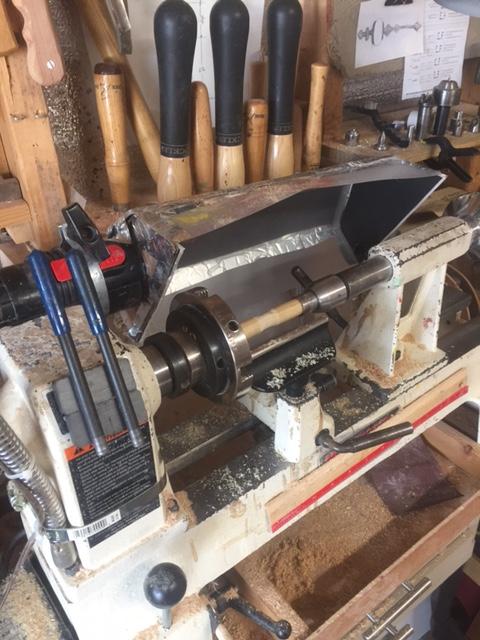

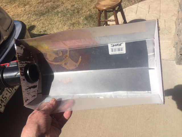

March 17, 20179 yr comment_102711 I have a Jet mini and wanted to use a vac to help with the saw dust problem. However I have very limited space. I got some cutting board plastic and some quarter inch styrofoam from the dollar store. I used some left over tape from a furnace duct job. The kind that has real aluminum. I sized it for my limited area and put in a support with an adjusting clamp. It turned out OK and I am anxious to start a new projedt. Report
March 17, 20179 yr Author comment_102734 I just tried it out and it works fine, however I have to make a couple revisions......add some velcro and make a divider so it will reduce the size when I turn smaller pieces, etc Report
March 17, 20179 yr comment_102738 13 minutes ago, Ron Altier said: I just tried it out and it works fine, however I have to make a couple revisions.... Can't remember the last time I did something and it was just right the first time Looks like you're on the right track at least. Steve Report
March 17, 20179 yr comment_102762 Very innovative Ron as well as budget minded...thanks for sharing your idea. Report
