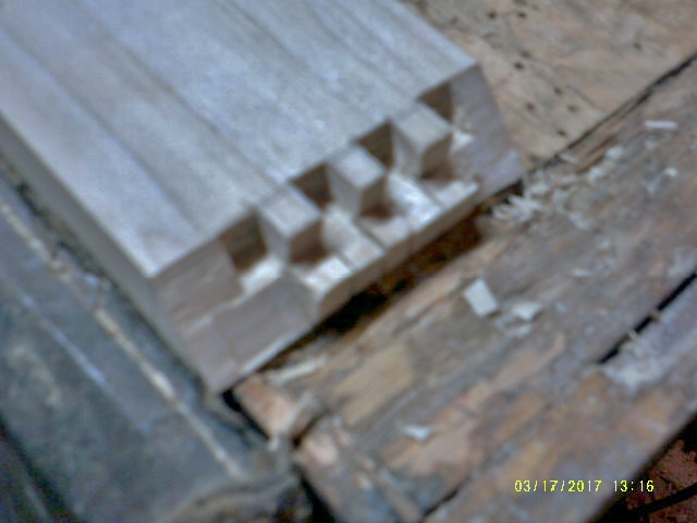

Well, trying something a bit different.     Kind of new at this type of joinery.....
I used the 358 mitre box to cut a couple lengths of Poplar.    Squared a line all around....did a bit of saw work....
After I had laid out a few finger joints..  That mitre line?
It gets worse from here......
Version No.1...didn't quite pan out.    Got worse trying to cut the matching part of the joint...
I trimmed back the fingers a bit on Version #2, BUT..I cut the wrong sections out......fingers were in the wrong spot....
Tossed that wrong item aside, got it's replacement and cut it all over again.   This time, I made sure I was removing the waste....LOT of chisel work going on.....
Finally got to where a test fit could be done.   Looks just like a mitre joint, right?
Wonder what all them squiggles are for......
Clear as river mud?   Have a bit ore trimming to do, and then...maybe...do another three corners?     Maybe I might get good at this sort of thing?
BTW: First time I ever tried something like this.....will be looking for a bit easier way as I go along....stay tuned

That mis-cut piece?    Re-used it to lay out for a second corner..
First one is on top of the second corner.  Started with a clean cut end...
I also used this same saw for a few other cuts.   This one was to give me another 12" long side.   I used the recycled end to lay out the fingers
Thought about leaving the board flat on the bench, but..
Found out it was easier to saw the joint like this.
Handsaw to cut the bevel ends, the mitre box to cut the crosscut across the fingers.   The hardest part was the beveled cut to remove right in front of the fingers,,,
As chopping out the sockets was easy to do....finally set the part up on it's edge, and pared down with a sharp chisel.    Either driven with a mallet ( Lew's?) or with my chin.   Test fits, lots of them
Until all the gaposis is gone.    Hardest part was still getting a smooth bevel, without a hump in it's middle.   And, not pare my fingers too....
Two done, two more corners to do.  And a few chisels that need sharpened back up...Maybe I can go ahead and make a box out of this mess?     Depends on how many Brain Farts this will take....
Stay tuned?

Ok, I made a new handle for a rasp I had..
Old lathe chisel handle ( Harbor Freight..) cut down, sanded to shape, drilled and the rasp installed....Those markings?
Are one of a set of layout markings.   Crosscut line....is where the ends of the fingers will be..
Ugly, ain't it?    Square sockets to house the fingers from the next piece.      Chisels needed stropped before too much got chopped and pared.   Lots of test fits, too..
getting there....Finally got all the corners close enough for a dry run..
Other than the one end clamped to the bench, everything else is just sitting there.....still needs a little fine tuning at the mitres..
But, for the first time around doing this sort of thing....beginner's luck?     I am getting better as I do each corner, learning as I go along.
Might dig out the old Stanley (Not Colt) 45 and make a box out of this mess?  Stay tuned.....
