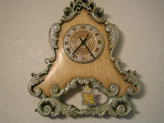

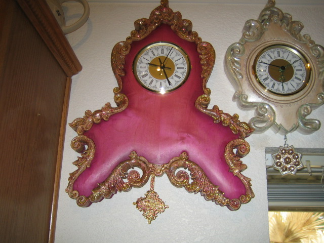

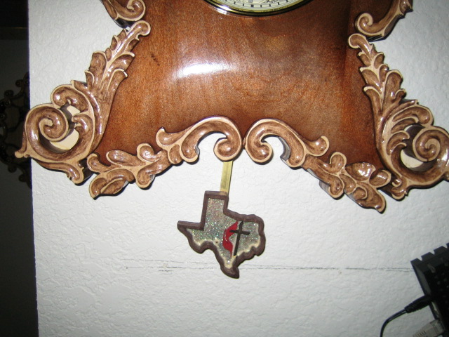

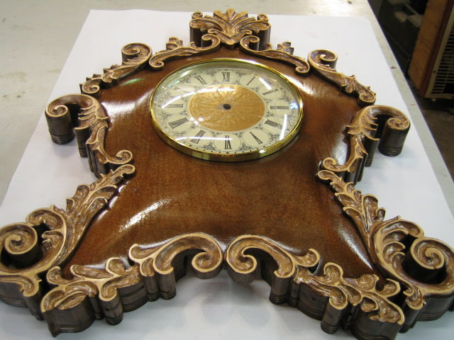

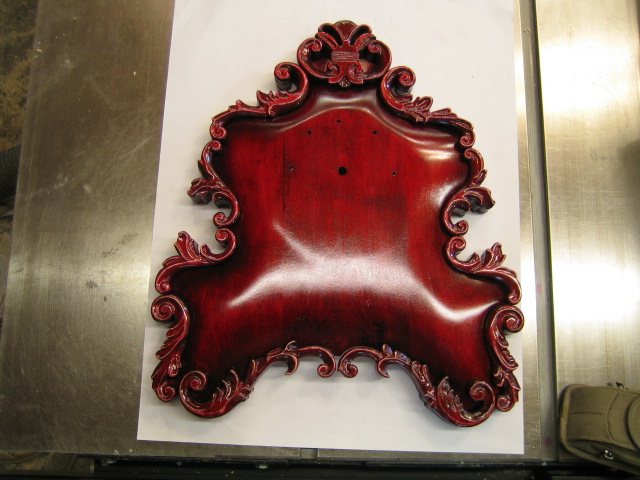

July 15, 20179 yr Author comment_116669 Doc Hamm I have made quite a few of this type and if you look close most of the carving pieces are the same or very close. Sometimes I extend or shorten some pieces to fit things in the correct space...Notice I don't carve these pieces on the sides for the scroll saw cuts the excess away so I just leave the edges as they are. Years ago I started buying cheap pressed wood carving pieces then trace around them and scroll saw them using good solid hardwood. And using thick wood a person can gets way more detail without having to carve the sides of a piece. Since these clocks hang on the wall the sides are not noticed like a mantle clock. So yes when I make a mantle clock I like to do something to the sides of each piece. This is about a two year experience into to carving. I finally told myself if someone else can do this, I can too but at my age I decided on using only power tools, no hammers and chisels, never.. Not too many carving pieces are ever shown here and thats the reason I more or less challenge folks to try something like these I make... Trade secrets, hey, I believe guys on this site is simply too lazy to even try carving, so giving away my trade secrets like was mentioned, ha. I did have a furniture repair refinish shop hundreds of years ago so than end of these carvings things I show I am just doing things with stain and lacquer I didn't have time to do when I was putting food on the table..... and not worrying about keeping the customer happy. By the way most all these are around 18" tall. Thats about the limit my scroll saw will handle. Report
