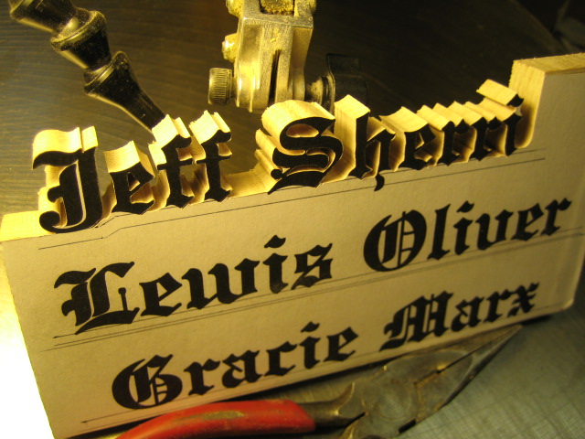

Okay so everything I make is not tied to the french but some things I like to make comes free from microsoft. All these letters for the names are free.
 This guy said I want to by that clock for his wife's Christmas some time ago. Well I actually made this one for my wife but if you can wait a month or so I will see if I can make you one like it only bigger and better. Boy, that was some bold and wild words.
I even added June's name to the tall one which he like better especially since it was bigger than the other , but so did I. I had to tape two pieces of graph paper together but here I learned a lot sitting there looking at the one I had already made and try to improve on some of the lines I wasn't exactly happy about while connecting the lines on the first one. That's why they make pencils and erasers and believe me I was watching the the lines that came with the paper kinda disappear as I drew....I will suggest one other thing that really helped draw these clocks,,,,,,, I ordered lots and lots of pairs of carvings I could find anywhere to buy.... and before I started putting my lines on the paper I would lay pairs of carvings out then try  to make my lines blend in with the carvings. And the tall clock is a good example of the form of the clock matching the carvings..
  If a person does use store bought carvings, I like to add about 1/2" extra to the thickness. Glue wood on the back then use the scroll saw and cut out the hangovers. I usually buy the larger carvings then cut them down for the areas they will be used on.
   Its raining and I need to spray my horsey so the reason for these hopefully helpful things I learned a little at a time...
Oh and Harry Brink,,,,, When I am cutting out letters to be free standing like the ones below, I only go in the white area with the blade and leave all the black. And  to make it a lot easier to glue the letters down, I leave them all attached to each other..... 58a33b6a9a325_plaqueforkids2.jpg.367b14efc2e915c41ce73715838ce432.jpg
   You have to draw this out under the name before you get to the scroll saw. These are store bought carvings I think came from Hobby Lobby. Here is where the French Curved set came in handy again. The letters came off of Microsoft.
