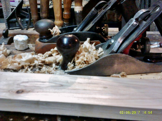

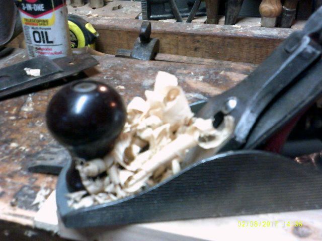

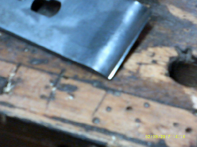

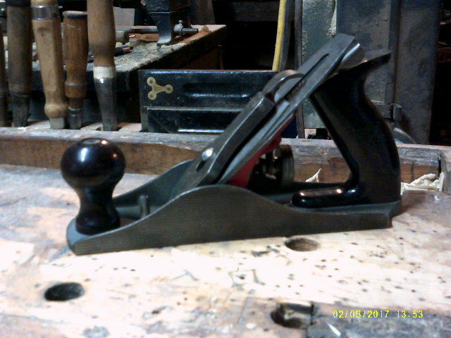

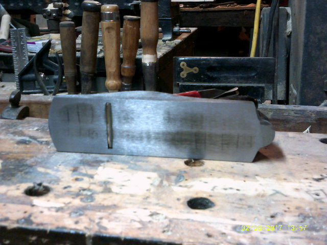

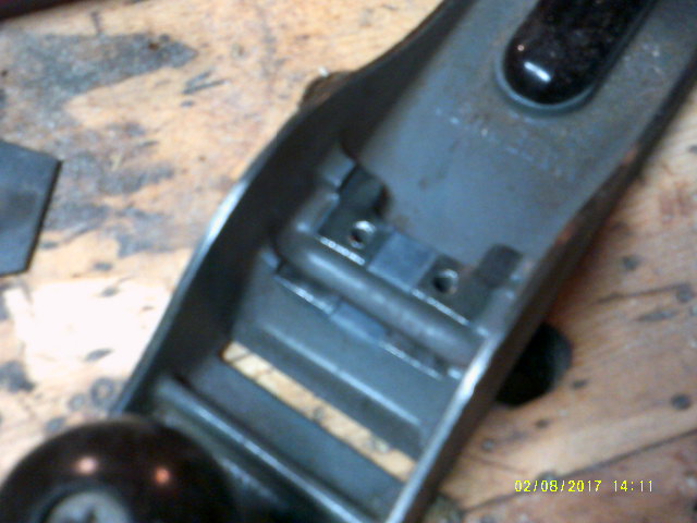

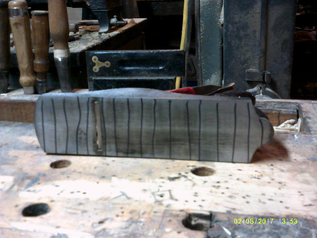

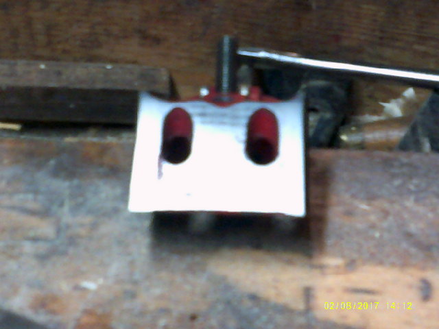

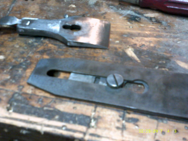

February 8, 20179 yr Popular Post comment_96676 Did a bit of trading last weekend....a rehabbed plane went out the door, and a "Plane-shaped" Object was left behind..... Needed a new lever cap bolt, old one was MIA. None of my spares would fit.....gave up, got out a tap, and cut new threads, to match a new bolt. Didn't like the cheap, painted lever cap, anyway. Logo was a red-orange Craftsman in the gray painted lever cap....tossed it aside, as I had a better lever cap in the spares box.. Iron was a bit flimsy, would bend just looking at it....Had an old OEM 2" iron from Home Despot, back when they sold iron for Buck Bothers planes. irons were good, planes were junk.. And, at least it doesn't bend on it's own. Shined up the lever cap, too. Cleaned the seat where the frog sat... Frog's seat was covered in paint. Used a wire cup in the drill press to polish it down flat. Then the beltsander to flatten the bottom of the frog.. It was a bit out of shape, now it is flat, and sits on the seats without rocking around.... Which leaves the sole of this "Thing"... Black Sharpie to mark the sole up.. I left the plane assembled, with the iron drawn back up into the plane. Set up the big beltsander with a new 80 grit belt. Ran it for a while clamped upside down in the leg vise.. Quite a few low spots left? Got ticked off a bit, clamped the plane upside down in the end vise, and ran the sander that way...and a large file...finally started to look a little better.. Starting to look like a plane? Let's see IF it will work like one.. Not too hateful? Had the chipbreaker set a bit close.. Now I just need to sharpen the iron up to standards.....was going good down in the shop, even rehabbed a second plane... the plane behind the old Craftsman is an Ohio Tool Co. 0-35 smoother. I finally found a chipbreaker set up for these "Trans" planes, just needed to be slimmed down a bit to fit in the plane. been a nice day IN the shop...outside? Not so nice. And, it is still coming down...oh well. Report
