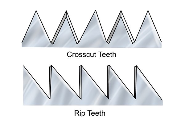

Tooth set and spacing.
+1 for Gene this morning,
Cal
design, grind, set and tooth count...

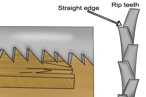

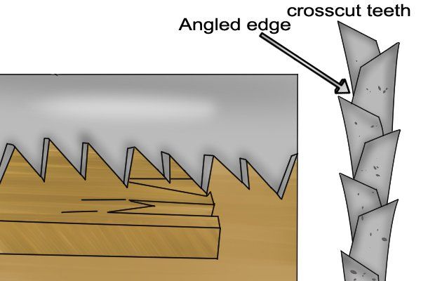

Both crosscut and rip teeth are ‘set’ (bent away from the blade) but crosscut teeth are angled on their inside edge, whereas rip teeth aren’t. This sharp angled edge means that crosscut teeth can slice through material like a series of little knives.
Crosscut teeth are designed for cutting across the grain of wood. This is generally considered a more difficult task, so crosscut teeth are ideal for it.
Rip teeth do not have an angled edge, which means they work more like little chisels, scraping the wood away rather than slicing through it.
Rip teeth are designed for cutting along or with the grain. This is generally considered an easier task, so rip teeth are ideal.
a rip saw having 5½ points to the inch, which will work rapidly and with ease in pine and other soft woods. If mahogany, cherry, or other hard wood is to be ripped, a six-point saw should be used.
A crosscut saw for ordinary work should have five or six points to the inch; but for fine work ten or twelve points would be better, especially for dry woods, either soft or hard.
