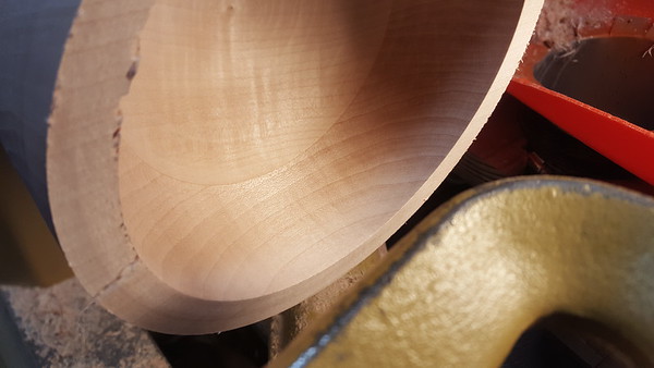

I was going  back and forth over scrapers.   I thought maybe I really liked a Glenn Lucas negative rake scraper.  Then I saw a Kelton tool.  It's got a little pivot.  I had a Sorby scraper blade. so I made a Kelton  type  drop edge tool
here it is going slowly
The Kelton model is built with a  7/8" bar the milled flats on the Kelton model are superfluous I think. But the heavier bar is helpful and I plan on upgrading to a 1" bar.
I can say that if you were on the fence about the Kelton unit that it is probably worth the money because the design works
Here's the  unsanded Maple surface it leaves behind.

That looks pretty good - great job!
Never heard of the Kelton.  Looks good Cliff.  Thanks for sharing.

You need to raise the scraper about a half inch so that you aren't scraping below center.  That rough grinding sound is the scraper digging into end grain because of self feeding when the scraper is below center.  It also looks like the tool is being used with too much pressure.  The scraper is primarily for taking feather light clean-up cuts before final sanding.
thanks for that.
