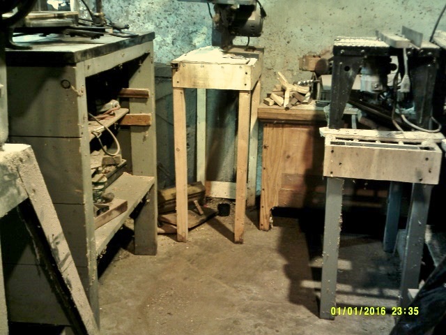

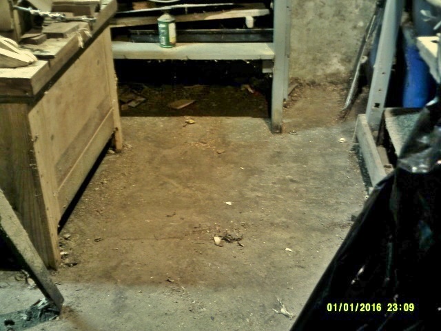

Crowded spot.   I cleaned the floor where these were, and got things ready to move...

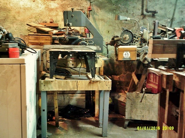

Getting better.   The black thing to the lower right, is the trash bag.   I had to pull the tool chest out, and slide it towards the trash bag,  so the bench could take the place of the chest.  Chest was headed to the wall..

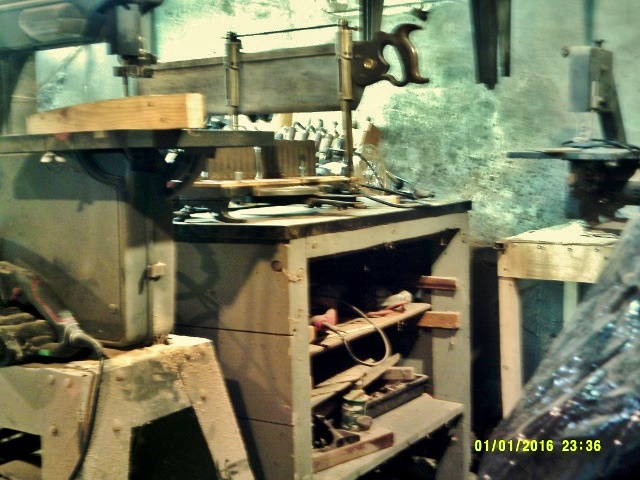

Small bandsaw inbetween.   Router table is now beside the lathe.  The bench is for the BIG Mitre Box..

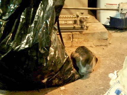

Backed up to the back of the workbench.   bad when you need a rake to clean a floor....even the broom is worn out.  Shop Cat tried to help out, by guarding the trash bag..

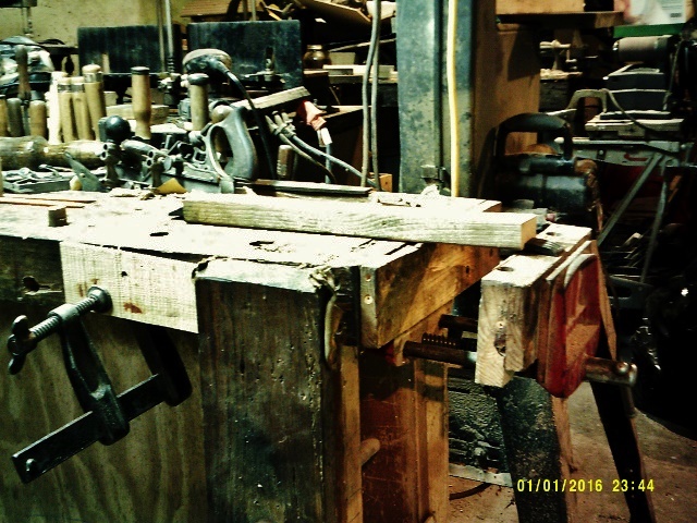

Soo, now I have room to work back there, I can even turn around!  Maybe I can get back to do some woodworking?

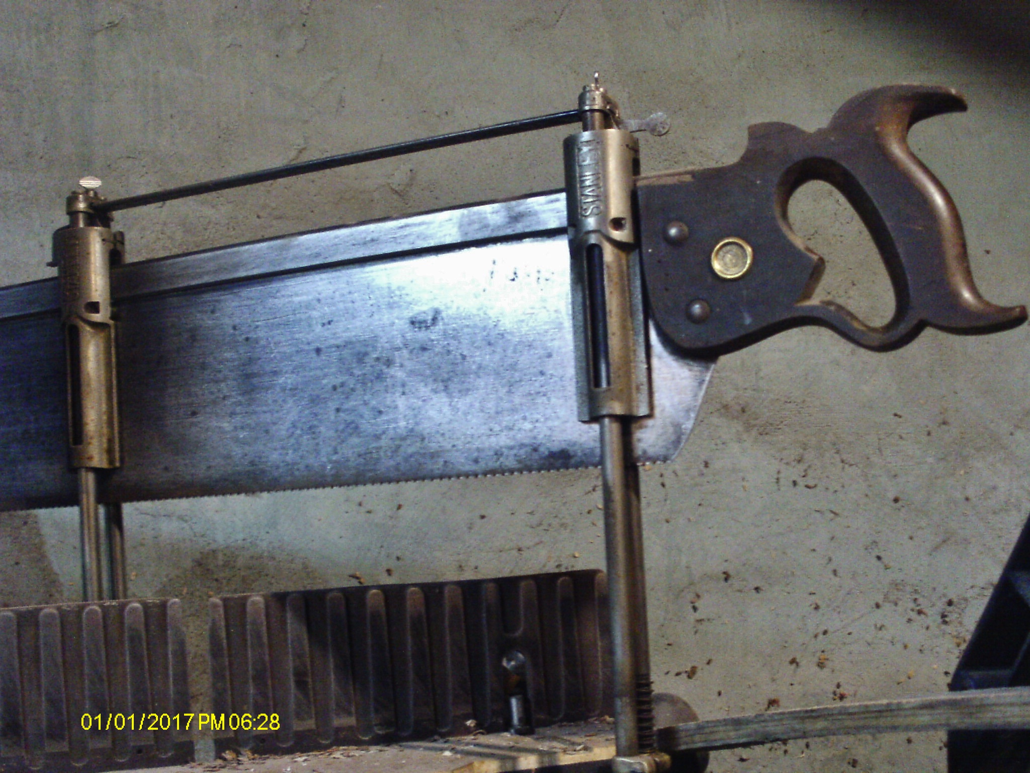

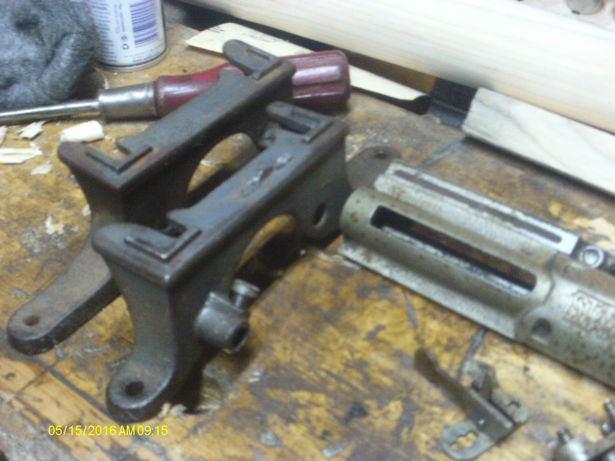

Can we get more detailed pictures of the miter saw?  I inherited one. One of the legs was broken so I am getting some new ones cast in bronze (all the guy had). I see yours appears to have some kind of bar above the saw. Mine has some kind of attachment up there but but I never knew what it was for.

I will need your help setting up my miter saw if you make it to Columbus....
As for that bar acroos the top?   I simply bought some flat bar stock at Lowes.
Needs to fit this slot at the top.   I also needed to buy a couple thumbscrews to hold the bar in place.
The bar is to keep the posts square to each other.   It is NOT a handle to carry the box with.

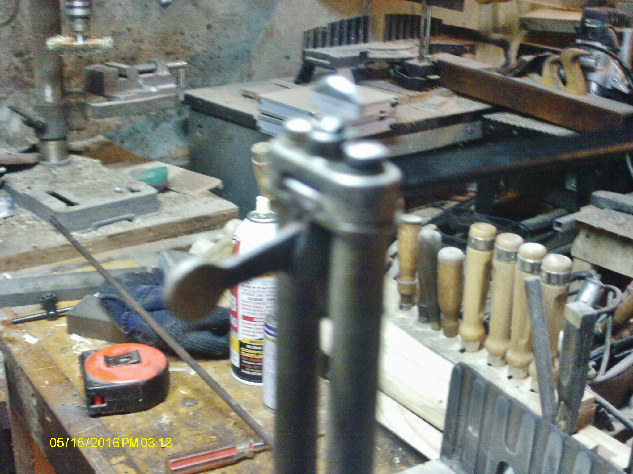

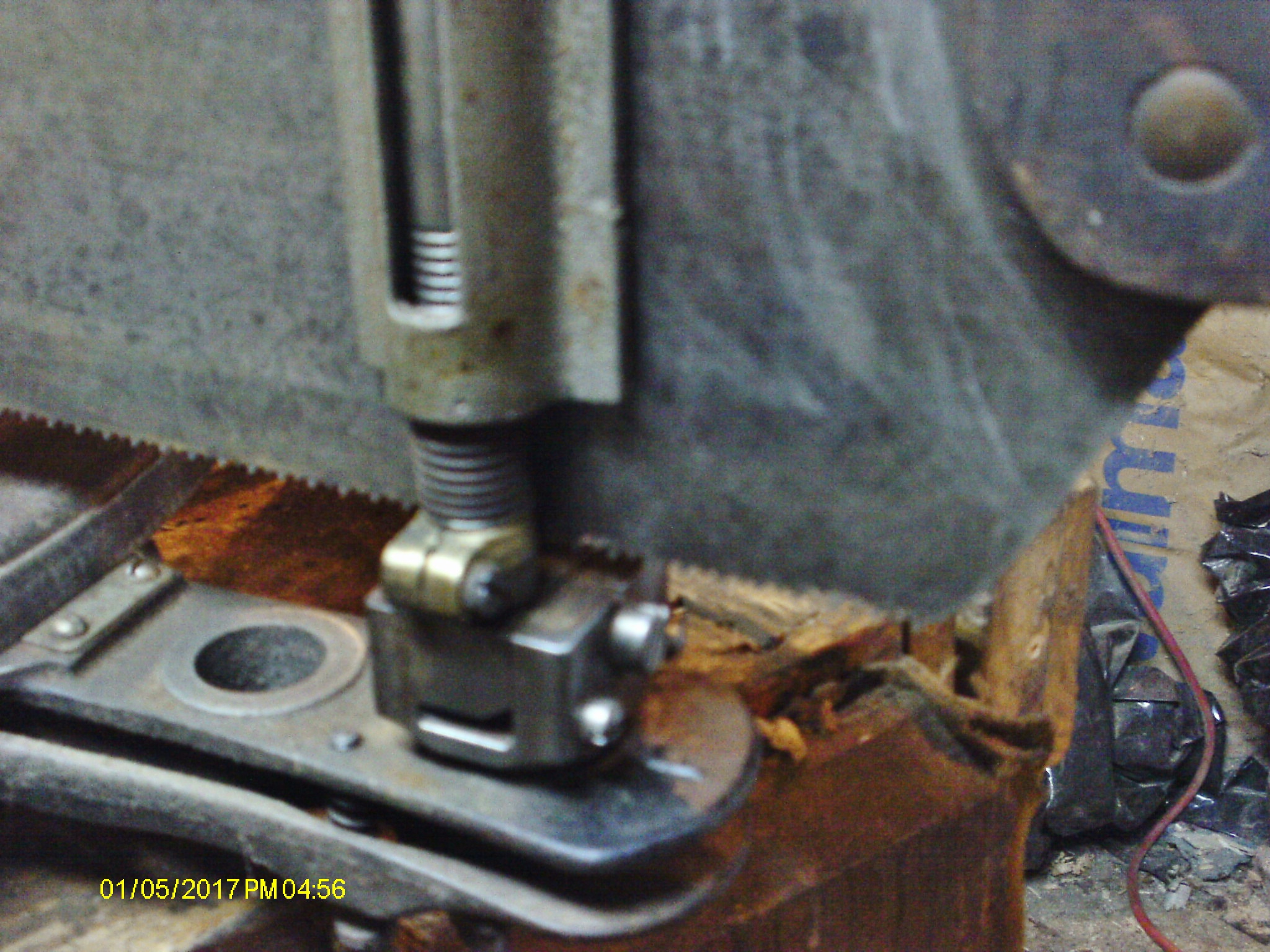

This is the front guide.  It will have an "F" right above the center bolt.  The spring is supposed to go on the left.   At the top, there should be a lever.   You "trip' the lever to lower the saw.   The Rear guide will have a "B".  The tab at it's top will be a square shaped one.  When the saw is tripped on the front, the tab on the back gets tripped as well.  On the photo with the saw, I have the back guide turned the wrong way, as the tab should be towards the front.    I can  try to other pictures if need be.

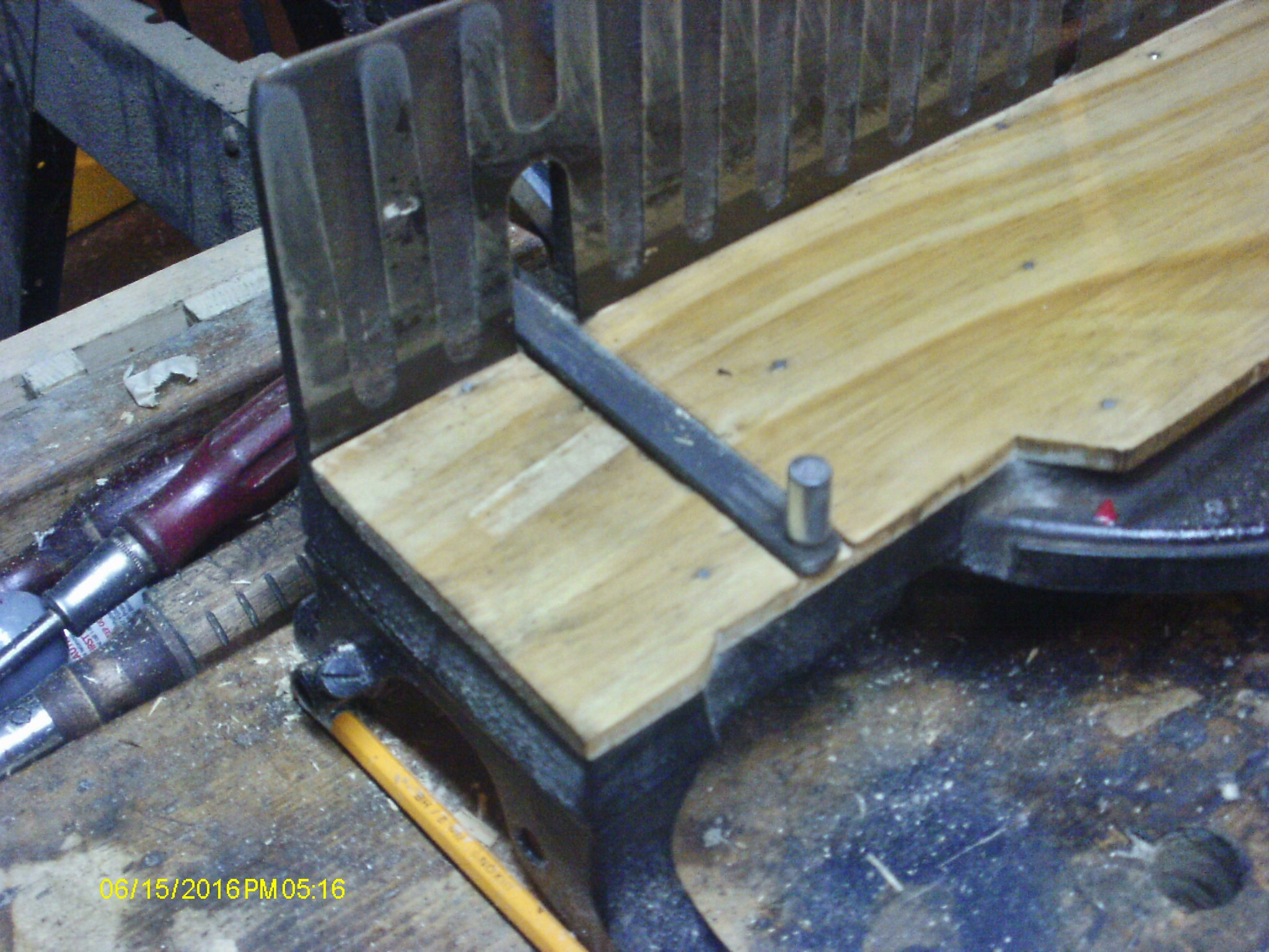

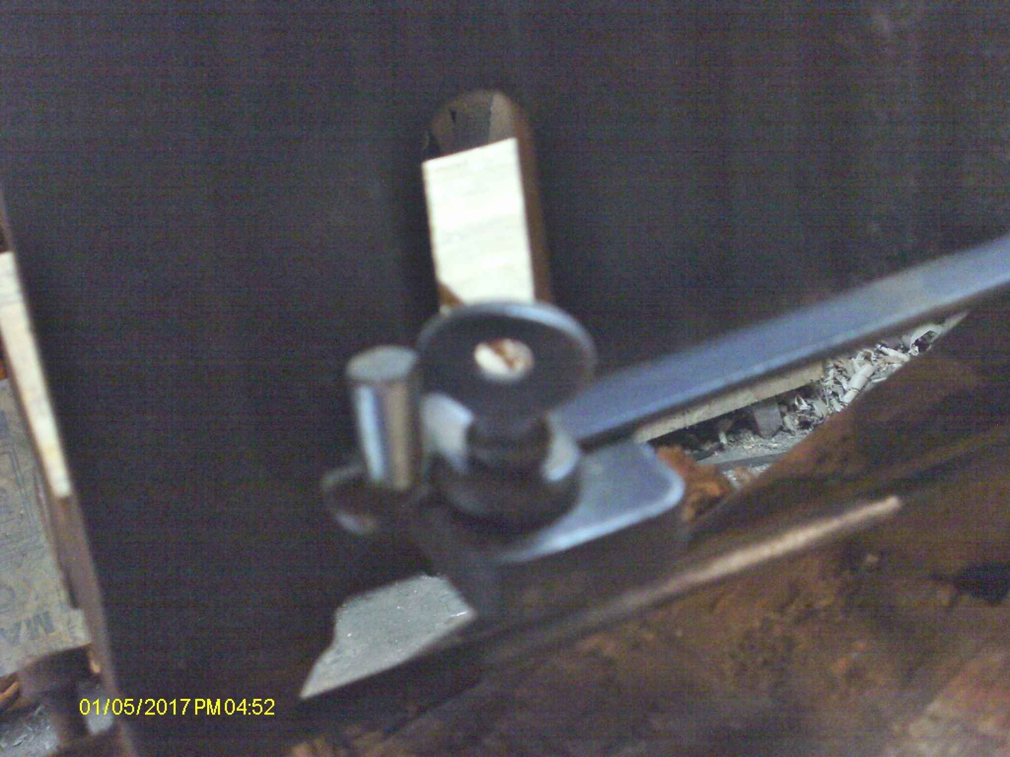

They are for the stock holders.
A bar & peg, that slides in a dado in the deck.    It is supposed to help hold a piece of lumber against the fence, so it doesn't move while you are trying to saw it..
Slide this out, place the wood on the deck, and then slide the pin against the wood and tighten the thumbscrew in the back.

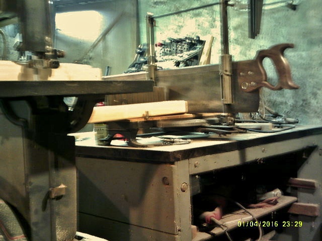

You can just barely see the pin sticking up there.  Holding the work while the saw is in use..  and giving my shoulder a work out..
