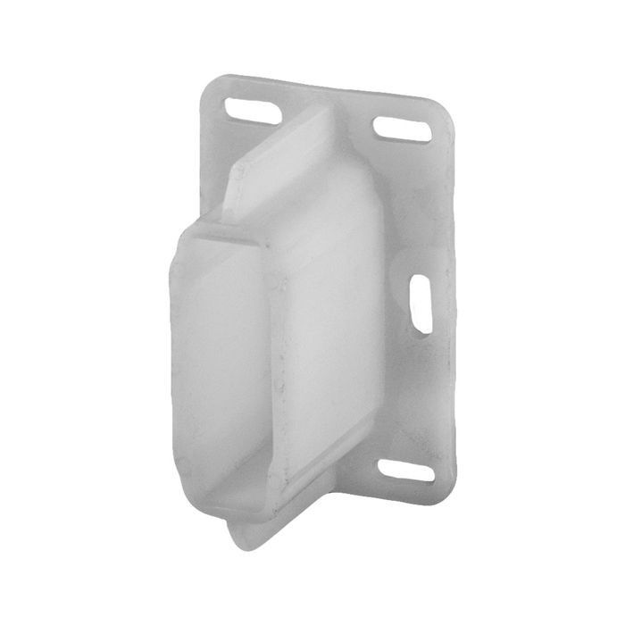

January 6, 20179 yr comment_91503 I would like to change the drawer slides in my kitchen cabinets to Full Extension Ball Bearing type. I've seen there are many different lengths and I don't know where to measure for the slides. Any advice and help would be appreciated. I think I'll need the rear mount brackets also. There's a piece of plywood screwed to the back of the cabinets to strengthen the back. Most likely a place to screw the brackets to hold them. Report
January 6, 20179 yr comment_91510 Wally, I am thinking whatever the depth of your drawers are would be about the length of the slides you need. If you are mounting with a rear bracket, they may need to be the depth of the cabinet minus the bracket. I would go to Woodworkers Supply (online) and look at all of the drawer slide options they have and look at the downloads they provide on the installation recommendations for the particular slides. Report
January 6, 20179 yr comment_91517 measure from the face of the face frame to the back of the cabinet... select the glide or nears length of glide that will fit... block the back of the cab to hold the end of the glide if it won't reach to the back of the cab... or filler between the glide and the wall of the cab... Report
January 6, 20179 yr comment_91524 my rule of thumb: cabinet depth - 2" = length of glide. so for 24" deep cabinets, I use 22" glides. allows room for rear boards that secure the cabinet to the wall (usually 3/4") Report

November 10, 20197 yr comment_208289 Some slides fasten the the rear wall. If you get that kind then they need to be a little longer than your drawers. Report
November 11, 20197 yr comment_208341 You can buy full extension rear and side sockets...usually you want to usd a 22" full extension drawer slide for a 24" deep cabinet... Report

November 12, 20197 yr comment_208522 It's not uncommon to want to move from a side mount roller to a full extension drawer slide. They both require a 1/2 on each side or a drawer box 1" less than the opening it goes into.... Simple measure the drawer sides and that should give you the length needed. If you have a cabinet 24"deep and a drawer box 22" deep then you need a 22 drawer slide.... Report
November 12, 20197 yr comment_208523 The side mounts require the 1/2 on each side of the drawer but won't work if you have the older center style drawer slides metal or wooden... Report
