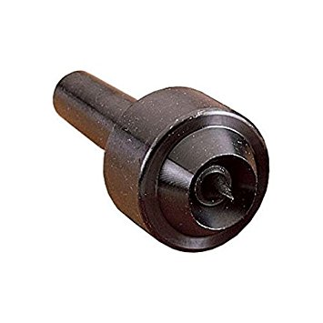

Common live centers like the one shown have a Morris taper shaft cut to fit a bearing on the end and a cap made to fit over the bearing.  Buy one and remove the cap and bearing and take them and the tailstock to a machine shop and they can make an adapter to fit your shaft. That is the best I can do without pictures.  Pictures are always a big help at getting the right help.

Sorry my post was to show a picture of a live center.  You can remove the tapered shaft from the bearing and have the machine make a threaded adapter.
Image result for wood lathe live tail center
