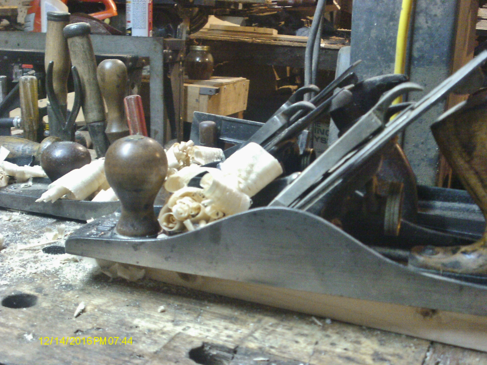

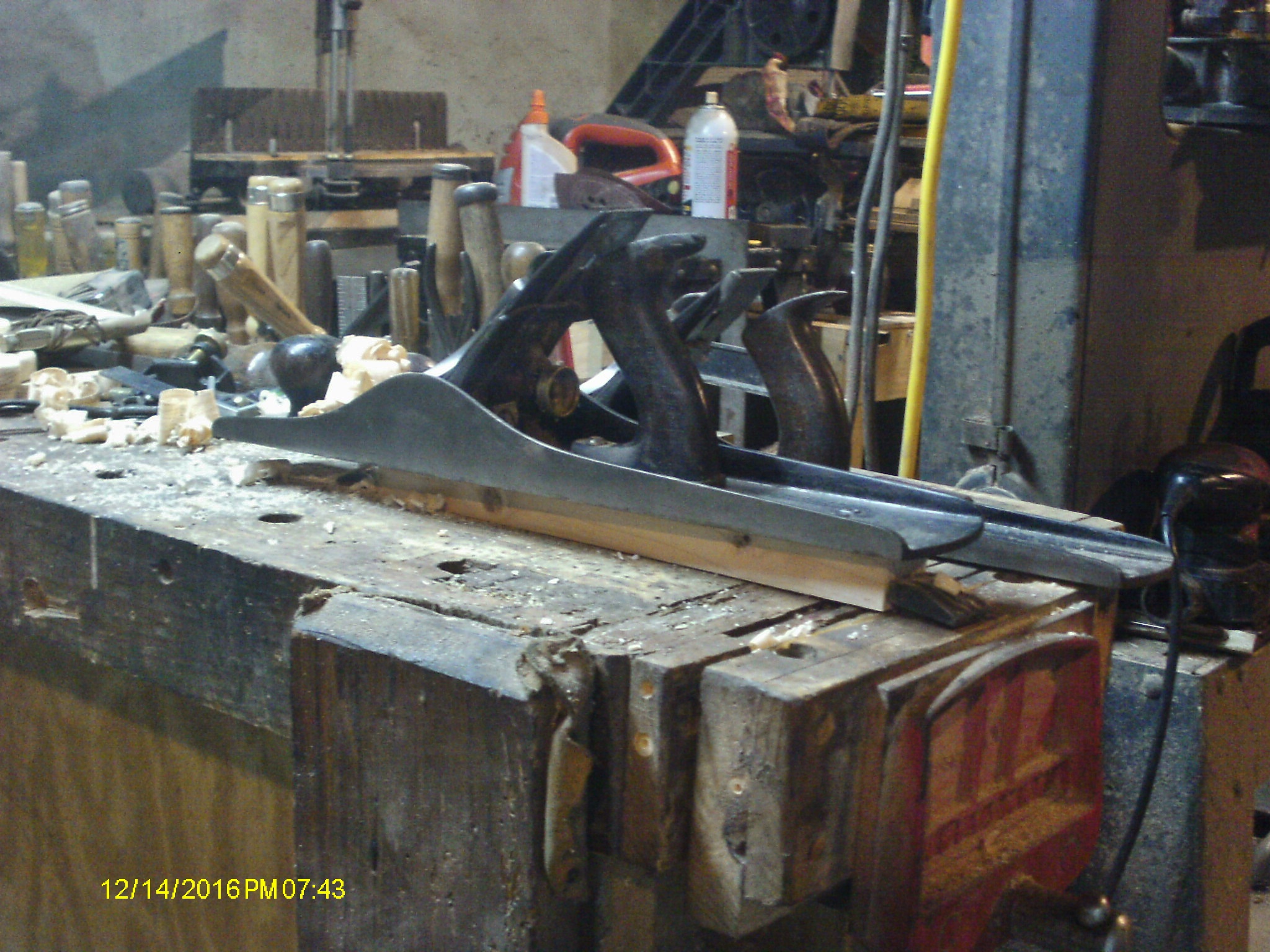

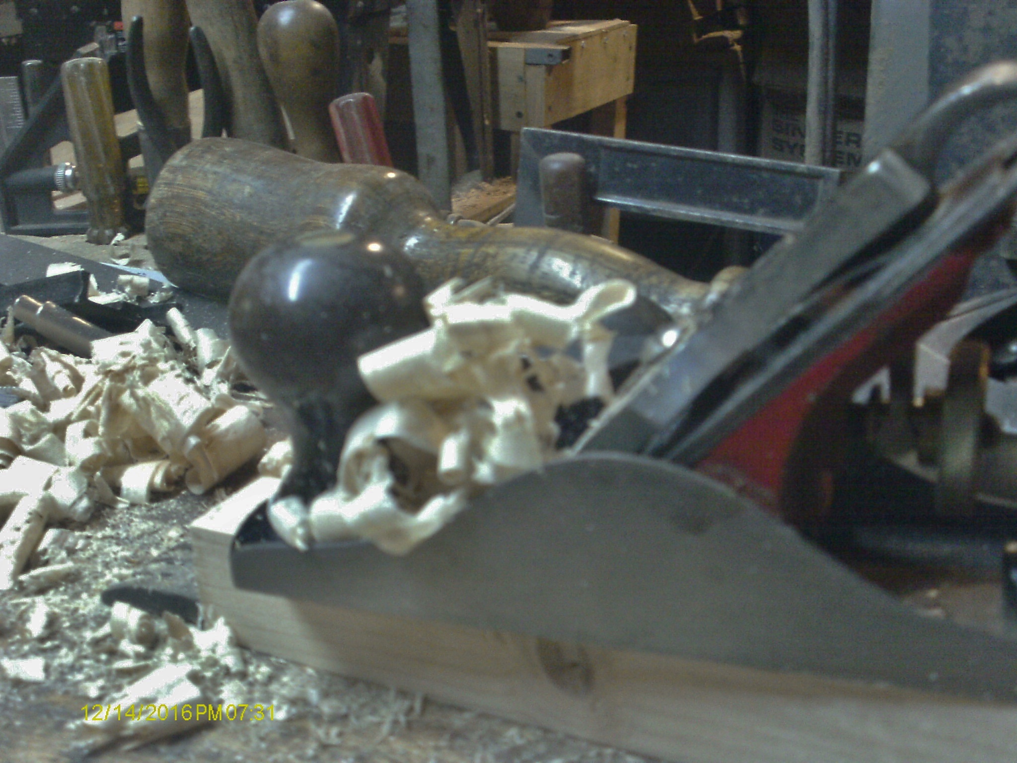

Everytime I rehab a plane or do a bit of "upkeep" to one, I tend to set up a bit of scrap to test the plane out.   kind of fun WHEN they are set up right.   Also shows me what needs attention...
Already had the Fulton done, and had a Craftsman ready....then the camera.....got the camera to work again..for a little while

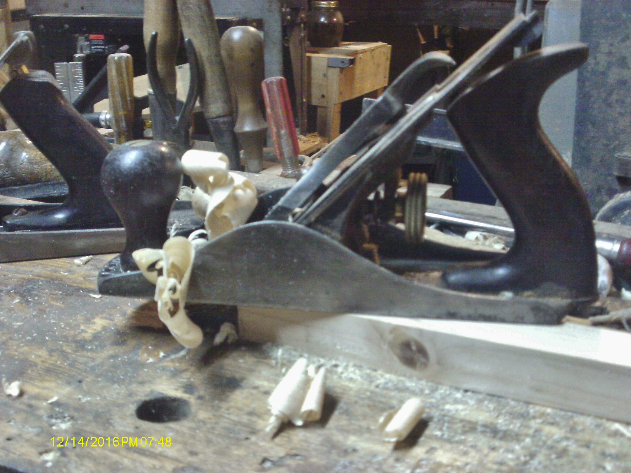

Made  by millers falls.   Had to completely re-do the bevel on the iron....hey, they do tend to  wear a bit.   Checked on a couple other planes...
This Ohio Tool Co. No. 0-7  had a bit of rust on the sole.   C;eaned it up, and check the settings....
then started on the next little plane..

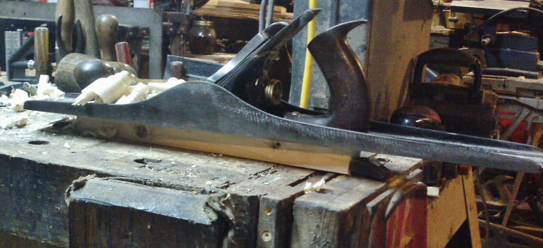

A Stanley No. 6c, type 10.  Wax the sole, and move on..

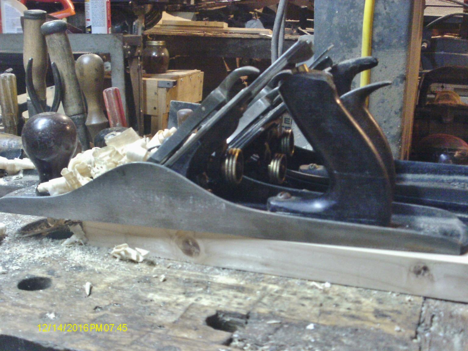

A Stanley No. 5-1/2 Jumbo Jack.  Type 17 makes it almost the youngest of the group..  Now, I do have two Stanley Jack planes...the No. 5c has a cambered edge to the iron, the Stanley No. 5 smooth sole?
Seems to be about ready?   Which leaves a No. 4 sized plane to check on..
A Stanley No. 4 Type 13 SW model.   Seems to be about ready?
That be the main group of planes.   I also tried out a Stanley No.7c, type 9....but then the camera locked up, again.   Grrrrrrr.
Maybe next time, I'll have a larger piece of pine scrap?

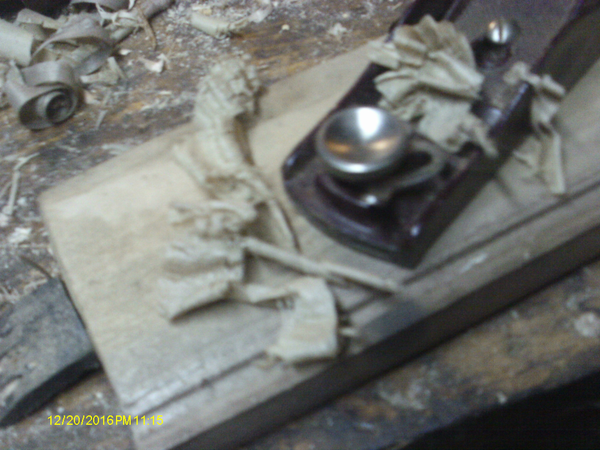

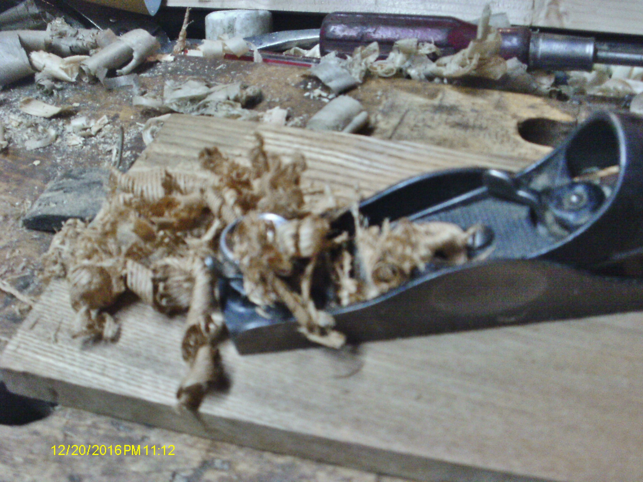

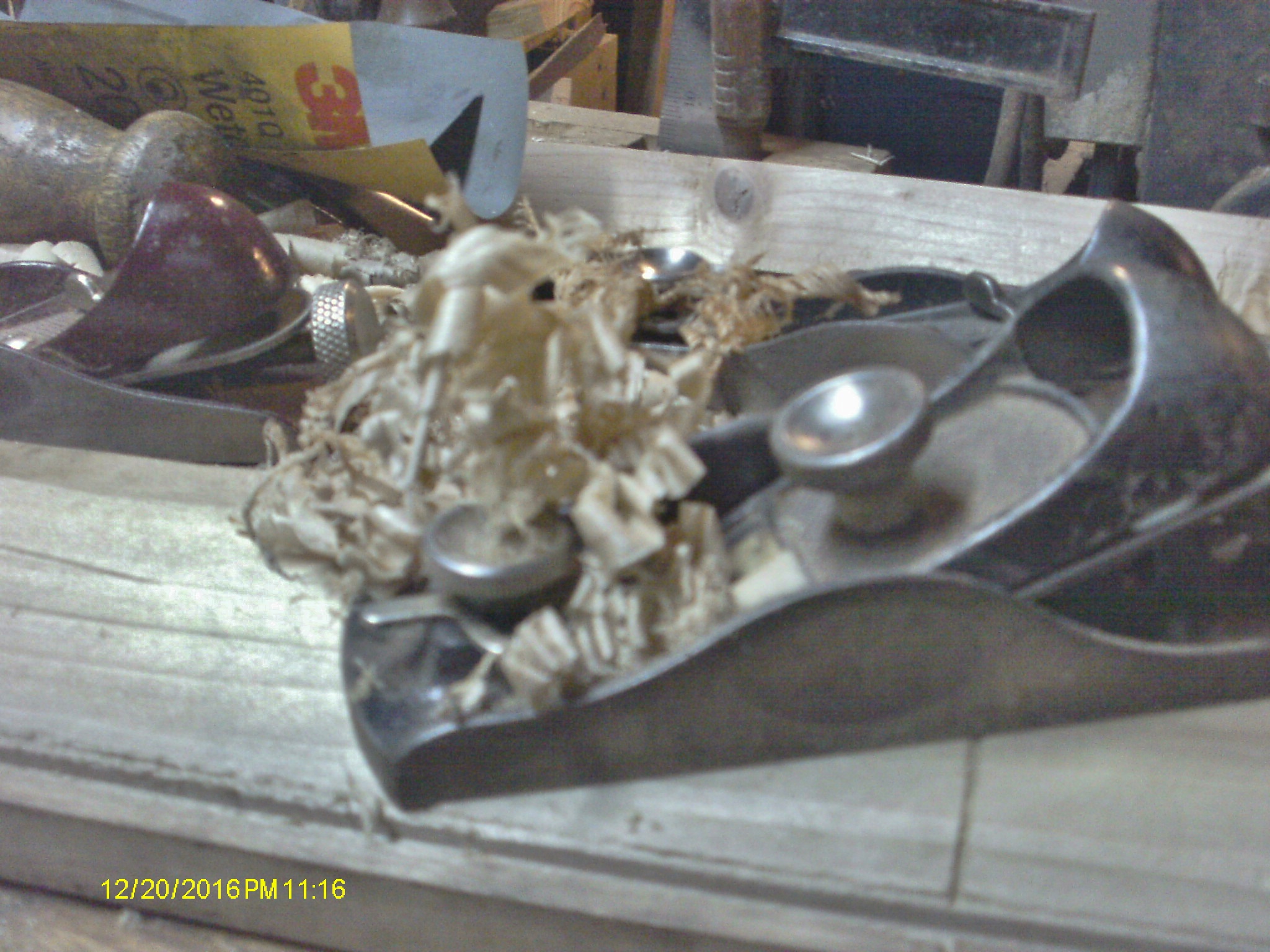

Trying to get a few block planes sharpened back up..
Millers Falls #56B vs white oak......needs more tune up...
Stanley 60-1/2 :Cordovan......needs a few trips down a strop..
Stanley 9-1/2...meh.....maybe tomorrow I can finish them up?
Like that one...got one just like it...close to having it all refurbed...mine originally had Black Japanning though...yours look like it still has the original "maroon" color Japanning??? Sweet little low angle model...
I'll try to get some of the PIP posted yet this year.
Never seen one of those with the adjustable throat opening Steven...nice...
?? for you...do you put any 'chamber' on your block plane irons?
Edited by Grandpadave52
Millers falls #56B was always black japanning.....the Cordovan was something Stanley used before they went with that ugly blue colour.   Late 60s, I think....Stanley had a full range of planes in that colour...I even have a # 9-1/4 block plane in that "maroon"  colour.   Sold a 9-1/2 last year in Cordovan.
I do not put any camber on block plane irons,  have a hard enough time keeping the edges straight across..
Good information to know...thanks
Also good to know...I have used the "ruler trick" for the micro bevel and also on a couple for oh so slight camber, but really couldn't tell much difference...glad to know I'm not the only one that struggles keeping the edges straight :P
