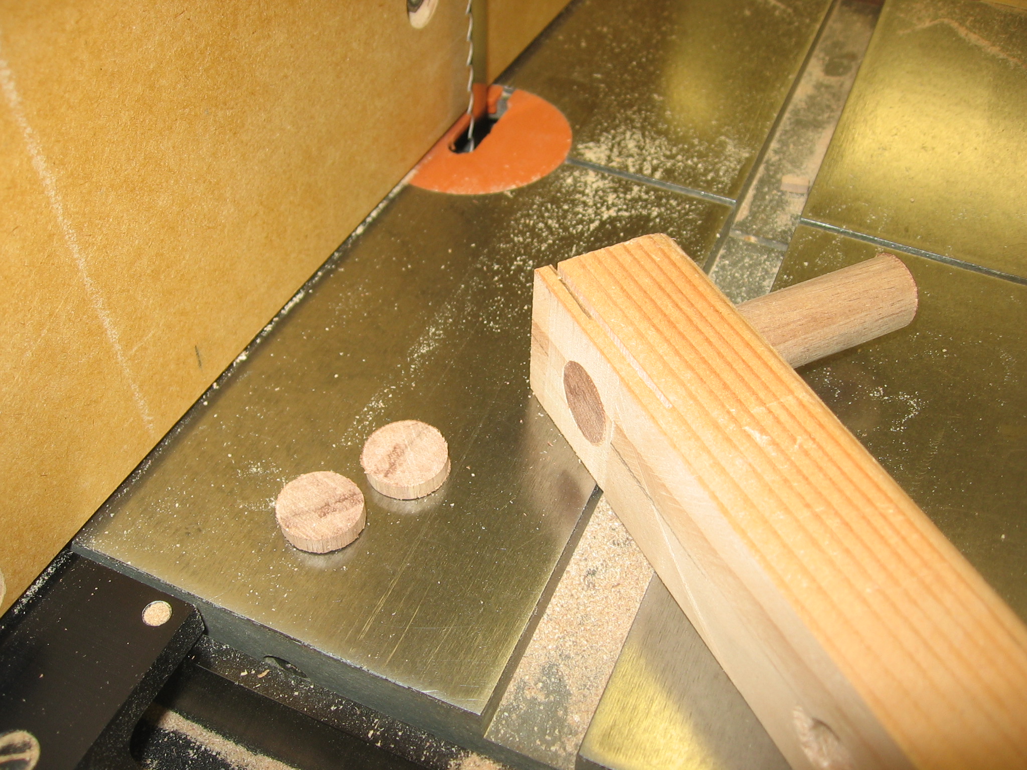

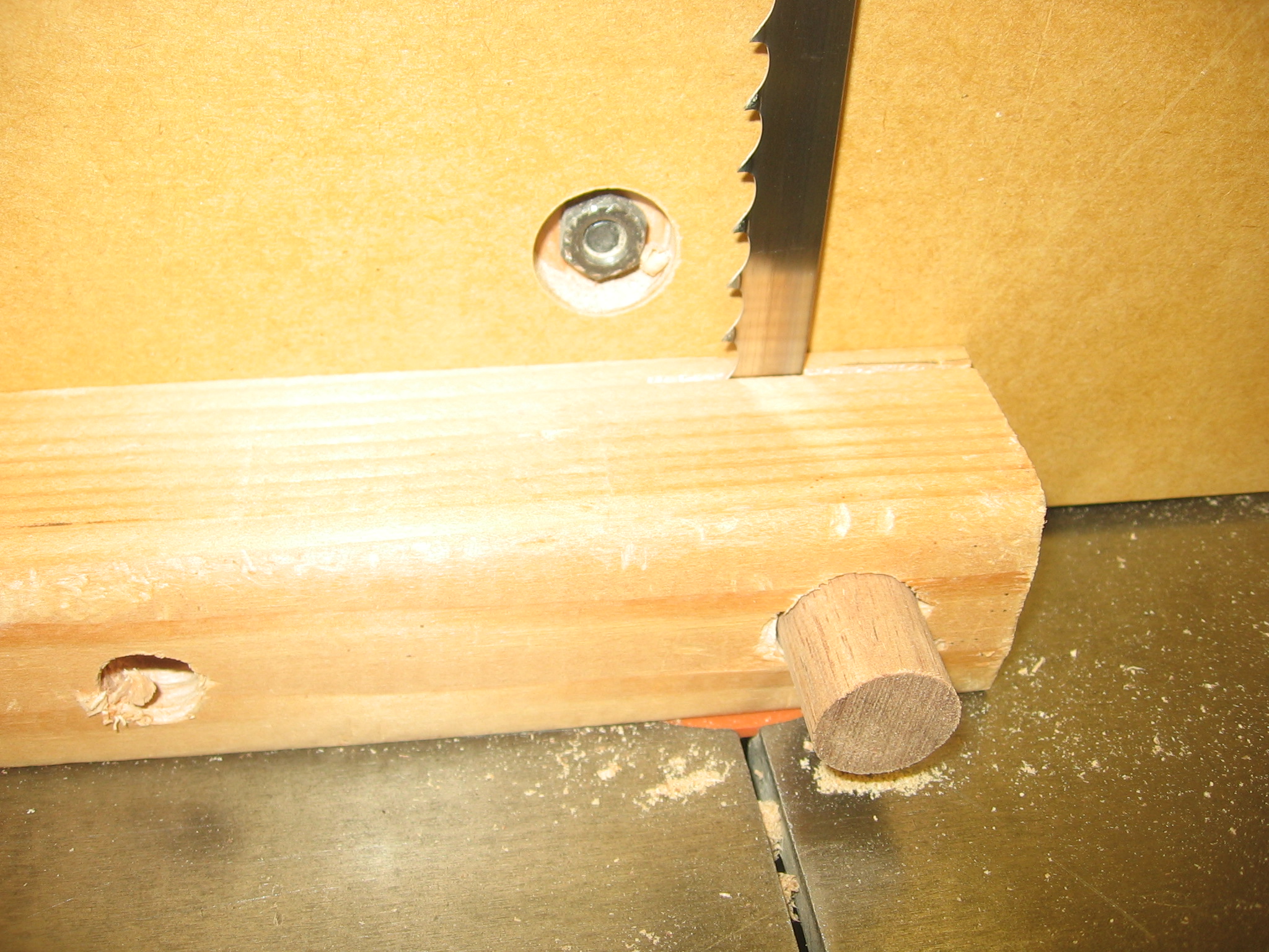

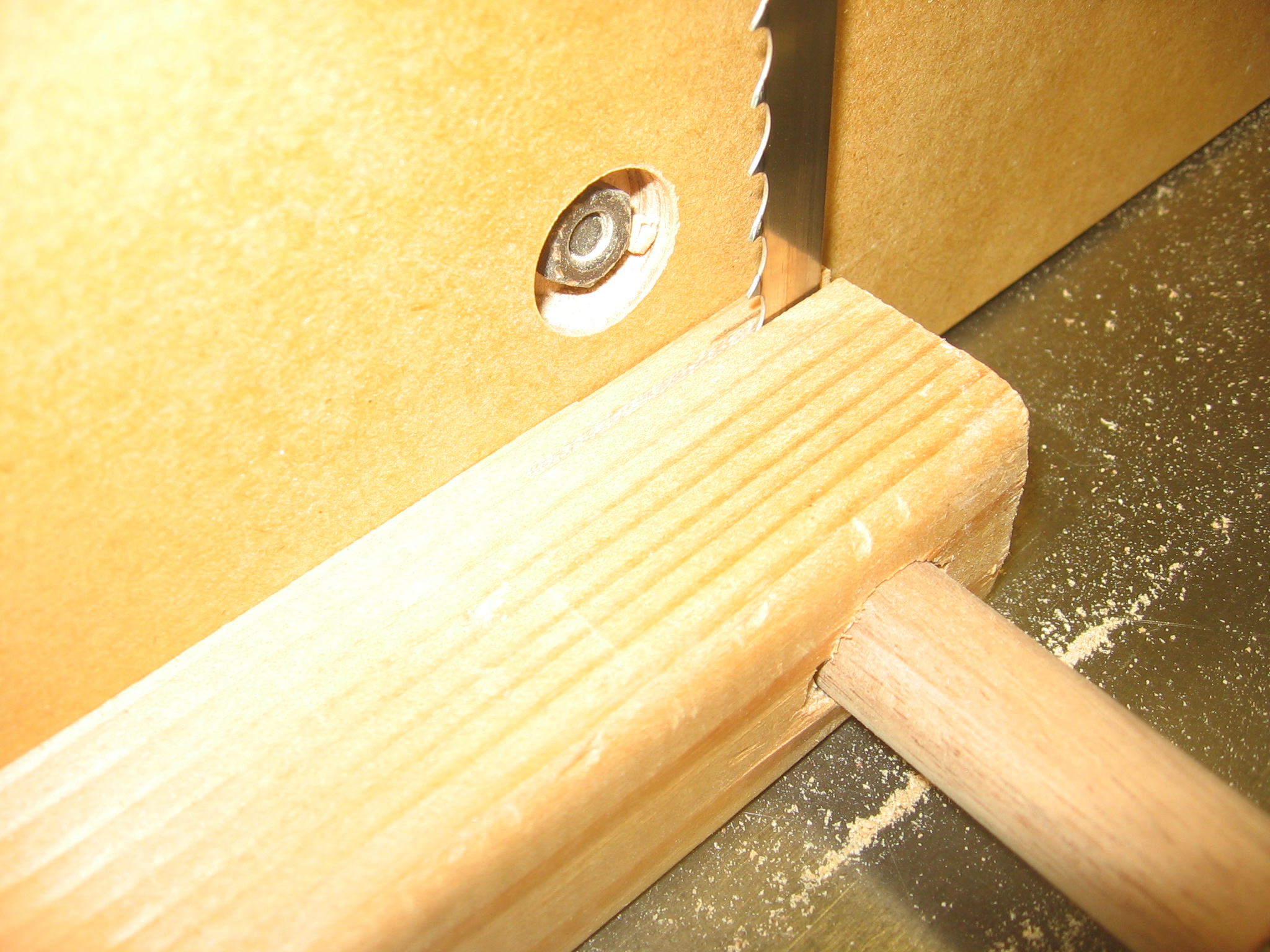

November 28, 201610 yr comment_85695 I replied to thison another thread. I don't like to cut dowels on the TC,cant find them after they go air born, so cut them on the Band saw. Make a jig out of a block with a hole cut thruit the size of the dowel. Set the fence on the band saw the length of the cut. Insert the dowel into the hole ,riding against the fence. Make the cut and withdraw the block. Keep doing till the number of dowels required is cut. The dowel buttons are all the same thickness, they are trapped against the fence,so they don't go airborne and is a safe way to cut a small piece. Report
November 28, 201610 yr comment_85696 6 minutes ago, Dadio said: The dowel buttons are all the same thickness, they are trapped against the fence,so they don't go airborne and is a safe way to cut a small piece. same for a TS only you raise the blade enough to cut the dowel meanwhile yur not cutting through the jig only kerfing... use the dowel length to push out the button... Report
