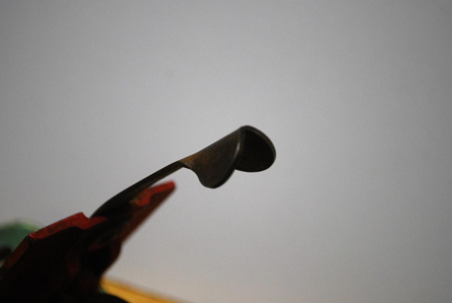

steven newman Posted October 29, 2016 Report Posted October 29, 2016 Not too sure about the "off" brands from England ( keep wanting to say FAL CO) Depth adjuster knob is a WW2 Stanley. That large black knob stuck into the toe of the rear handle? Doesn't belong there. Replace with a frog bolt of the right size... Maybe an off brand of Stanley-UK, or maybe a war era clifton for army use? The orange frog also screams Stanley. Would like to see the end of the lateral lever....where a thumb would go to adjust it. Sharpen it up, replace that Fugly black knob with a bolt, and replace the lever cap. Grind a decent camber on the edge of the iron. Should do ok. Fred W. Hargis Jr, Grandpadave52 and HARO50 3 Quote
HARO50 Posted October 29, 2016 Author Report Posted October 29, 2016 (edited) Thanks for the info, Steven. I was wondering if this thing was a Frankenplane! That "fugly" knob really interferes with one's grip on the tote, and with the cutter cap properly positioned, the iron protrudes about 1/8" at the shallowest setting. I'll get a shot of the lateral lever. By the looks of the remains of that lever iron, "FALCO" COULD fit on there! John P.S. Can't find anything under "Falco" online. Edited October 29, 2016 by HARO50 Quote

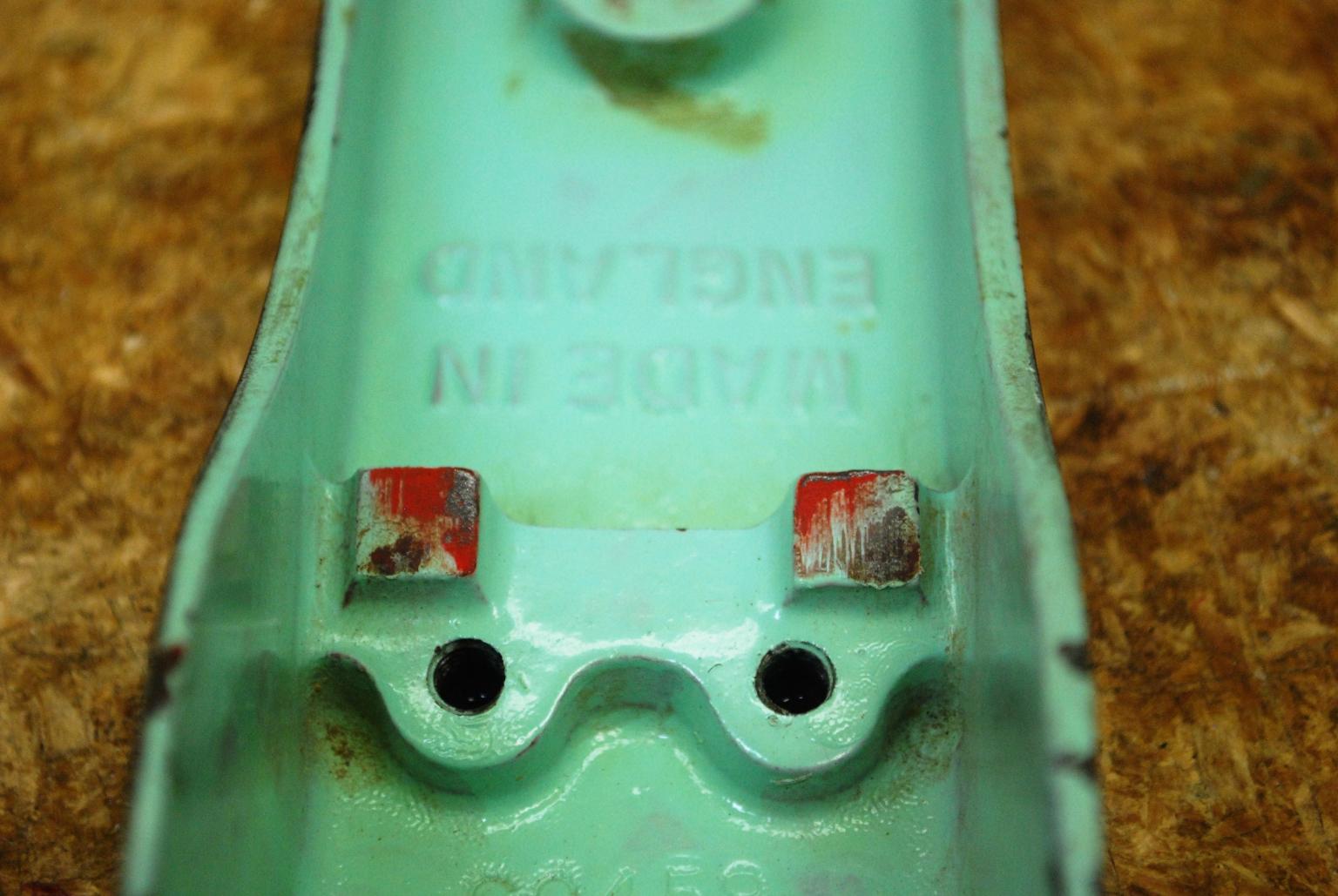

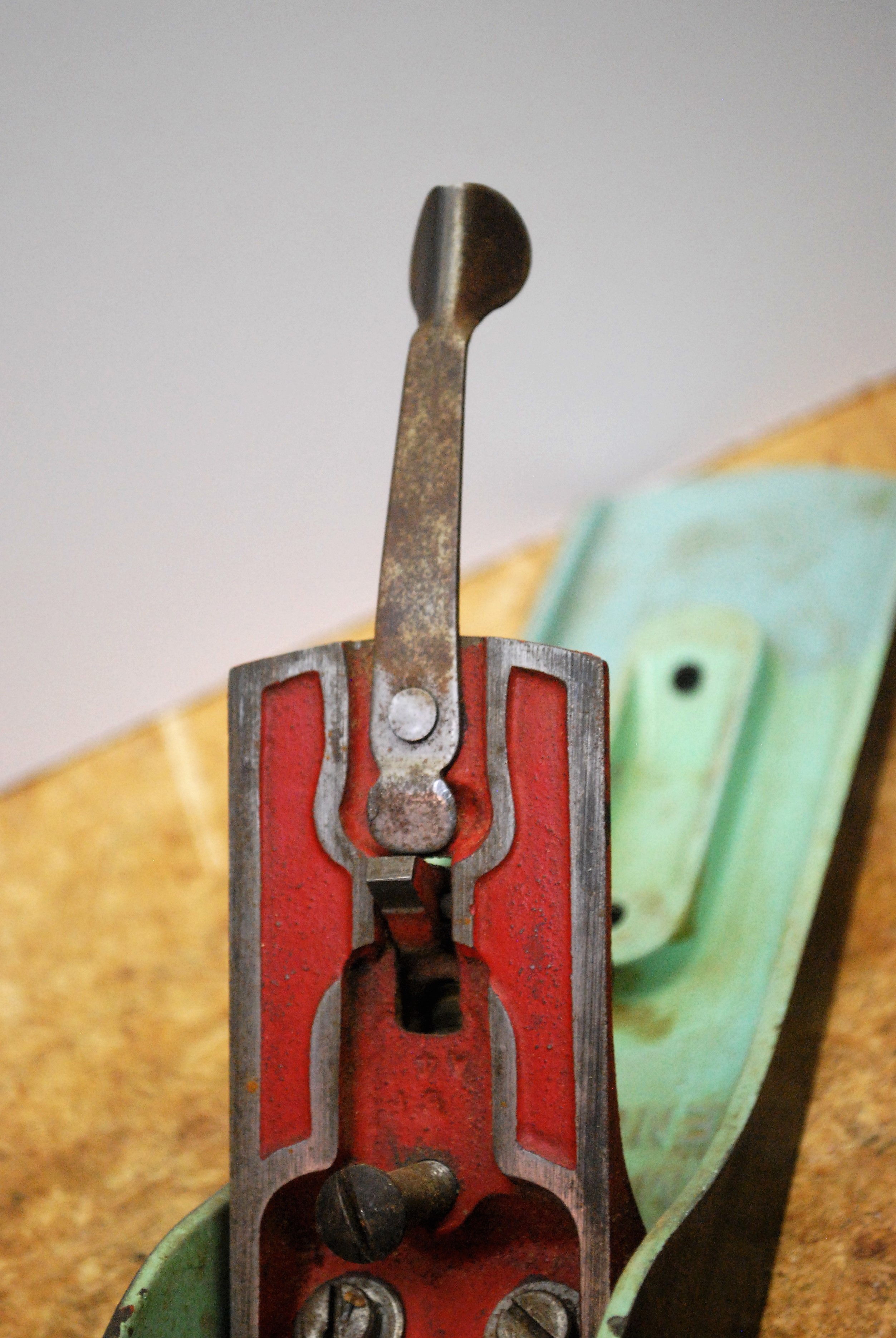

HARO50 Posted October 29, 2016 Author Report Posted October 29, 2016 Dismantled most of the plane and washed off some of the grime.... seems it was originally red. The green is definitely paint, and a lousy job, too! A small amount of paint on the knob and the threads of the bolt holding it proves that. I also found an F and a 2 in the hollow under the tote, as well as CO 459 under the frog. Don't know what the previous owner used this thing for, but by the looks of the sole, he was using it to plane TAR! John Grandpadave52 1 Quote
steven newman Posted October 29, 2016 Report Posted October 29, 2016 Stanley. Has the "Whaletail" adjuster. In 1962, Stanley crimped those wide "flukes" down to almost closed. Frog is either a Handyman style or a Victor. Markings under the handle would be mold marks. Showing which cavity and which mold was used. Age? Somewhere between WW2 and 1962. HARO50 and Grandpadave52 2 Quote

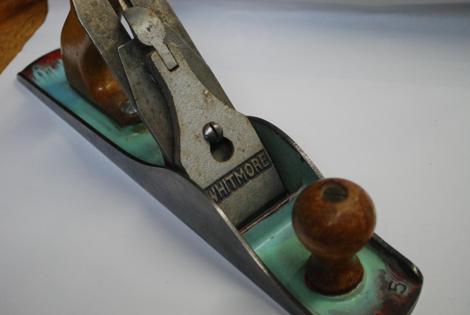

HARO50 Posted February 4, 2017 Author Report Posted February 4, 2017 Took a cross-country trip yesterday to find someone who has been posting assorted tools on Kijiji for a while now. Five large sheds full of furniture, tools, you name it, this lady has it! Found something in a box labelled "Parts". Not a mach, but not bad for $5. John Stick486, John Moody and Grandpadave52 3 Quote
Grandpadave52 Posted February 4, 2017 Report Posted February 4, 2017 Sweet find John...oddly close to your broken one even down to the green paint. What do you know about Whitmore planes? First I've ever seen or heard of one... Assume it's a #5 beings there is a #5 on it HARO50 1 Quote
HARO50 Posted February 4, 2017 Author Report Posted February 4, 2017 Guess I wasn't specific enough. The "part" was the lever cap... the plane is the old one I tried to identify previously. So I have a "Talco" plane with a "Whitmore" lever cap, but the important thing is, it works beautifully! John Grandpadave52 and Stick486 2 Quote
Stick486 Posted February 4, 2017 Report Posted February 4, 2017 3 minutes ago, HARO50 said: the important thing is, it works beautifully! couldn't ask for more than that... HARO50 1 Quote
Grandpadave52 Posted February 4, 2017 Report Posted February 4, 2017 8 minutes ago, HARO50 said: Guess I wasn't specific enough. The "part" was the lever cap... the plane is the old one I tried to identify previously. So I have a "Talco" plane with a "Whitmore" lever cap, but the important thing is, it works beautifully! John Well that 'splains it Lucee' Guess I was more tired than I realized last night... Still a good find and better yet you got the "old plane back in the air." HARO50 1 Quote
