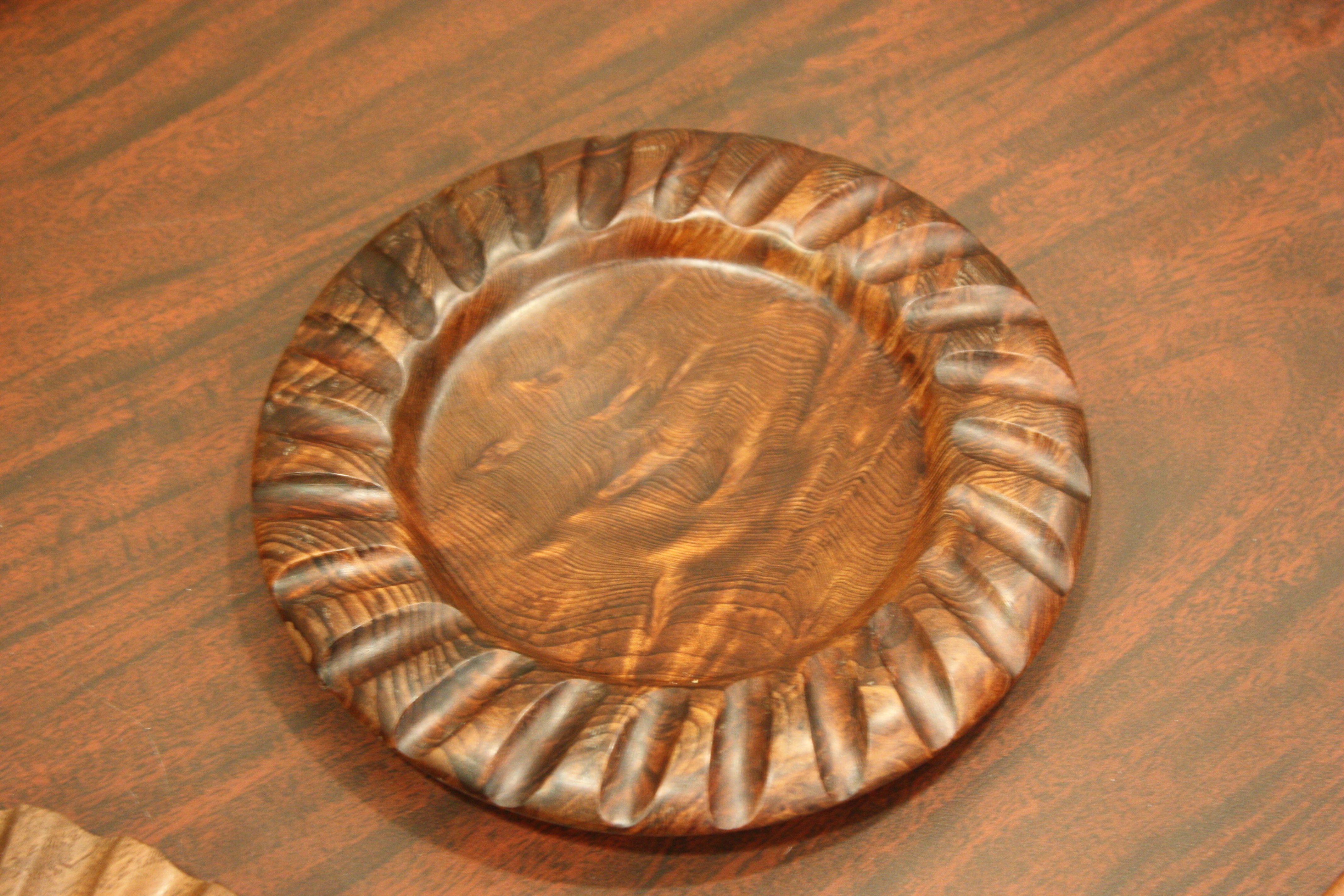

October 26, 201610 yr comment_80794 22 hours ago, Ron Altier said: Gerald, I had no idea what an indexing head is. Had to go to Youtube and see. Looks very precise and time consuming. I have made some pieces that were segmented with precise cuts, glued and turned. Can you post something you have made that used this process? Thanks I do not have a picture of the setup, but used the index wheel to drill these holes while on the lathe. The index wheel also allows you to use a platform on the lathe and do fluting or groves in projects on the lathe. This site has the plastic index wheels I use . There is also a metal index wheel at a site called Alisam Engineering. This is a very useful tool. This piece was done by a fellow club member . He also did this on the sides of vases and the flute sizes and angles can be changed too. Report
October 26, 201610 yr comment_80800 Thanks, now I have the concept. The chuck marks a spot precisely so you can perform a maneuver at the exact degree. That is basically how we aimed artillery. Except our circle had 3600 mills, instead of 360 degrees. Report
