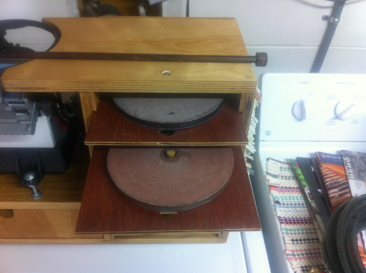

November 23, 201610 yr Author comment_85033 1 hour ago, schnewj said: The dowel is a rod that goes through the finger pulls to keep the shelves from falling out when I move it around. In addition, I used a rare earth magnet on the drawer to keep it from doing the same. If you look real close you can see it in the upper right corner of the drawer. Not a great photo, but it gives you the idea. The reason I asked was that I did use a dowel on a board to line up the sticky backed PSA discs with the hole when I installed them. Works both on the glass with sanding discs and on the MDF with the magnetic discs.. But that is a good idea to lock the shelves in place with a rod. Herb Report
