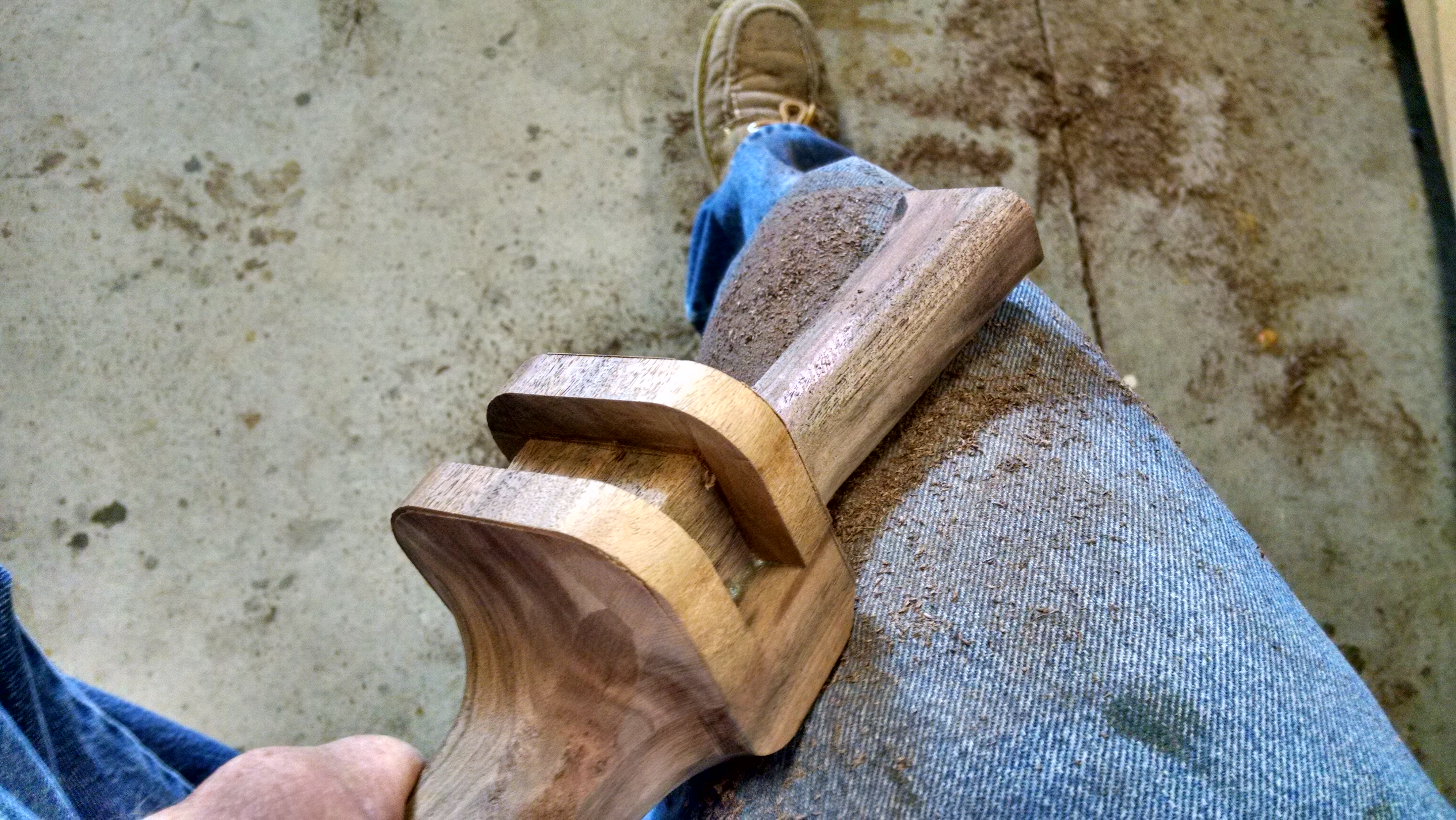

October 16, 201610 yr Popular Post comment_79352 The front legs were started last night and this morning I was able to get them band sawn and roughed out. Earlier, not shown in other topics, I cut out the leg billets, cut the seat joints, and I glued an additional piece of lumber to each leg, as one piece. I'll need the additional material to accommodate the final shape and angle of the legs. I glued both legs up to one additional piece so that when they are separated, their will be a nice symmetry of grain when observed from the front or from the sitters position. I scribed a line from one end to the next diagonally, this is my band saw line. The legs are separated at the bandsaw. The legs are now free. I used a template to outline the rough shape of the front legs. The legs are cut at the band saw to rough shape. Once the profiles are cut, I scribe for the adjacent sides to be sawn. Both legs are now ready for the band saw. I also roughed in some curves to the transition, you can see the light pencil marks extended from the straight scribe lines arcing out to the edge. The legs are now cut one last time at the band saw. Once the legs are cut, some rough shaping was done at the oscillating spindle sander to get the curves where I need them. The rough fit, very rough I may add! But believe me, it all comes together eventually. If anybody has constructed a Hal Taylor chair, you should be recognizing many of the techniques by now. Report

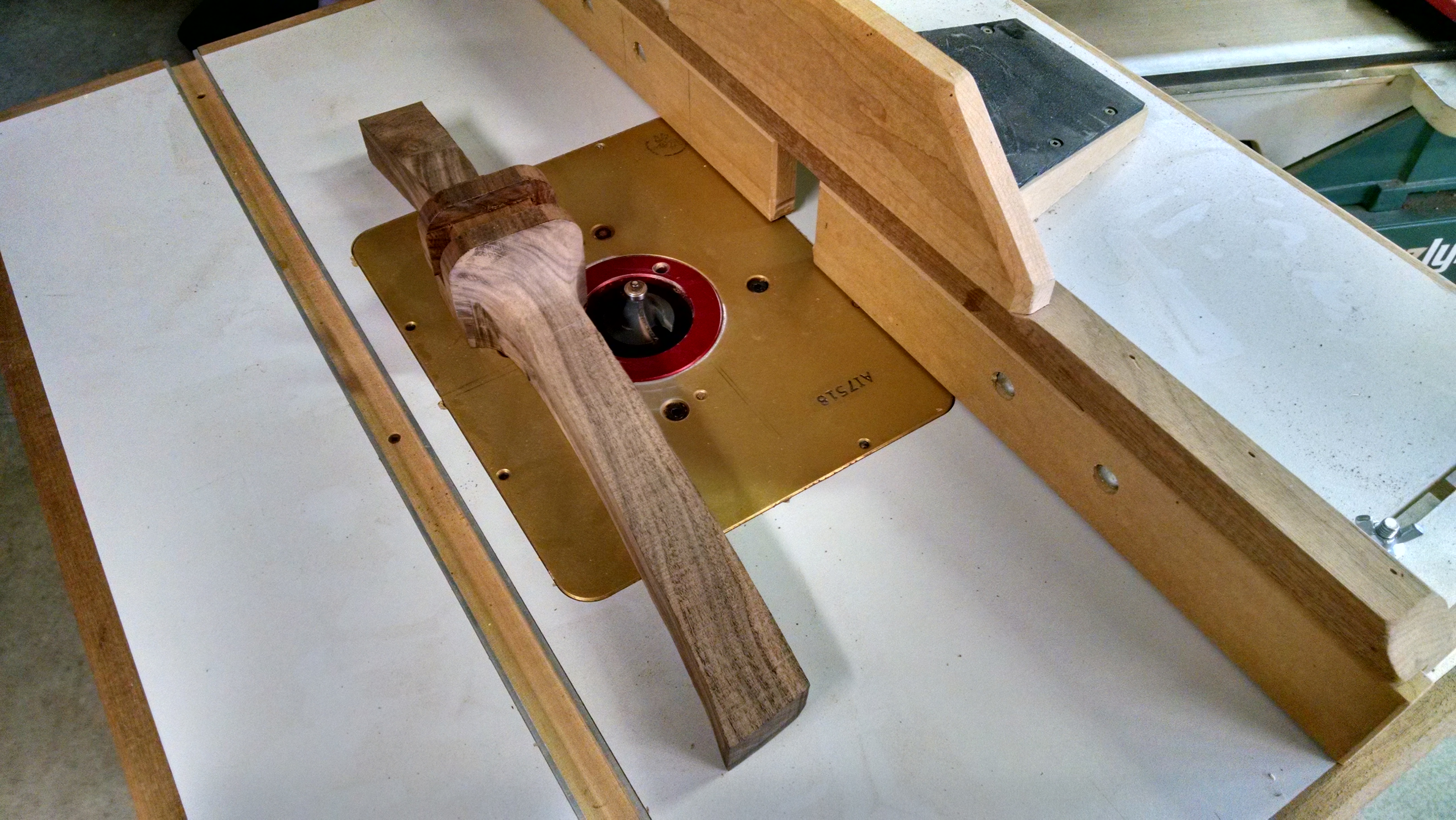

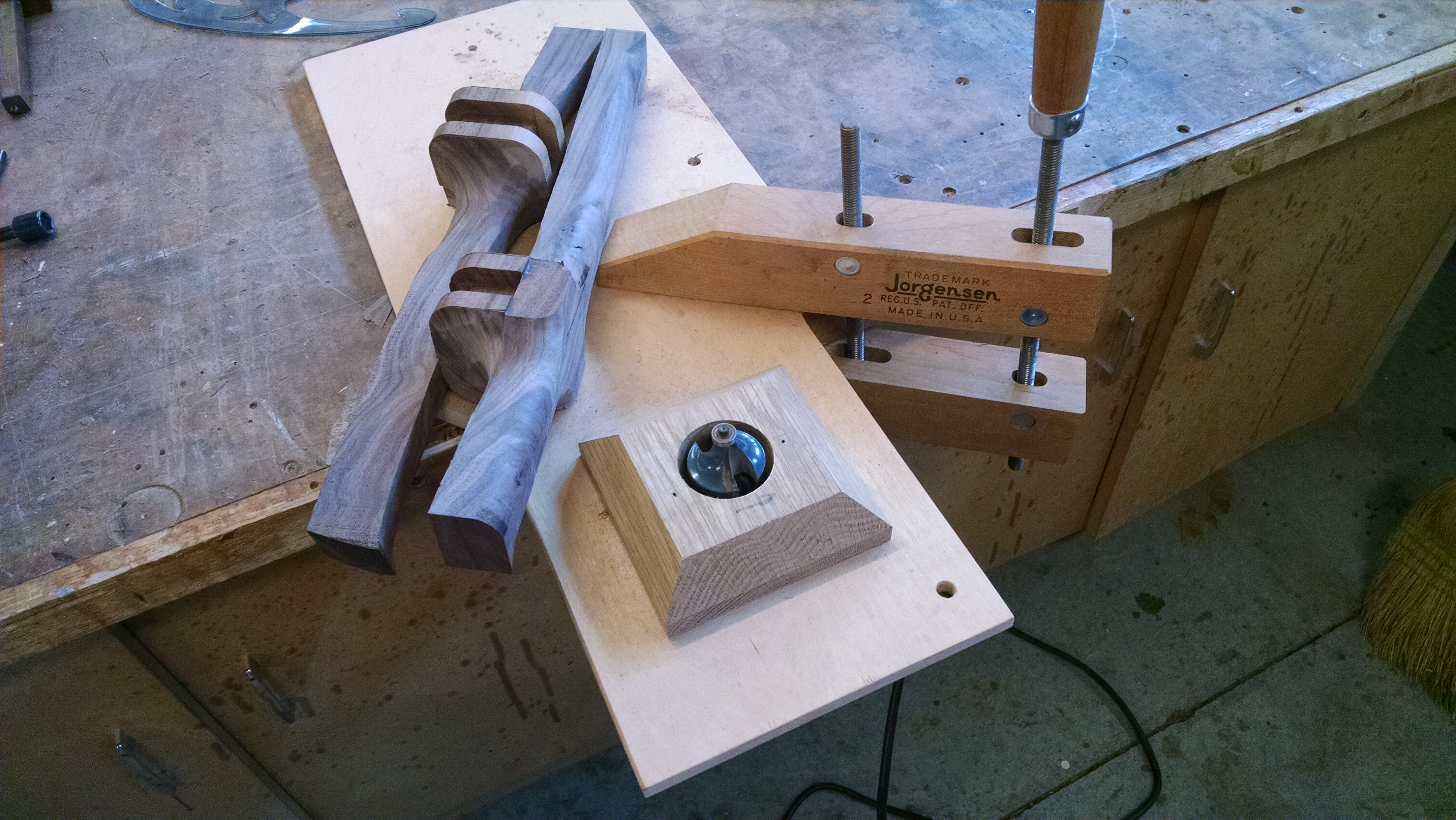

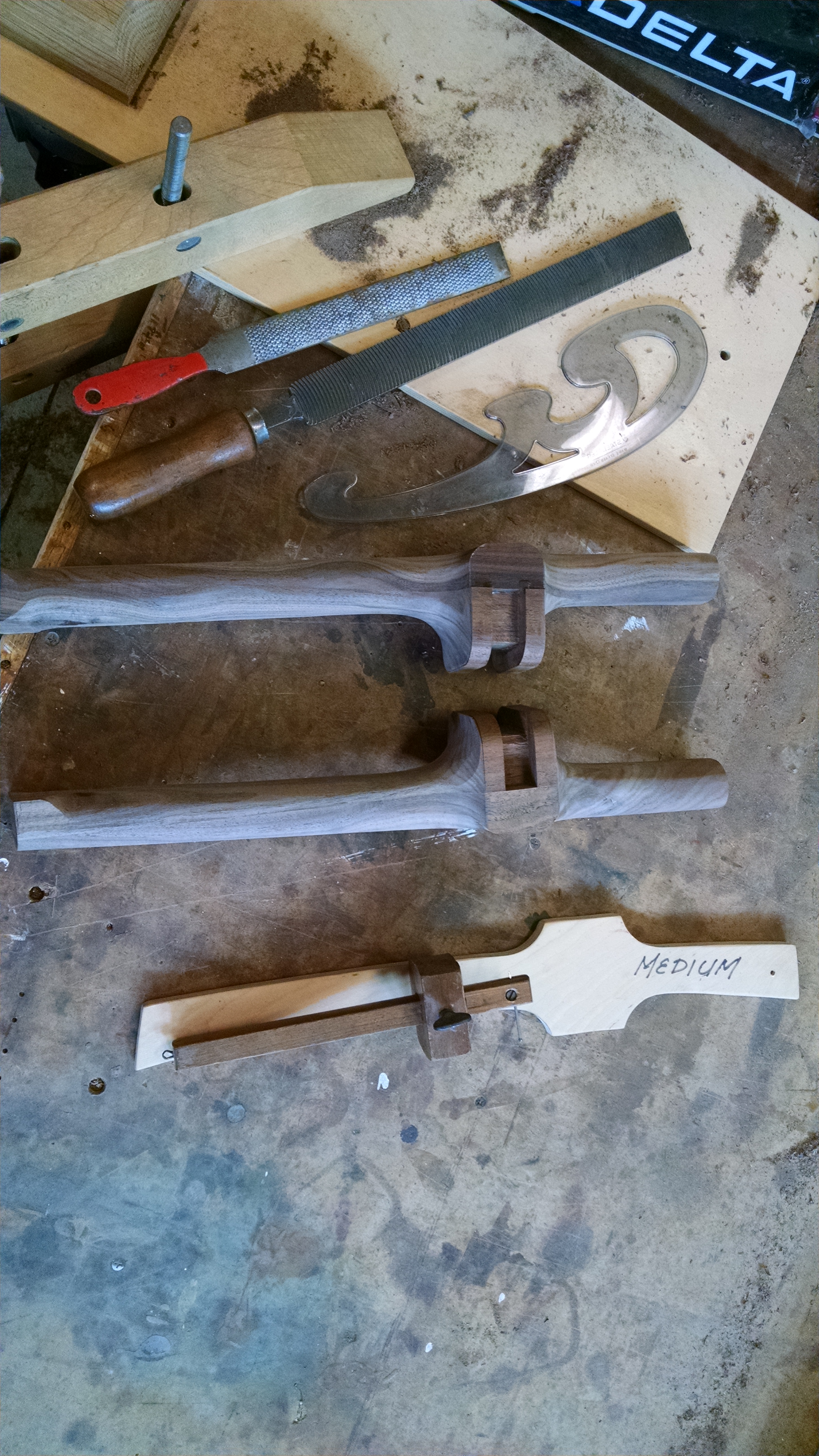

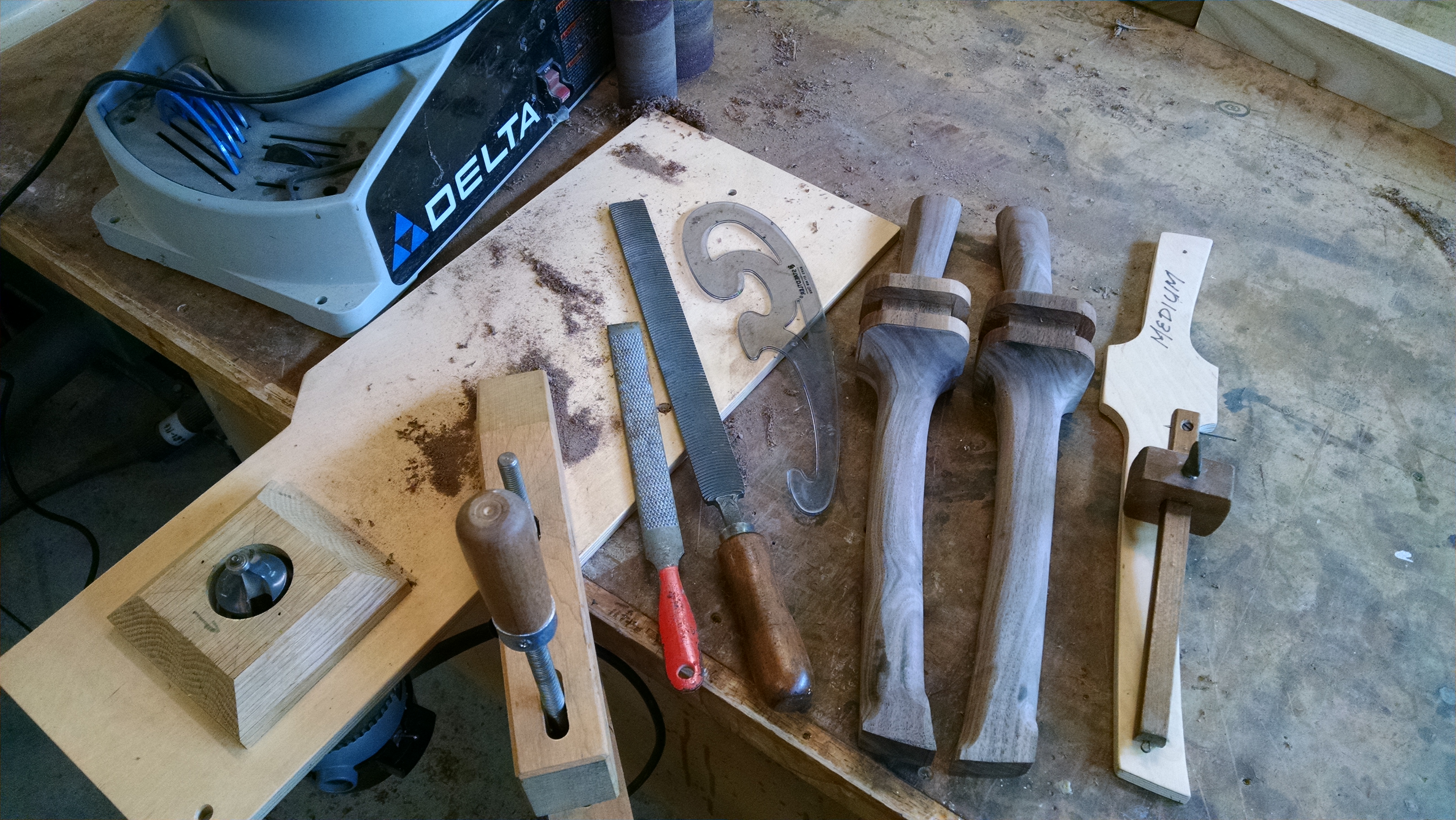

October 16, 201610 yr Author comment_79381 Why thank you Stick! Here are a few more pics of the process. Routing a 5/8" round over on the flat side. And below, using the custom router table to get close on the opposite sides. I could not get all the way in even with the modified router, so I had to use a rasp and float to round over the remaining edges. Now I have some very sexy legs don't I? The legs, and the tools I used to get them to the state they are in. Report

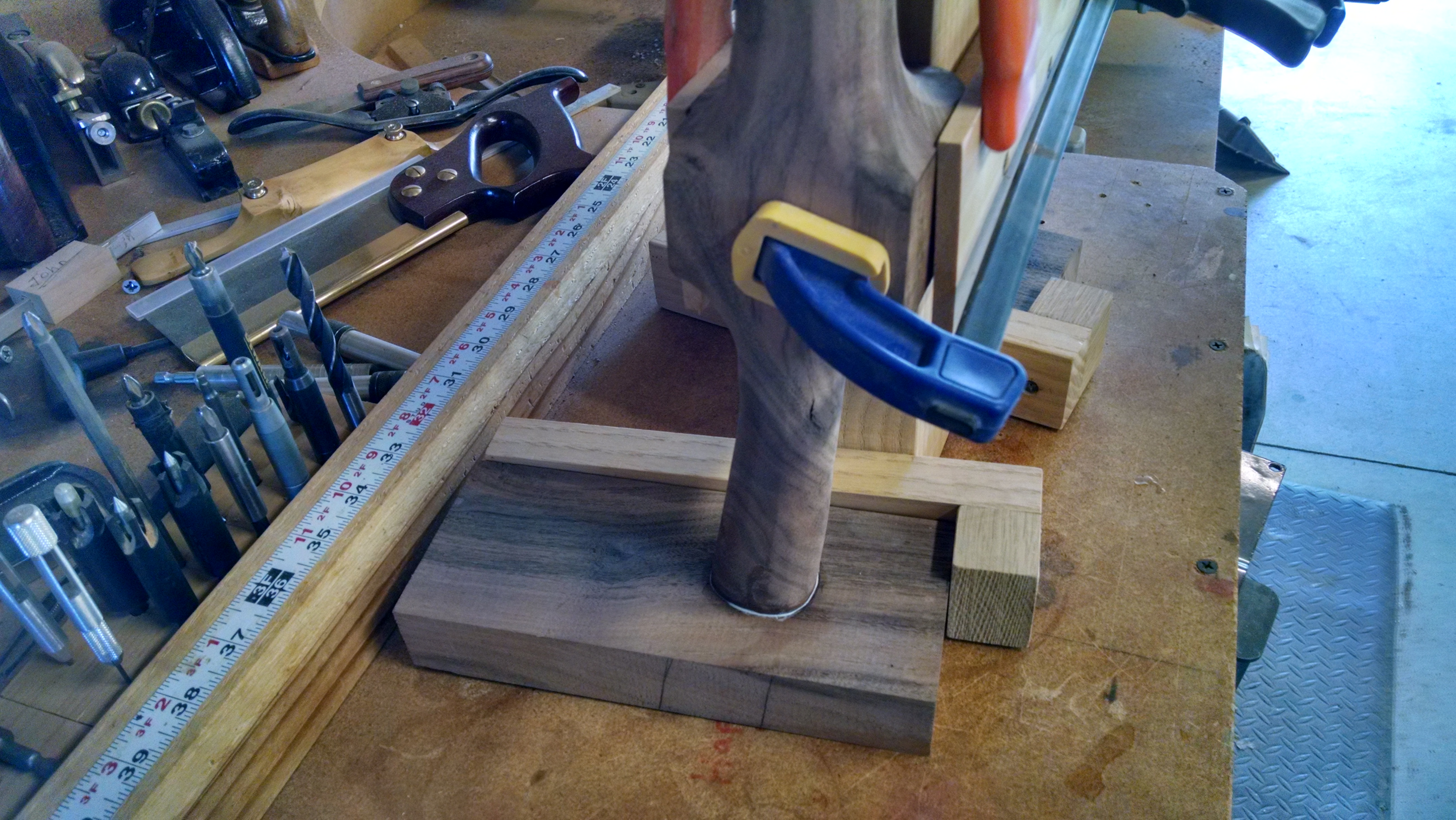

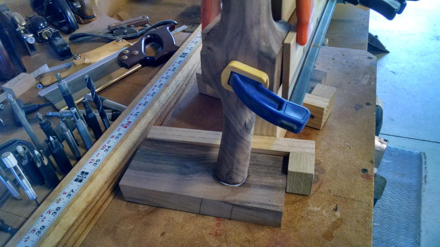

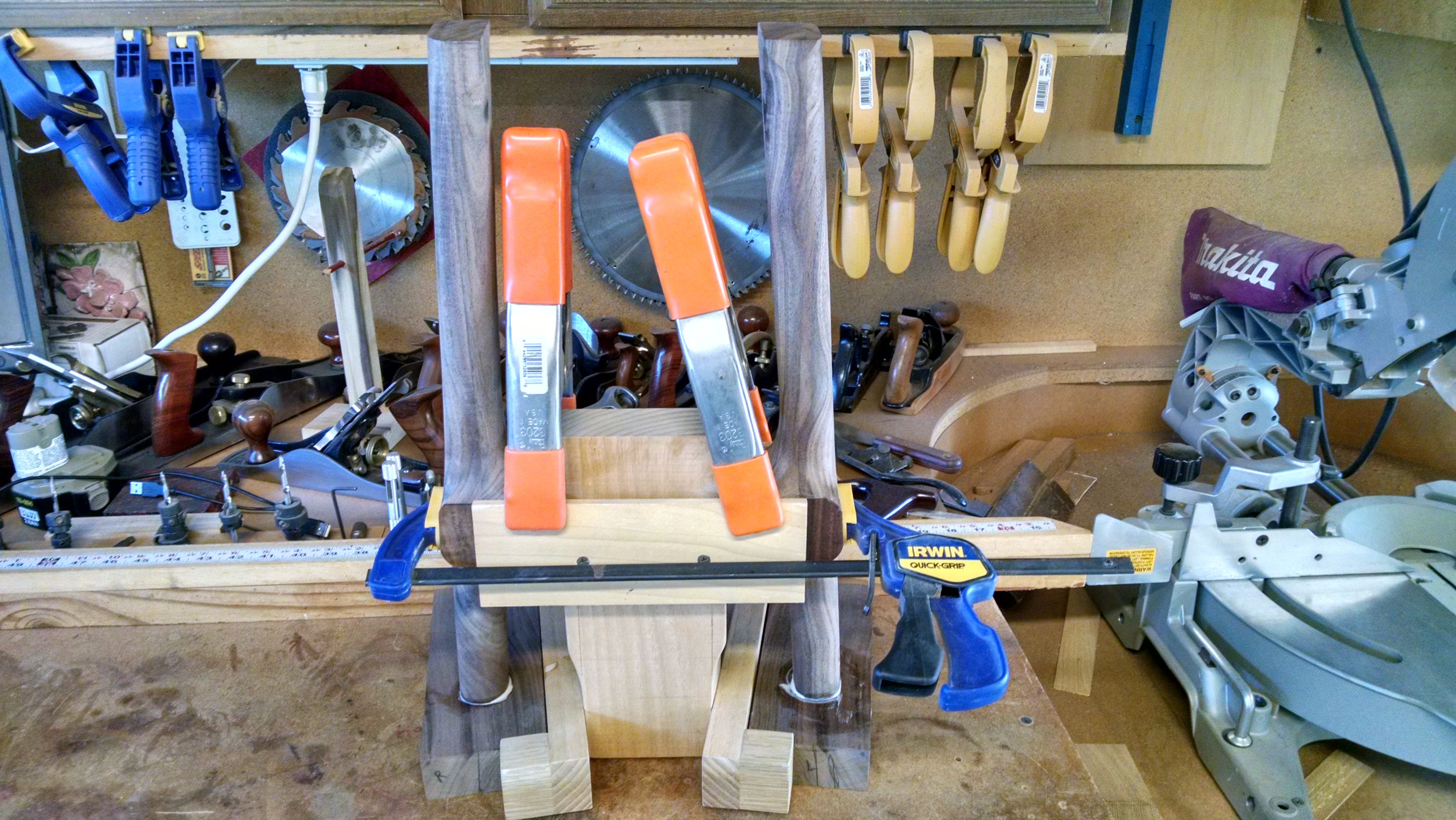

October 21, 201610 yr Author comment_80181 Now we have some rough transitions blocks that I glued on this morning. You'll notice with this chair there are a few add-on blocks to allow for the graceful transitions to the chair components. So rough blocks have to be glued in key locations to allow for a sweeping curve to flow into each chair component, these blocks will eventually be shaped to flow into the underside of the arm rests. These legs are shown upside down with the blocks actually glued to the tops. My jig below cants the arm transitions out six degrees. When you get into these chairs, and really many other types of chairs, you'll find that a common thread angular measurement is "six degrees". I do not know why, all I know is that it looks good, if anyone has any enlightening words on the whole "six degree" thing with chair building, fill me in please. Next image is just a close up of the arm transition blocks. The transition blocks are screwed and glued, the actual arm will be glued only the transition block pad. Report
October 21, 201610 yr comment_80184 Man John, the jig/ fixture is too complicated for me, let alone mating these sub-assemblies to the main component. The grain just never quits no matter what part you're making. Love the week-ends when you have time in your shop! Report
October 21, 201610 yr Author comment_80186 9 minutes ago, Grandpadave52 said: Man John, the jig/ fixture is too complicated for me, let alone mating these sub-assemblies to the main component. The grain just never quits no matter what part you're making. Love the week-ends when you have time in your shop! I always say Dave, us woodworkers are just a bunch of schmucks, we aint nuttin with out grain, the wood speaks for itself, we just help it sing a little. There is some wood you could just slab out, polish it, and hang it on a wall and your done, Claro is one of them, the Claro makes me look good. It's easy to make a successful project with beautiful wood. Report
