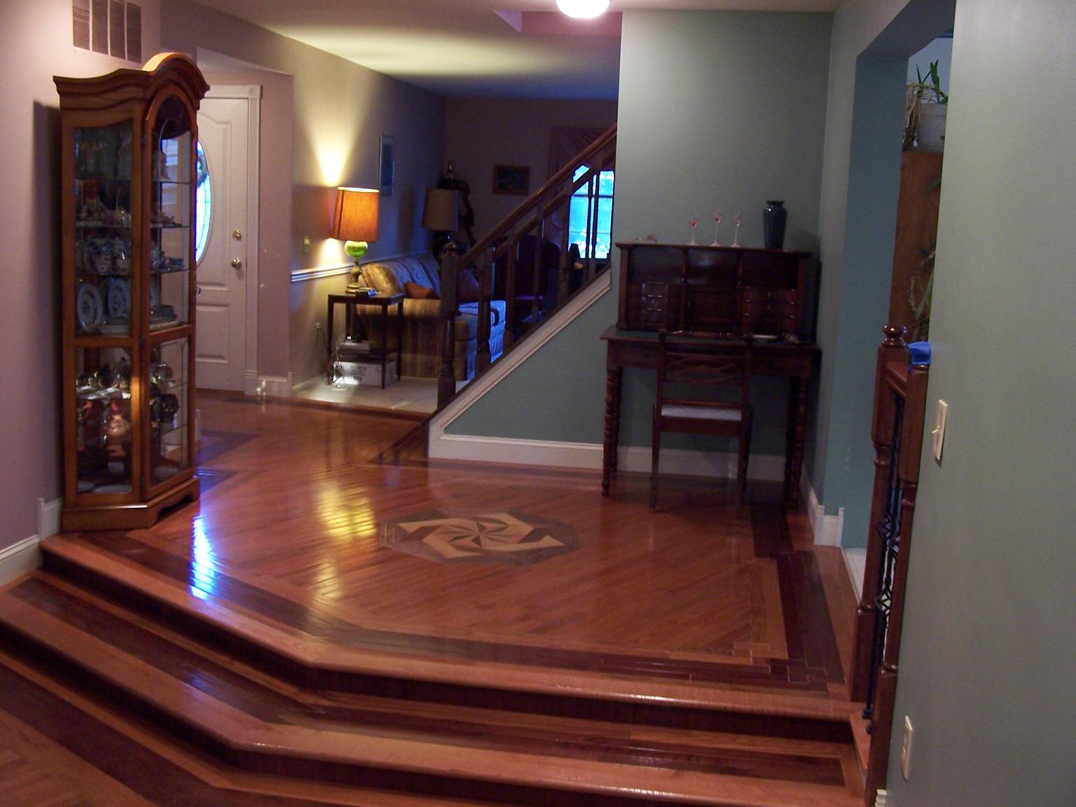

Indoors to the yesteryear project...
found a couple of better pictures of the medallion...
Absolutely gorgeous...VERY high end look...
If that entry was mine, I'd make people come in the back, then escort them to the front to view or at least have those little Tyvek slippers to put on over their shoes before walking across.
It would be like walking on the Mona Lisa...which would bother me less.:P

@Stick
What did you use to lay out the pattern?  A Cad/Cam program or trial & error?
More likely sheer experience?
I like the 3d effect.
Wife is now thinking a lazy susan would look great with that design.
Probably well above my skill level/pay grade
smitty
overlay the material into a design..
adapt off of existing designs... (often several)
already made veneer templates of different species and then scaled to fit...
or here.. this is what I want only different...
VOE fits in here someplace...
but there wasn't enough of everything so I stretched what I had using poplar veneer made to look like ebony to give it the 3D look...
because the finished medallion didn't look right  (wrecked angle/Fibonacci thing) I added the walnut to increase the size and to keep the medallion from blending in...
the walnut was left over flooring from a gun cabinet that was done to look like box car siding...
the walnut was surface damaged/distressed so I scorped it to camo the damage...
