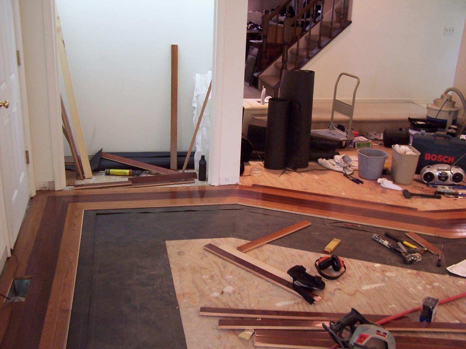

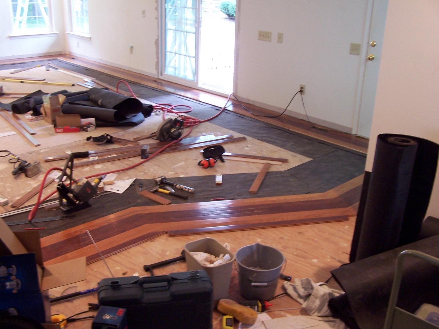

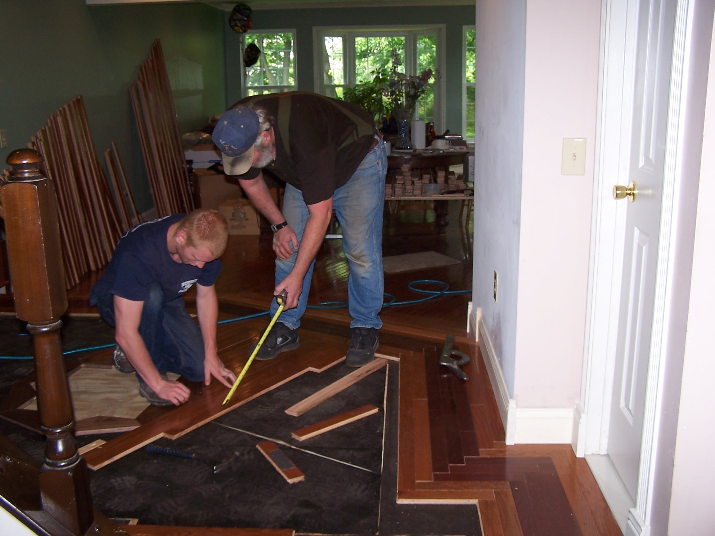

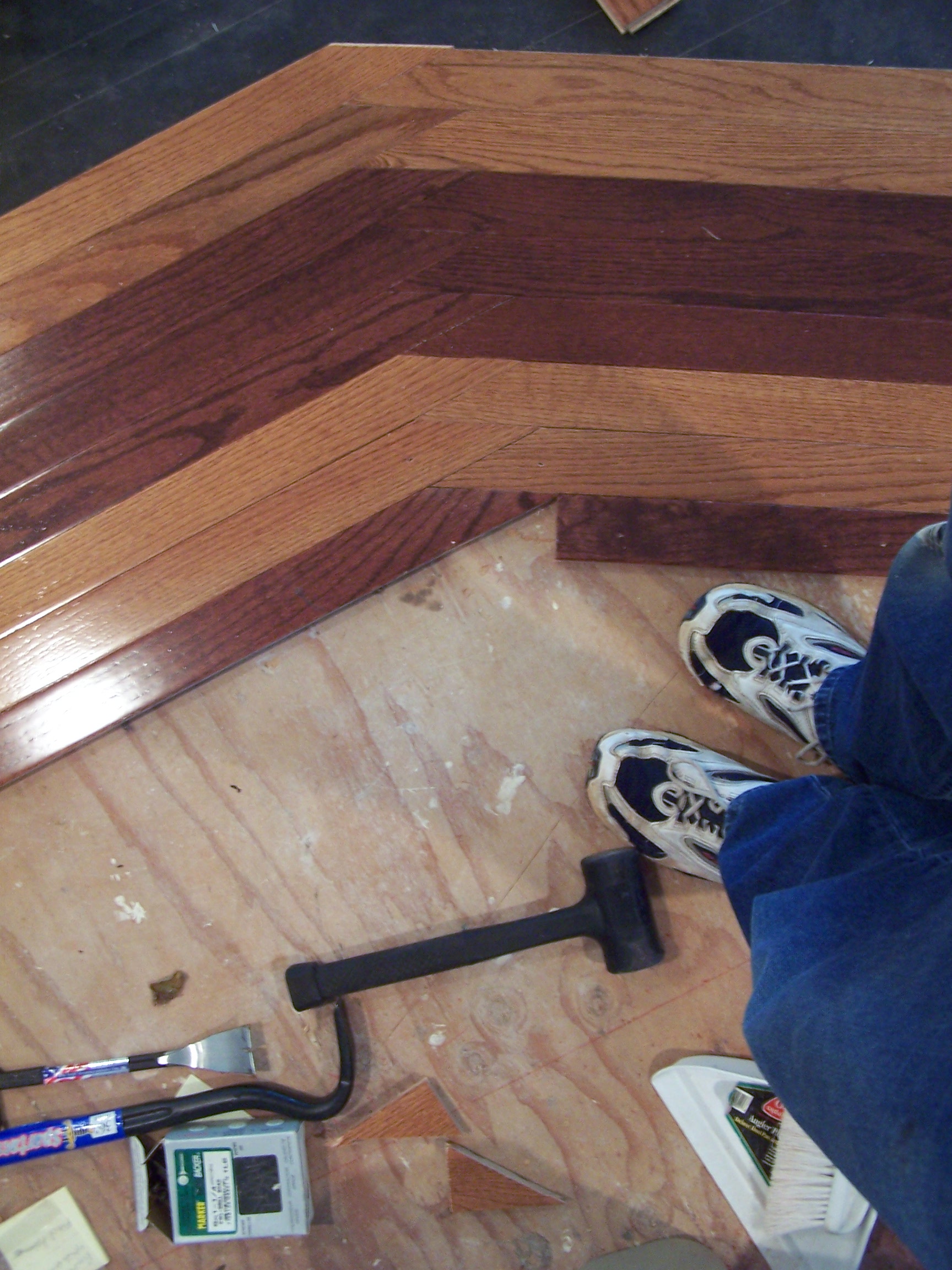

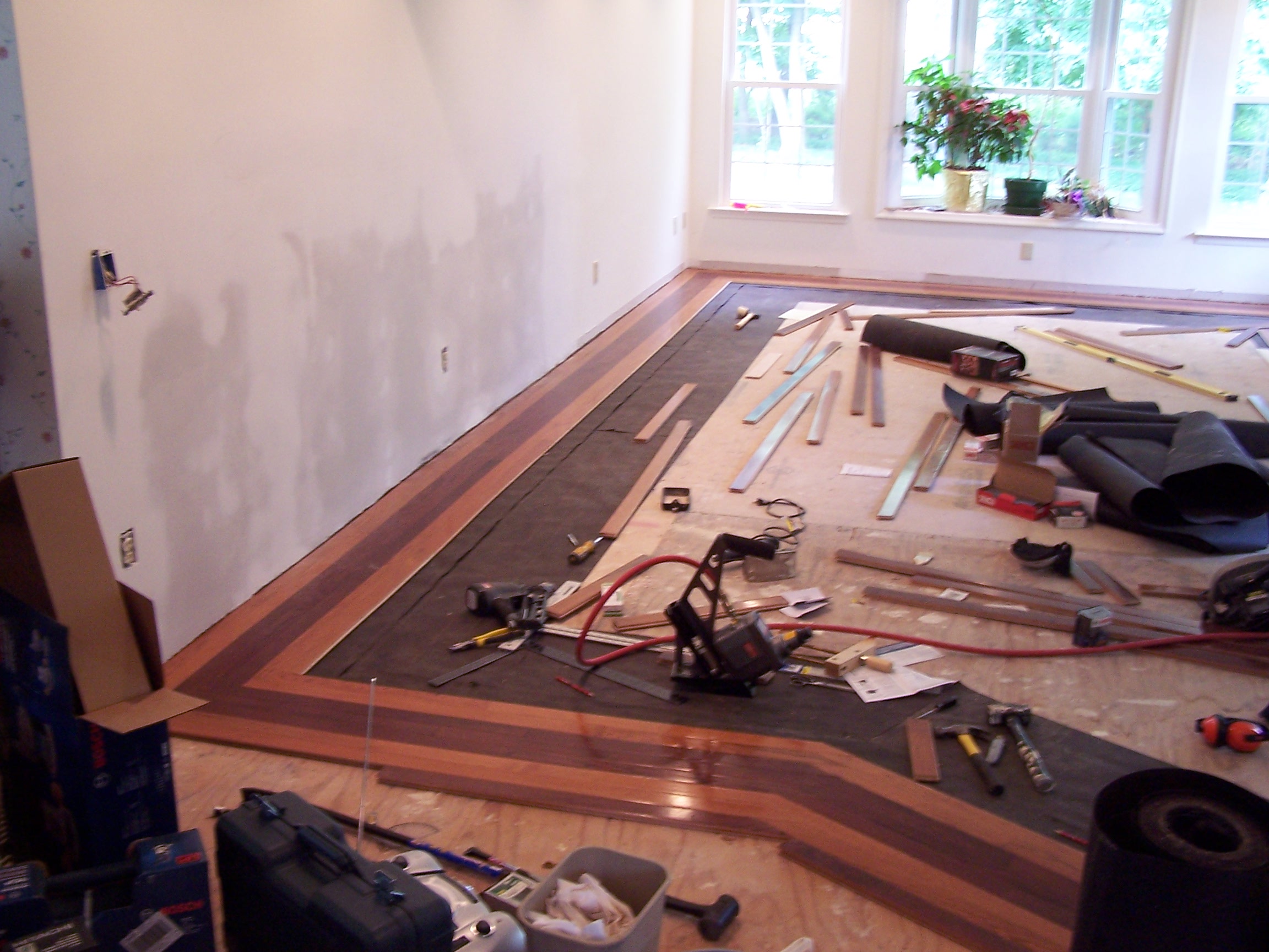

October 13, 201610 yr Popular Post comment_78737 teaching the customer's nephew some how to... here we have layout in a way out of square nothing straight room... installation and comping angles to get aesthetics... the kid (16YO) was great... smart.. listened well and had the ability to think 3D+ and paid attention to detail...... 1st week went kinda .. well it went... when his mother saw what he did... did he ever get busy... the DW work was to flatten the walls and give the illusion of straight... flattening the floor was a chore.... closet and SGD were added.... Edited October 13, 201610 yr by Stick486 Report
