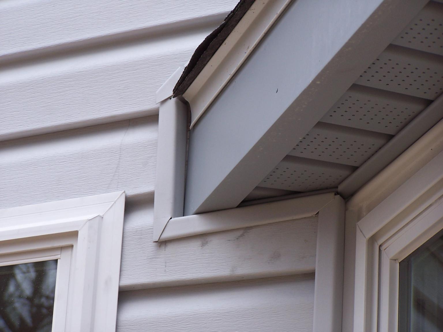

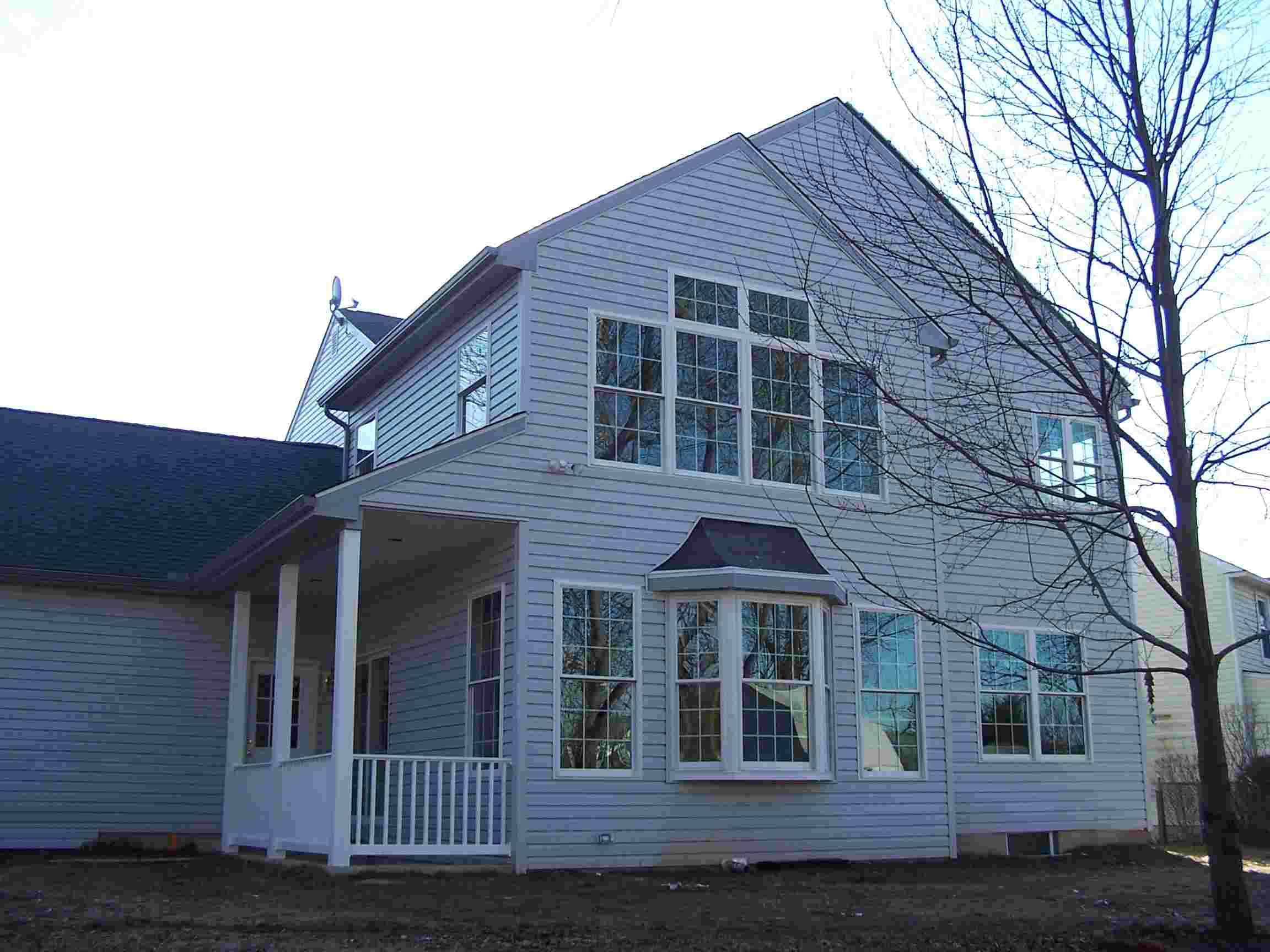

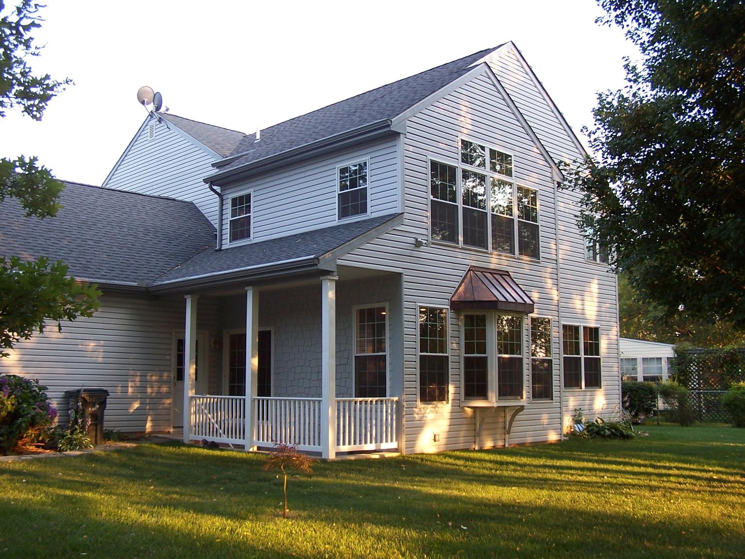

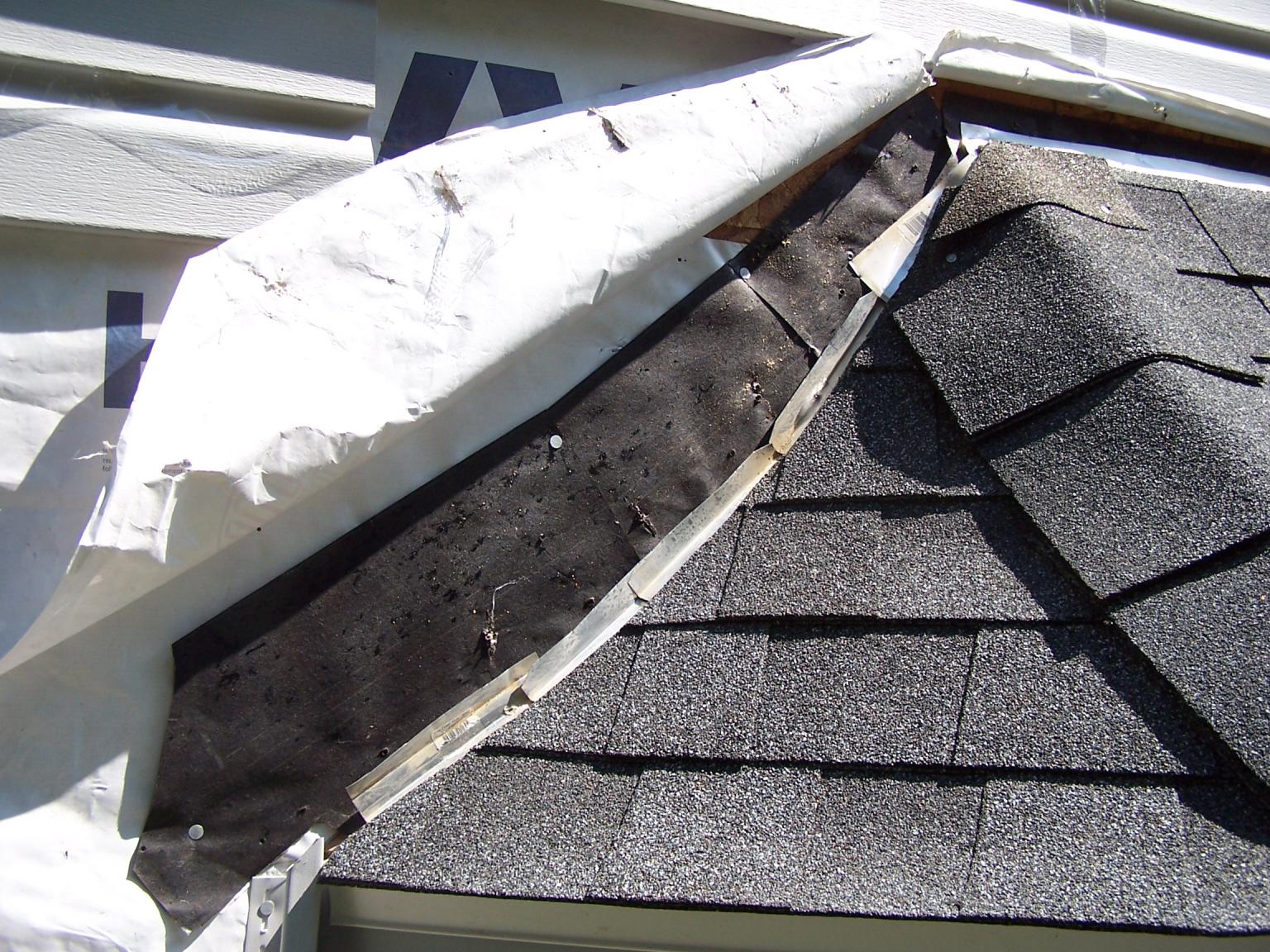

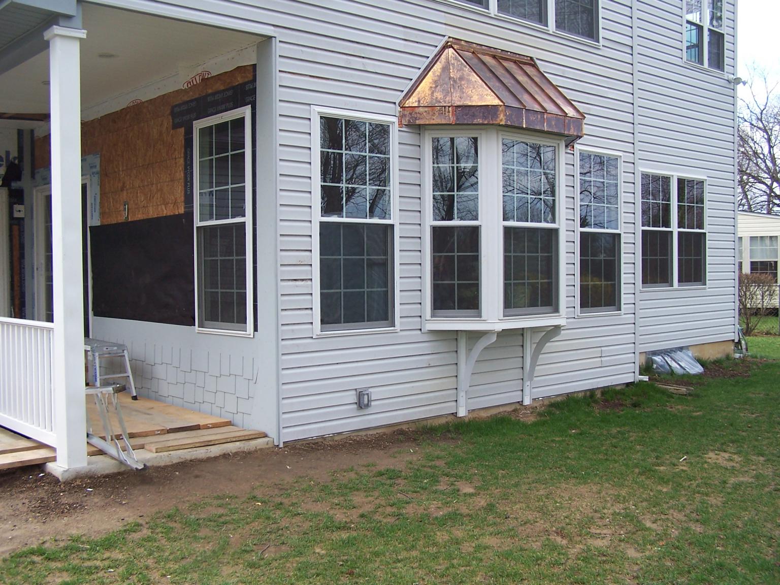

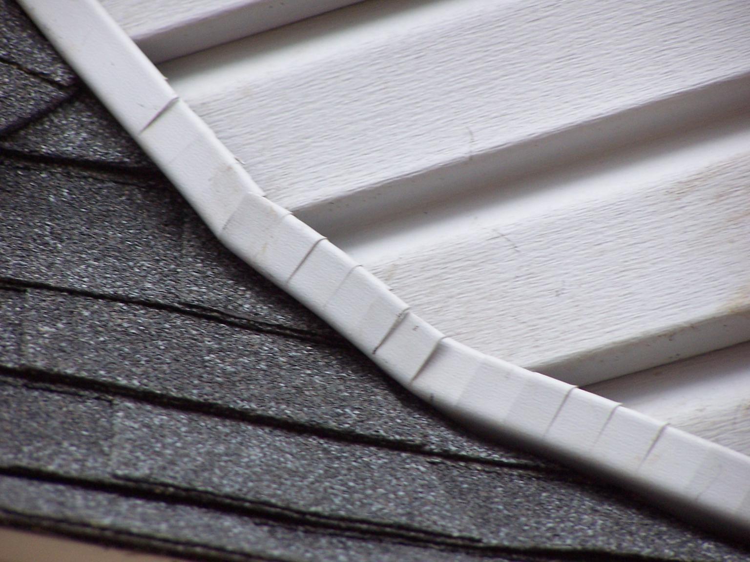

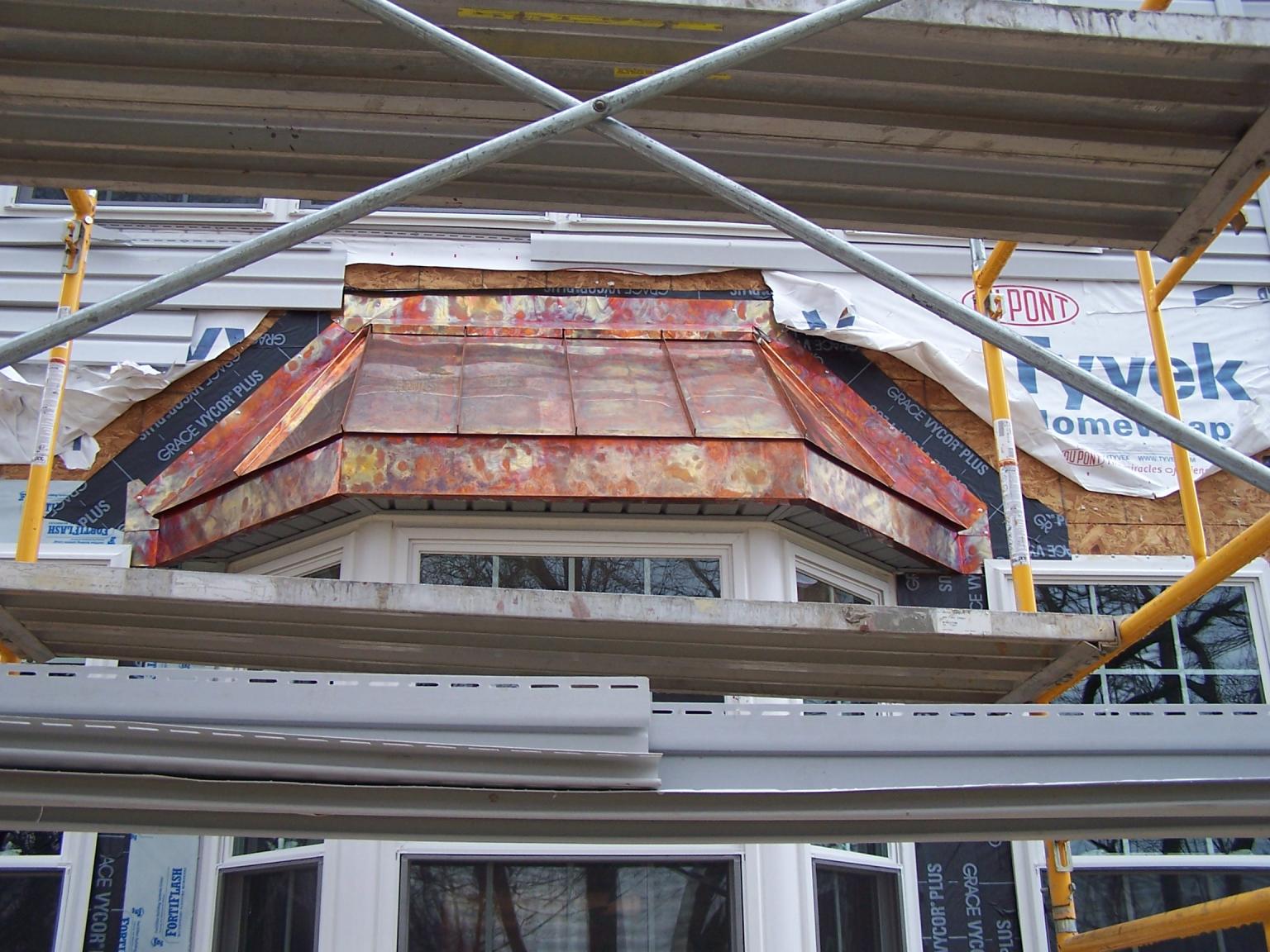

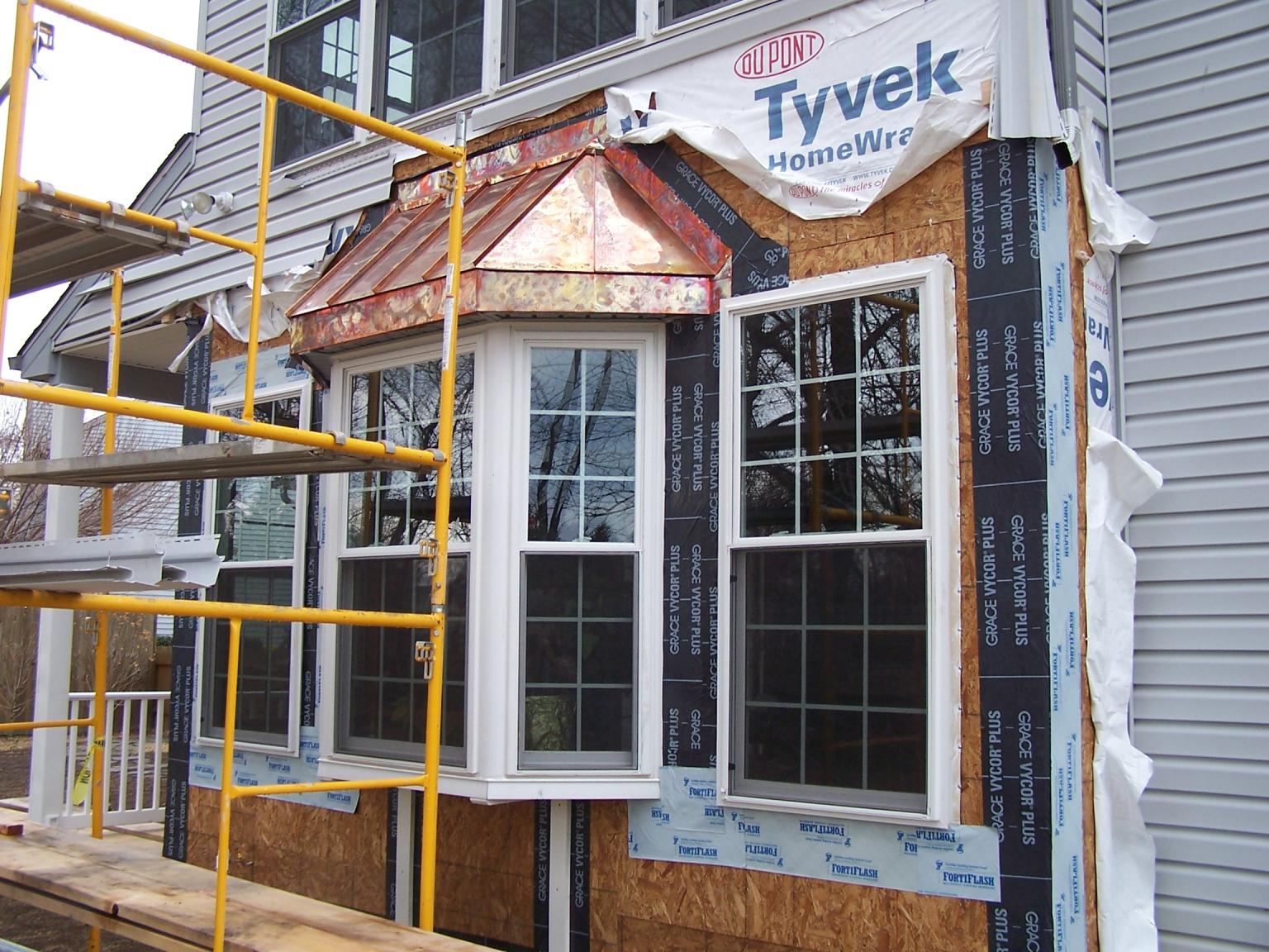

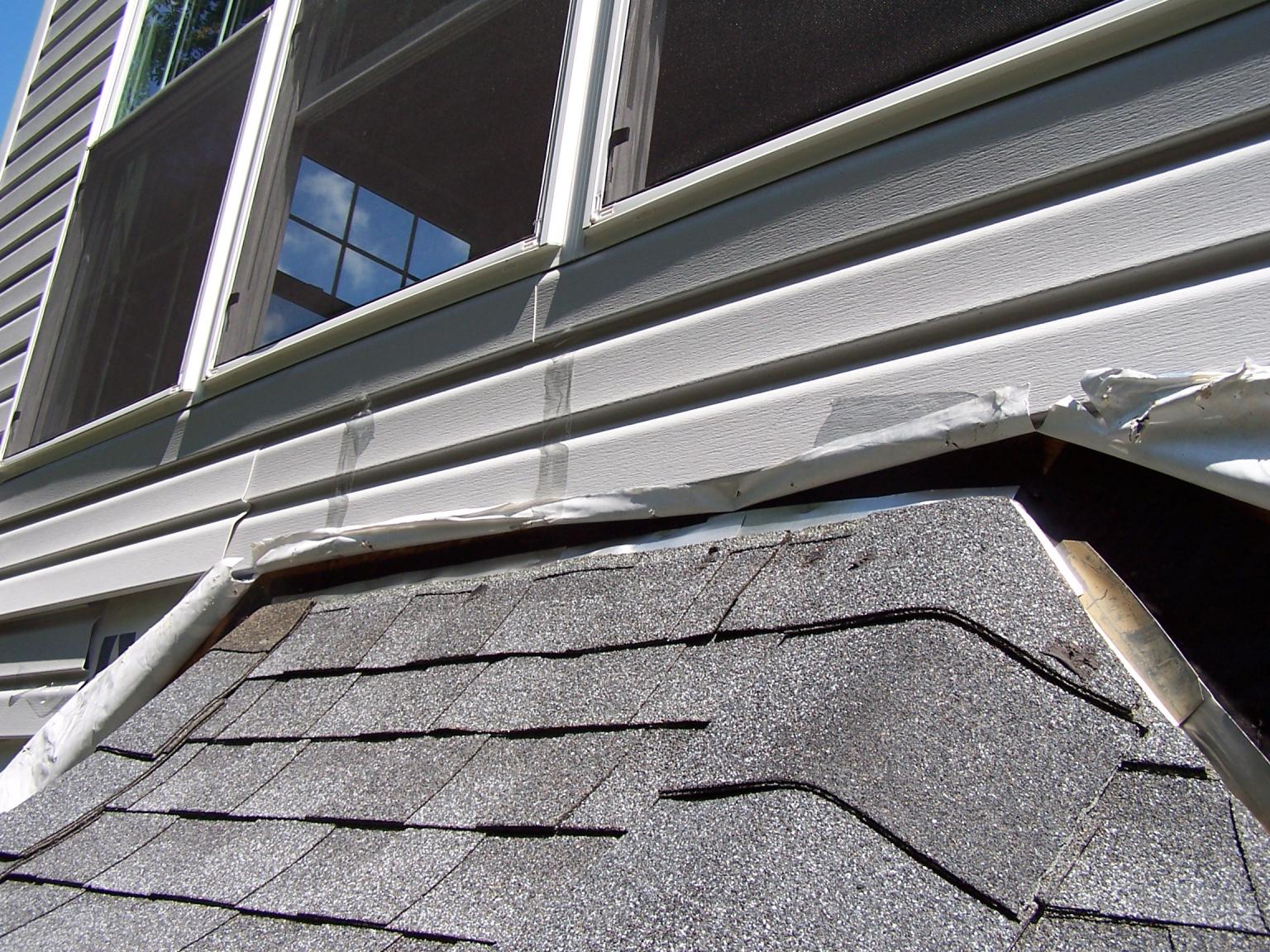

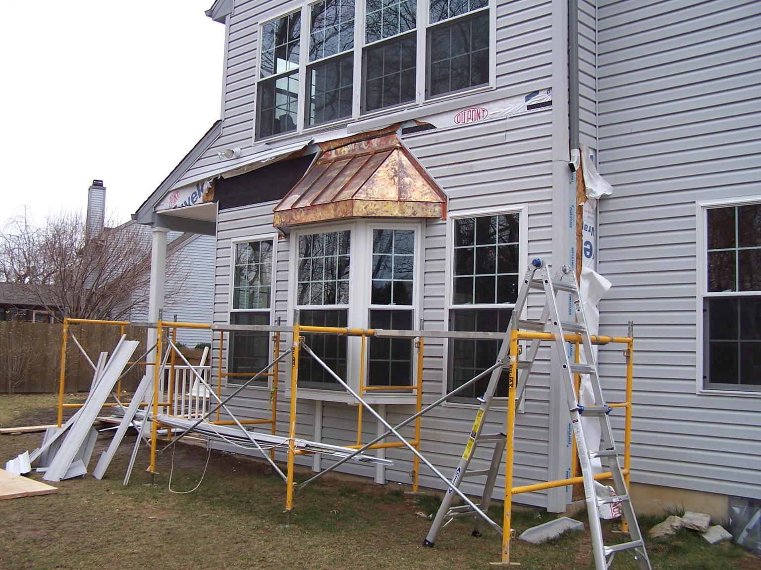

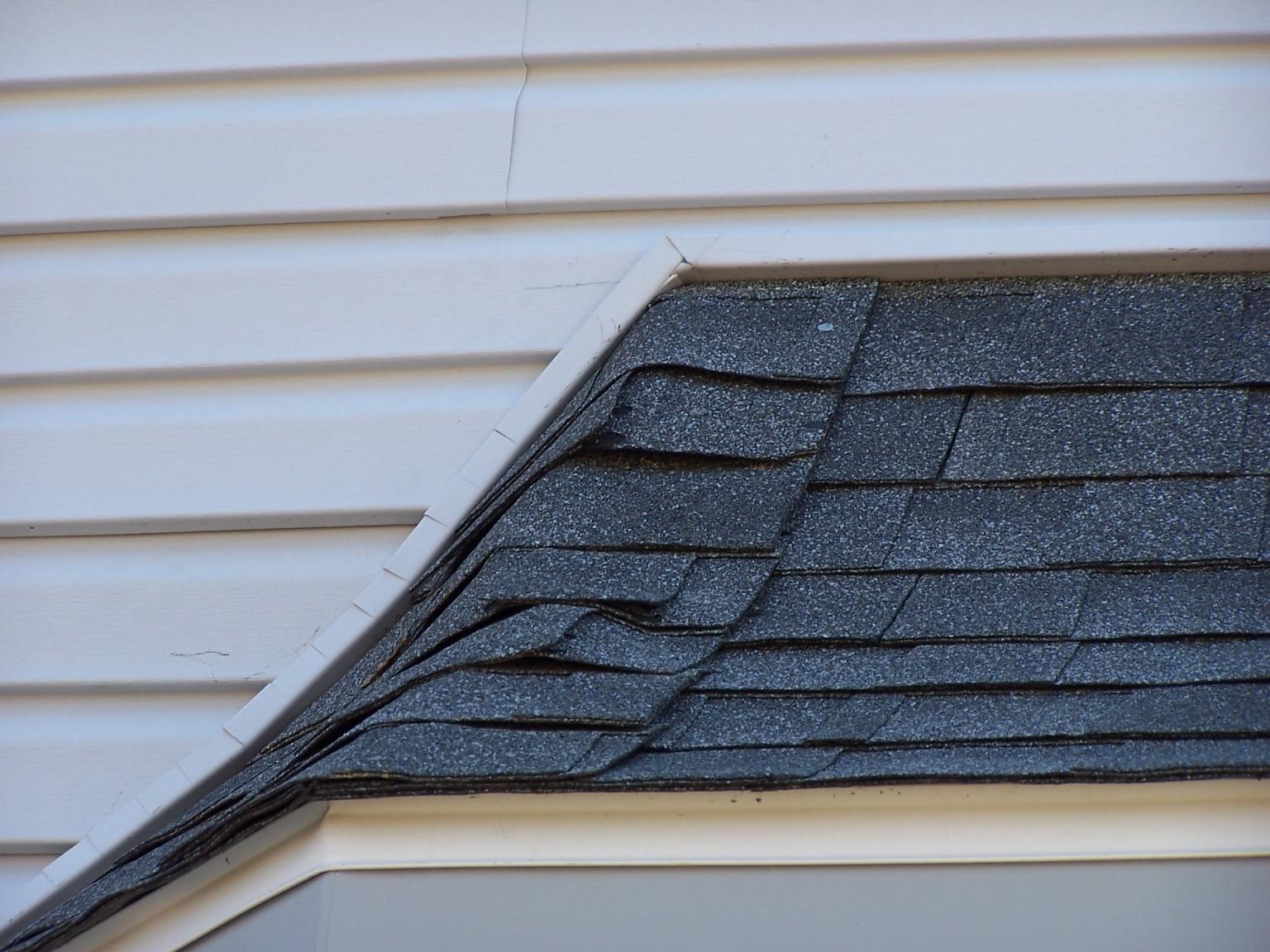

October 13, 201610 yr Popular Post comment_78722 Here is a project I did (yesteryear) cleaning up after somebody else.. Windows leaked air and water.. (no flashing) Limited house wrap... Bay window was falling out of the wall.. All of the windows were not coplaner... Poorly done/incomplete flashing on the bay... the change... my copper work... the corbels are steel... midway... Edited November 20, 20179 yr by Ron Dudelston tags added Report
October 13, 201610 yr comment_78724 Really nice ice work...love the copper and the seam work! Did you solder or just crimp? Certainly added character to the house. Report
October 13, 201610 yr comment_78725 VERY nice work. Exceptional. Love the copper and the iron corbels. Did/do you need to redo all the windows? Report
October 13, 201610 yr Author comment_78727 8 minutes ago, Grandpadave52 said: Really nice ice work...love the copper and the seam work! Did you solder or just crimp? Certainly added character to the house. thanks... modified locking double fold... sorta like a snap lock.. Report
October 13, 201610 yr Author comment_78730 11 minutes ago, Gene Howe said: VERY nice work. Exceptional. Love the copper and the iron corbels. Did/do you need to redo all the windows? thanks... all 32 of them... the set above the bay were the most difficult... Report

October 16, 201610 yr comment_79222 nice job!!!! next time you might want to shine the copper up evenly so it ages and patinas evenly. Report
October 16, 201610 yr Author comment_79235 46 minutes ago, DRAGON1 said: nice job!!!! next time you might want to shine the copper up evenly so it ages and patinas evenly. that was deliberately done w/ a torch and clear coated w/ Rexthane... everybody has the green patina... be different... Edited October 16, 201610 yr by Stick486 Report

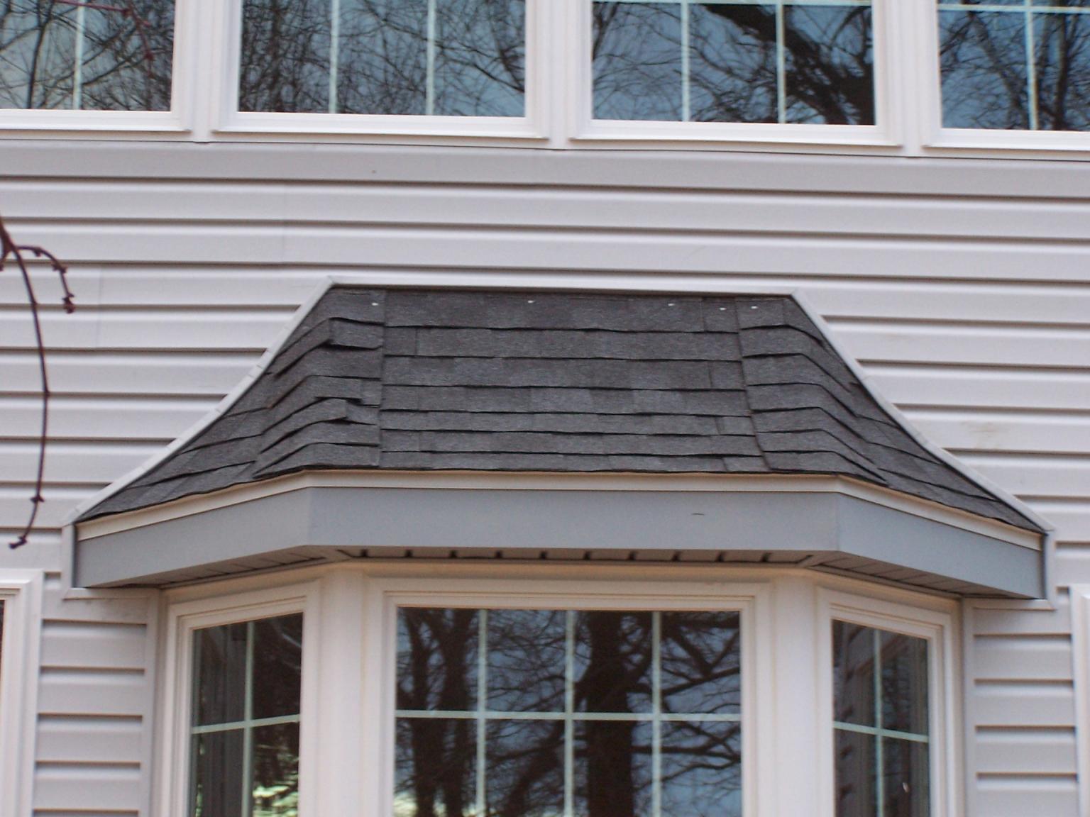

October 21, 201610 yr Author comment_80028 this is where this started.... you saw earlier how the flashing was done which proved to be a water let and you can only guess what happened to the interior... the fit and finish help w/ the water letting too... also note the soil up/over the siding and at the basement window sill... Report

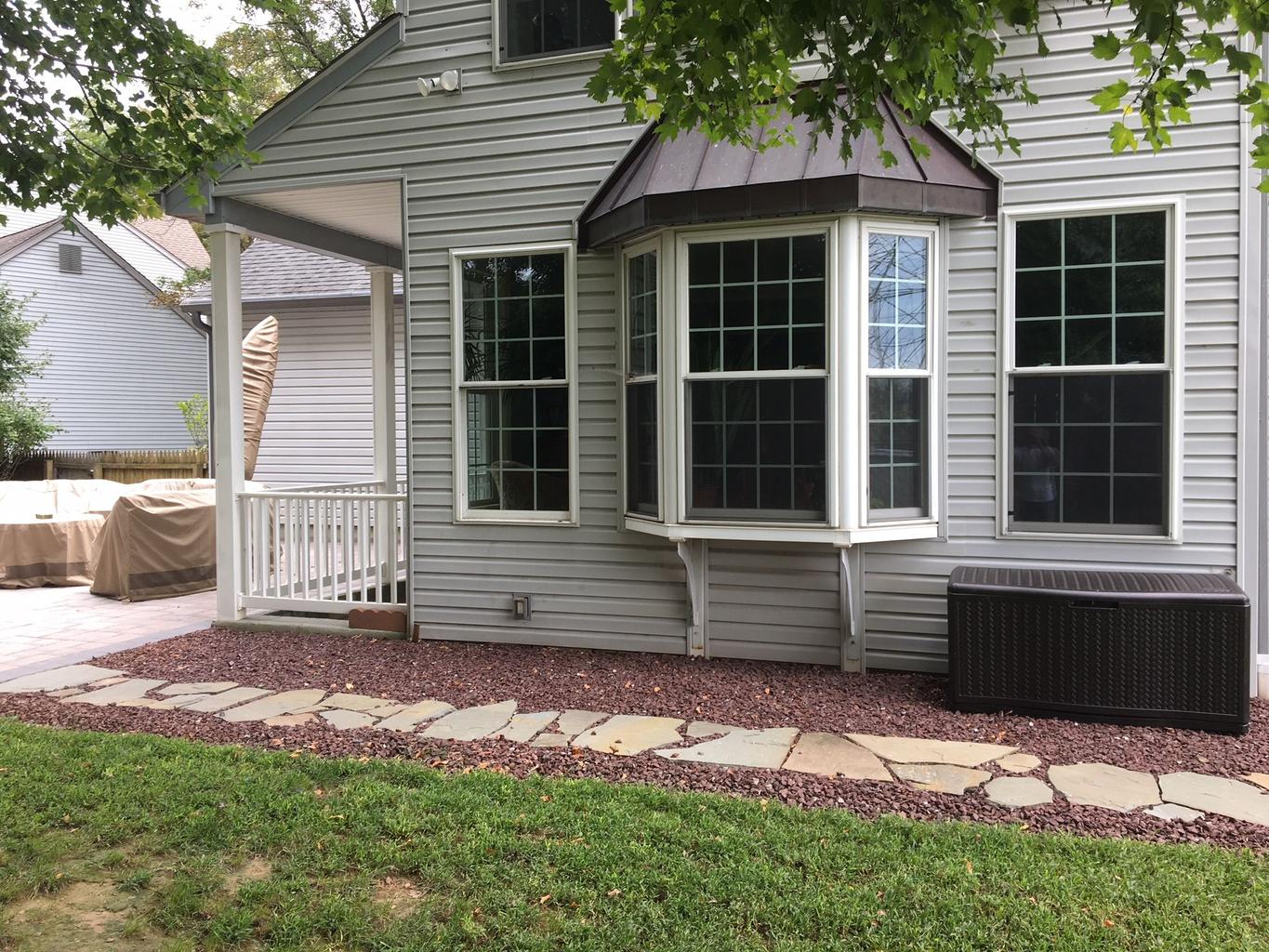

December 2, 20187 yr Author Popular Post comment_168240 found a picture of the finished bay window portion of the yesteryear project series... Report
December 2, 20187 yr comment_168246 That was surely a haphazardly done job. Great improvement Stick . Didn't even have support under the bay window. You can be proud of this. Report
