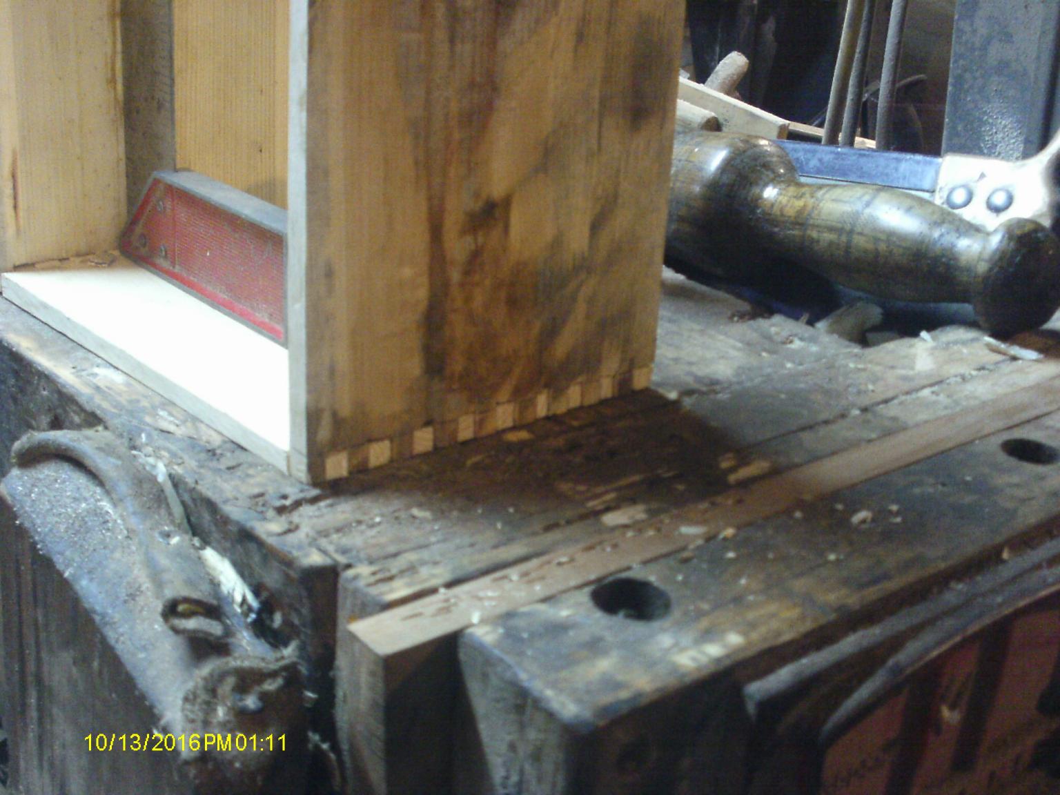

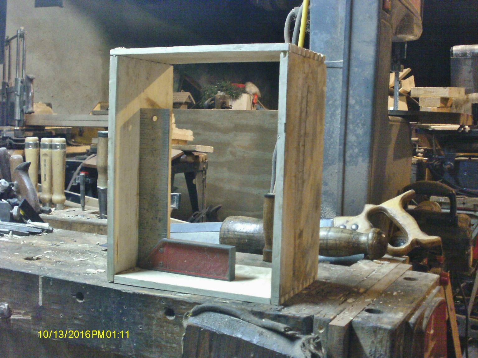

Used a few tools until two sides were done.  Used those to mark where the fingers were on the end pieces....
Until I had all four sides done.     Finger joints didn't look too hateful..

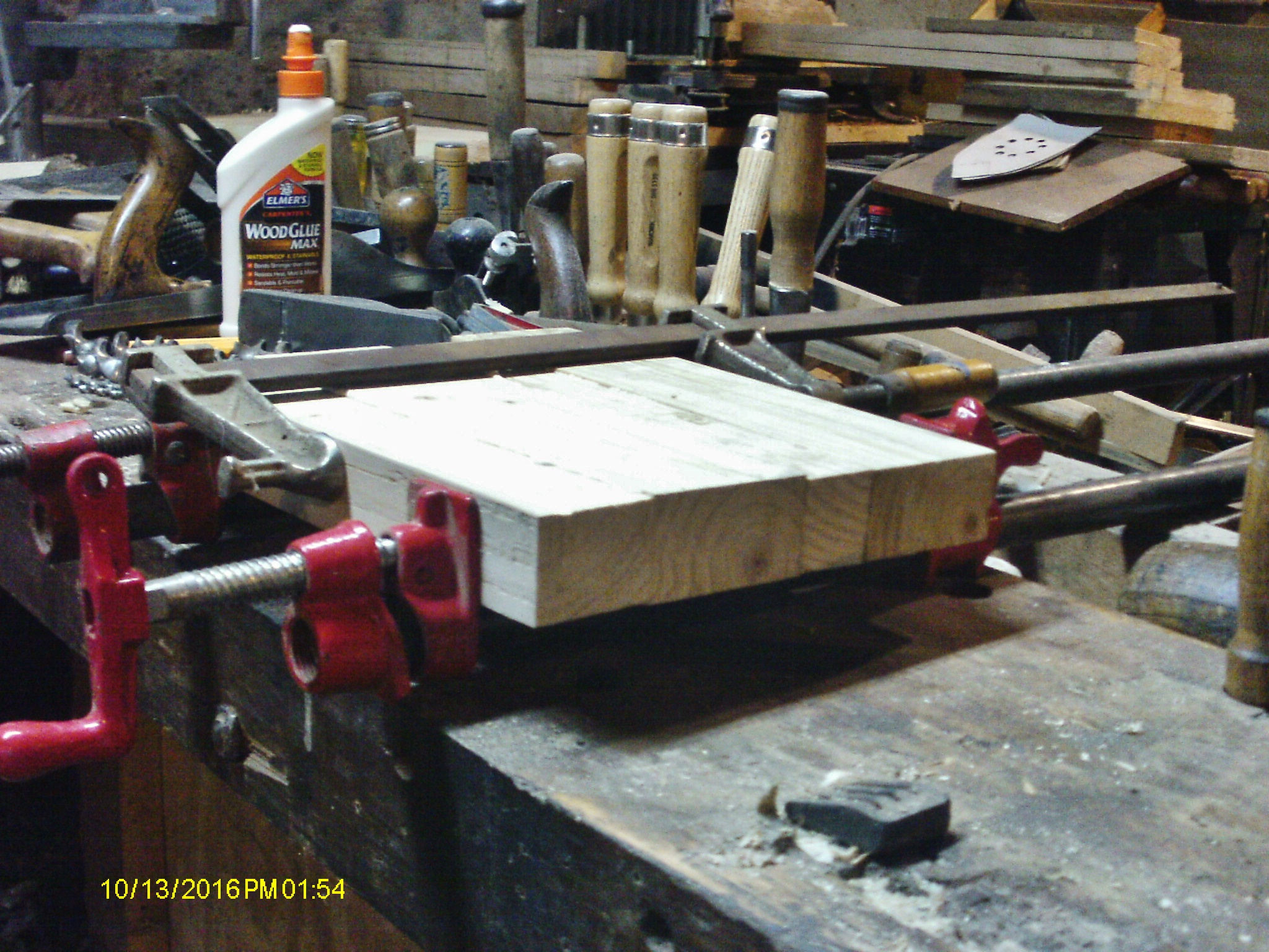

Resawed a few blanks for the bit holders...Didn't have a single chunk wide enough, soooooo
Made enough blanks to make two glue ups.   But, they needed a bit of work, before I could clamp a set up as a glue up..
Stanley No. 5-1/2  seemed to do the job.   Got the first set into the clamps...
 I can come back tomorrow, and level this out.     Then take a few auger bits, and the bit brace, drill down from one end.    At least until  The flutes can be covered.    After drilling a bunch of sizes, I can then cut away where the  top half of the holes  are.    But, only where I drilled out.    "Below" that point, I need a smaller sized bit to drill just for the shafts/shanks of each bit.  That way, the bits will stay put in the holders.   Have to leave enough room to extract the bit as need from the holder.   That way, I can tip up the end to remove the bit.  Clear as mud?    May just play hooky again, tomorrow.    Stay tuned....
