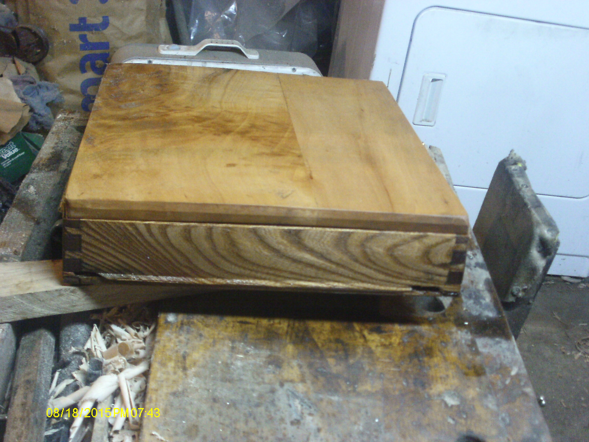

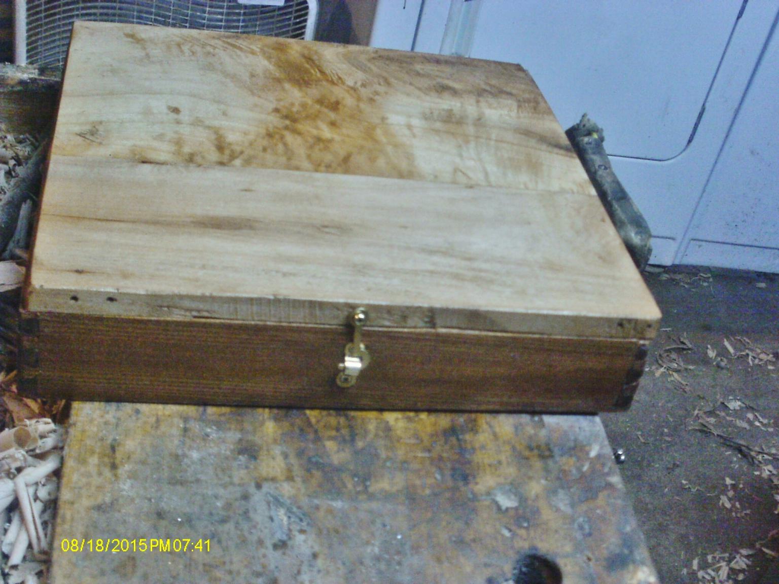

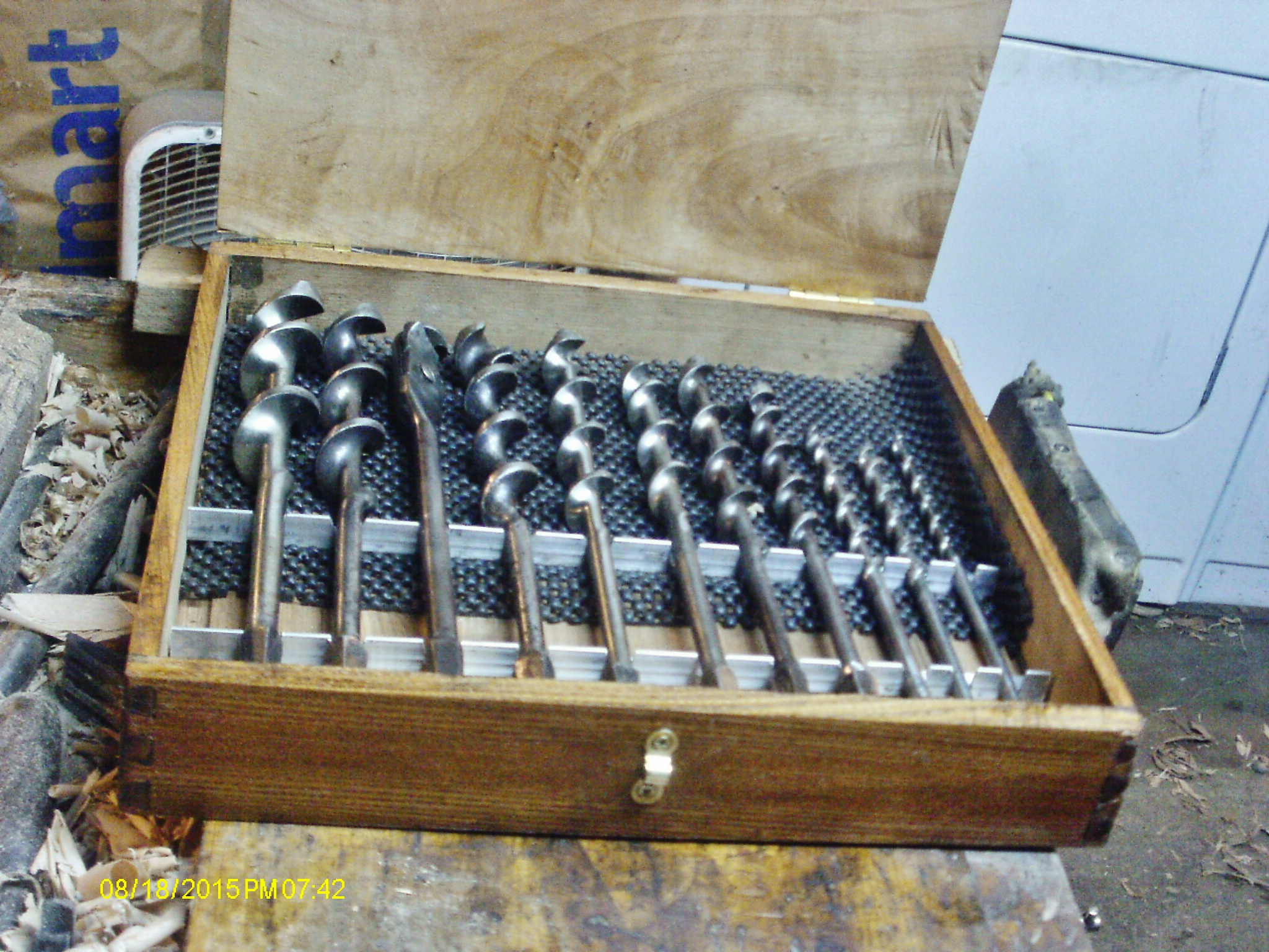

September 29, 201610 yr comment_76467 Well, a while back, I made a box to hold what was then my small set of auger bits.... Not that bad a box, and when you open the lid.. Not too bad. But, in the year since this was made, I have more than doubled the amount of bits I have to store. Might be time to build a new box? Wood supply right now is mainly Pine. The Problem? How to arrange almost 30( or more!) bits in one box? The "box" part isn't a problem, been wanting to do dovetailed boxes again, anyway. Bits go from the small #4 up to and beyond the #20 sizes, and about every size in-between. Maybe make a few "layers" of sets? Have a feeling I may have a while to plan one out. Might as well put the Single Brain Cell Sketch Up back on-line, and see what in can conjure up. As for the "old" box? Maybe I can find another use for it.......BTW: That HUGE bit in the second picture? It is a Craftsman #22. Maybe I can take it back to sears, for a new one? Report

September 29, 201610 yr comment_76503 I would go with multiple boxes. A box to hold them all would be a bit large and would have to be beefy enough to hold the weight. Report
September 29, 201610 yr comment_76507 deepen the box and add a tray... Edited September 29, 201610 yr by Stick486 Report
September 29, 201610 yr comment_76510 30+ augers is Lotta bits and a Lotta weight. How about a drawered box? Similar to a machinest's chest with a lid that drops down to make a small table. Report

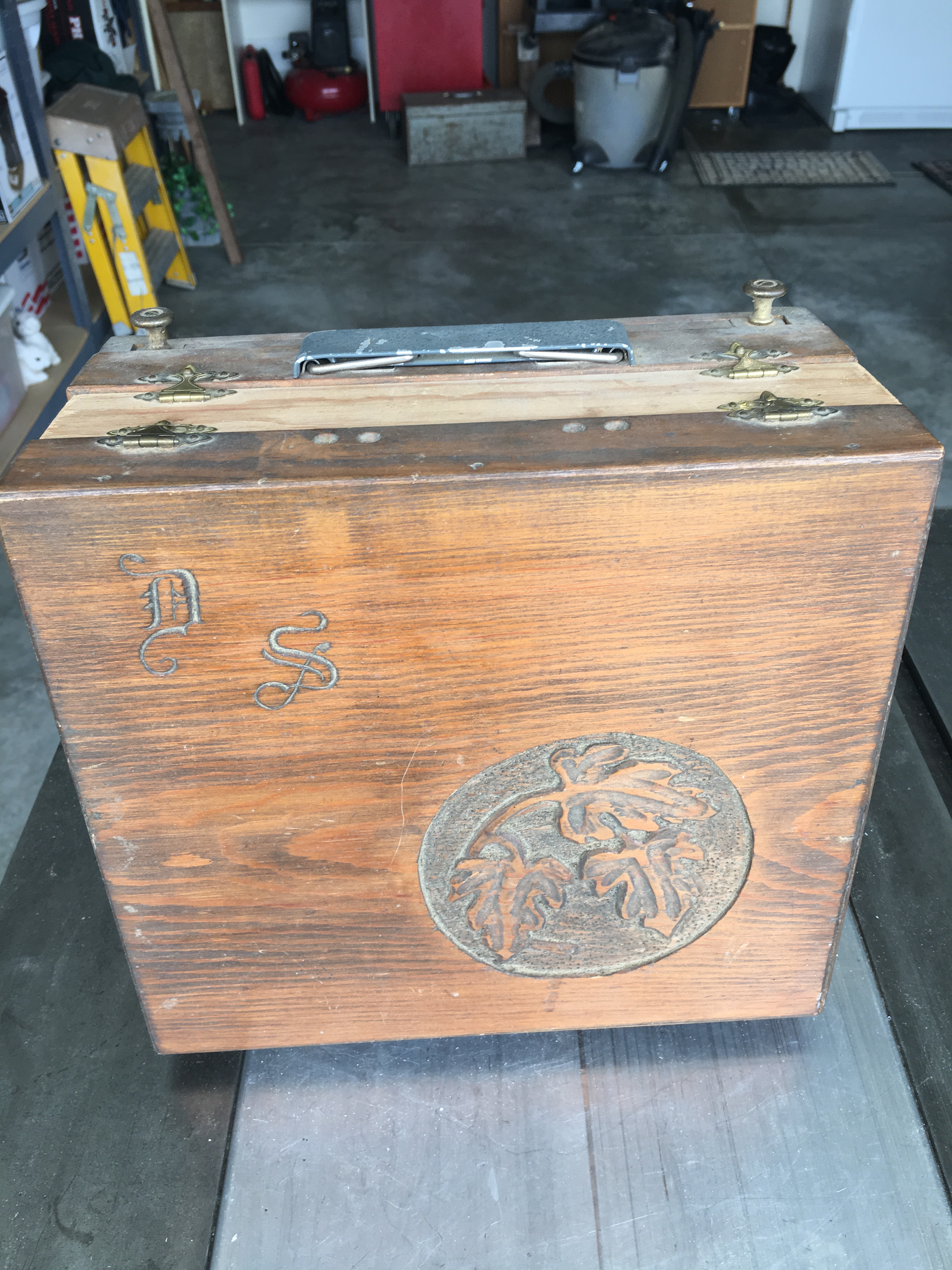

September 30, 201610 yr comment_76760 When I made a case for mine I made it like a briefcase with bits on both sides. Also wanted to keep the brace together and mounted it to the case. I do not have a pic, maybe make one today. You could use what you have and make another box bottom to match and mount it to the top of this one . Also Stick had a good suggestion, that is the way my forstner bits came in the case. Report

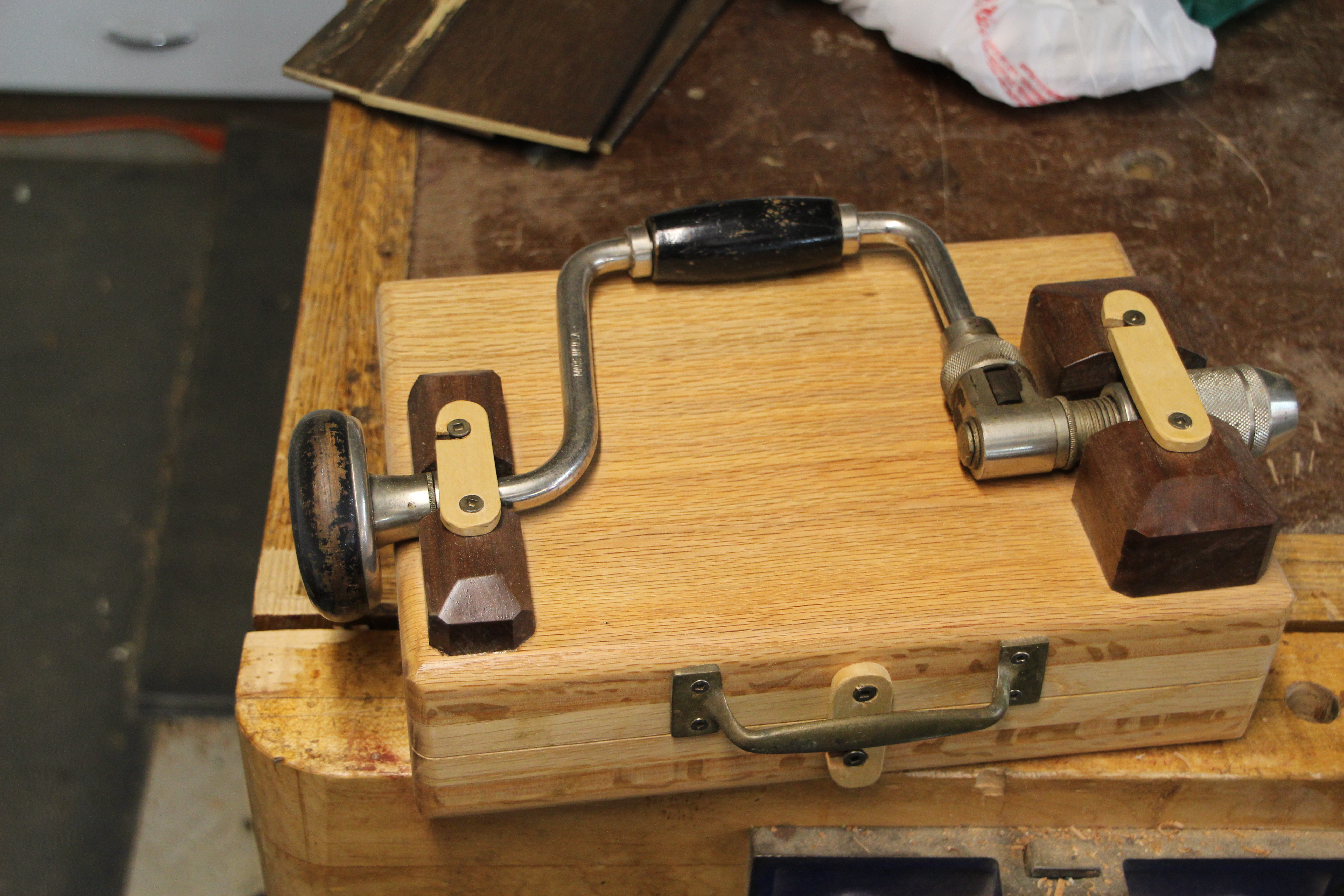

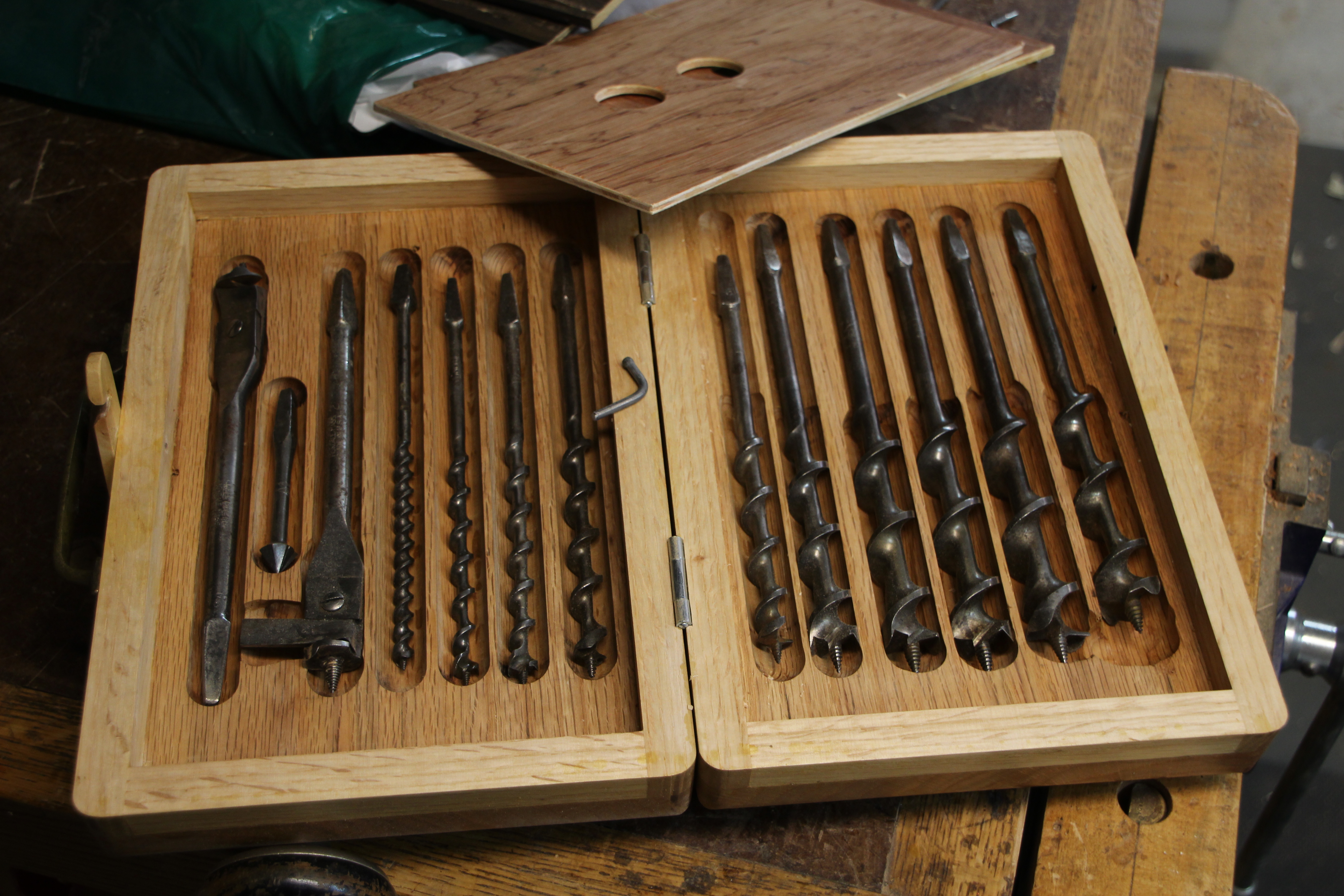

October 1, 201610 yr Popular Post comment_76806 Here is my drill case . The clips over the drill swivel to release the brace. and the case opens the same way. The inside has routed channels for the bits. Not a complete set just what I got with the brace. Also came with 2 extensions. Report

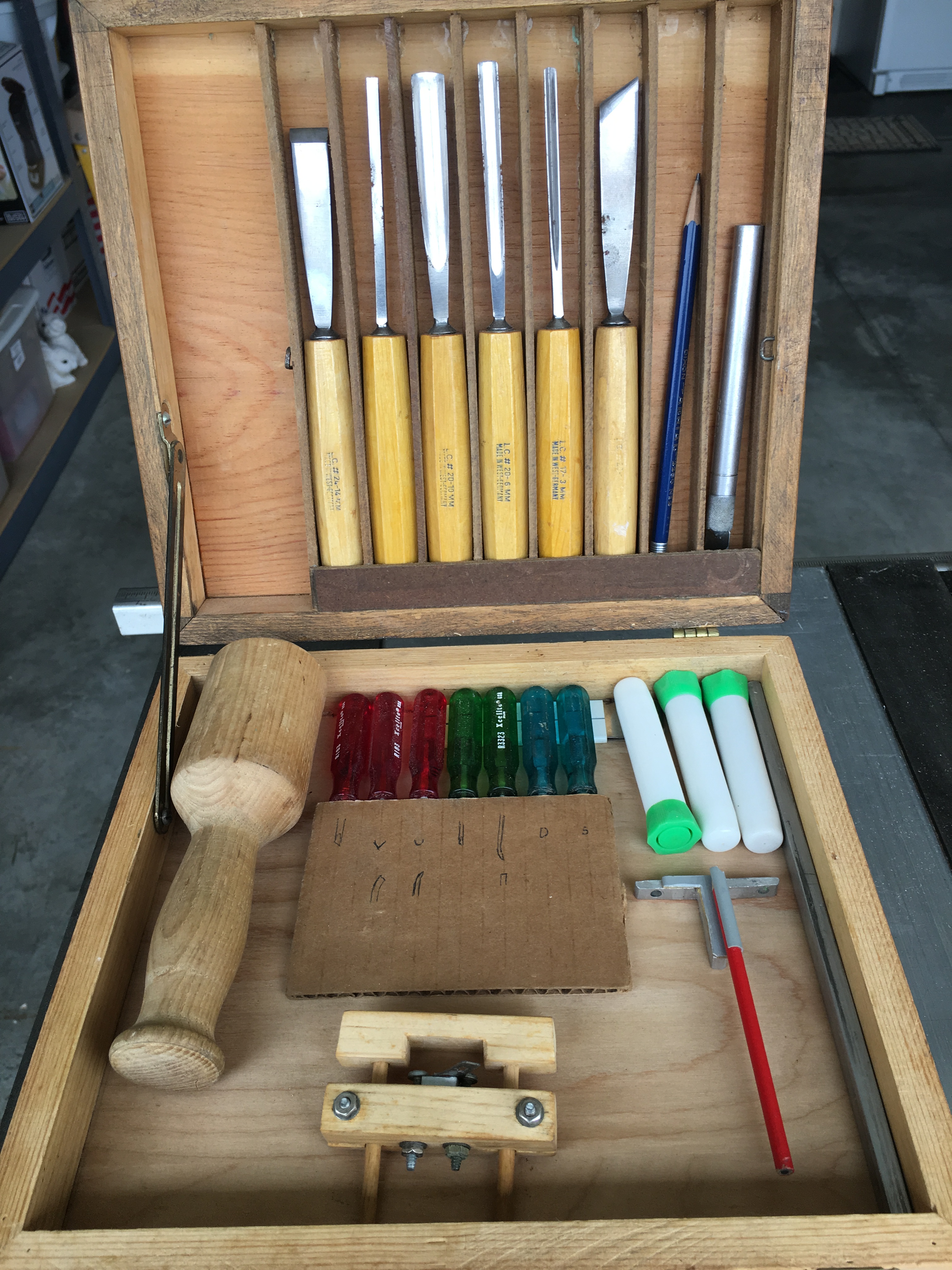

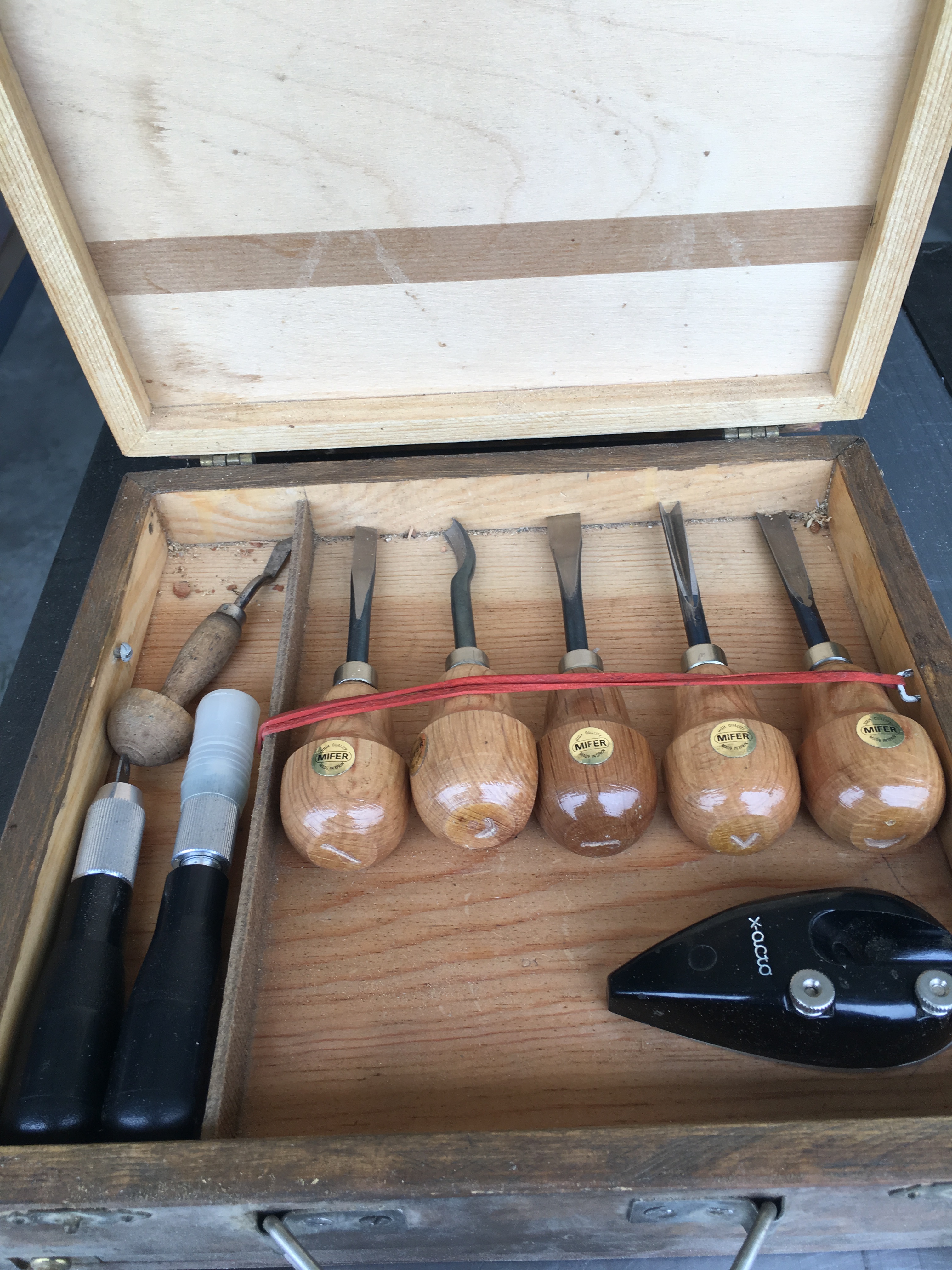

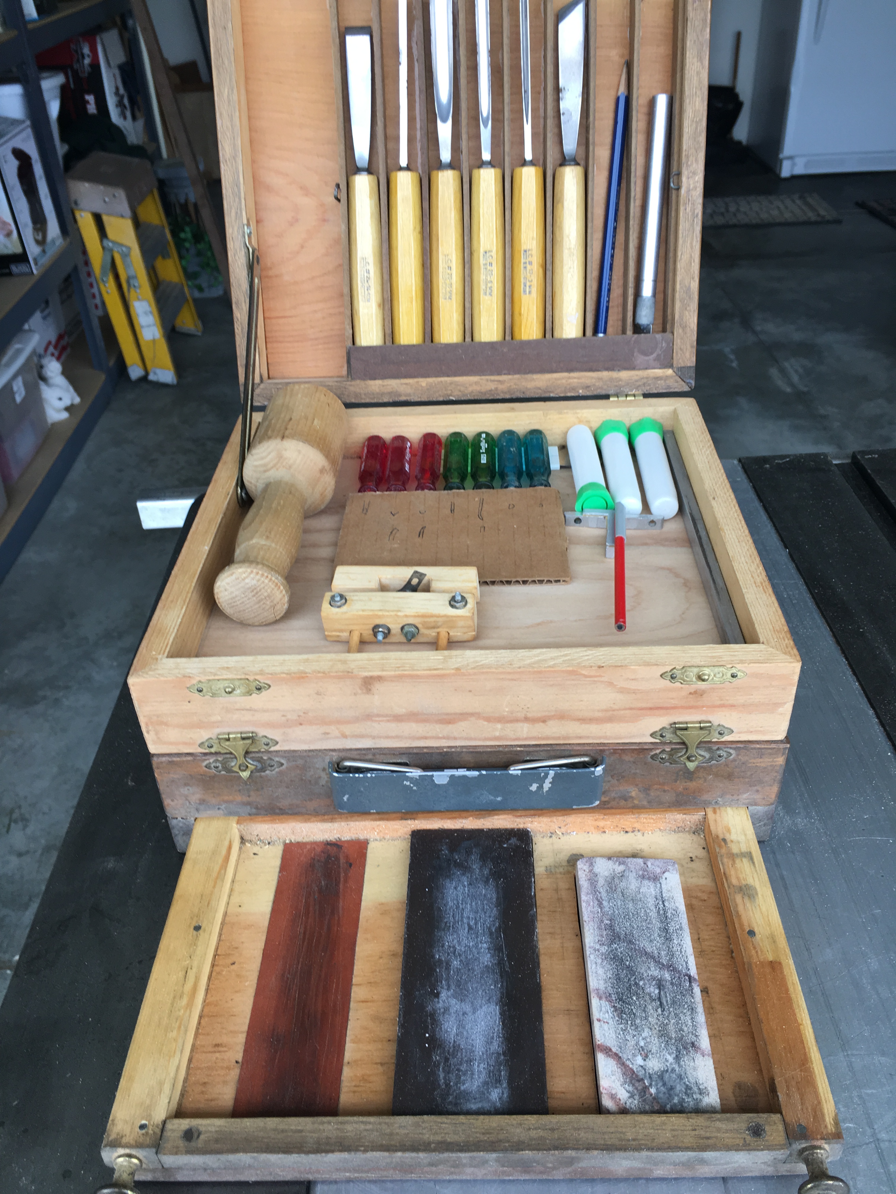

October 3, 201610 yr Popular Post comment_77142 Steve - Fifty years ago, before I had power tools or a shop, I was meeting with a wood carving group. I needed a case to carry my carving chisels, so I came up with this... I added some mini-chisels made out of small screw drivers. And the arsenal grew larger with a set of palm chisels , so I added a another layer... Then I added a drawer to accommodate the sharpening stones and a leather strop And the final package looked like this... The middle tray does not line up perfectly with the rest of the box, but as I said before, this was before power tools and a shop. Dave. Report
