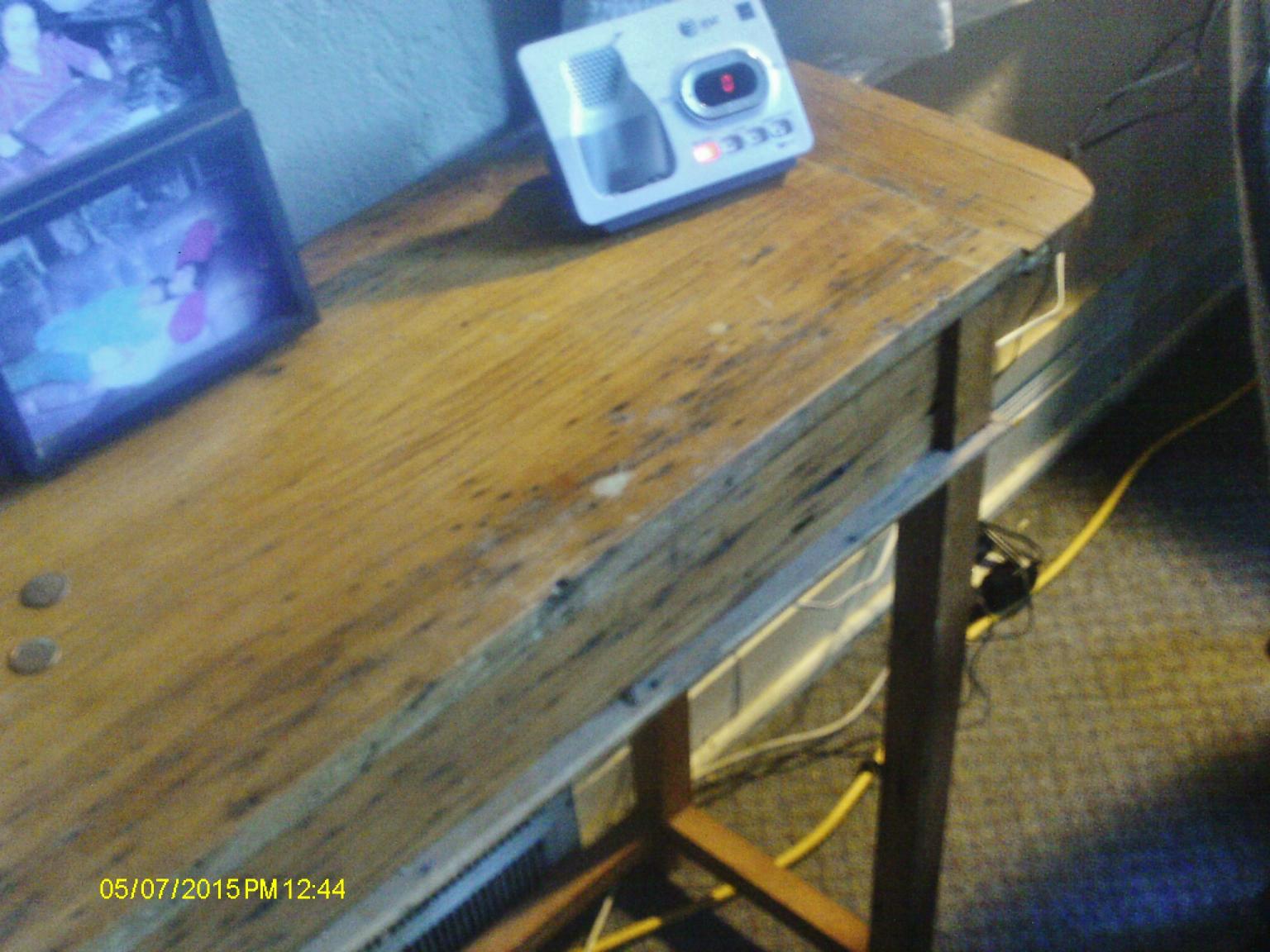

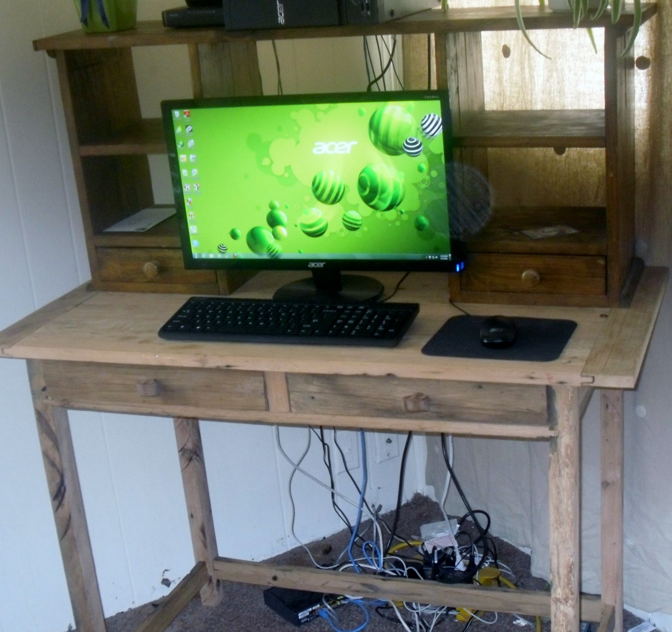

September 26, 201610 yr comment_76095 Old barn rafters, resawn into something that looks like a desk. Hutch was scraps of pine, main desk was Sycamore rafters, 2" x 5" by 8-12' long. Got quite a bit of 3/4" thick stock to work with...This was 6 years ago...or so. Have since added a finish to the desk part. Those knobs for the lower drawers? Bits of Walnut scraps... Edited September 26, 201610 yr by steven newman Report

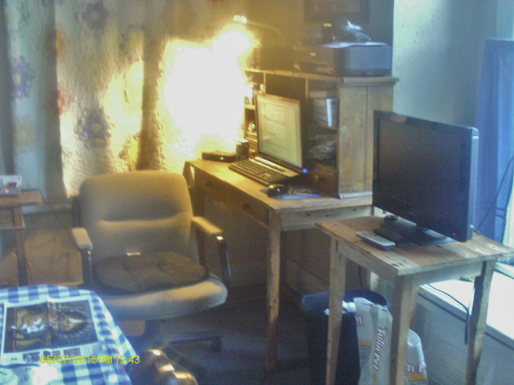

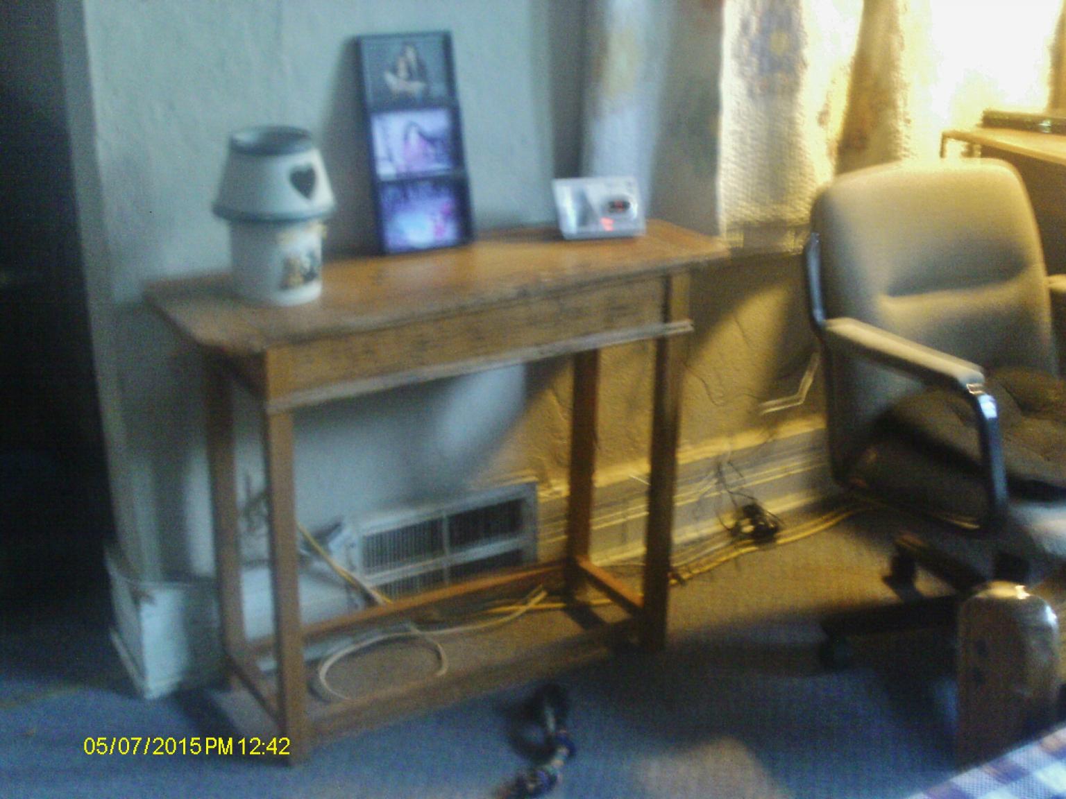

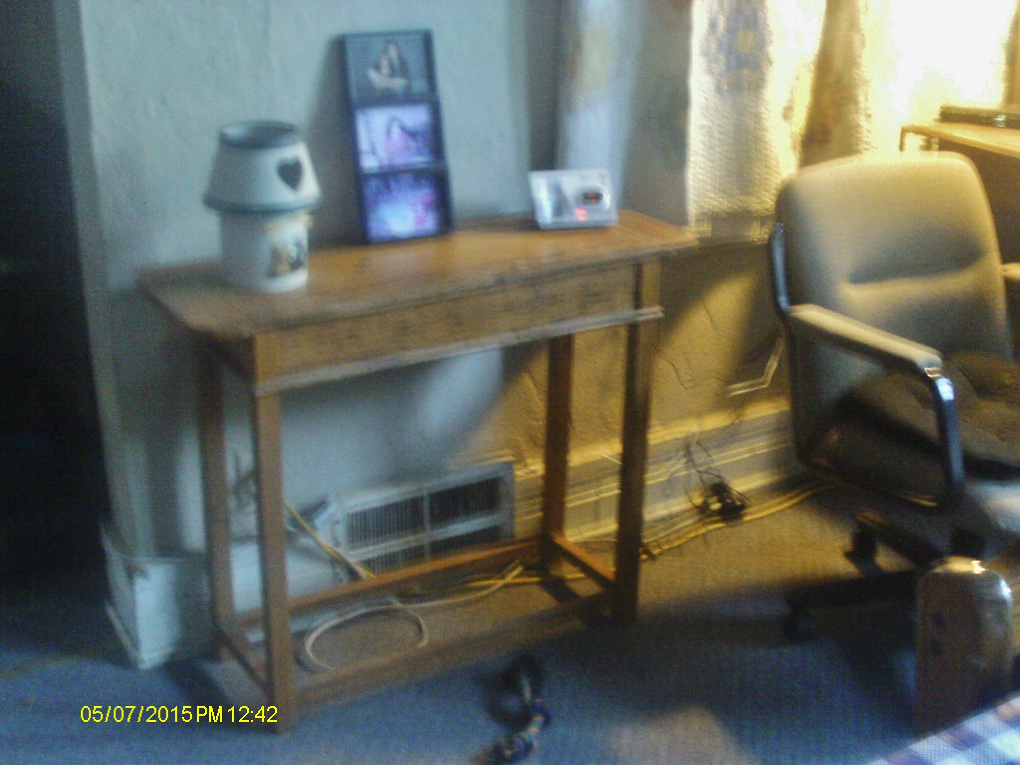

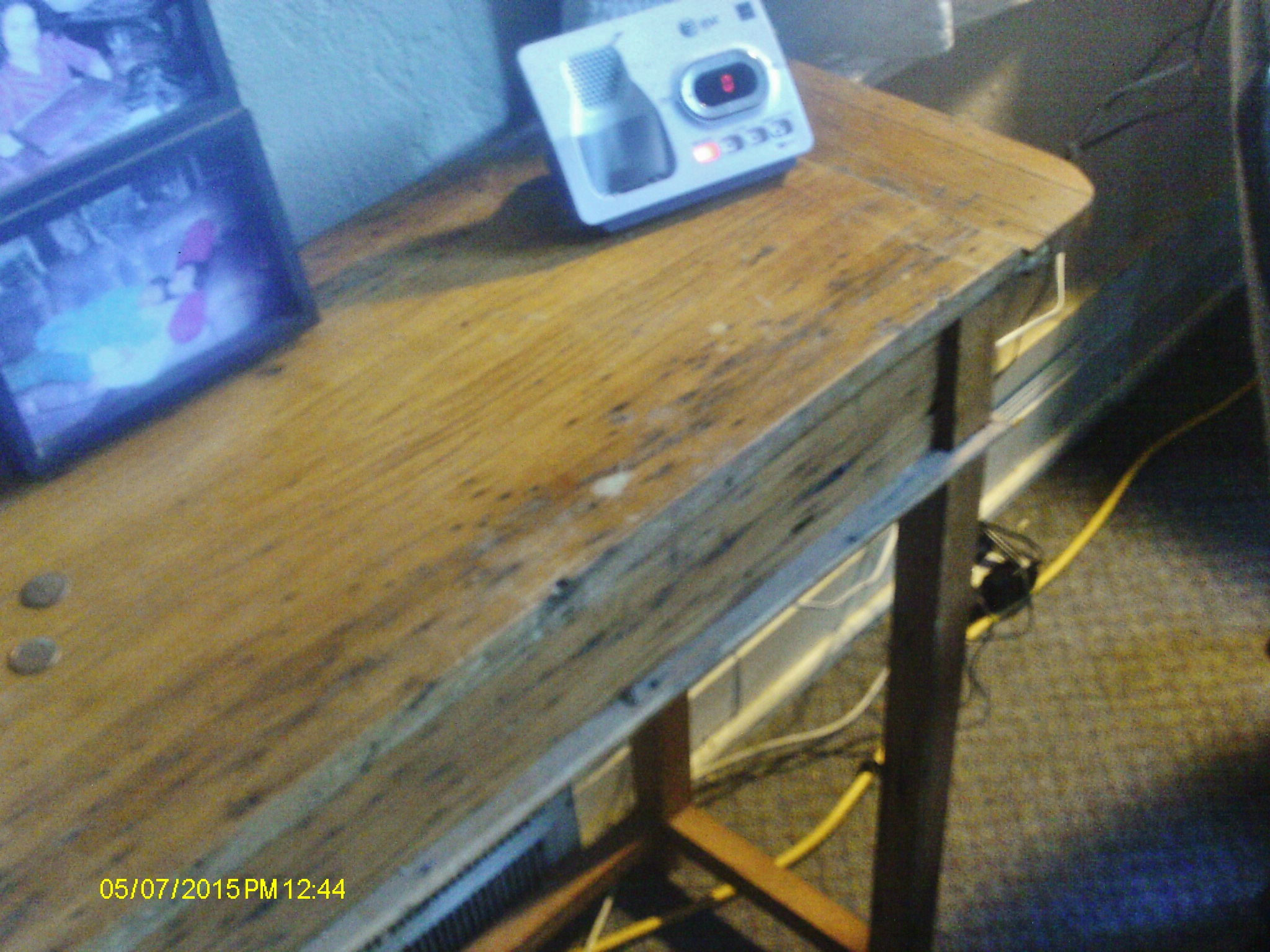

September 26, 201610 yr Popular Post comment_76096 Desk is still in use today. I am sitting here at that desk... It has seen a few moves over the years. There is a table just off to the left. Top was from a single plank of Sycamore, might have been a skirt board..... Plank WAS 13-1/2 " wide, until I had to trim it a bit, for square... With bread board ends. Just a pile of old barn wood... Report

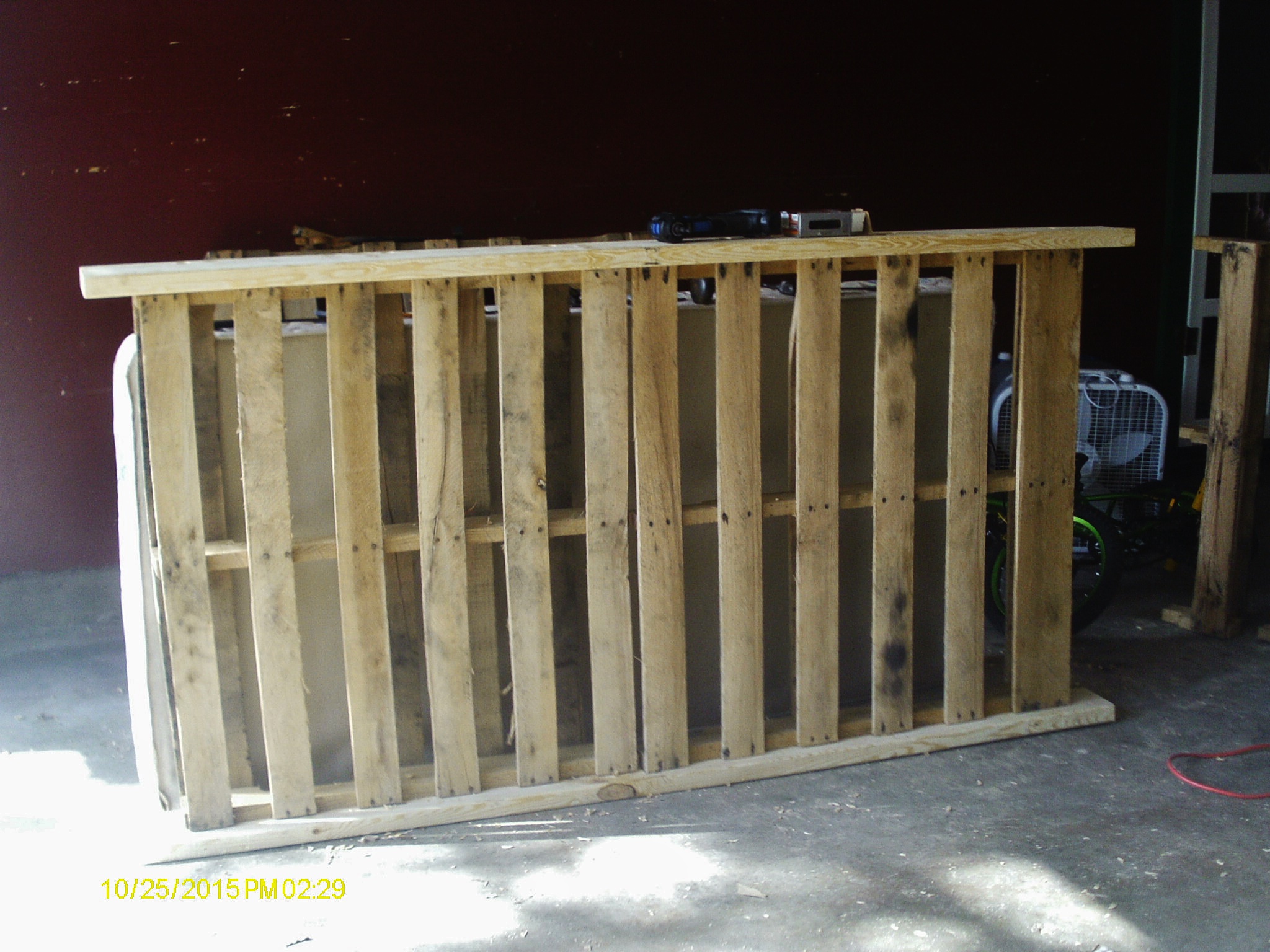

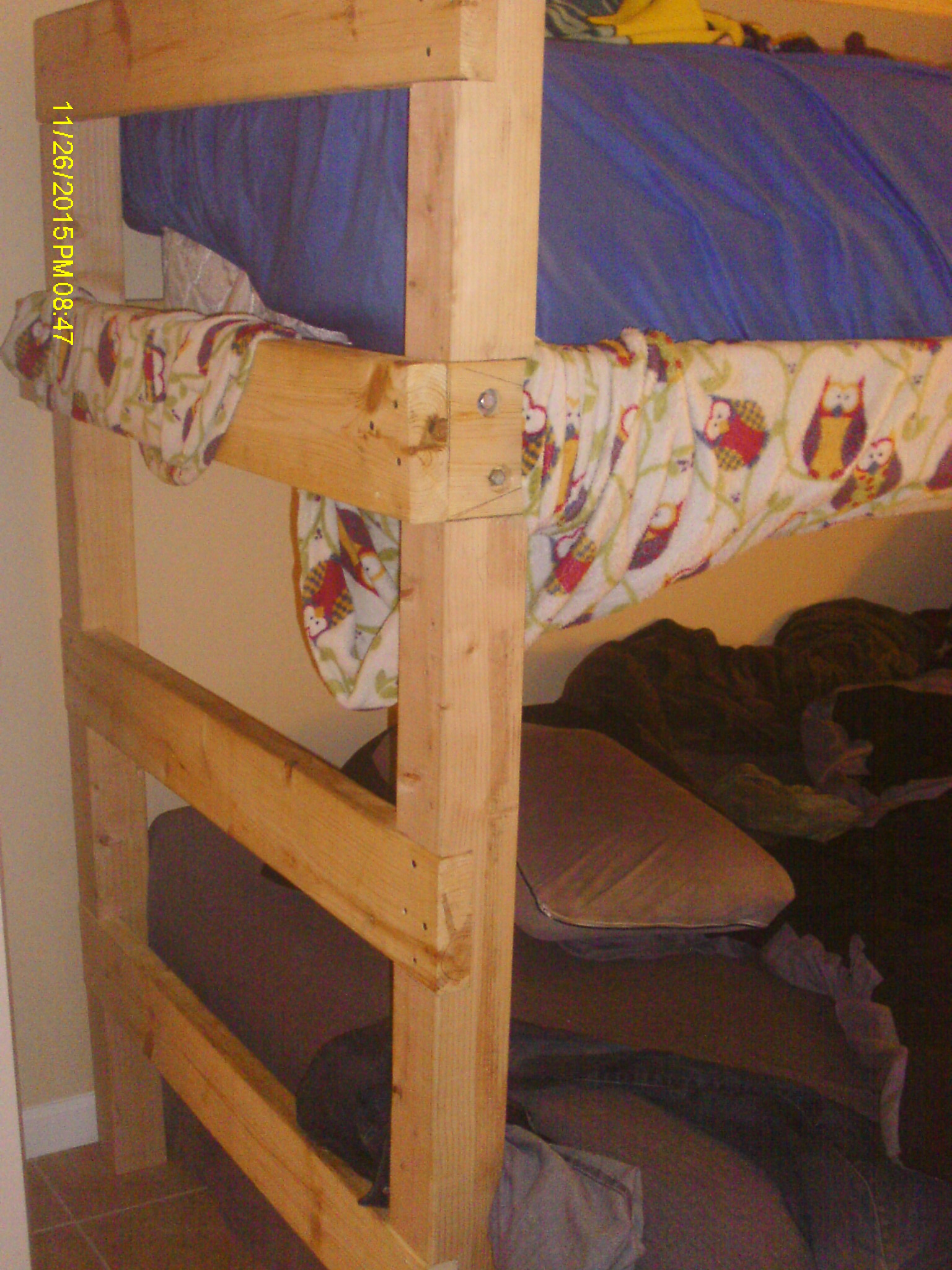

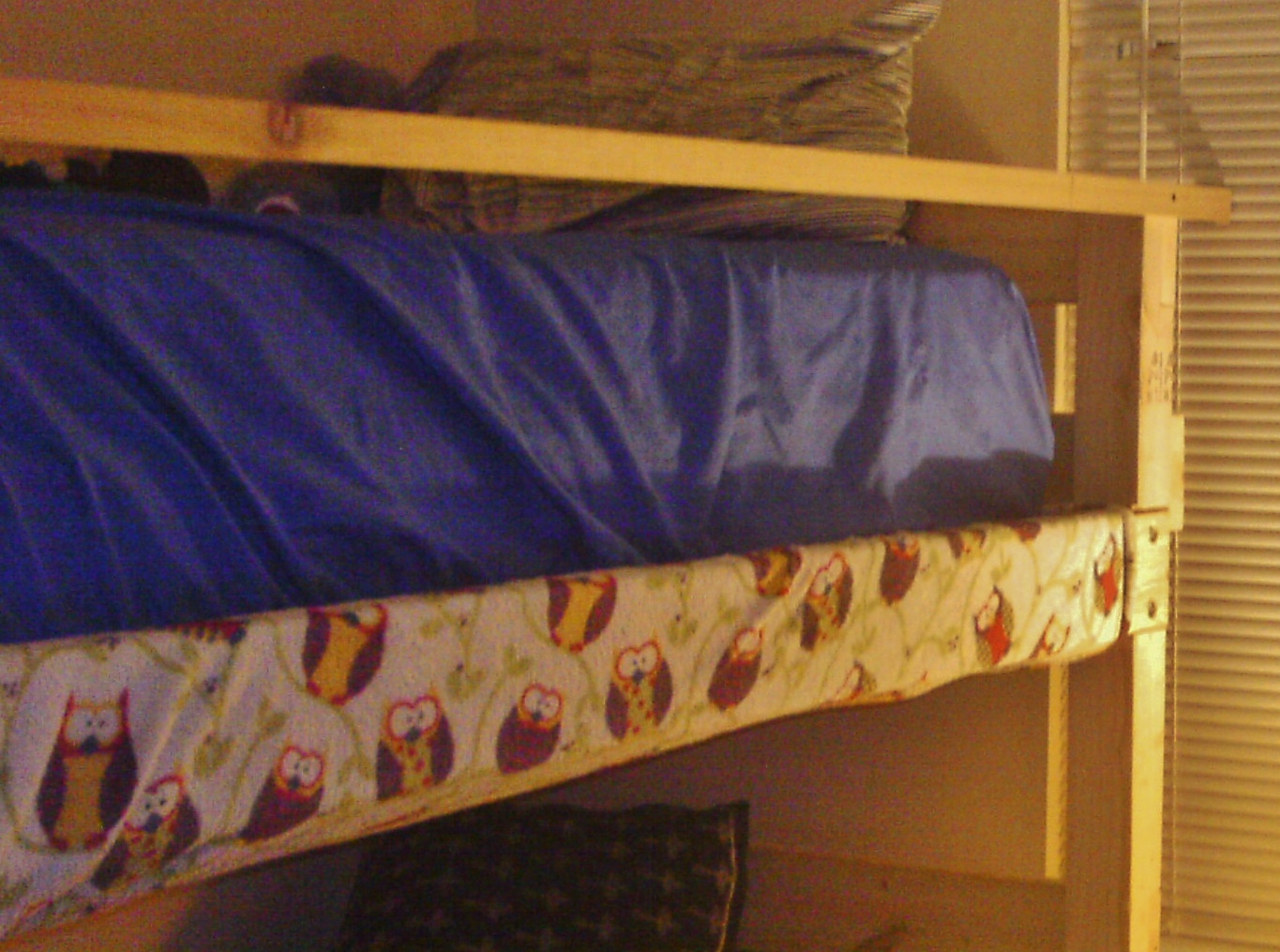

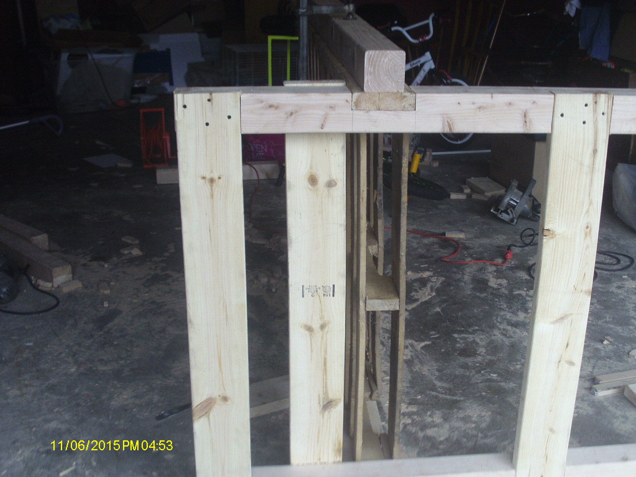

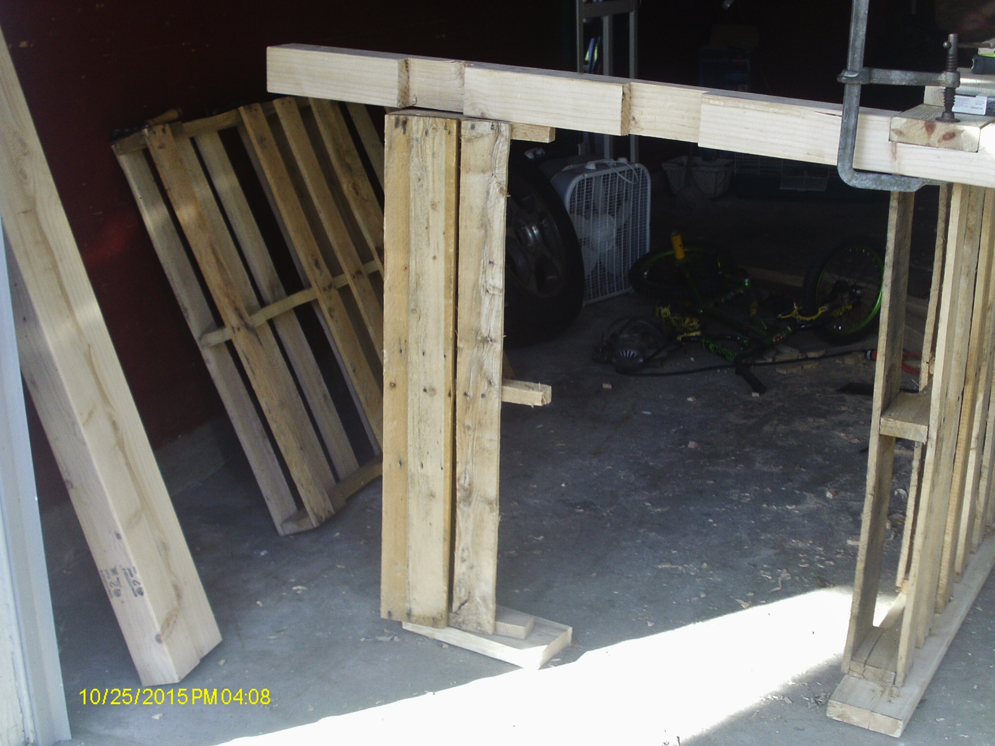

September 26, 201610 yr comment_76166 Let's see...Daughter wanted a Loft bed built for GrandBRAT #5....I bought a few non-treated 4x4s, and a few 2x6s Daughter had a few of these on hand. I cut two down a bit to get the length needed. Notched a few 4x4s, and cut them to the height she wanted.. Used one of the "cut-offs" as a bench. Circular saw for the kerf cuts, BIG framer chisel to clean up. Ends also used 2x6s to make a "ladder" end. 2x^s were lagged into the sides of the pallets. Then those were lagged into notches on the 4x4s, as well. Had to use an Impact gun to drive all the lags. Lags also had a washer, so I had to counter -bore for that. Counter-bore was a brace and bit. After a while.. I could assemble one end. Took another trip down there, to FINALLY get the bed all assembled and ready to go.. He can climb up the ends. His older brother just slid his bed in place under the loft bed. Safety Rail to keep things from rolling off the mattress, They used a sheet to cover the pallet base. Bed doesn't even move, while the 7 yr old rolls around up there. Just another use for pallets... Report
