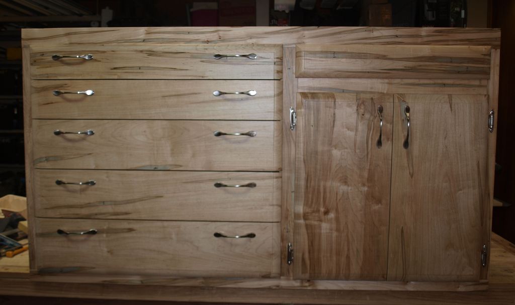

September 24, 201610 yr comment_75769 1 hour ago, Ron Altier said: Gotta get some. I want to play!! Post a picture of somewhere you used it. Thanks moved all of the handles and hinges,,, plugged the holes... wild gain separation/tear out on the left door, right side of valence and left side top drawer... Report

September 24, 201610 yr Author comment_75771 Wow, that looks great. I will get some soon. I have some spalted wood that is unstable and that should do the job so I can turn it into something wonderful, at least wonderful to like guys like us. Thanks Report
