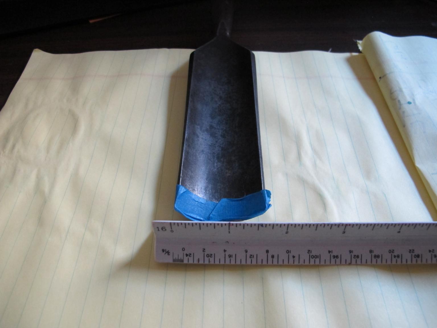

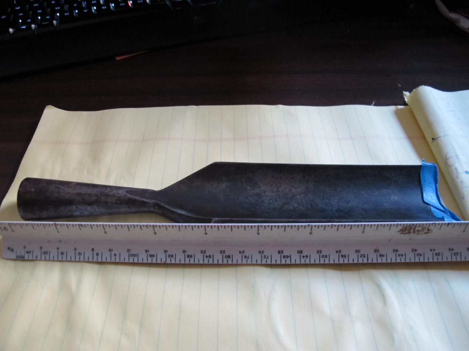

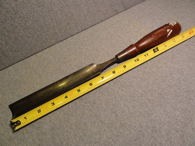

September 23, 201610 yr comment_75639 A buddy just dropped off a Buck Brothers gouge that needs a handle. TUrning it is no problem but I need to get an idea of the proportions of the original handle- which is missing. This is what I have- If anyone can direct me to a site that would have a picture of this particular chisel, I'd be grateful! Edited November 21, 20179 yr by Ron Dudelston tags added Report

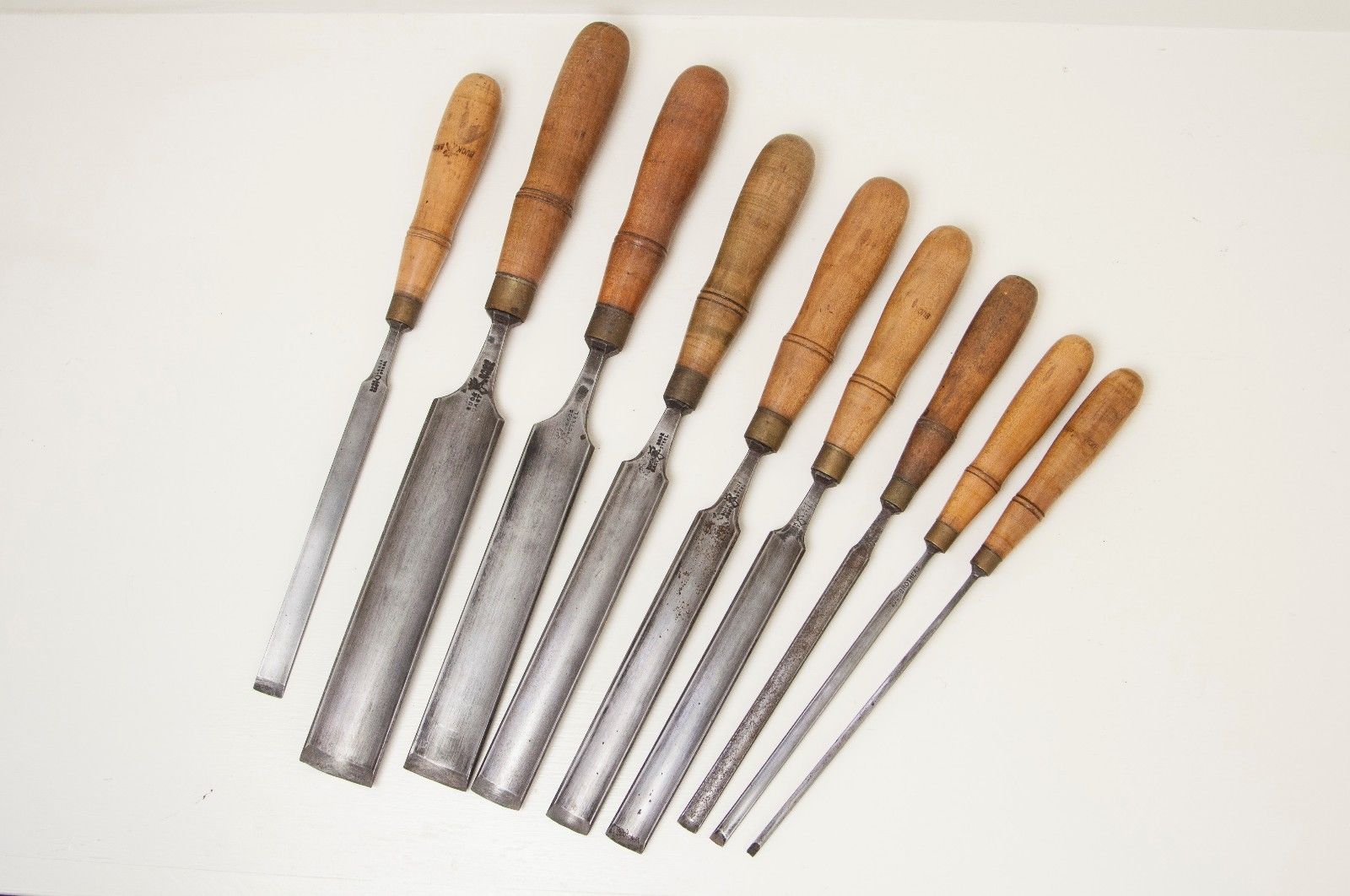

September 23, 201610 yr comment_75642 Does this help Lew? No dimensions but.... You could scale the handles in proportion to the irons, and see if there is a common factor. Report

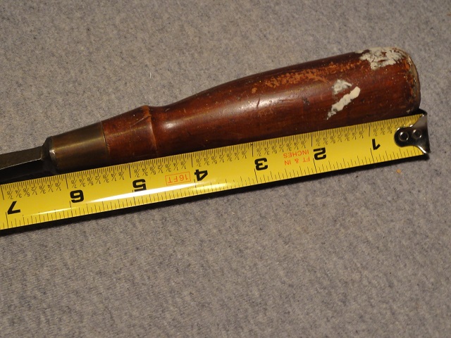

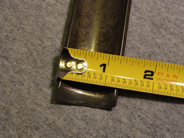

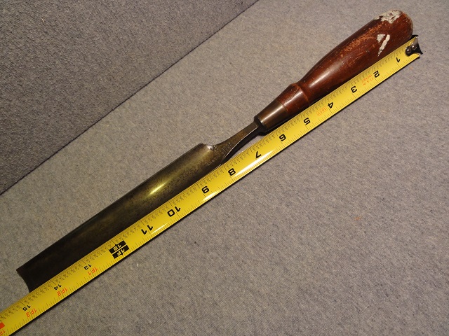

September 23, 201610 yr comment_75652 Lew, you had better go play the lottery because today is your lucky day. When I first got into turning a friend of mine gave me some turning tools his grandfather had owned and this carving chisel was with them. It is also a Buck Brothers. Yours looks to be inch and a half. This one looks like one and a quarter. The overall length is 15 inches. Here it is measured from the blade end. Here it is measured from the handle end. Here is a handle close-up. The large diameter of the handle is inch and a half. If you need anything more? Let me know. Edited September 23, 201610 yr by HandyDan Report
September 23, 201610 yr Author comment_75653 6 minutes ago, HandyDan said: you had better go play the lottery because today is your lucky day Thanks, Dan!! That looks exactly like what my buddy described as his thoughts. The dimensions look perfect. Report

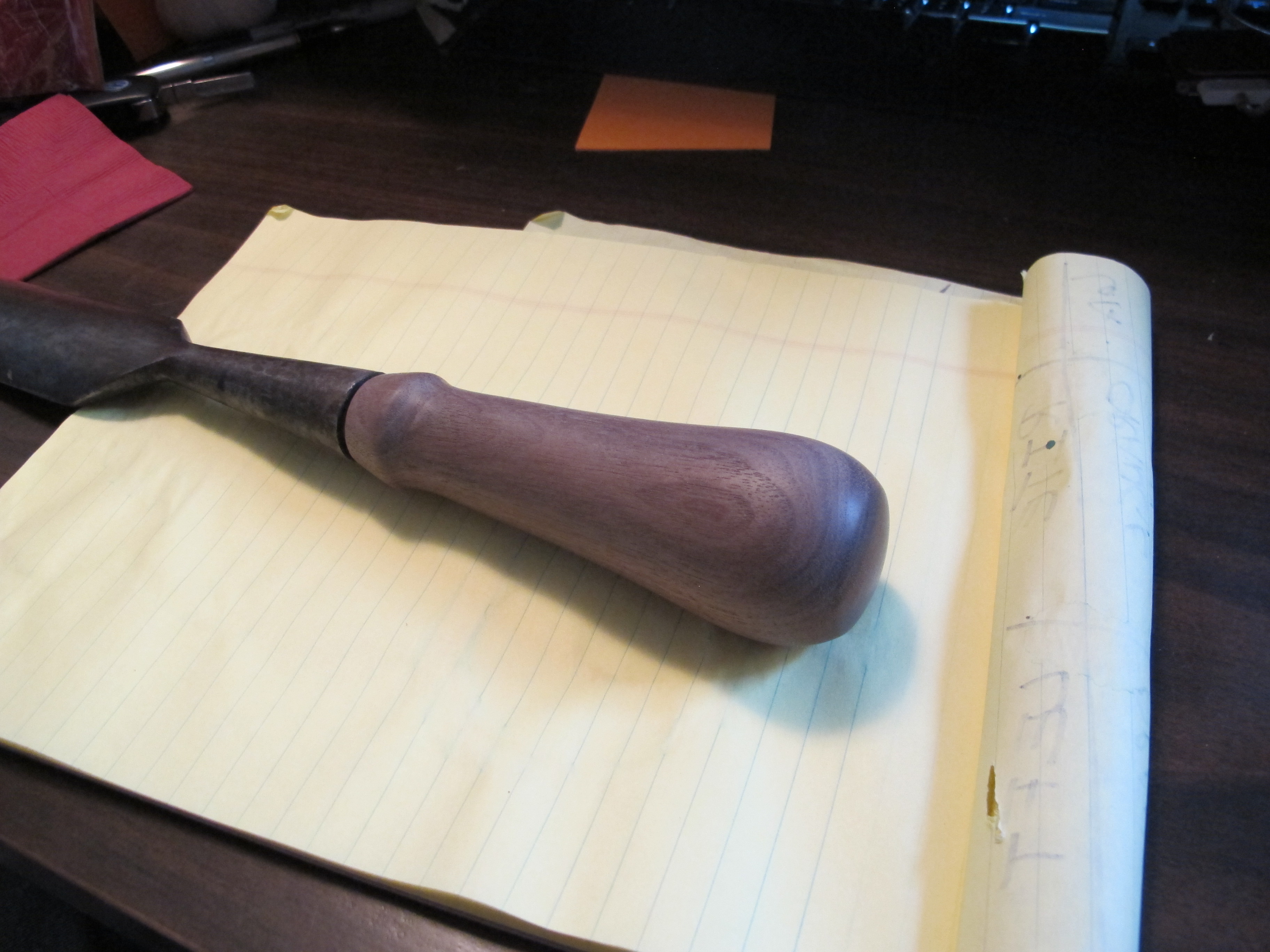

September 24, 201610 yr Author comment_75871 Thanks for all of the suggestion. Mine came out a little differently shaped but I think it'll be OK. No finish, my friend can add it if he wants a finish. Scrap of walnut- Not completely seated in case he wants to add a finish. Report
September 24, 201610 yr comment_75874 John your set you show there looks like the handles are a bit undersized to me. I think I have better control with something twice that big to grip.... Maybe its because I am a weakling and size does matter.. Report
September 24, 201610 yr comment_75892 Great job on the handle. That should do the job for many years to come. Report
September 25, 201610 yr Author comment_75904 2 hours ago, HandyDan said: Great job on the handle. That should do the job for many years to come. Thanks, Dan! He picked it up a little while ago and was please with the results. Report
September 25, 201610 yr comment_75920 That looks great Lew! I'm sure he will enjoy it for many years to come. Love the walnut. Report
