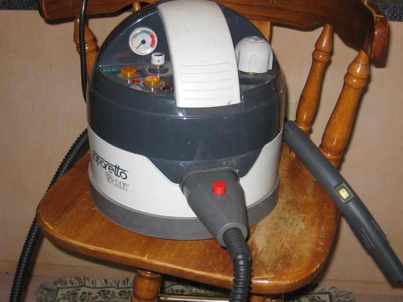

John, I haven't had a chance to use it yet, but I bought a Jewelers Steamer for cleaning jewelry. I got it at an auction for 10.00. My thoughts were use it for steam bending. Maybe I can get it out and hook it up. I'll try to get a picture of it today and post.
21 minutes ago, John Morris said:
Thanks John! When you get a chance that would be great!

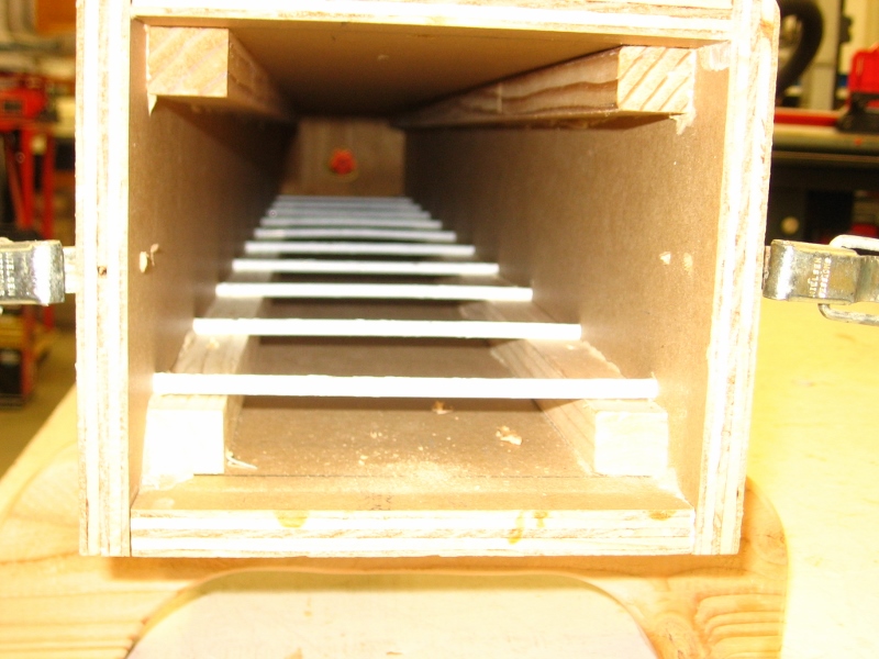

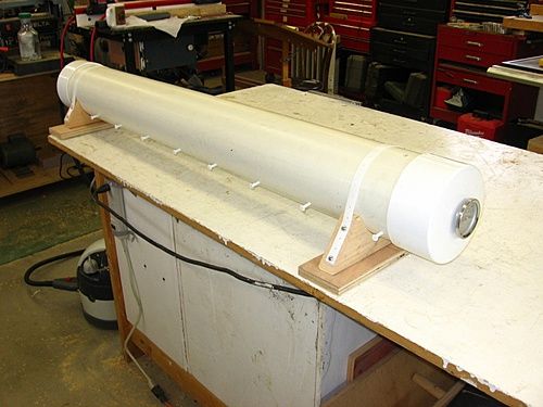

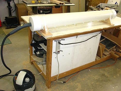

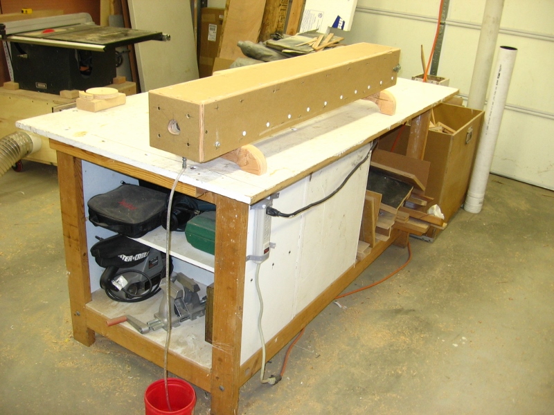

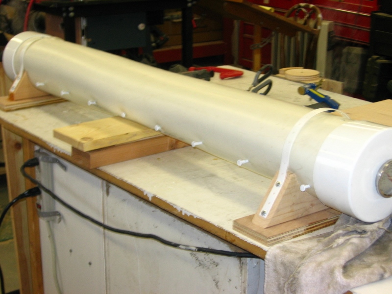

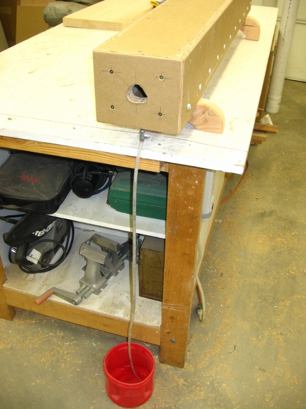

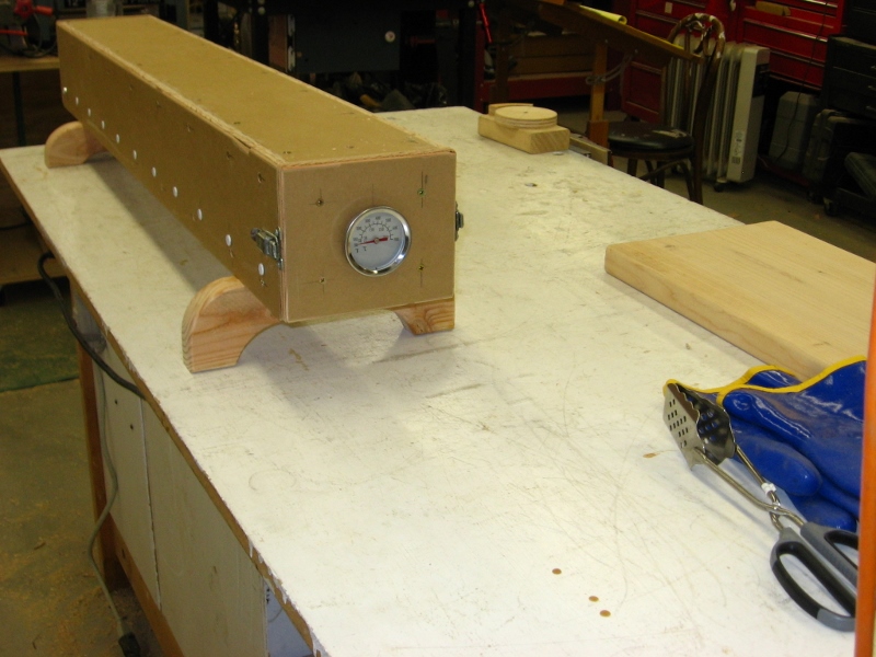

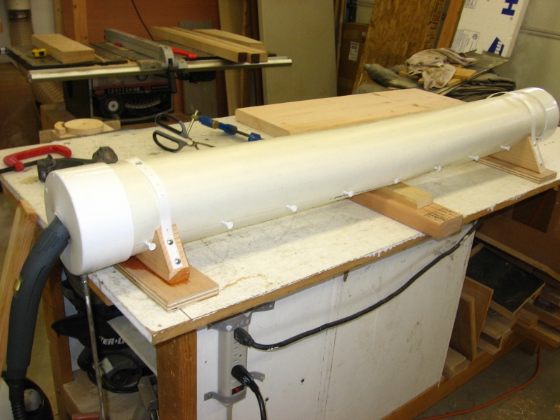

John, I will relate my experience with steam bending here are some boxes I made. As you can see the PVC one collapsed after 45 min of steam.  The MDO plywood held up fine .
Stick is correct in not using kiln dried material. I even soaked it for 4 days and it still didn't bend, I broke  every piece. It did bend better but still broke. I was tryng to bend maple and white oak, both the same results. Finally abandoned the project and gave the steam box away.

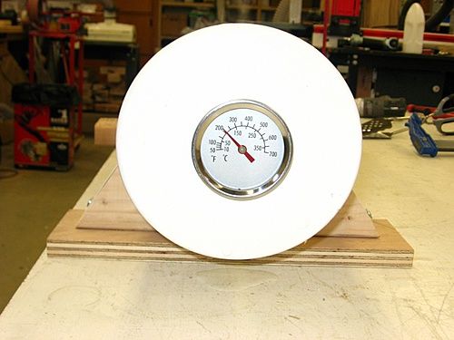

The steam generator I was using was a carpet steam cleaner, the Temp gage for the box was a BBQ one bought at Lowes, the supports for the wood inside the box wre long gutter nails from Ace hardware.The MDF plywood was 1/2" Melimine both sides. I used construction adhesive and SS screws.
Hope this helps.
, Herb

Correction to the above, the plywood steam box was not MDF, it was MDO, Medium Density Overlay,. there is also a HDO High Density Overlay too , both can be purchased in one side or both sides at the lumber yard. Very good material for concrete forms leaving a very smooth surface on concrete, and reusable many times. A high grade moisture resistant  plywood.
Another point it make your box sloping to drain the condensate water out, also vent the high end with a small hole to relieve the steam pressure.
