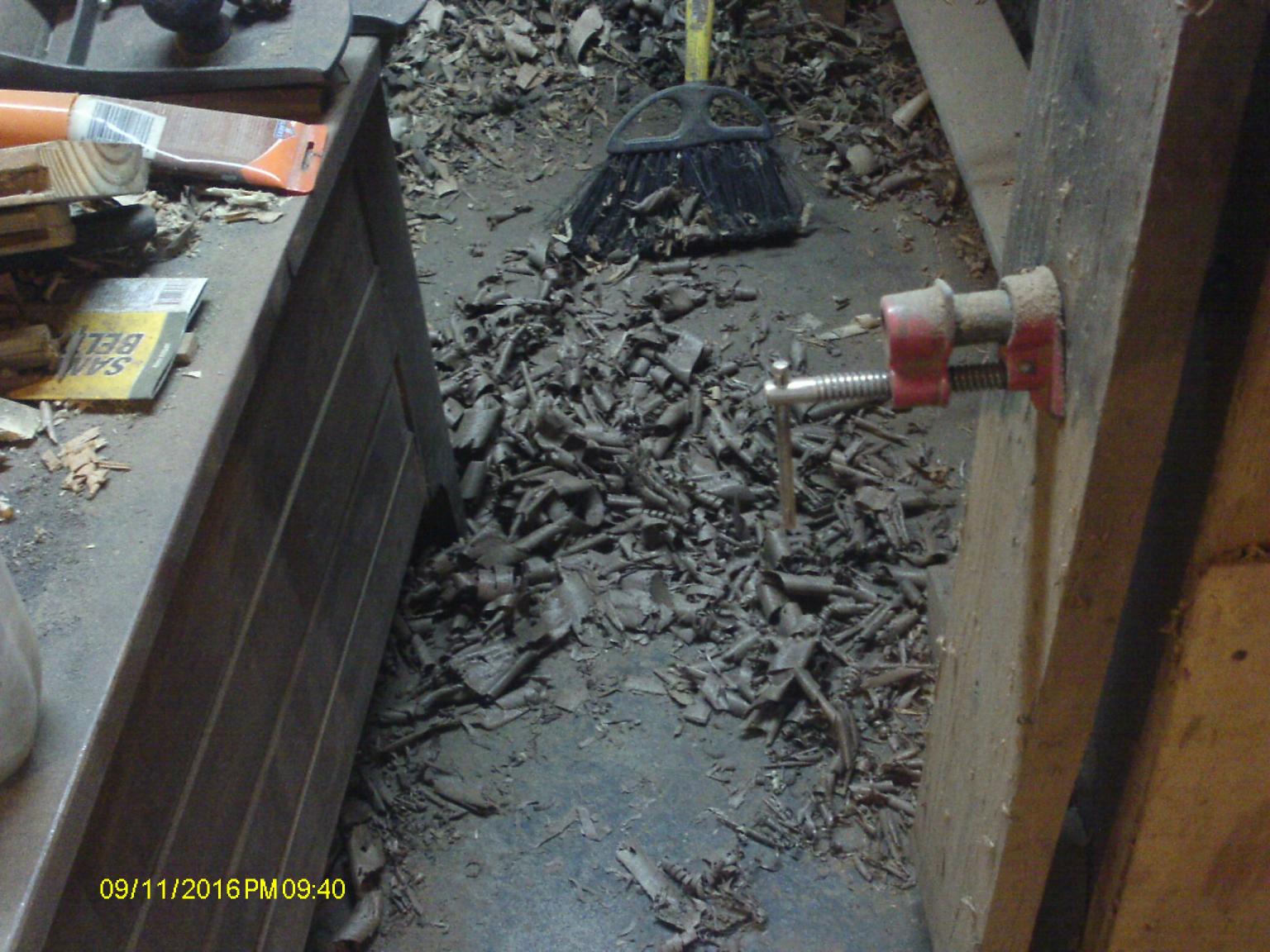

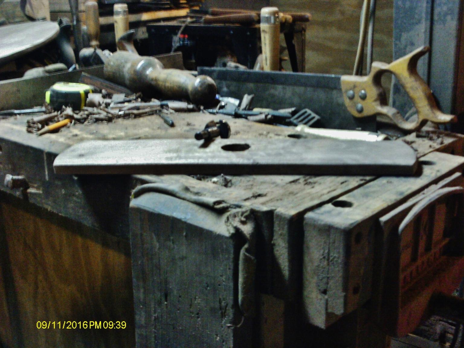

September 12, 201610 yr comment_73511 What little I could get done, at least. Found out we were taking the GrandBRATS home a couple hours later than I thought....snuck off to the shop. Had a slab to resaw down to a batten...wound up breaking the bandsaw blade, digging out another (DULL) one, and finishing the cut. Then the planes took over. And the beltsander. and the spokeshave. Rounded both ends to match the curve of the top, Beltsander to taper each end a bit. No.3 plane and spokeshave to bevel the sides. Whew. Dust and shavings everywhere. Meh, it will have to do. The forstner bit was for that hole. Will come back later, add a counter bore for the post to sit in a bit better.. Doesn't have to go down very far...maybe 1/8". Did I say I made a mess..where is Igor when I need him.. Report

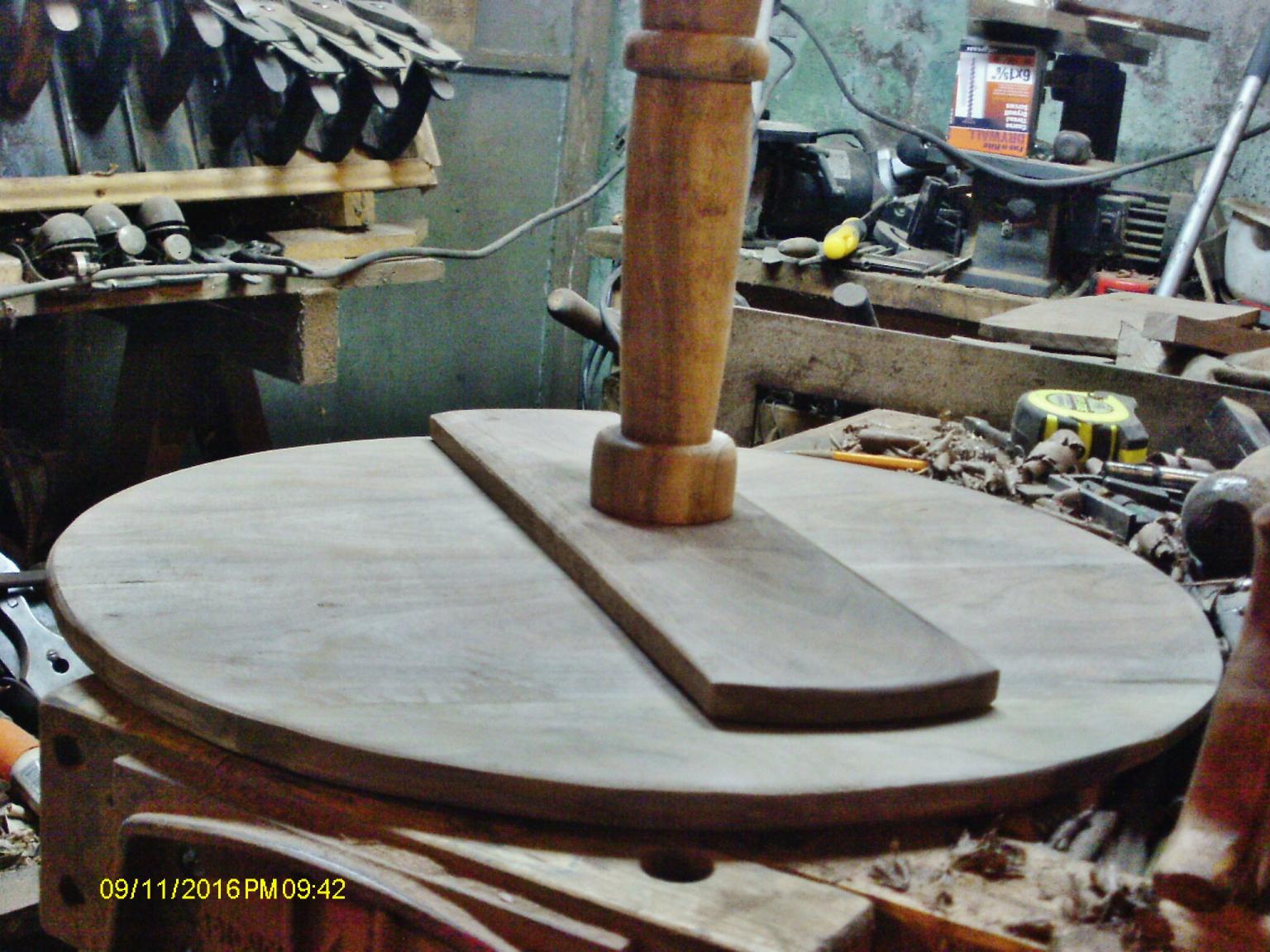

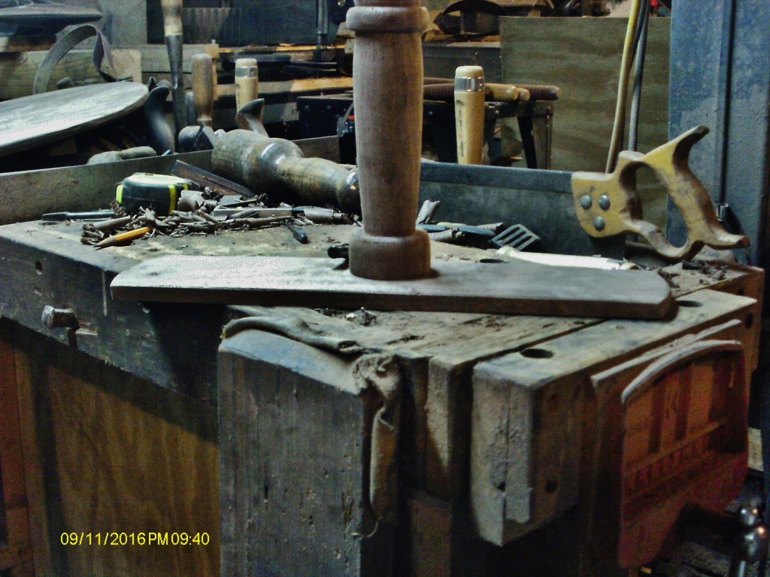

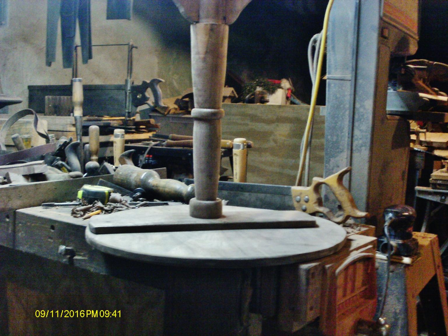

September 12, 201610 yr Author comment_73514 That was strange.....what happened? Got cut off while posting? Anyway, I also worked on the top, trying to find which face looked the best......planes, sanders, spokeshave an edge or three...was time to take the BRATS home, anyway. I did test fit things a bit.. what you see is the underside of things. Yes, this do go across the grain. I also will need screws to attach it with ( no glue) and use slotted screws. I need to drill slotted holes, too Have to allow for expansion. A wider view? Came home from my Daughter's place with a leg brace on the left leg. Yep, knee is that bad. Will know more in the morning, I hope. Stay tuned on both items..table..and the knee. Report
