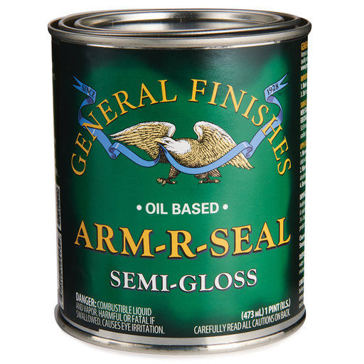

July 27, 20197 yr comment_197102 Hey Michael, a few years ago I ditched my spray equipment, basically because I just don't have a need for it. Back in the day I did quite a few side jobs that involved a lot of flat work, such as cabinets and doors etc. But I got away from that hustle and bustle, toned it all down, and I mainly make things for family and the occasional interested party that wants custom work and will pay well for it. I really did not like spraying, it was just messy, and the clean up, and the set up, and on and on. I swore to never let a spray device in my shop again, and I don't regret it one bit. For the amount of work I do, it's just not practicle. So I finally made the decision to just ditch it all, it works for me, it won't work for others. But in a shop that is located in a basement like yours, have you considered mastering your wipe on skills? No fuss no mess, and the finish always turns out perfect, because of the simplicity of the application. And there are coatings made that you wipe on, that are very durable. Since we are talking about General Finishes, they have: Wipe it on, that's it. I love wipe on finishing, after all that fine work you put into a project, it's just enjoyable to have some music on, or not, birds chirping, whatever, and enjoy the final bliss of the project by quietly wiping on the finish, with out that ruckus of a compressor, and atomized chemicals floating all over the place. Just a suggestion Michael. Report
