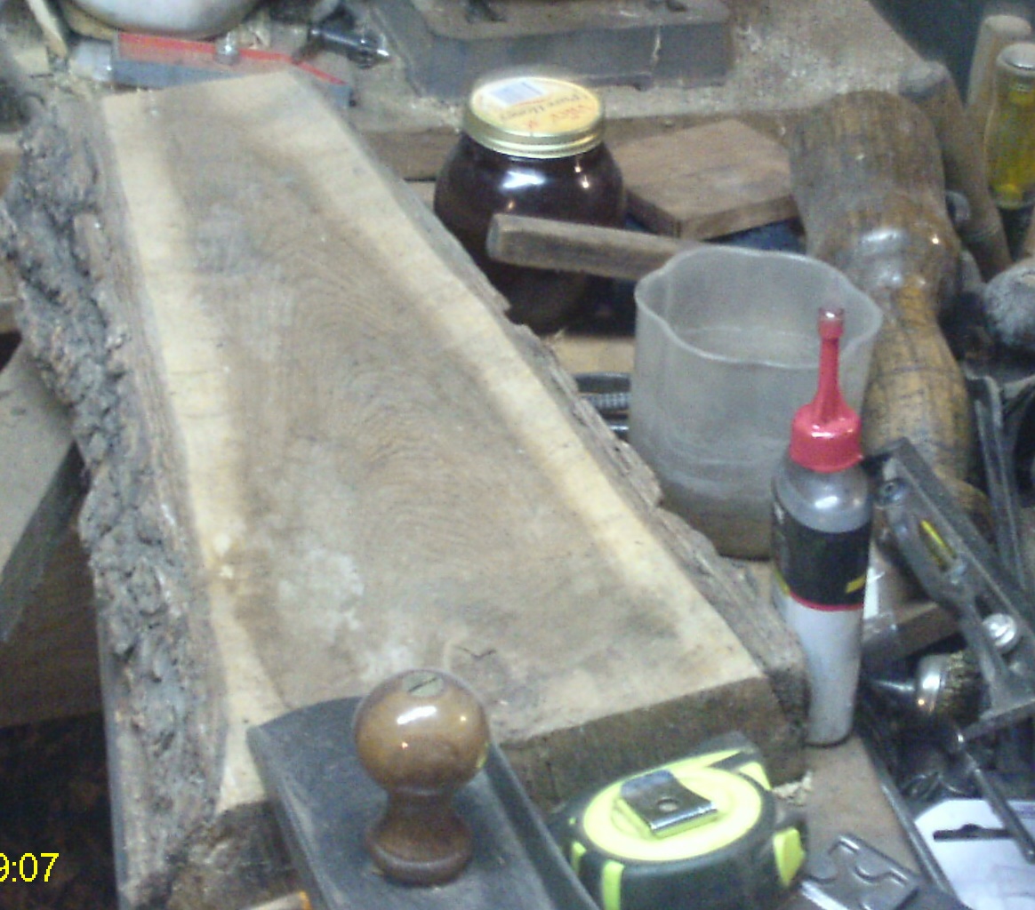

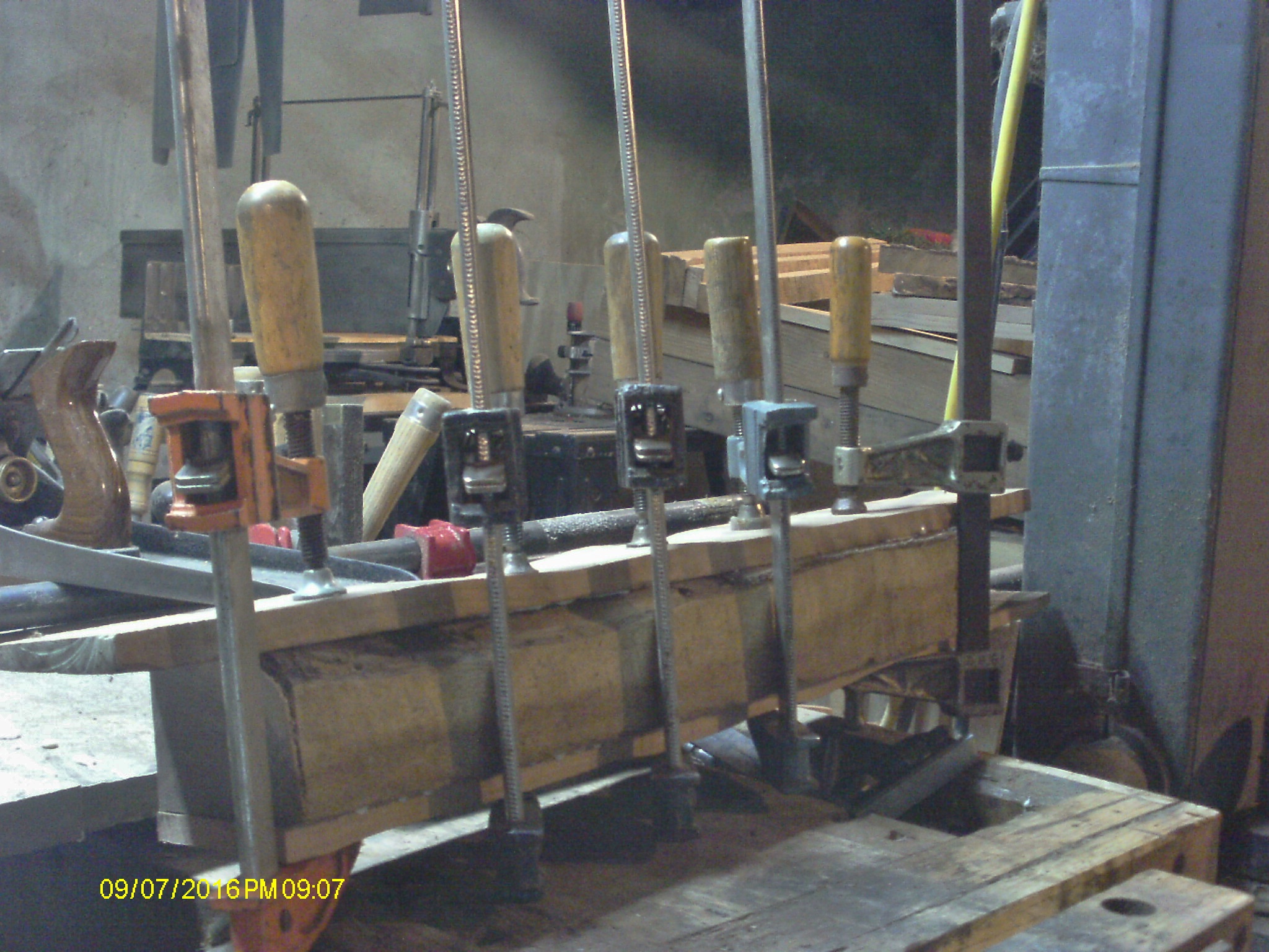

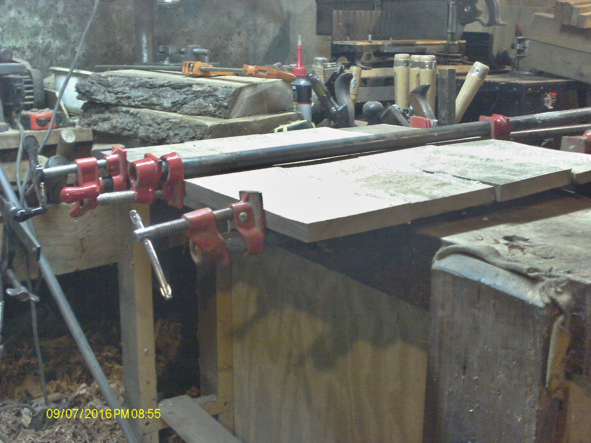

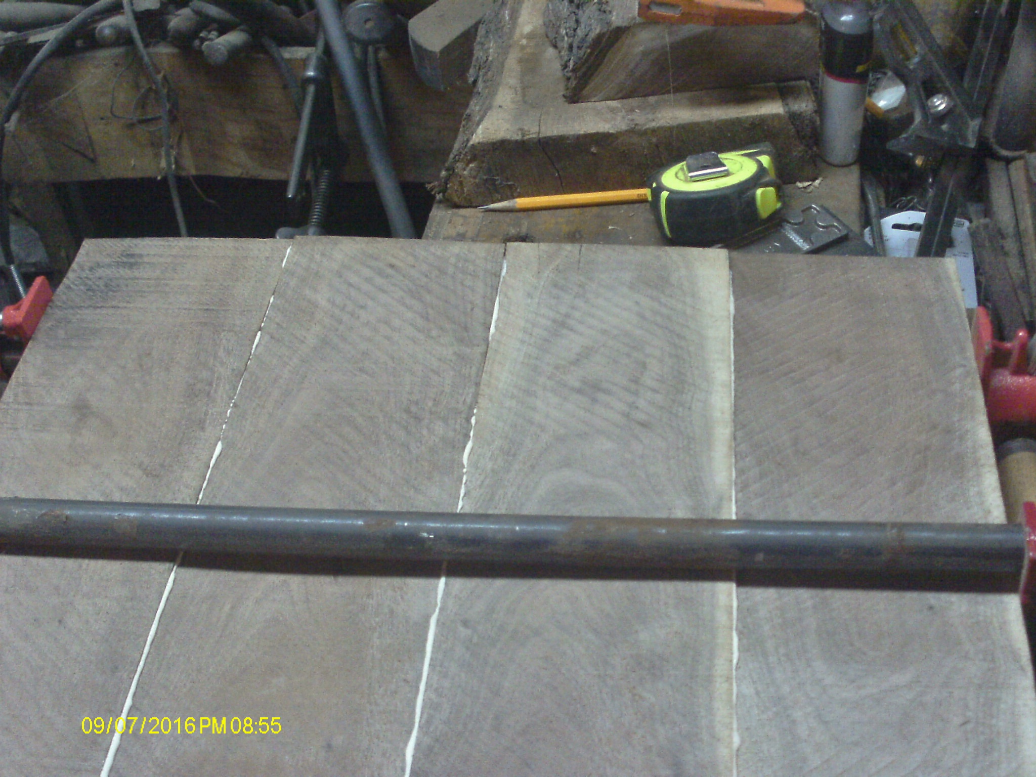

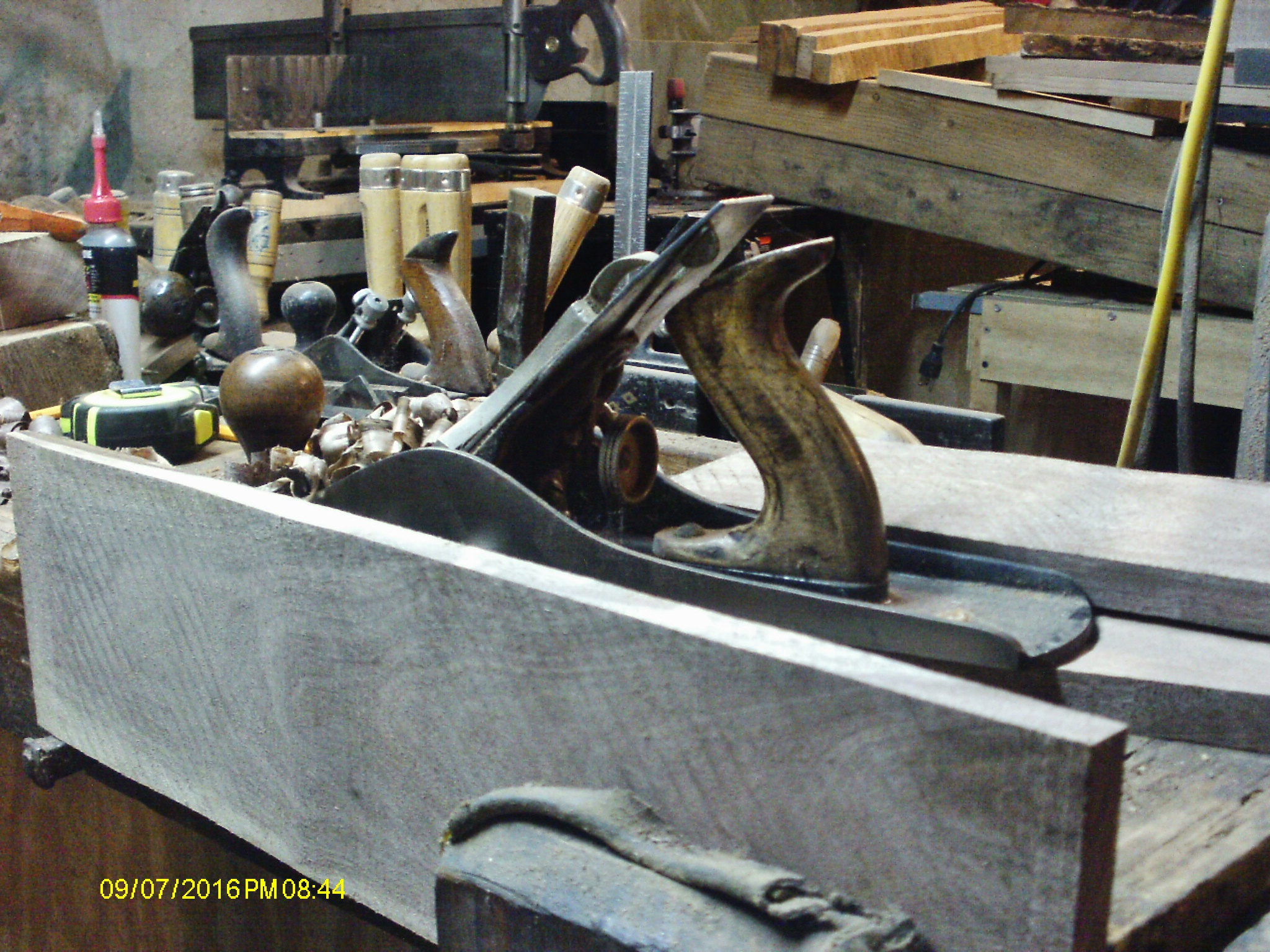

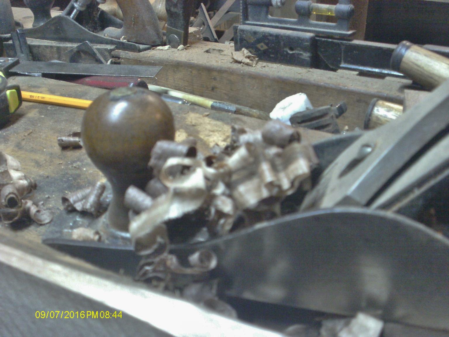

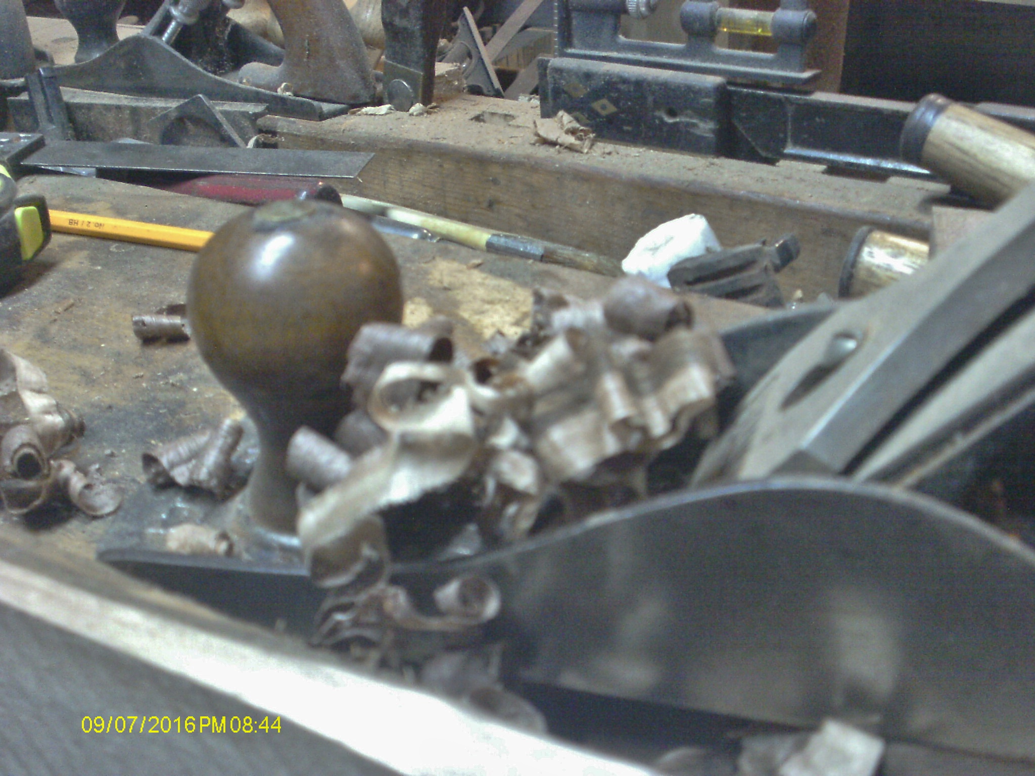

September 8, 201610 yr comment_72693 Things cooled off a bit, and I fired up the box fan to blow across the bench ( and ME) Put away the No.7c, got out a smaller plane.. Stanley No. 5-1/2 Jumbo Jack. At 15" long, should work nicely on these 18" long edges. I kept checking as I ran the plane, both sighting down along the length of the edge, and with a board thst was already done. Nice when you get these ribbons the full length of the board.. Finally got the four boards to just about match up along the edges. Pipe clamps and glue time.. End grain? I plan to flatten the entire panel, once the glue has cured. I clamped it up just enough to raise a bead.. Pipe clamps? Well, I had a use for the "bar" clamps in the shop. I resawed the second slab to get about a 3" width....but needed some "add-ons" to get the width on the faces.... Think anyone will notice those are Cherry add-ons? This will be turned in to the column that holds the top up. Leaves me with the last of this $1 slab of Walnut Just in case I need a little extra..... Report

September 8, 201610 yr comment_72737 Awaiting the next installment of the candle stand/table. Sure like those curls. Sweet. Report
