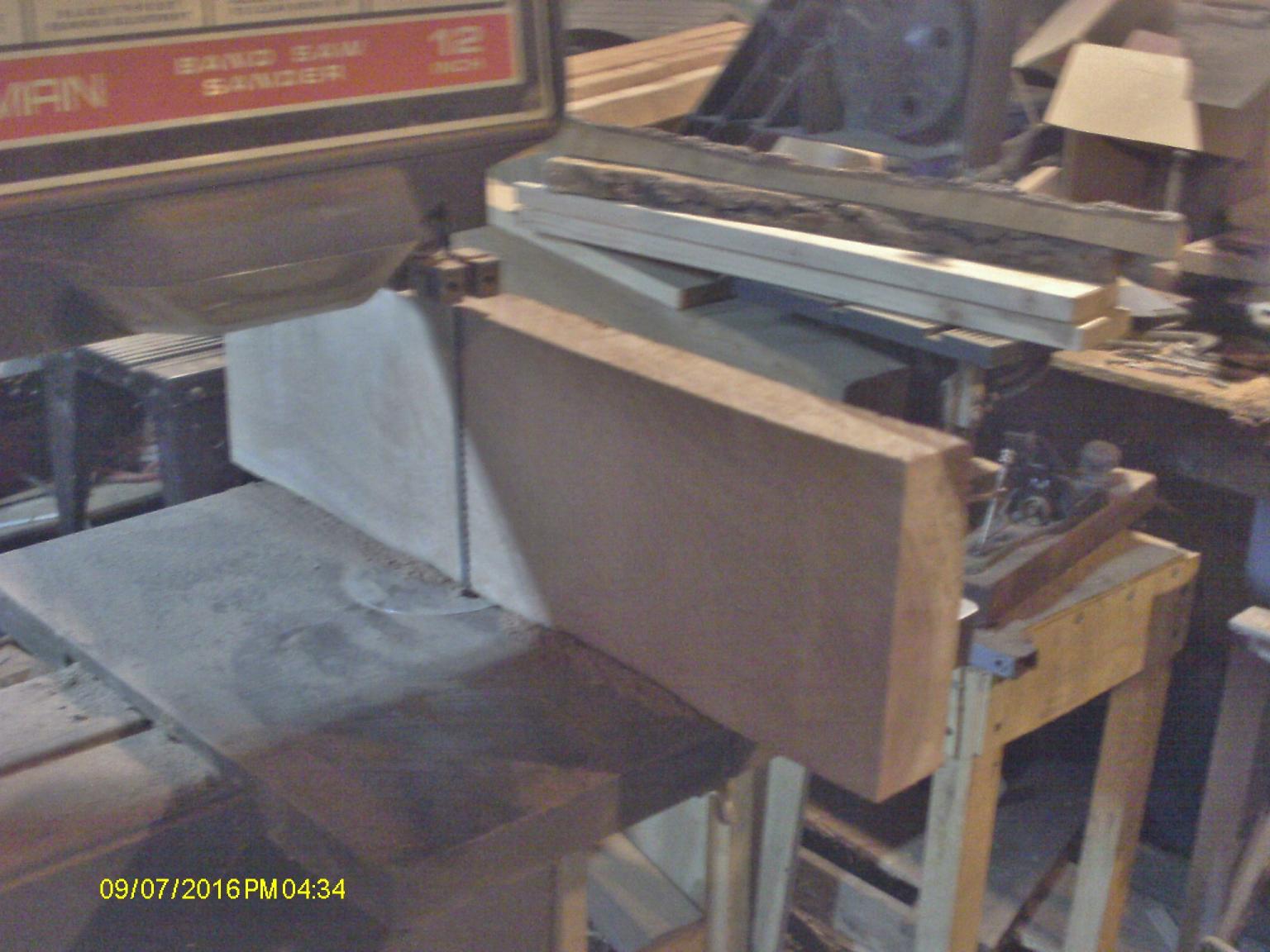

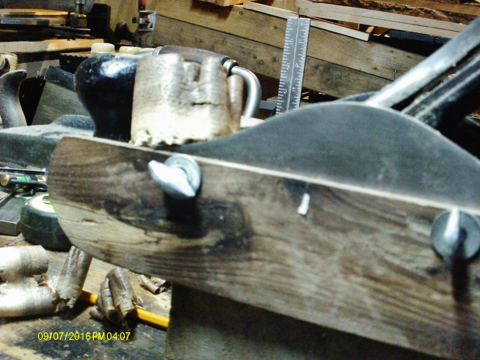

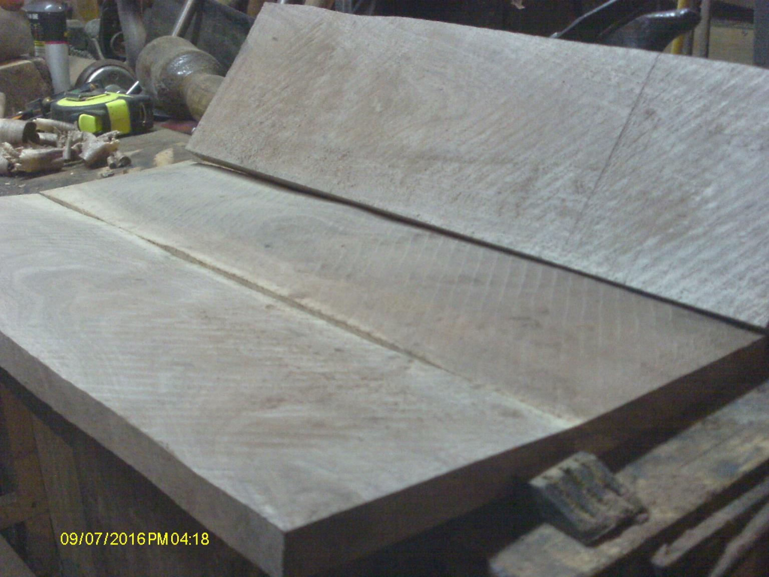

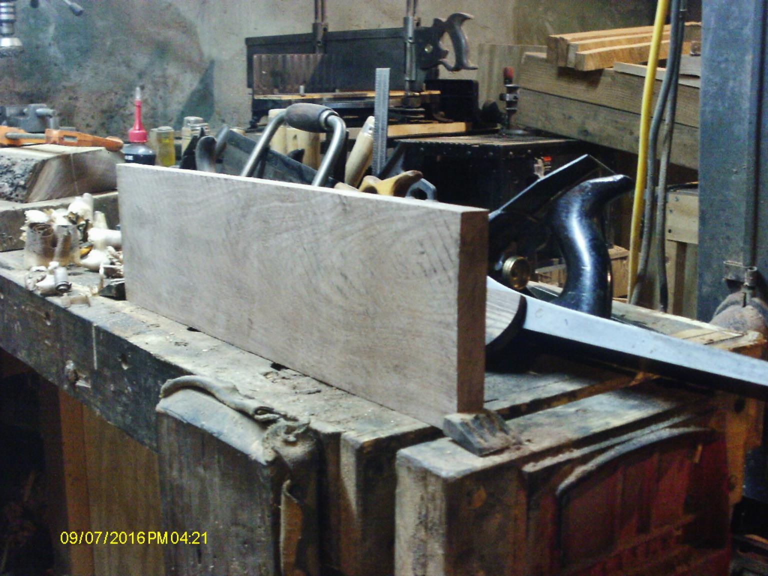

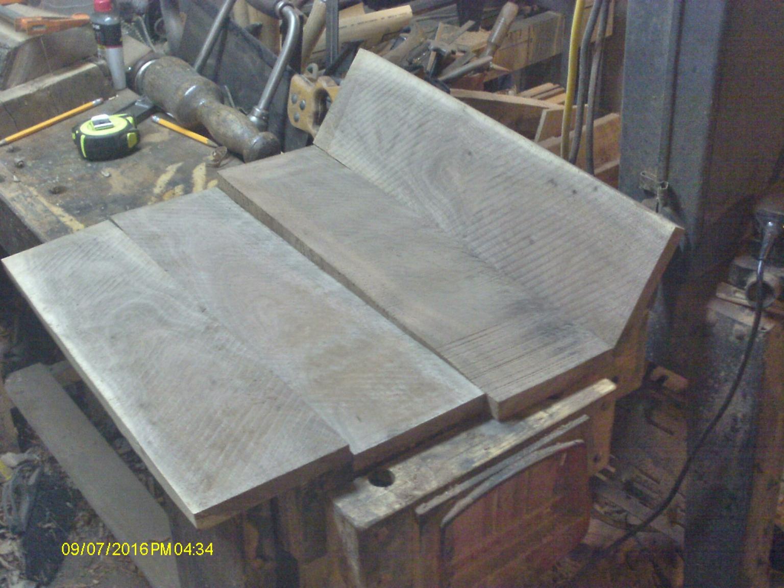

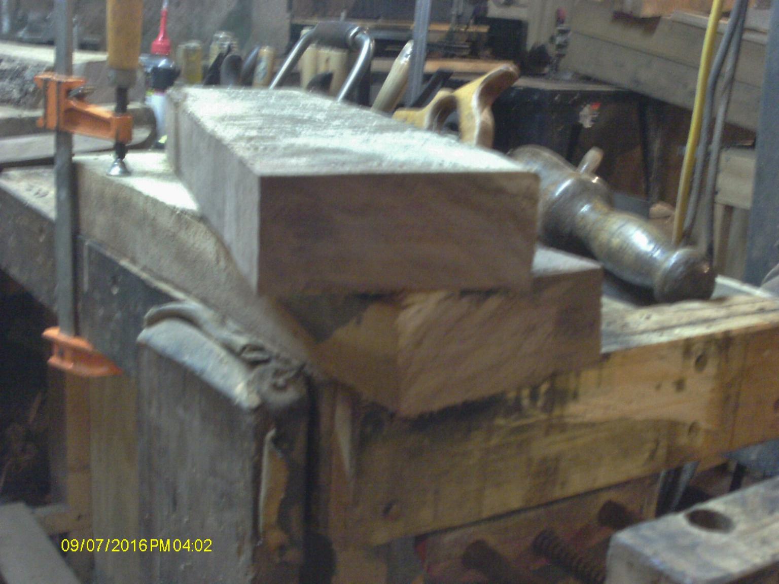

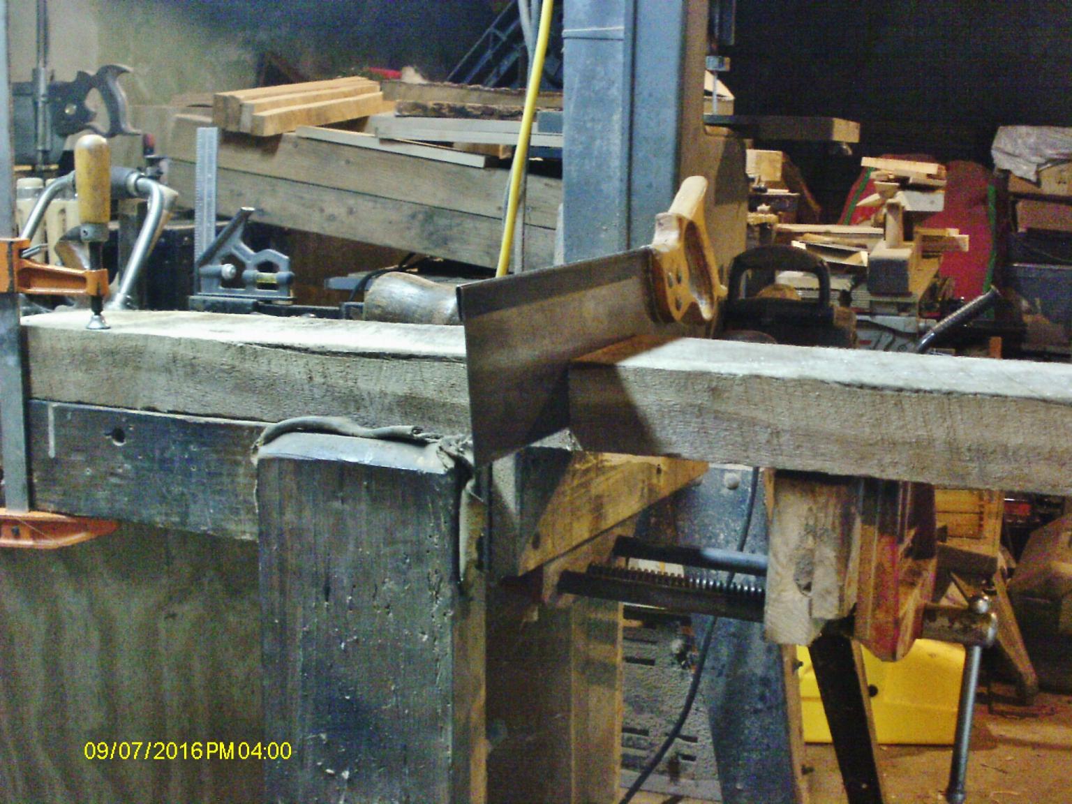

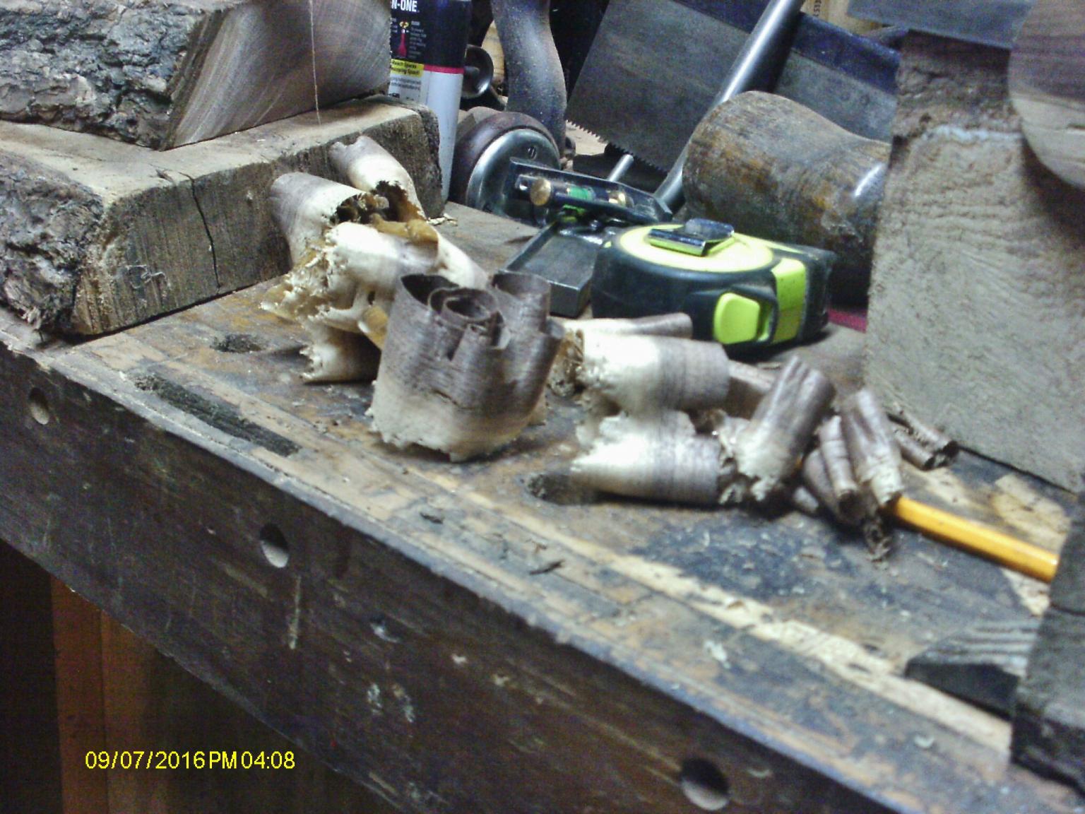

September 7, 201610 yr comment_72626 Measured out an 18" long section, and proceeded to crosscut a chunk off.. Took a lot of wax on the blade. I didn't feel like dragging the circular saw down the stairs... 18" was a bit too much to crosscut on the bandsaw, Finally Set the one section aside, needed to joint one edge square... The plane has a walnut fence, to help stay square, Plane is a Stanley No.7c, type 9 Shavings seem to be walnut, also... A little sap wood. Needed this board to have a square corner, to make it easier to resaw.. This is from the second board, first one gave me three pieces... But, at only 15" wide...I needed a fourth one to make a 18" diameter round top....so That blaack knot will be heading to the outside, where the cut will be coming around. Need to start jointing edges, to do a glue up.. One way to hold it. Plane is a bit too long, about 2" longer than the boards. I suppose I could drop down a size or two. Plan right now is to get these four glued up into a panel, The day after the glue is cure, I can flatten the entire panel, and cut it into a circle. The leftover slab sitting on the bandsaw will be cut into three curved legs. Still have the two shorter planks.....maybe a glue up into a column blank for the lathe? It 's start anyway.....Now, IF I can find that fellow Gumption again, I might just cobble something up? 87 degrees outside, and HUMID.....shop isn't much better... Report
