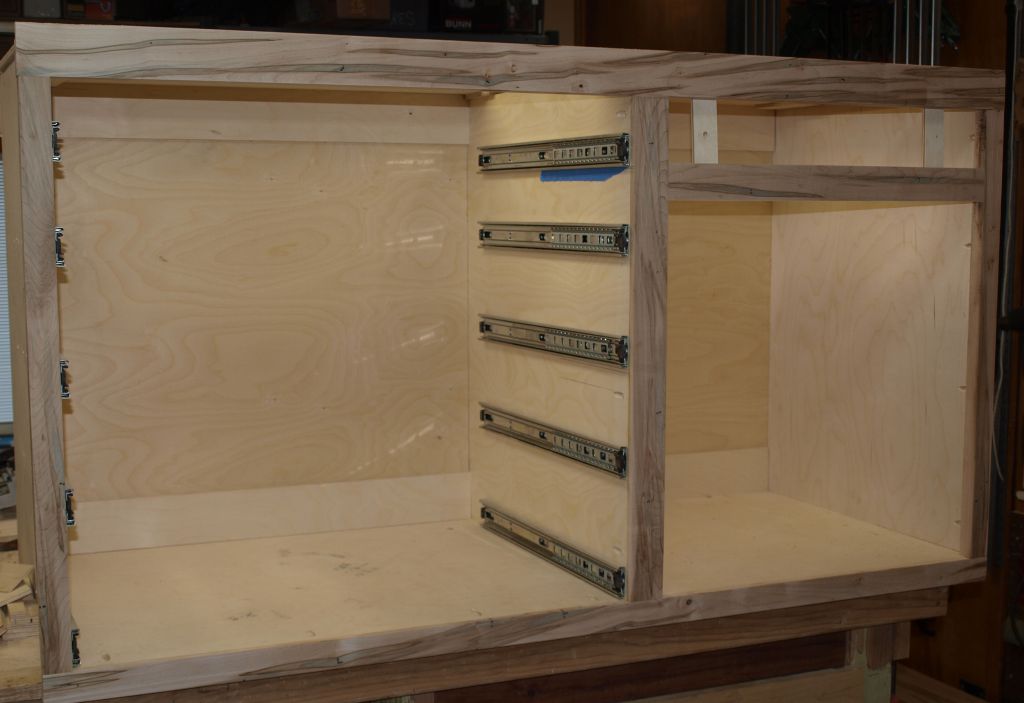

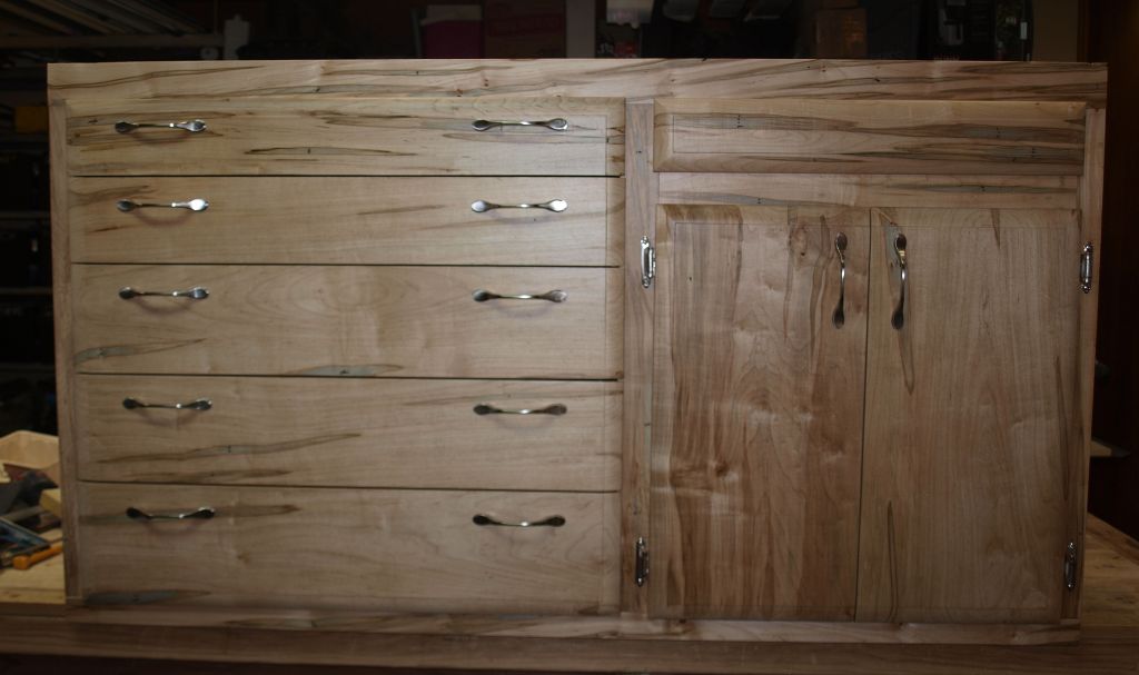

September 3, 201610 yr Author comment_71840 4 minutes ago, lew said: Nice! Is that Hickory ? Ambrosia Maple... Report
September 3, 201610 yr comment_71842 That's very nice. Is it a sink base. If it is how long has J been using the dish pan? Report
September 3, 201610 yr Author comment_71847 Bathroom vanity and it went into a space that was empty for more than 26 years... I got the job and it had to be done 2 months before I found out about it... Report
September 3, 201610 yr comment_71850 Stick that is some nice work man. Really clean and well done, look at those drawer reveals, perfect! Nice design too, it's splendid. Report
September 3, 201610 yr comment_71851 Looks good stick. To the best of my memory this is the first piece of your work I have ever seen you post. Report

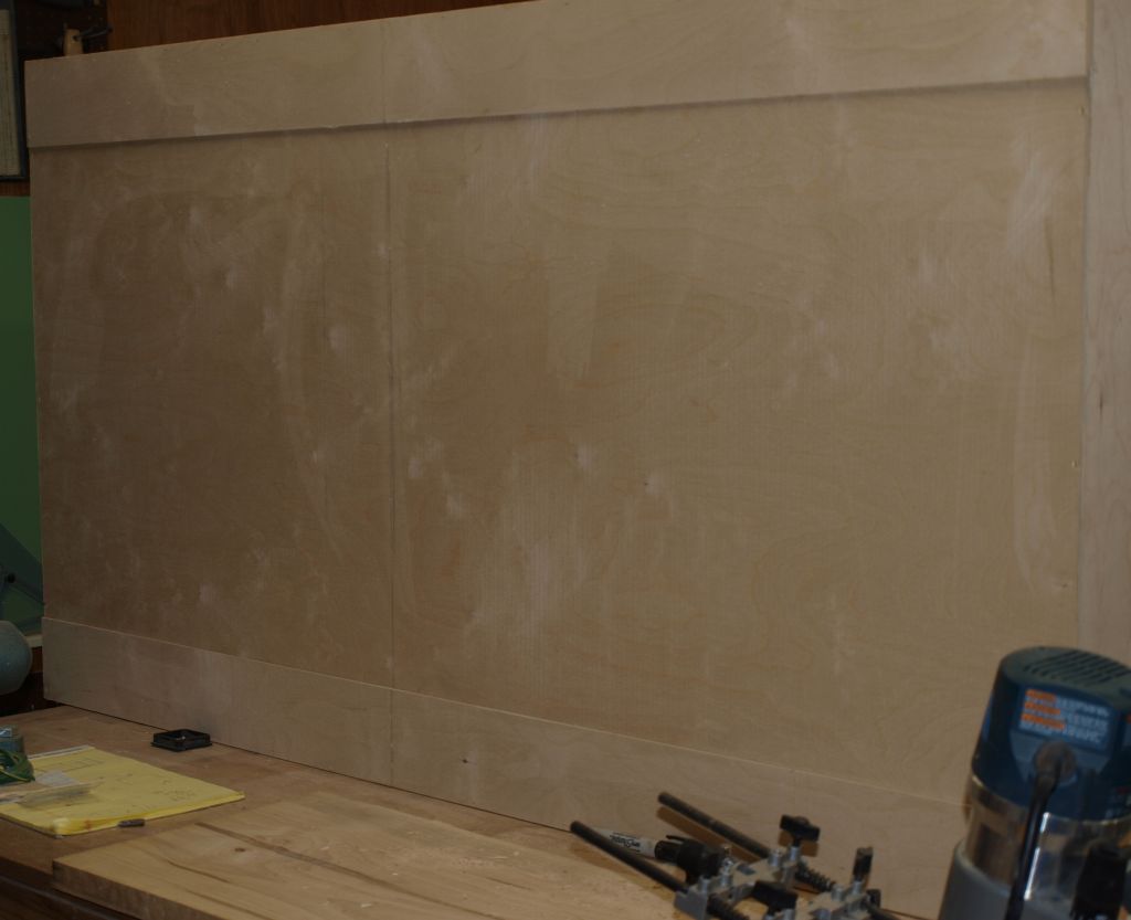

September 3, 201610 yr Author comment_71857 5 minutes ago, John Morris said: Stick that is some nice work man. Really clean and well done, look at those drawer reveals, perfect! Nice design too, it's splendid. and no plans... X wide... X tall... X deep... and this is how much material there is... now let's see what's in the left overs box for hardware... notice there is no base... Report
September 3, 201610 yr comment_71858 Just now, Stick486 said: notice there is no base... Why no base? Report

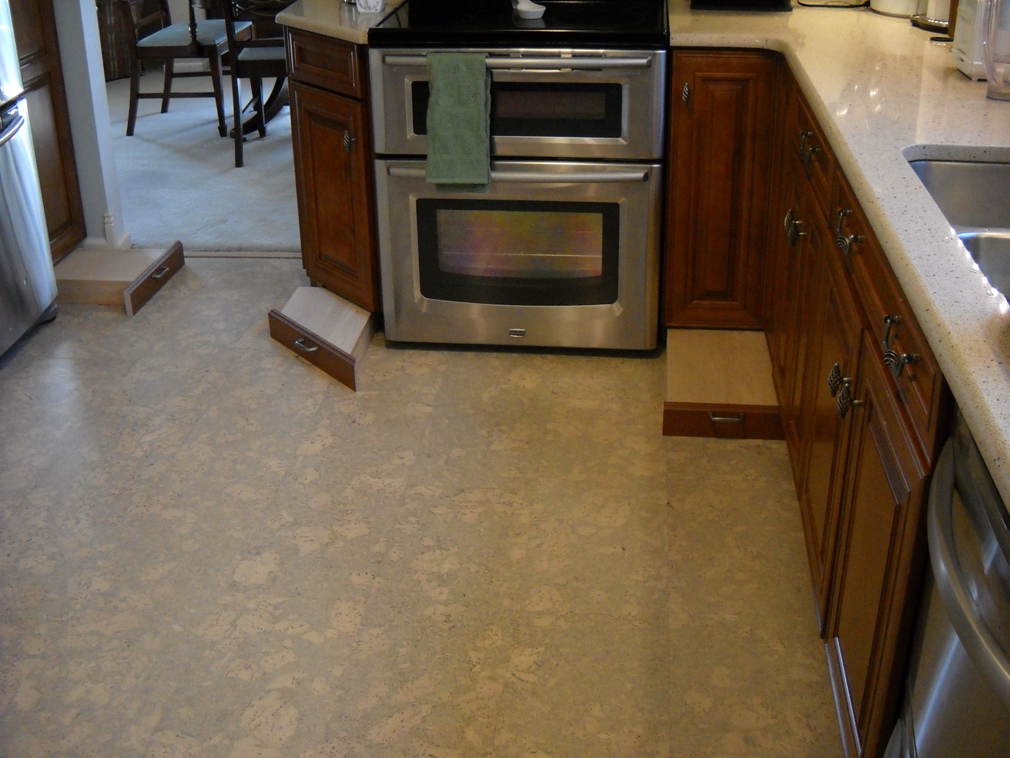

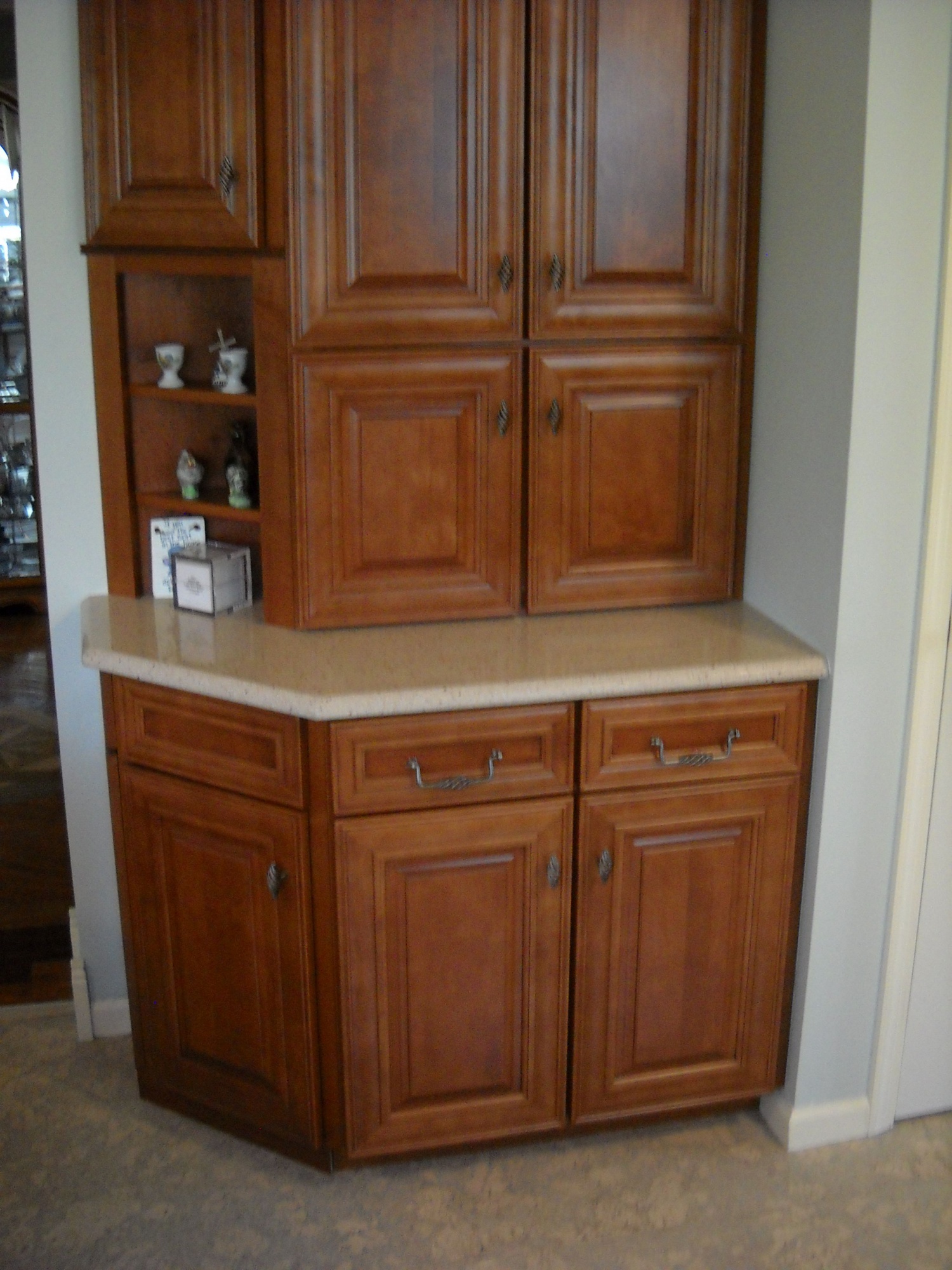

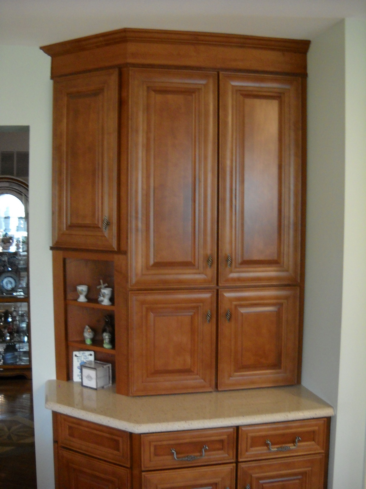

September 3, 201610 yr Author comment_71864 2 minutes ago, John Morris said: Why no base? bases are site built w/ the drops and cut offs... they also the get customization... step stools, security lockers, drawers, plumbing/HVAC chases and what ever else anybuddy can dream up.... installing and leveling the bases first is a lot easier than doing separate box set ups... makes for some fast accurate installation.. just park the box.. my boxes upper and lower are up to 12' long and configured as the customer wants them... saves assembly time and a serious quantity of material.. that cab is 74'' wide... here's cabs w/ drawers and stools... Report
September 3, 201610 yr comment_71866 Stick, that is how I install floor cabinets too, I build the base using 2x4's and shim them at the floor to level. Then I secure the bases. Then I mount the cabs on the bases, and during the trimming phase I'll fit the toe-kicks in under the base cabinets with the 2x4 bases as the backing for the toe kicks, I love doing it that way. That being said, if I can build a full width base cabinet I will, I don't like building standard 24" and 48" bases and install them in pieces, I'd rather fit the entire wall with one cabinet. Report

September 3, 201610 yr comment_71902 Definitely a nice cabinet. Wonderful specimens of Ambrosia Maple. Report
