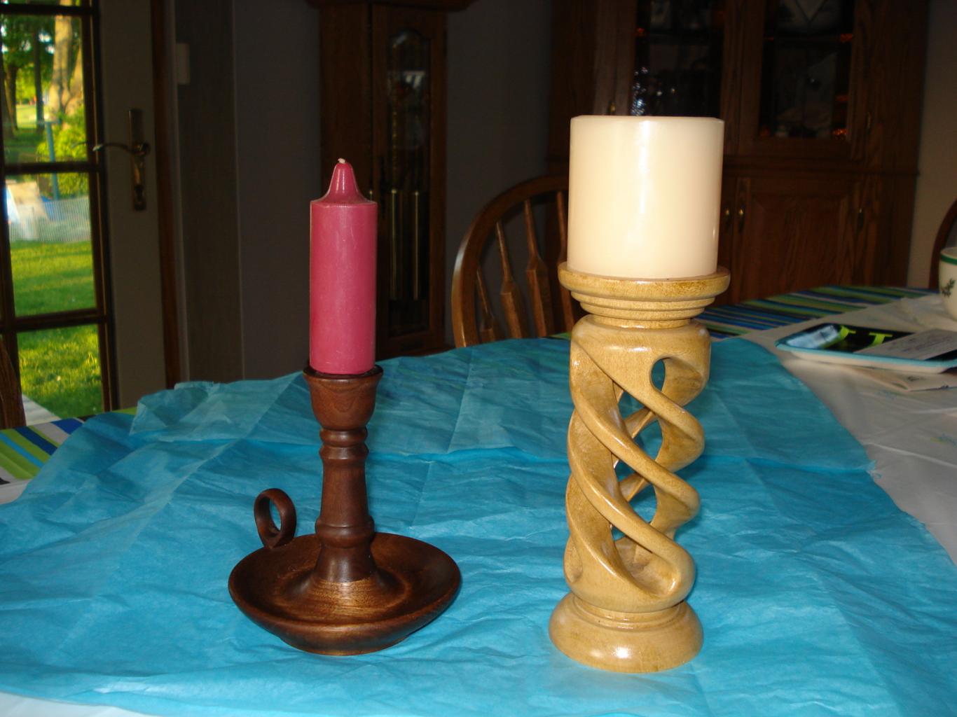

lew Posted September 3, 2016 Report Posted September 3, 2016 A couple of candle holders made on the lathe. Left one is walnut the right one is maple. Chips N Dust, Steve Krumanaker, Gerald and 1 other 4 Quote

HandyDan Posted September 4, 2016 Report Posted September 4, 2016 Those are fine. How is the spiral done? Quote
Steve Krumanaker Posted September 4, 2016 Report Posted September 4, 2016 Lew, I really like those. That maple one is amazing! How long does it take to do something like that? Steve Quote
lew Posted September 4, 2016 Author Report Posted September 4, 2016 1 hour ago, Steve Krumanaker said: How long does it take to do something like that? That's a question I should have asked myself before starting this project! The actual wood cutting process is very quick, maybe an hour after laying out the twist. Sanding, on the other hand, many, many hours. Steve Krumanaker 1 Quote
Gerald Posted September 4, 2016 Report Posted September 4, 2016 I love the twist . I have done some small ones but not an open twist. Got to try it once. Quote
lew Posted September 4, 2016 Author Report Posted September 4, 2016 1 hour ago, HandyDan said: How is the spiral done Dan, The plans were published in December 2001 woodworker’s Journal. You layout spirals around a cylinder. Then use a Forstner bit to drill along the spirals into the center of the cylinder. After all of the drilling is done, it leave the basic shape that needs refining. Thanks for asking. If you need more info, let me know. Quote

Pauley Posted September 10, 2024 Report Posted September 10, 2024 They’re beautiful. I can’t figure out how you did that maple one.. lew 1 Quote
lew Posted September 10, 2024 Author Report Posted September 10, 2024 23 hours ago, jim black said: I made the spiral candle holder many years ago but have misplaced the instructions, your help would be appreciated. Jim The plans were in the December 2001 woodworker’s Journal https://www.woodworkersjournal.com/woodworkers-journal-novemberdecember-2001/ I'll have to look and see if I have that issue somewhere Quote
lew Posted September 10, 2024 Author Report Posted September 10, 2024 @jim black I looked through all my old magazines. Couldn't find that issue. I'll keep looking on the web, maybe something similar will pop up. Quote
lew Posted September 10, 2024 Author Report Posted September 10, 2024 @jim black Here you are! SpiralCandle.pdf Quote
HandyDan Posted September 10, 2024 Report Posted September 10, 2024 16 minutes ago, lew said: Here you are! Thanks Lew. And I thought cane handles were a lot of work sanding. lew 1 Quote
lew Posted September 10, 2024 Author Report Posted September 10, 2024 2 minutes ago, HandyDan said: And I thought cane handles were a lot of work sanding. I made ONE of these- way too much work. I tried the router bit method but it was a miserable failure. The only thing that worked for me was 60 grit and up. HandyDan 1 Quote
