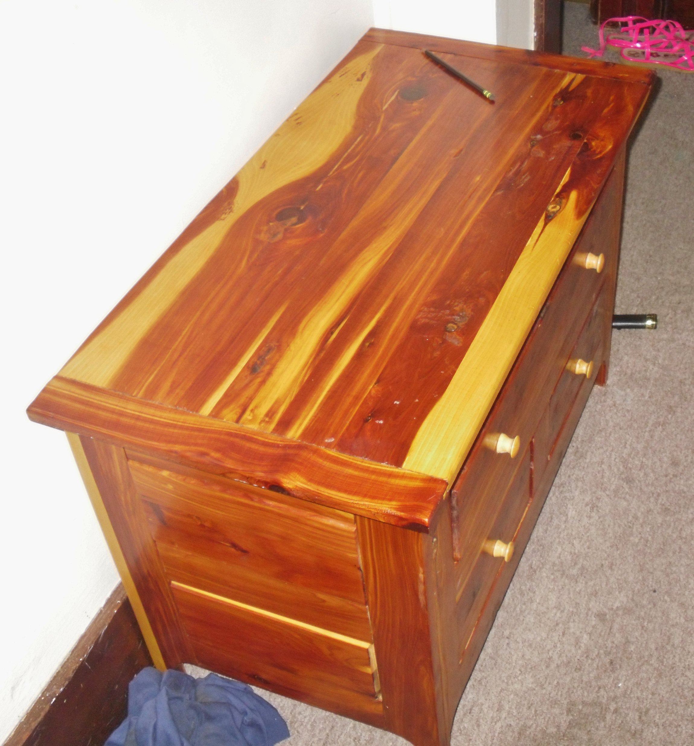

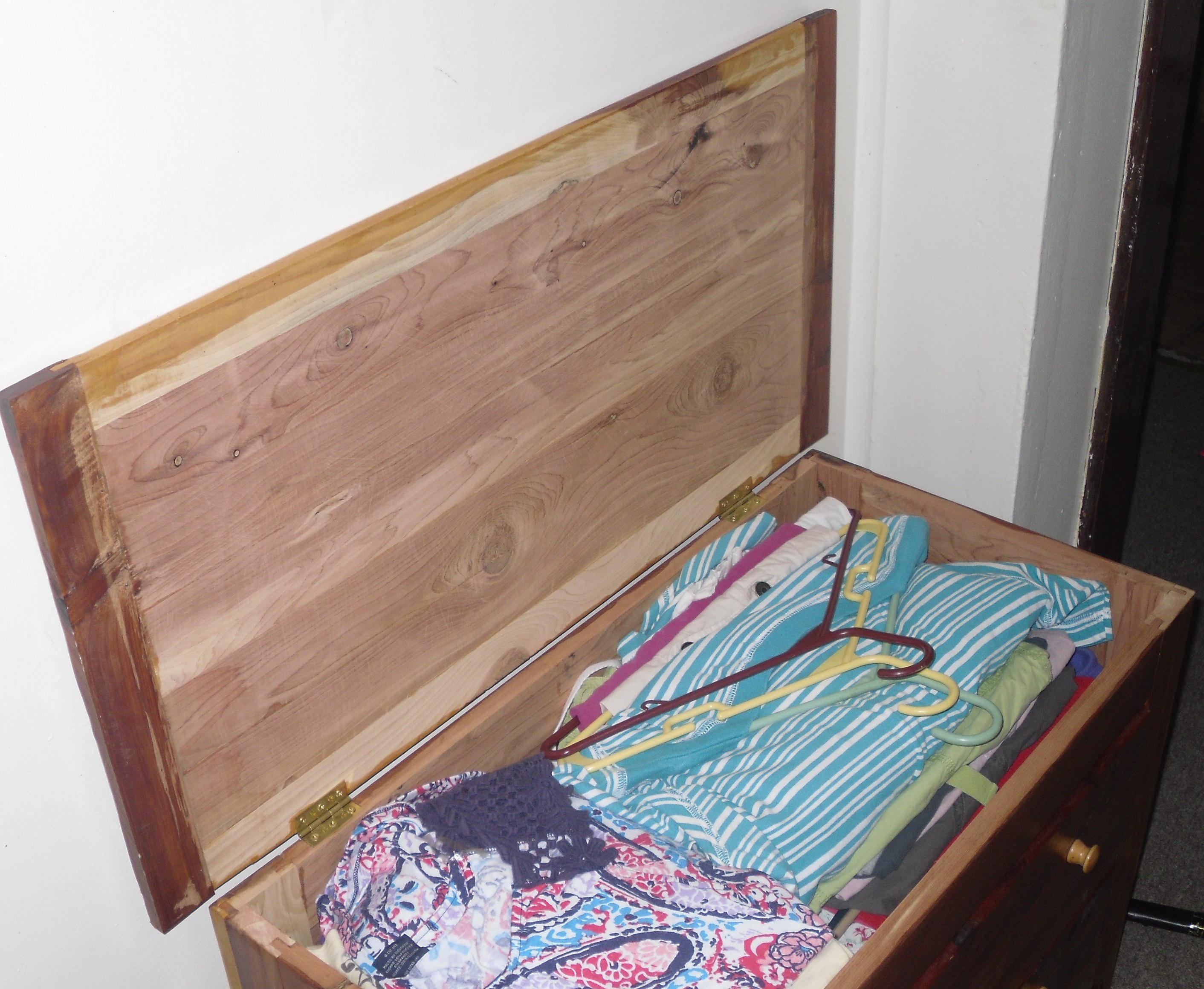

whatever you do, do not apply a finish to the cedar on the interior....or the whole point of a cedar chest is lost.
Like this?
Inside...vs..outside
Resawn from 2x6s into 3/4 thick boards

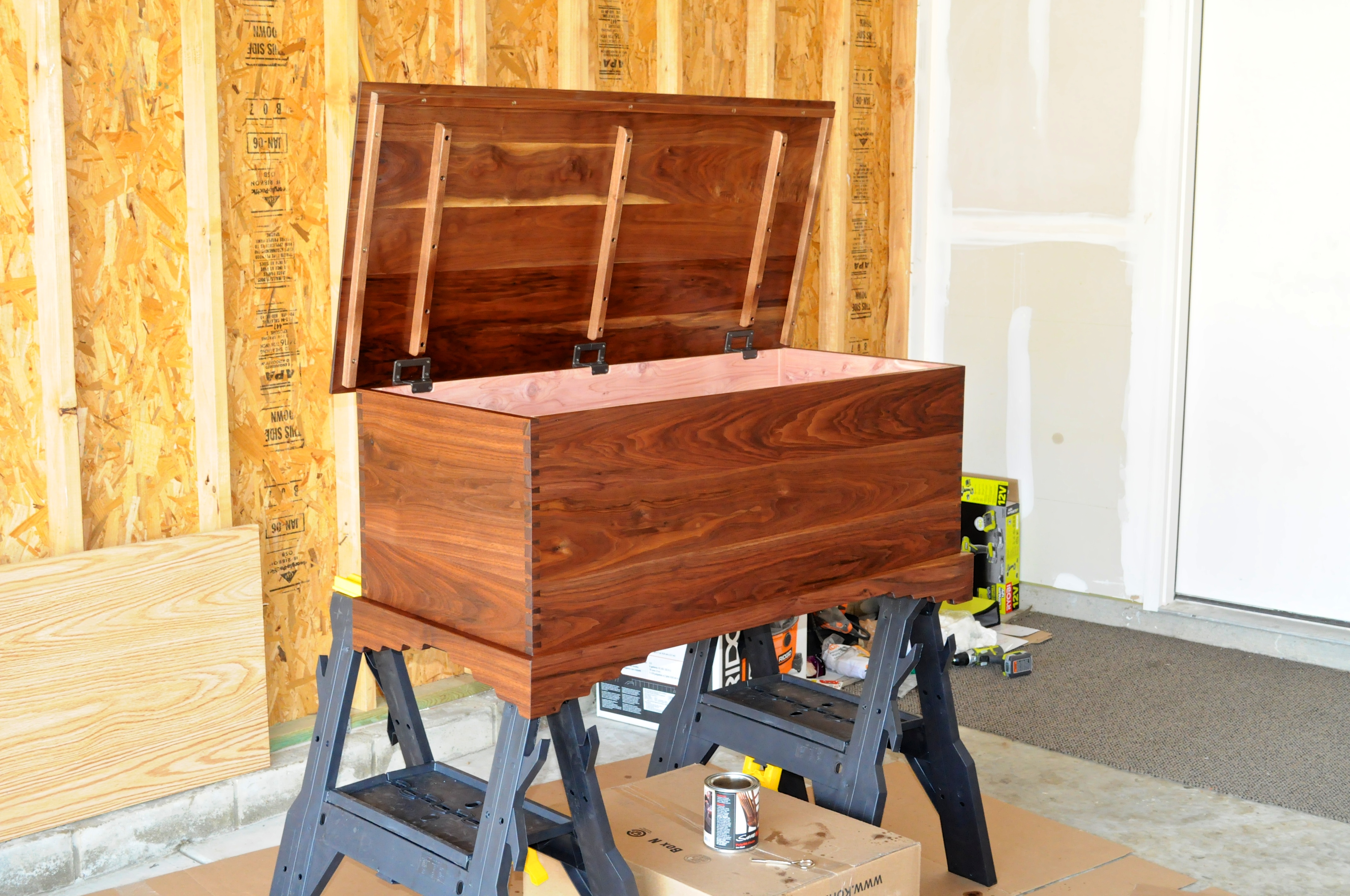

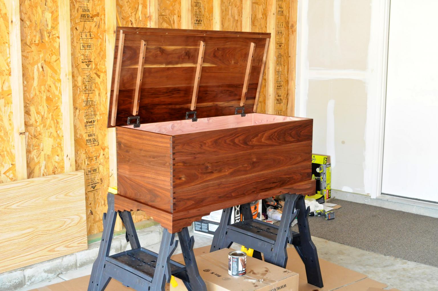

In July 2014 while my wife and I were on vacation to Indiana to see our son and daughter-in-law who was pregnant, we got together with Ron Dudelston and his wife Dorothy and we all headed down to Florence, Alabama to spend some time together John Moody and his wife Beth. While the girls did their girl stuff, Ron, John and I (mostly Ron and John) built an heirloom cedar lined walnut blanket chest for our soon to be born grand daughter. John Moody has made and sold a number of the blanket chests over the years so he has it down to a science. We did the main part of the construction in Alabama and then transported it up to Ron's shop to finish the trim and cedar lining and then I took it back to my son's house and put on the finish. The chest turned out great, but unfortunately my daughter-in-law had complications with the pregnancy and our grand daughter was born premature at 22 weeks and passed away while we were there. But the kids love the chest and have it all filled.
I did a 4 part post about the process, including the cedar interior, with pics if you are interested.
http://thepatriotwoodworker.com/topic/7616-tpw-team-project-part-1/#comment-836
http://thepatriotwoodworker.com/topic/7610-tpw-team-project-part-2/#comment-779
http://thepatriotwoodworker.com/topic/7604-tpw-team-project-part-3/#comment-730
http://thepatriotwoodworker.com/topic/7594-tpw-team-project-part-4-walnut-and-cedar-blanket-chest-completed/#comment-680
