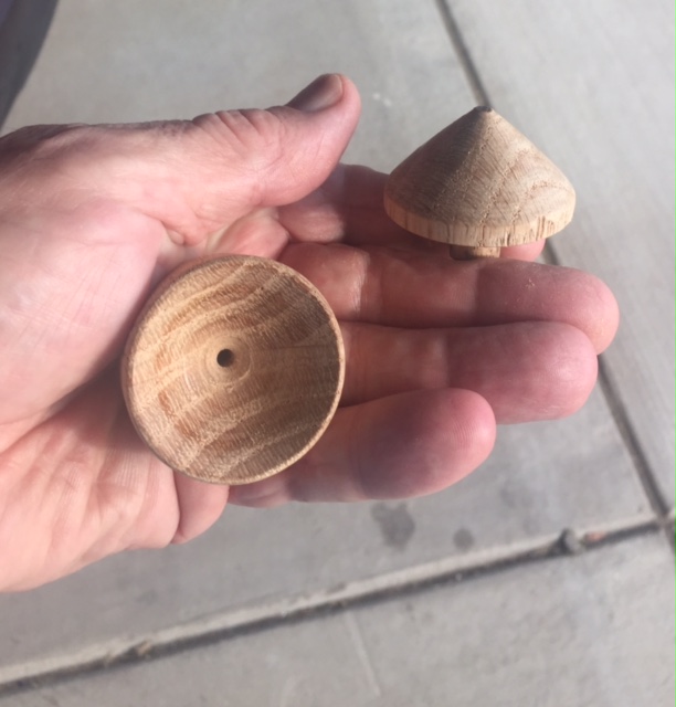

August 27, 201610 yr comment_70099 Gerald and I have discussed a tailstock support for delicate turning, such as tree ornaments. Your tailstock must have bearings to do this. I found some very stiff foam at Micheals that is 1" in dia and about inch long. I fashioned a holder made of oak, pressed the foam in and drilled a tapered hole to accommodate the piece. I have not tried it yet, but will report when I do. Report
August 28, 201610 yr comment_70133 Cool idea, Ron! My tailstock center is the bearing type but the point is not removable. I make a "cover" end to protect the turnings. I'm going to modify mine to look more like yours for some applications. Report

August 28, 201610 yr Author comment_70405 I did find that a couple of the tips were looser than others. However I only use a couple of them most of the time. There a couple that I have no idea what they are used for. I turned a couple of large ones out of Oak that work well, mostly in centering. The main tip holder with the bearings is true and tight. Report
