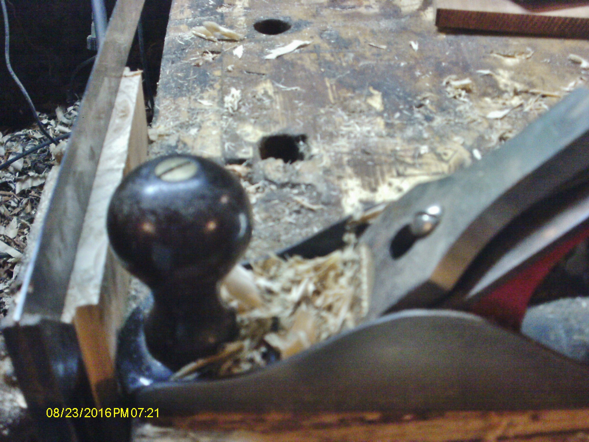

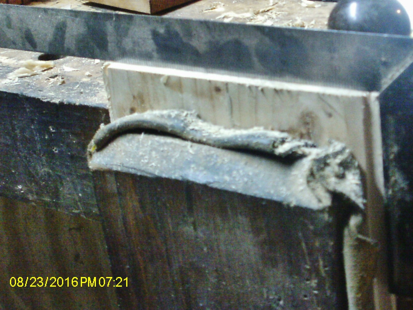

Ok, Laundry is out of the basement, I can go back to work.....Ends of the bottom panel needed a little plane work done..
Wasn't all that big.   The plane was made by Millers Falls for Sears, sold as a Craftsman.  The square was to check for any dippity=dos...Plane across end grain..
Looks good from my house...

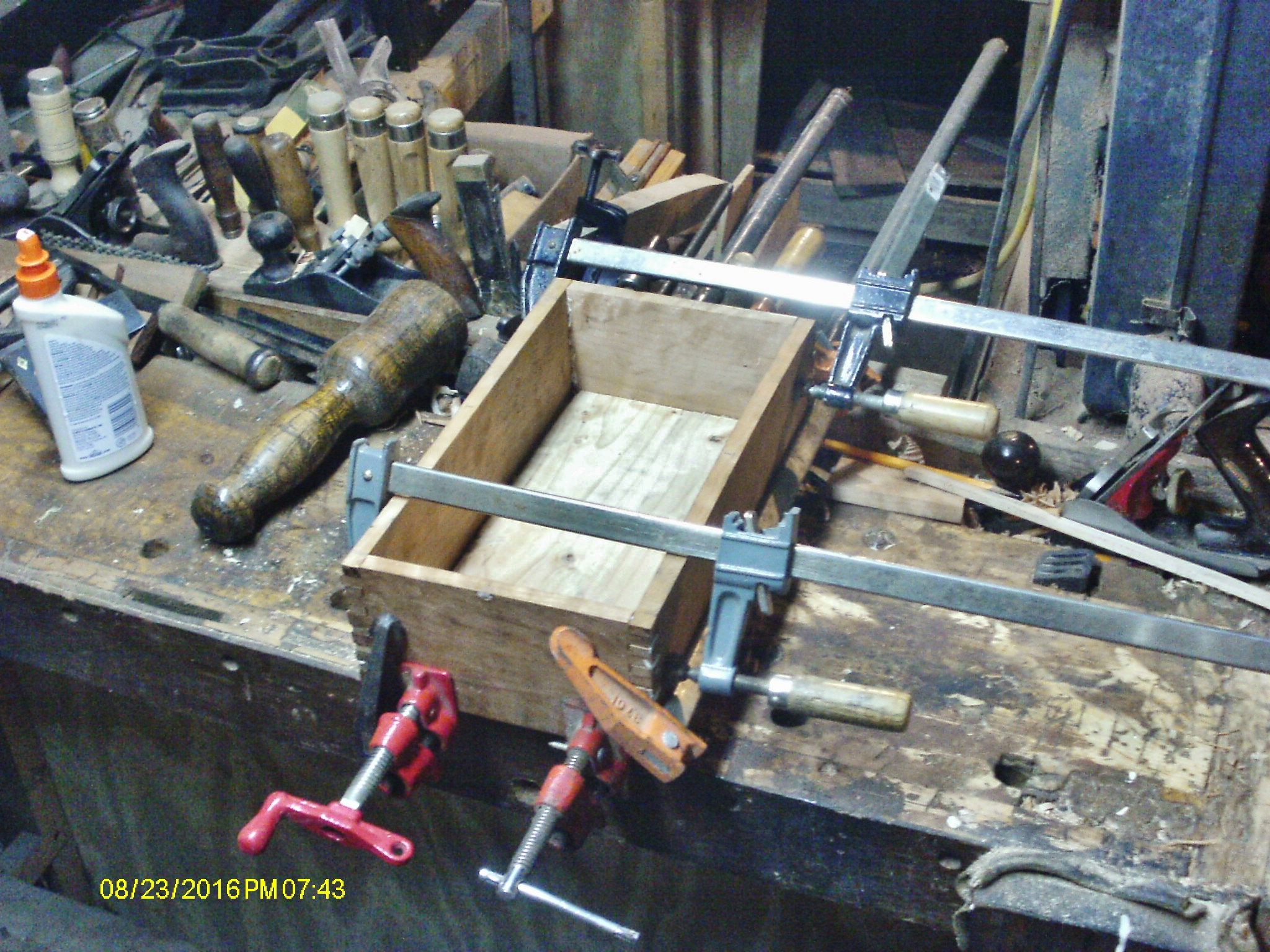

Panel also had a few high spots in the face grain....had, because I planed those flat , as well.   Did a little trimming on the box's sides for a better fit.   Might as well get the clamps and glue out
LOT of clamps..
Almost had enough.   Tried for square.....but the right side has a curve to it.  Diagonals looked good.   When this mess finally is out of the forest of clamps, I plane that side flat.

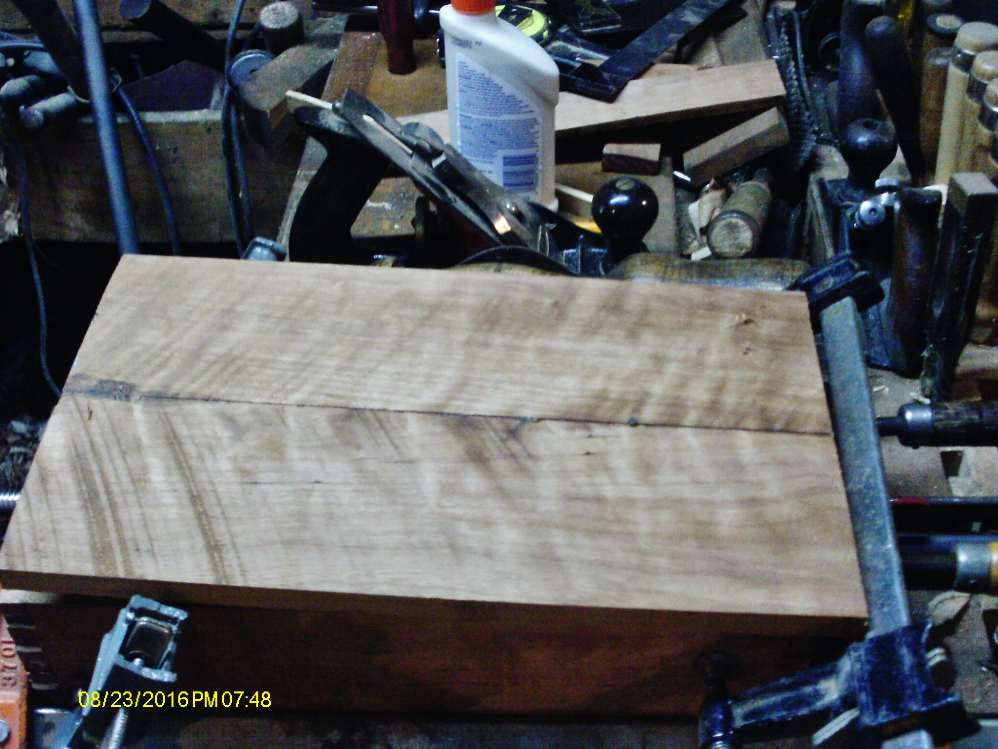

Along with all the other sides, and corners.  Maybe then, I can get the bench cleared off, as I have a lid to work on.   I now have a panel to mill up, for the lid
To be part of a frame&panel lid.  Might need a little plane work?
