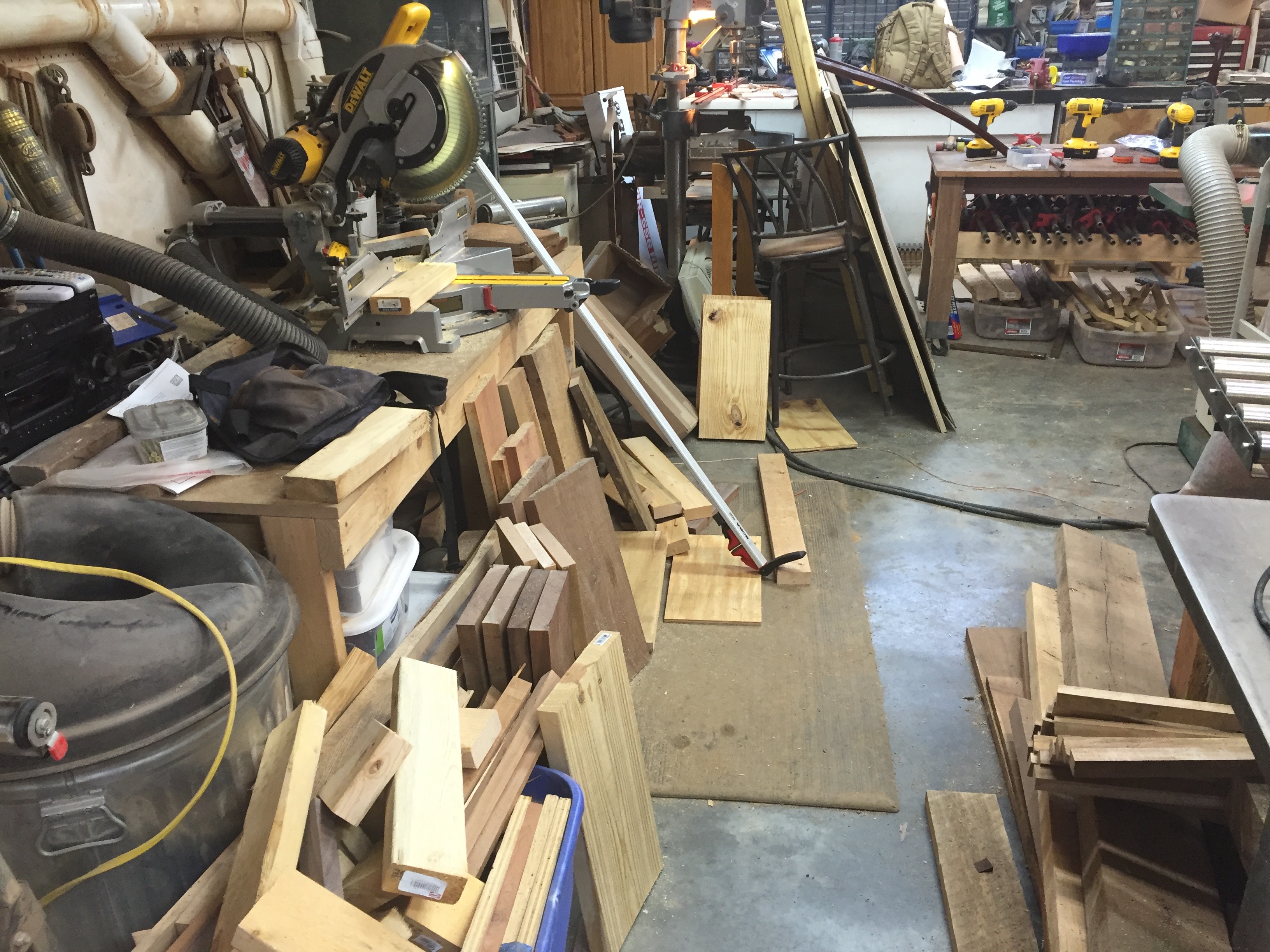

It is raining here again so no work on the shop expansion this weekend. Most of my time is going to be cleaning up in the shop and putting everything away that I have been using on the shop expansion. Shop is a mess right now.

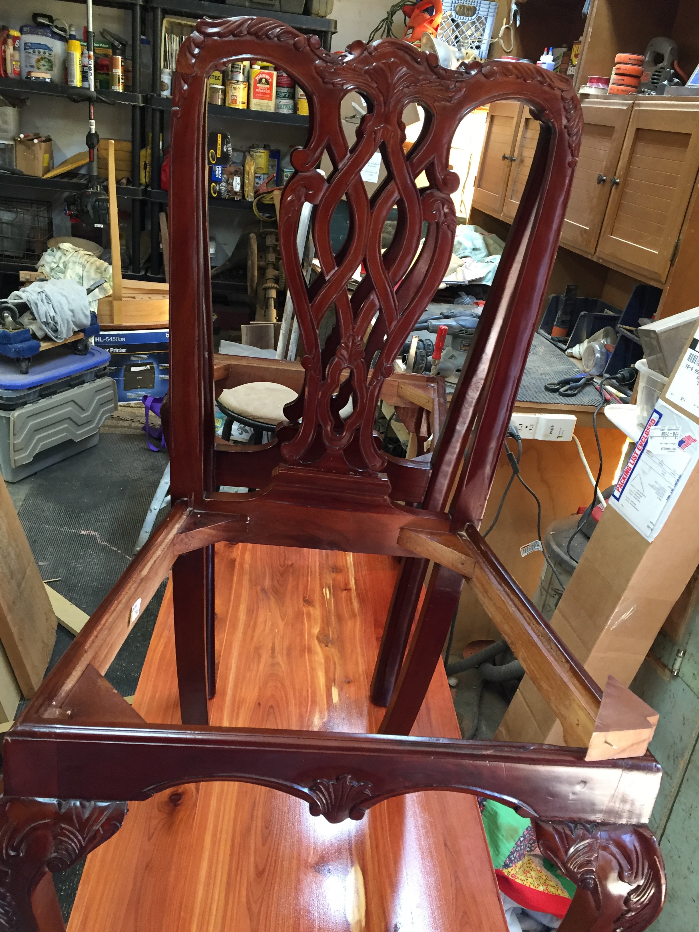

So while it is raining and I am cleaning up, I am also working on a chair repair job. I have two of eight chairs in the shop to repair.

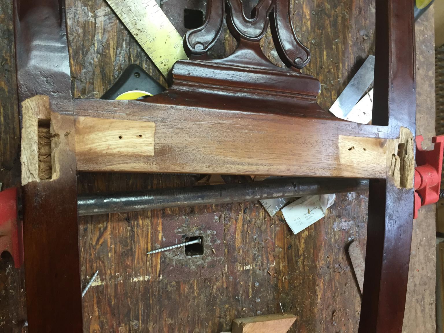

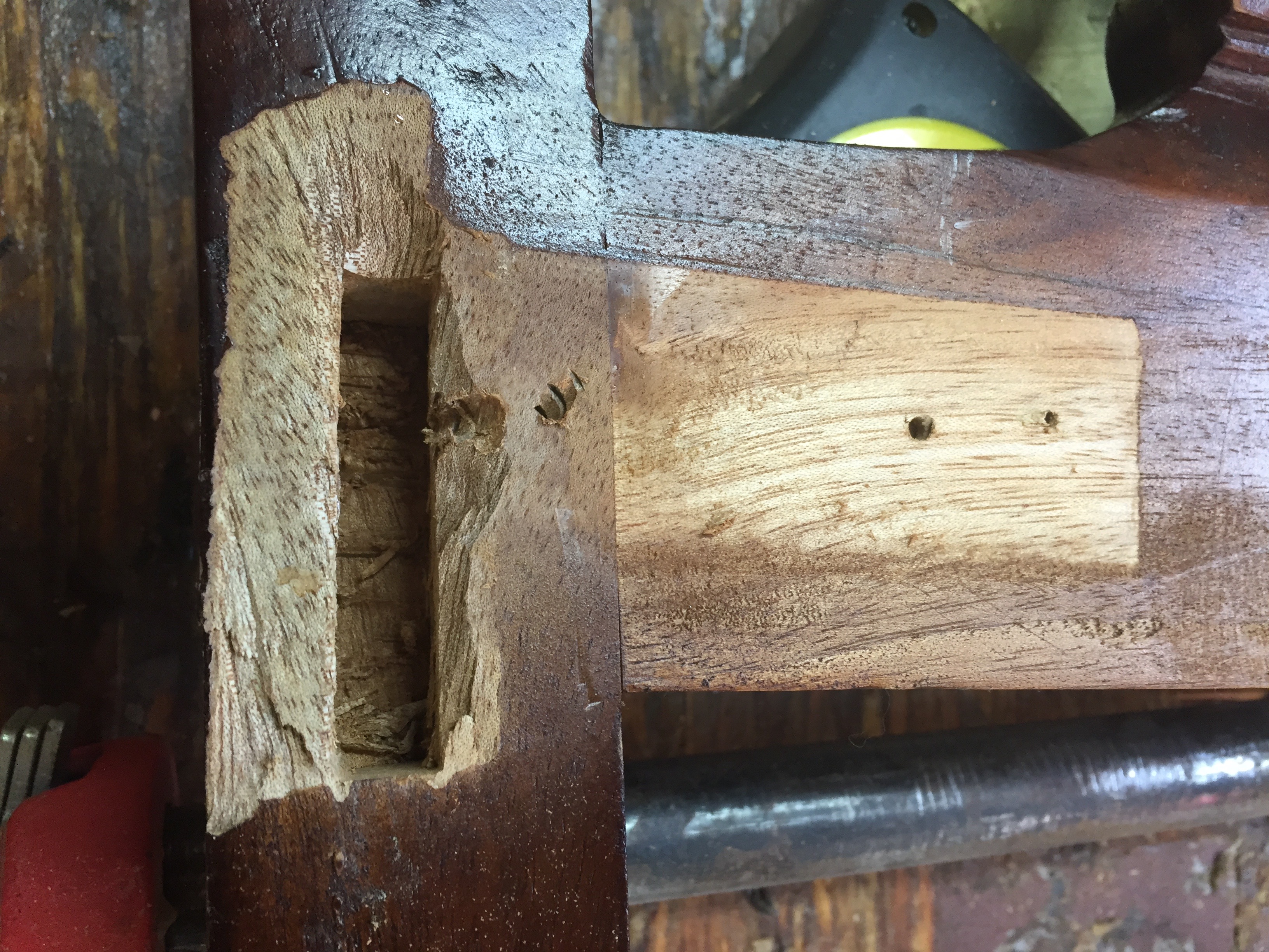

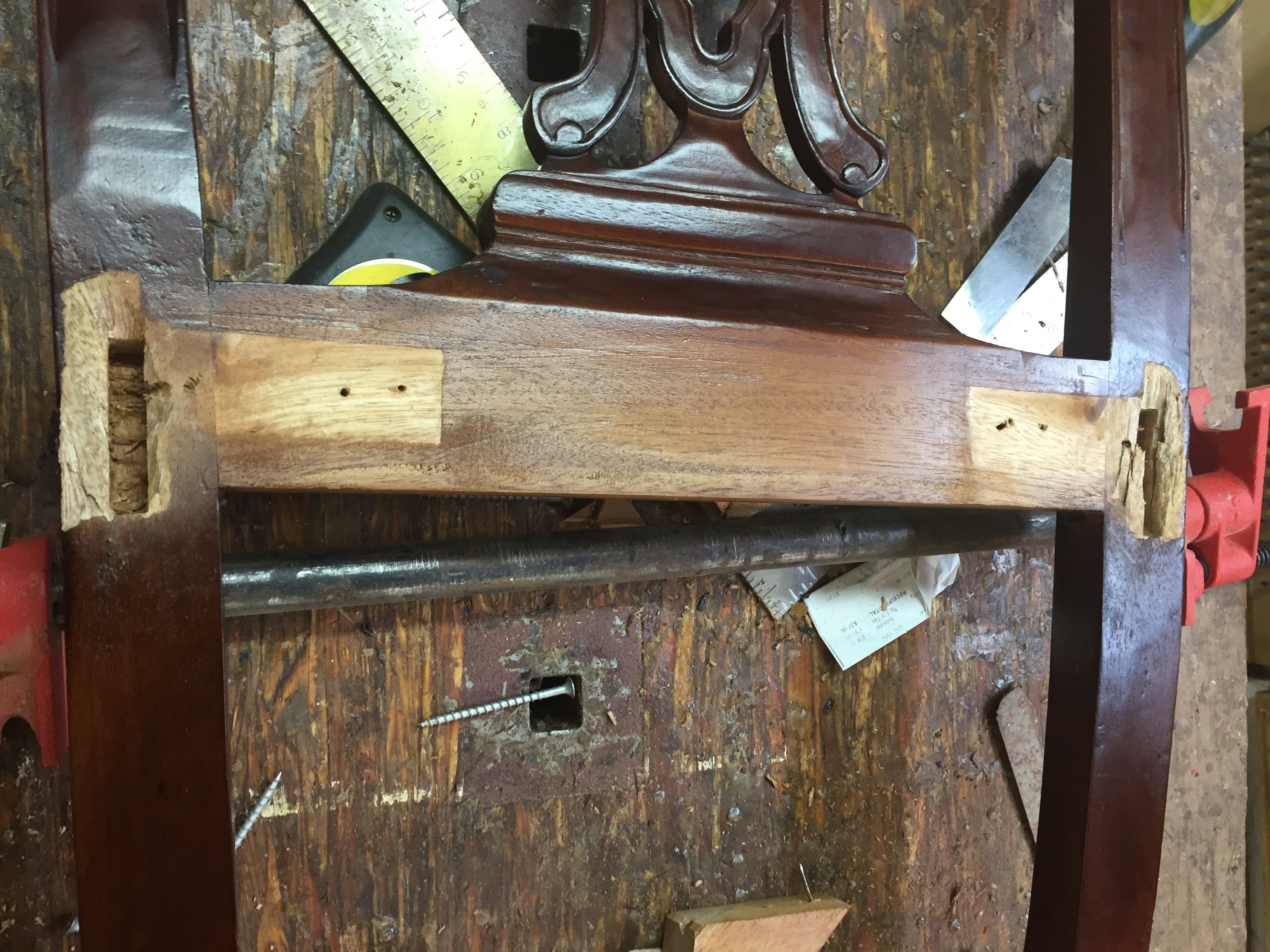

It seems that they have leaned back in the chairs onto the back legs and they have gotten loose. As I looked closer it appears the wood has split around the mortise and tenon joint.
When I removed the screws they had tried to fix them with the joint came apart pretty easily.
But it is easy to see where the wood and broken loose on the face of the mortise.

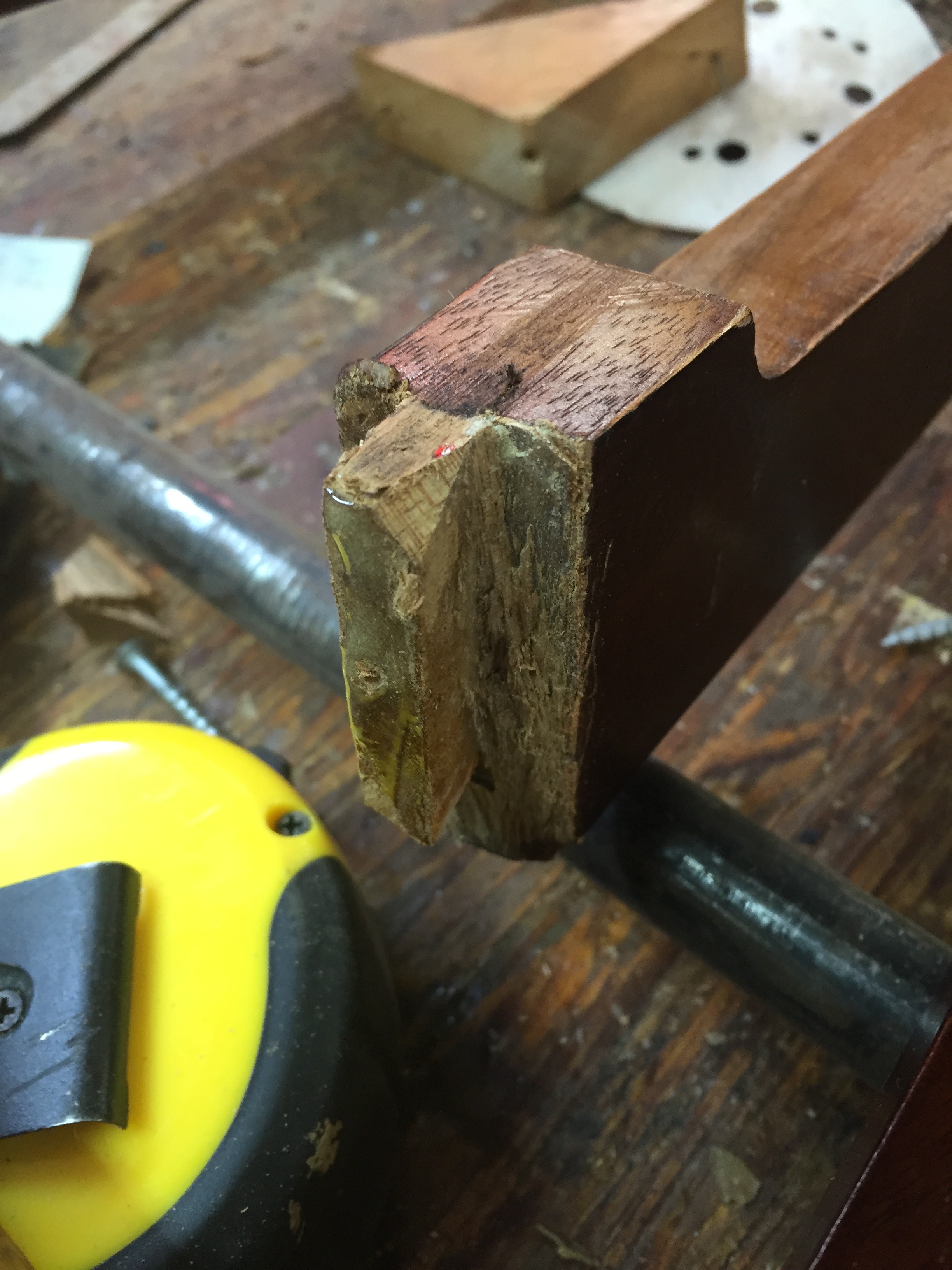

There was some epoxy on the end of the tenon so I am going to clean it all off and see if I can re-epoxy them and get them to hold. Just got to tell them you can't rock back on the back legs of a chair like this.

John, those tenons are worse that you described.

Good to see another repair guy, don't ya just love Gorilla glue and nails? Have dug as many as 50 nails from a single chair before.
1.. but there's no sawdust on the floor..
what's up w/ that..
can I suggest you skip the epoxy and face the rim of the mortise w/ new wood and replace the tenon w/ a floating tenon..
epoxy will separate from the wood over time if it's subjected to any more duress like the chair already experienced...
clean the rim w/ a router and rebuild w/ a wood filler or plate..
Thanks, that is a good suggestion. I'll see how it works out. There are eight of these to do.
Steve
I know they just keep throwing nails in it like the next one is really going to make a difference. I had a rocking chair recently to repair, the rocker was broken into. They put Gorilla glue on it and tried to put it back together. First time the rocked back it came off. You got to love it though.

There is more than you can see! But I do try to keep the sawdust up. I have several shop vacs around and after each process I get up what ever the DC didn't catch. Just a little OCD.
Warched this guy's build on YouTube. He had several holes to drill. After every hole, he carefully picked up the work piece and carried it to his trash can and used a bench brush to sweep the drill dust into the can.
Now, THAT'S OCD..but his floor was immaculate.
when I said wood filler I didn't mean paste or putty...
wood filler as in a piece of cut wood to fit...

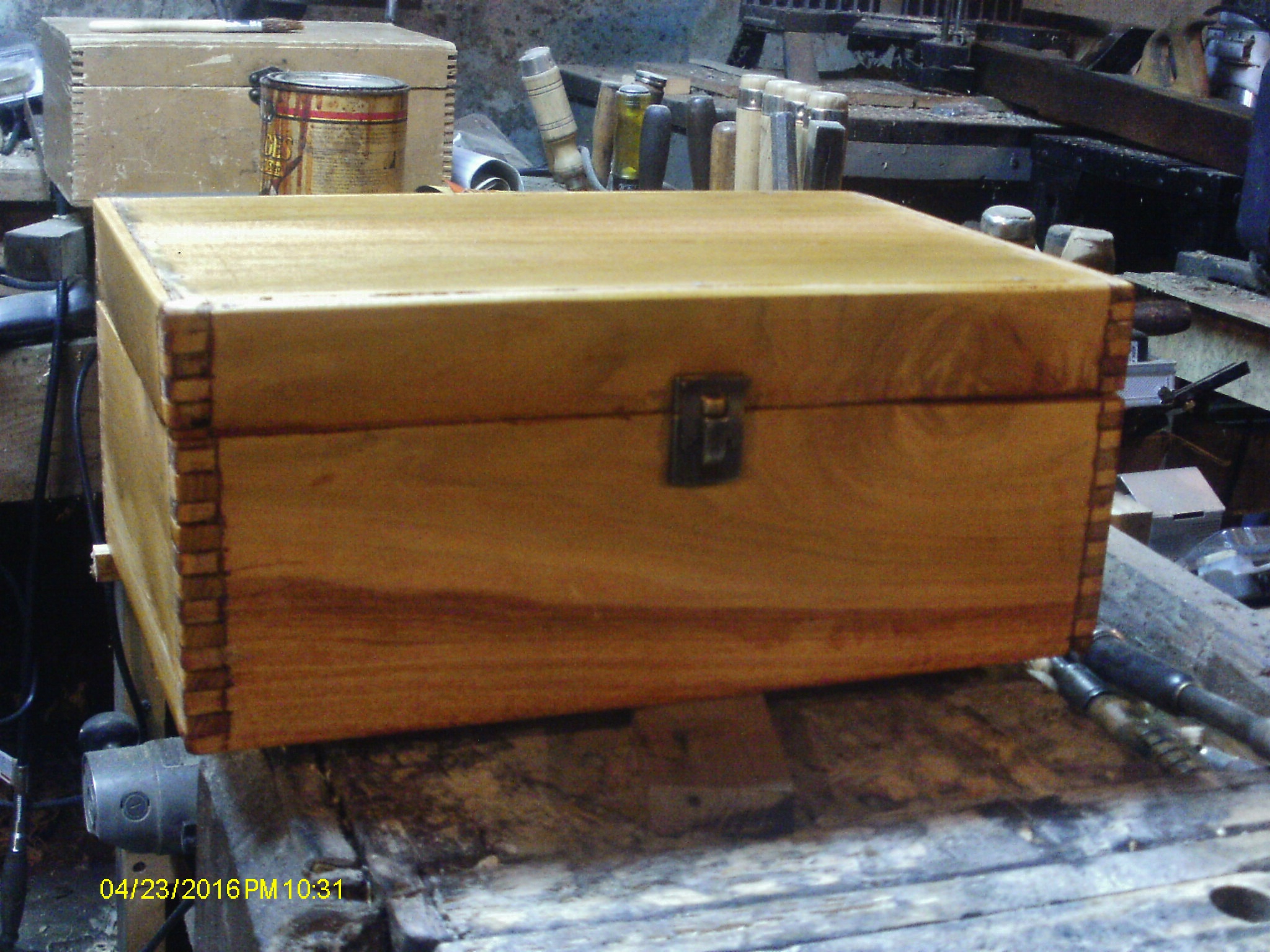

Too much running around today.   May just go down to the shop tomorrow, and lock the door behind me.    I could then just hide out all day long down there.    Well....as long as the Mountain Dews hold out...
Have a few finger joints to make.   Might give the Stanley #45 a try-out in cherry, cutting grooves to house a panel for a bottom.  Imagine a box like this, except in cherry..
This is the Poplar one I built to hold a Stanley No.45...the original box is in the background.   We'll see how the Cherry one looks.....
Another quote from me:
"There is a special room in Hell for people that put nails in chair joints.  And it's right next to the room for people that put screws in chair joints."
Mechanical fasteners don't keep joints from getting loose, but they do keep them from coming apart and concentrate the forces in one area so it's likely to break something right there."   I don't think I've ever seen a broken joint with a fastener that didn't break right through the fastener's hole.
