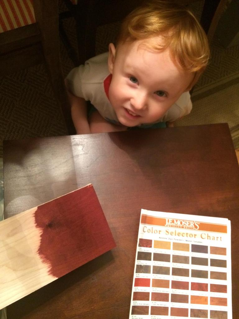

August 13, 201610 yr Author comment_67756 4 minutes ago, John Morris said: Is too red to even dilute it to make it work? Or is just plain ol too read to do anything with it? I am going to try dilution in the morning but I will need to pull some brown in for sure. Here is a pic of what I've got. The red is a little more intense in person I think. Report

August 13, 201610 yr comment_67759 It's not bad though, I can definitely see how you would purchase a redder dye, I see it too in the original piece. Let us know how it works out by knocking down the pigments with dilution. Report
August 13, 201610 yr Author comment_67760 I will. It is tough comparing the colors on a computer screen when you have never used them before haha. Live and learn though. Report
