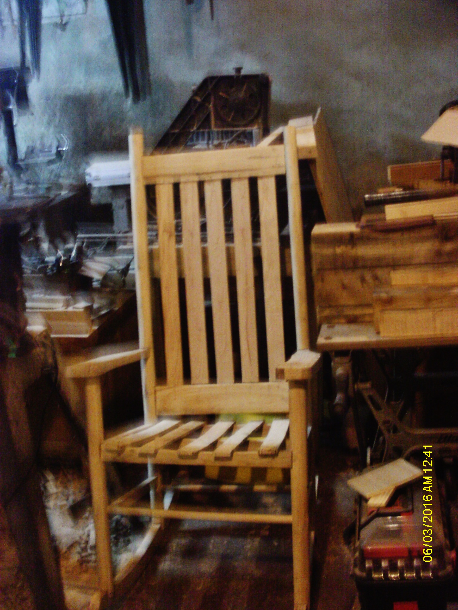

Seat slats aren't looking right, went and made 4 extras, and go with 6 in the seat...sometime.
