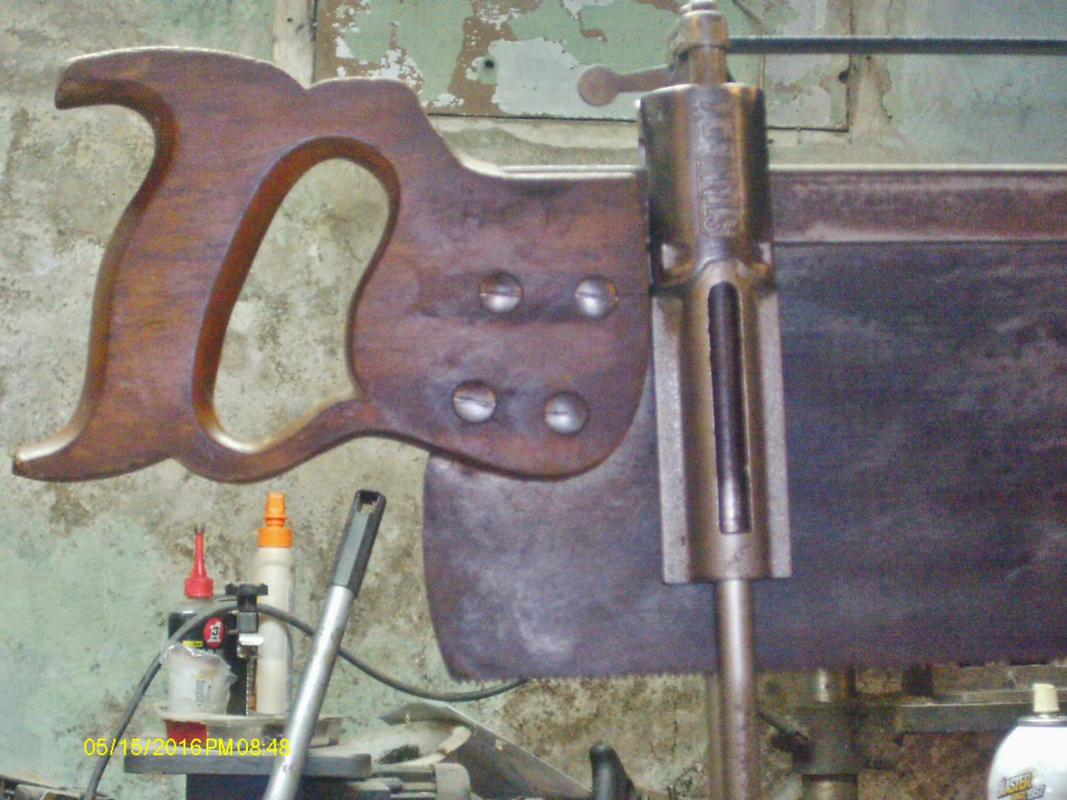

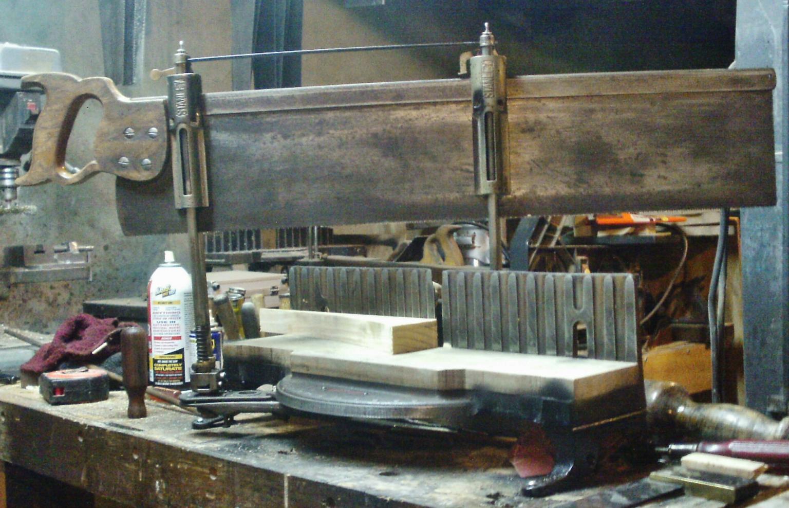

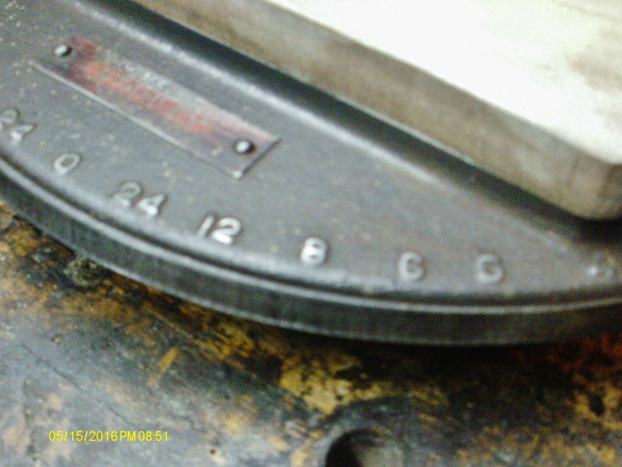

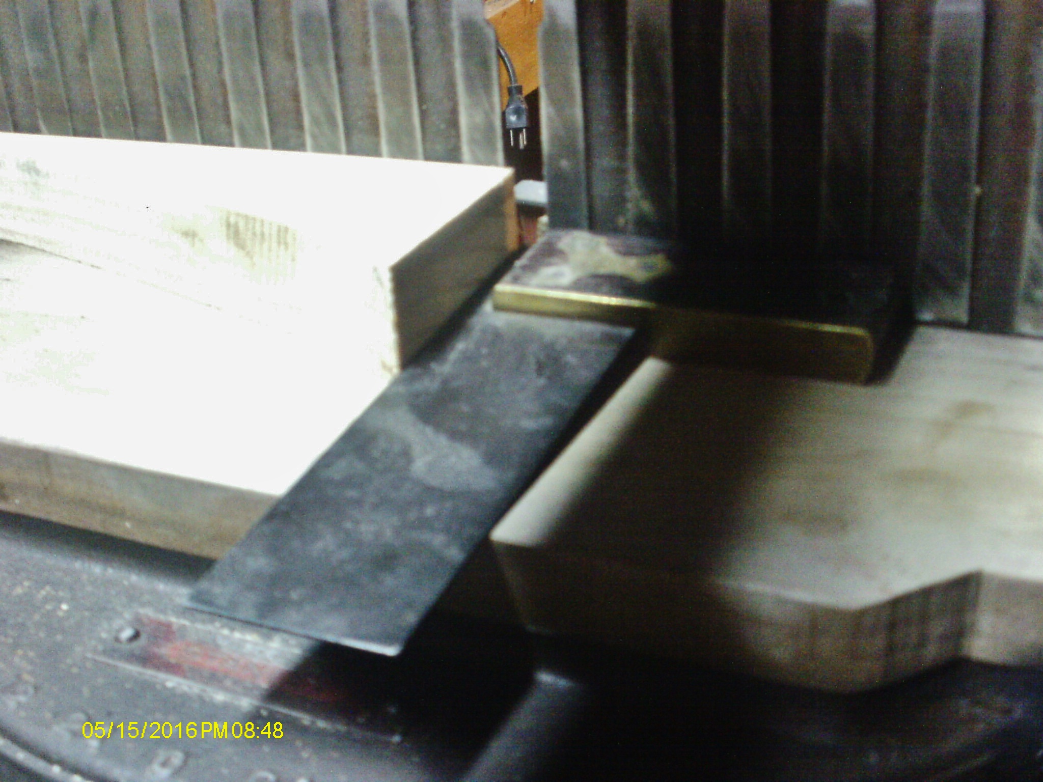

May 16, 201610 yr comment_66380 Took a while, these are a bit more work to do than a simple plane rehab. A few photos of this HUGE saw? About as far as I think I'll go with this saw. Any further down in the tear down would involve too many spring-loaded thingys to fly off into parts unknown.. Gave it a test drive at 90 degrees...yep, still works. That long saw sure takes up a lot of room, though. Cleaned the bolts, and then clocked them. The "STANLEY" needed to have a lot of rust wire wheeled off of it. Got a new( too thick, Grrrr)poplar deck, attached with 12 screws. New bolts to attache the legs. The bar across the top of the guides is some 1/8" thick by 1/2" wide flat bar weld stock. Two new thumbscrews are there to hold the bar in place. Setting numbers have been cleaned off, so I can at least READ them.. may go back and add some paint into the degree scale below them? Now, I need to clean up three other HUGE backsaws. Have one on "soak" cycle now... Report
