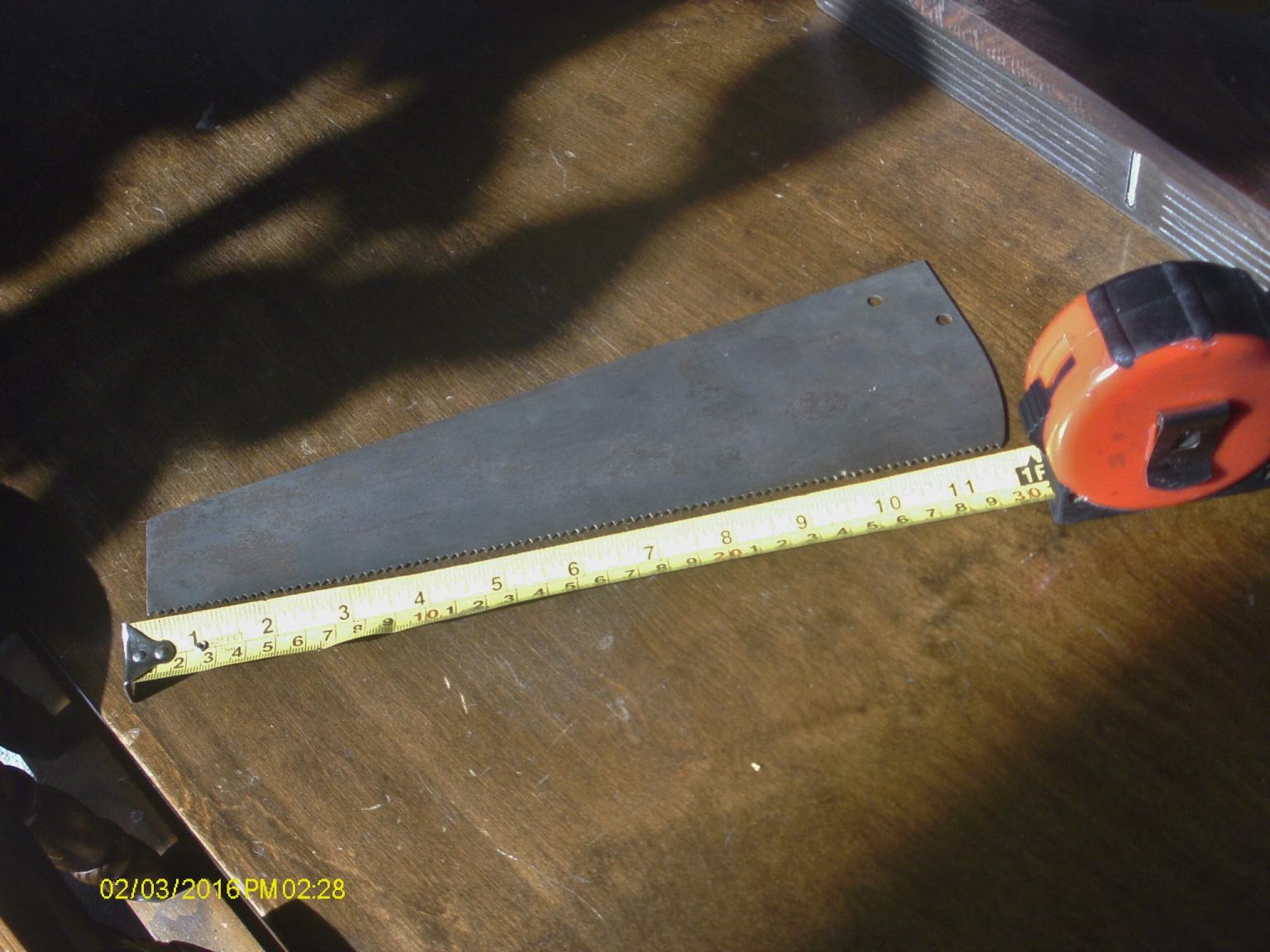

Started out with a saw plate that came in the mail..
56b3dba56700a_sawplate.thumb.JPG.1257214

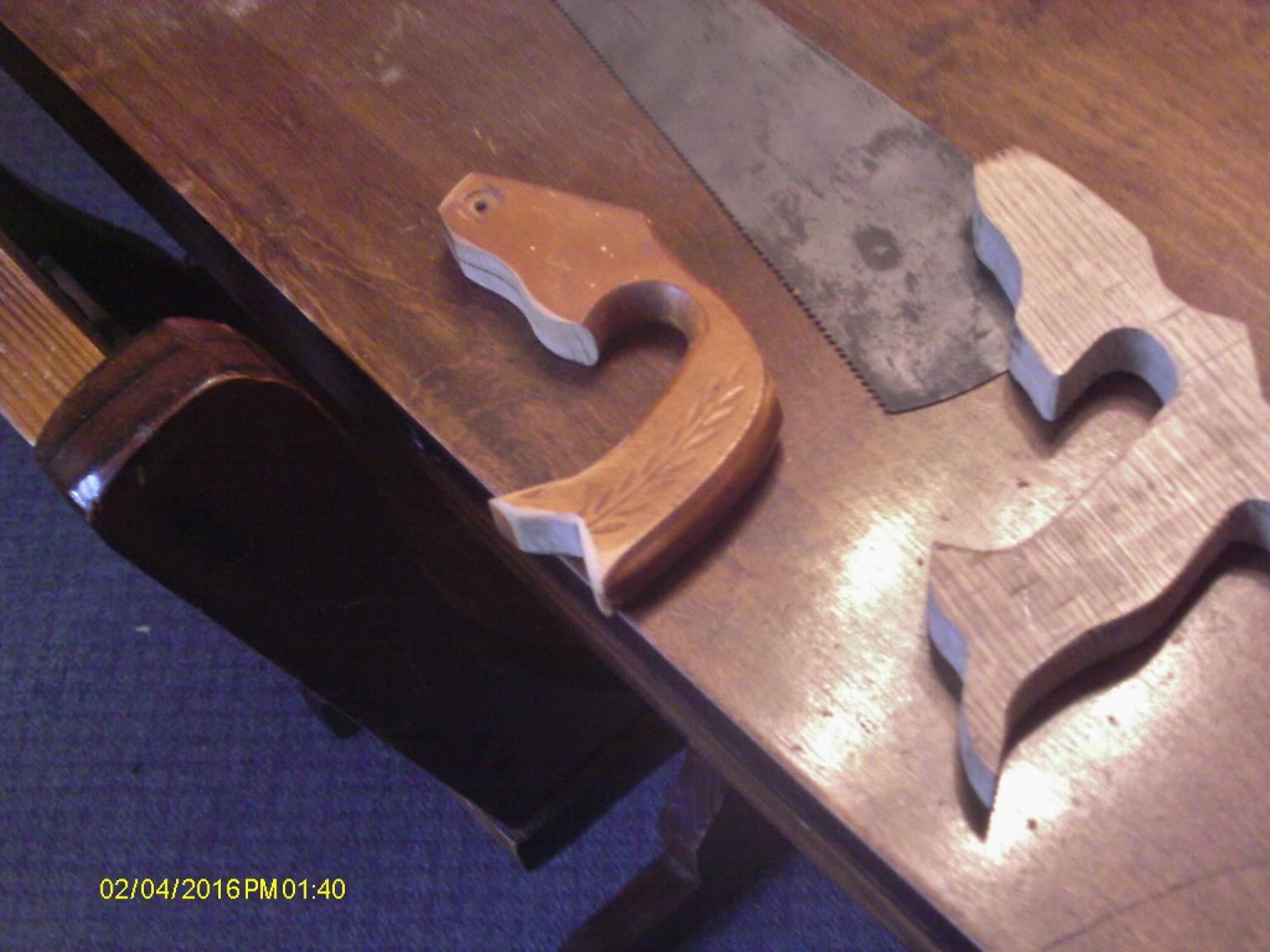

12" long, 9ppi, two holes for bolts.  Worked on straightening the tooth line, had two smallish kinks.   Got to thinking about maybe a handle, to make saw a little easier?

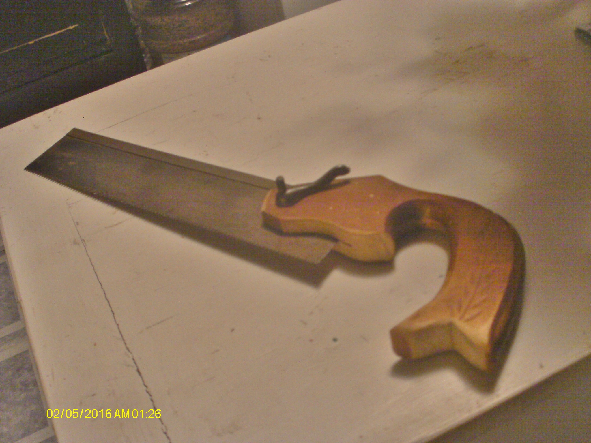

prototypes.thumb.JPG.ea2b2c5ee3558c3d547
Came up with these two items....one was just a cut-down nest-of-saws handle, the other was what I sketched out on a slab of white oak. I think it looks a bit better.
Router bits to start to shape it down, beltsander to sand away all the marks from the DULL router bit.  Whole LOT of sanding going on...
Finally, it felt good enough in the hand.    Clamped it into the vise, used a backsaw to cut the kerf for the saw plate.   Fitted the plate to the handle, time for a finish?

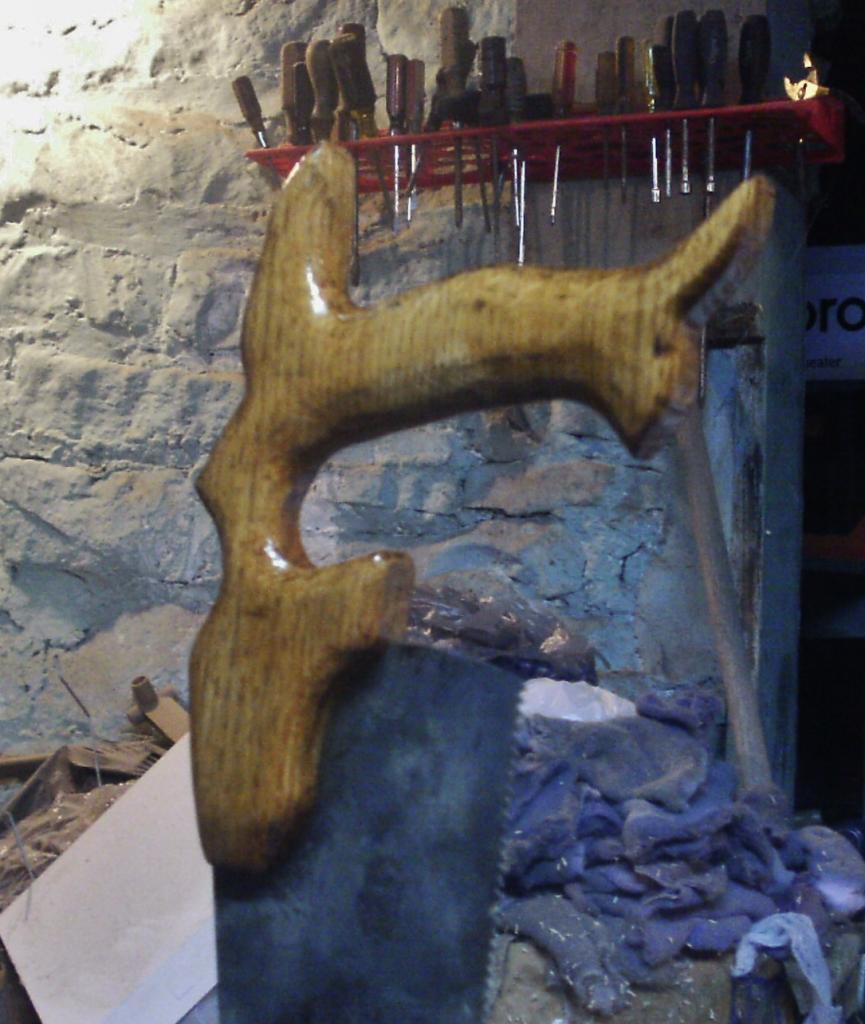

56b3dd6f26189_rightside.thumb.JPG.74574f
Coat of Witch's Brew.    Nice way to hold it while the finish dries.  Other side?

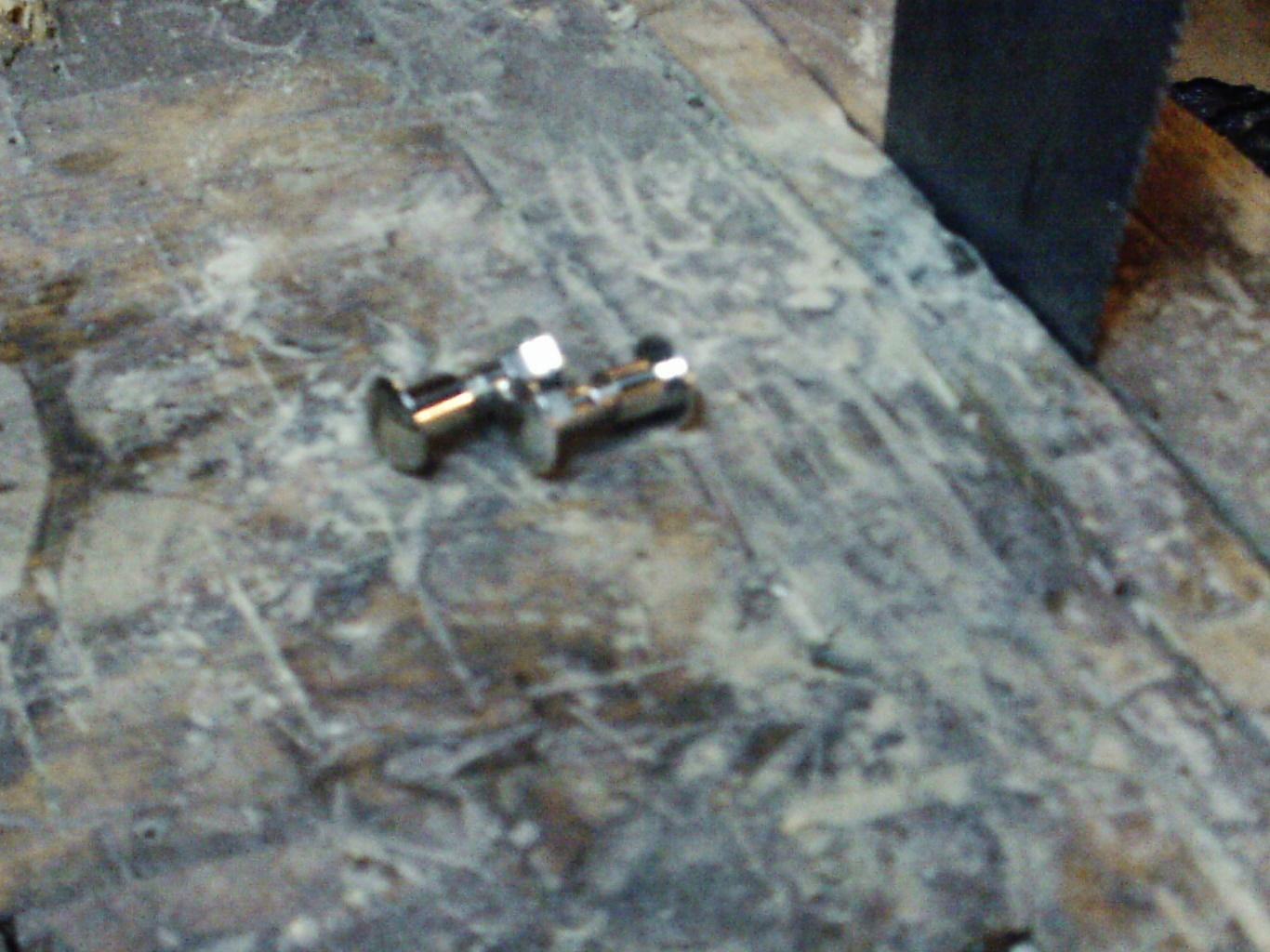

Still have to round up a few drill bits, to drill two holes...
56b3ddf992def_sawbolts.thumb.JPG.79e13aa
As I have two chrome bolts to install.    Don't have a medallion, not really needed.   Just playing around with a slab of Oak...

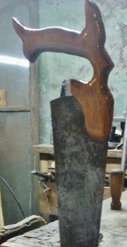

Sweet. My problem would be figuring out where to drill the handle to match the holes in the blade.
Not much of a problem

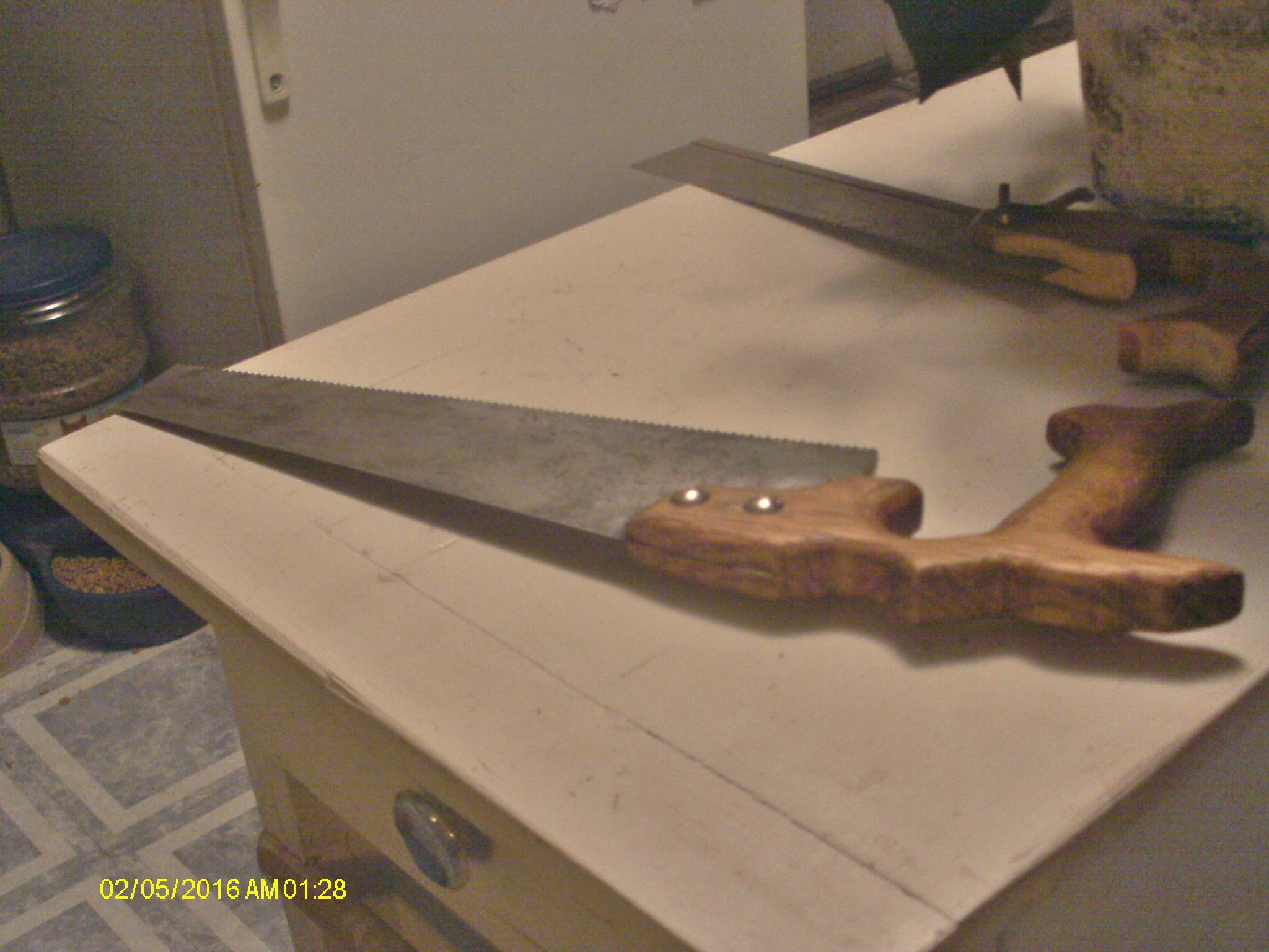

56b4453e2682c_newhandle.thumb.JPG.bf7e7e
I just drilled two new ones...other siide view?

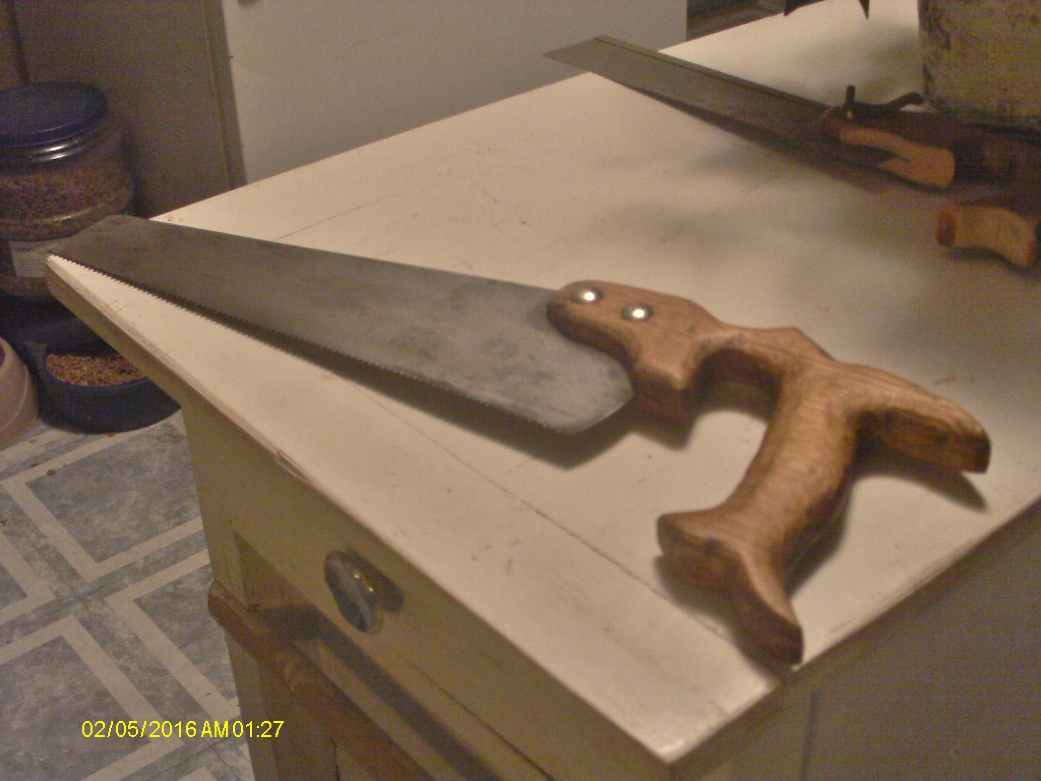

56b445883bbf2_theotherside.thumb.JPG.7eb

Just realized how you did the bolts on the new handle. Thought you would use the old blade holes over again. Your way is much easier!
Looks like a nice and comfy handle Steve, what condition is the saw plate, looks pretty good, sharpness?
Plate had a couple small kinks in it, and too much set to one side.    it will cut decent enough, a bit fast and rough, be a decent enough toolbox saw.
