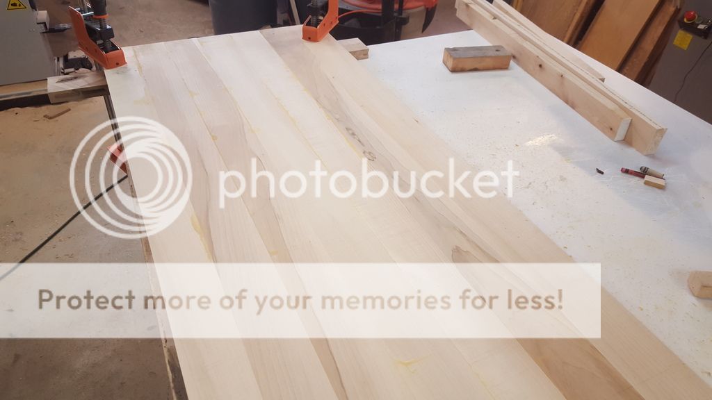

My sister has me making a heavy duty kitchen work table, for her minister. He wanted a butcher block top but with random lengths pieces. The top is 30" x 72". 1 1/2" thick. The strips are a little over 1 3/4" wide. Clamping across the strips, as well as the length, really is time-consuming. I can only glue a strip at a time. I'm making the top in 4 segments so I can run them thru the planer and get everything pretty flat. I'll finish up with belt/random orbit/hand scraper (I hope!)

Splines. Thought about the finger joints but opted for the spines (didn't have to buy a special router bit). I'm using a few full-length pieces interspersed in the field and one on each outside edge.
The top and the curse of plentiful squeeze out  I used maybe 2/3s of a  quart of glue on this.
THE CURSE OF THE SQUEEZE OUT  is how to get rid of it
I usually use a little crank neck chisel I made by bending the tang  But I noticed that some of the squeeze out was adhering so well that it bulled wood up with it so ~~~~~~~~~~
