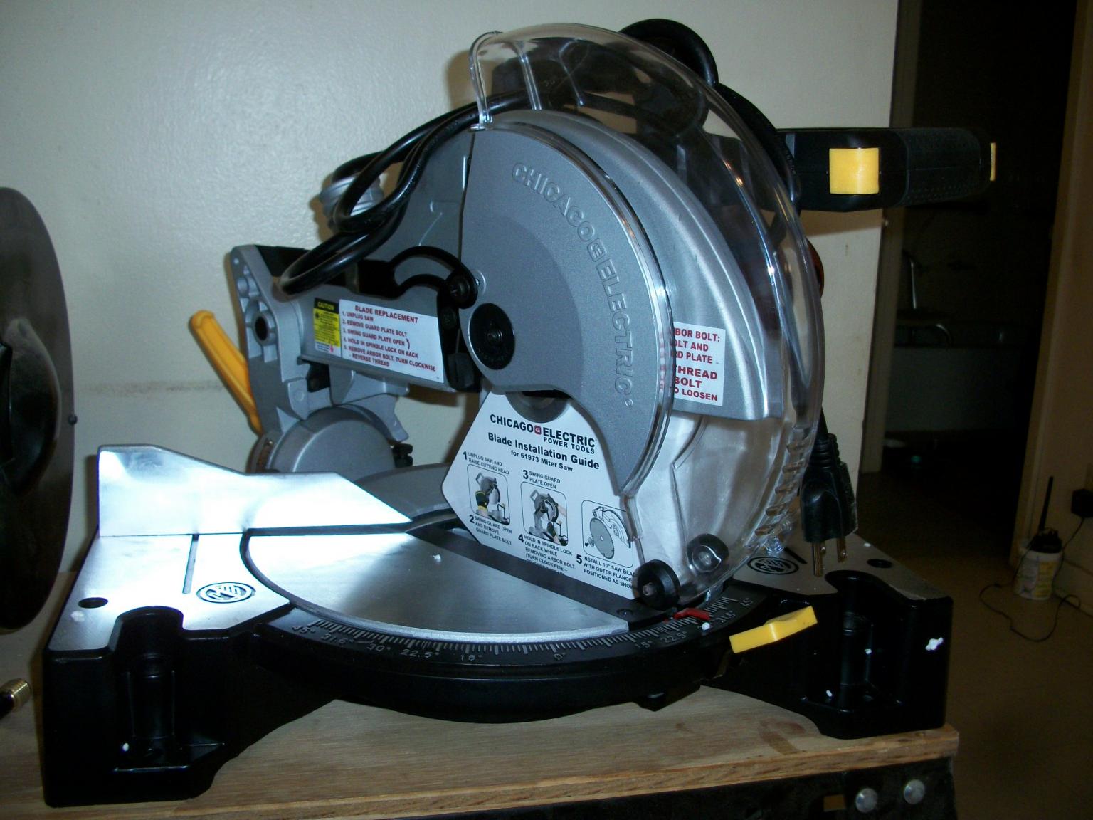

Hi gang I wanted to let you all see the new addition to the addiction, called tools and woodworking.
This miter saw is from Harbor Freight. I paid less than $100 for the saw itself, $78 I think it was, which is the lowest price I had ever seen for one.
I got the saw, a blade and a extended warranty (one year extension), all for a total of $136. That is about the same as I paid for the grinder which sits to the left.
I am waiting on the blade to come in, for some reason they didn't come together (go figure).
This is what I have been wanting/needing since I can't fit a table saw in here, so that I can make perfect straight or angled cuts, and make my turnings more complex and fun.
I will have to drill a few holes and anchor it before I use it. :)
Next on my list, a router. Gosh I need a bigger place LOL.
Thanks for looking and have a great day.100_0498.thumb.JPG.ade49aff5d005b6c1b86c

Yessir I sure did, and it is currently using the first blade I got. I just simply turned it around and it works great.
