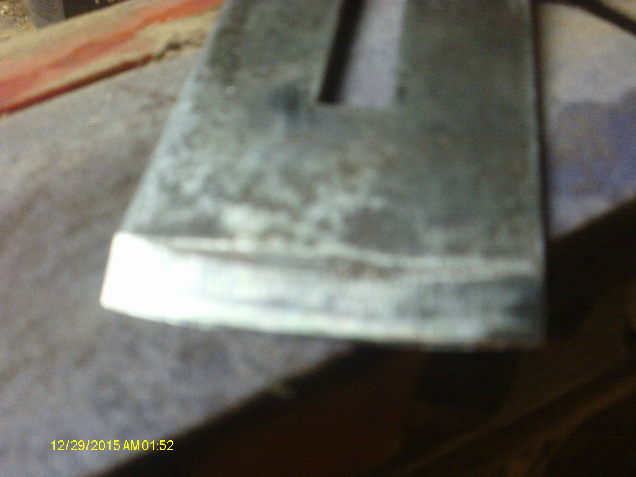

Seems to fit.   The iron needs to be resharpened, badly.    It had a big chip in one corner.     Ground enough off to remove the chip out.   Maybe later, I can grind a new edge, with a bit of camber.   Set things in place, to keep track of what goes where.

I think #2 is now as done as I can get it..
56829fc35b2d2_sharpenediron.thumb.JPG.b1
New edge has been ground.
