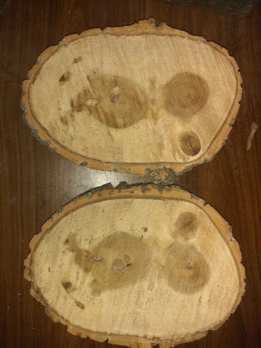

I am having some trouble with my phone (and tech skills). You asked which belts and I tried to answer both but it wouldn't happen. Here's my real problem. I have several 'disks' of cedar that I want to make into clocks. I was told that a drum sander was a necessity. It fell in my lap. Now I need to know how. I also have these 2 below. Have you ever seen anything like them? Thanks in advance for your patience and I hope I haven't dumped too much at once you.

As far as your disks, those are cool, great for clocks! Cedar cross cuts from a log are great for clock projects.
Yes a drum sander is very convenient for getting those nice and even and flat, but not a necessity, but since you had that sander fall in your lap, it's a great thing.
If these are new cuts it would be a good idea to slather some coats of sanding sealer on them "now" to minimize cracking and let them dry for six months or more.
