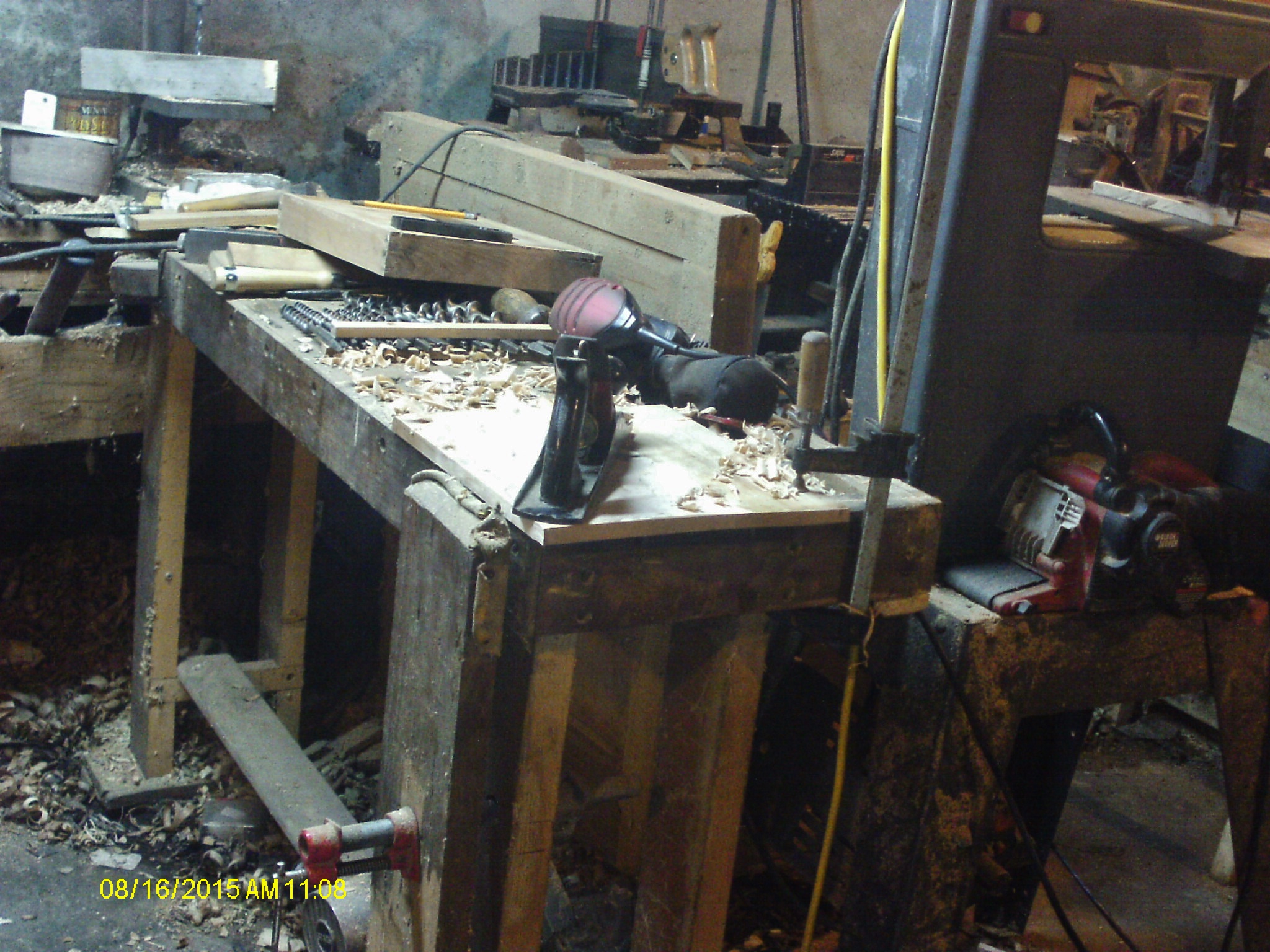

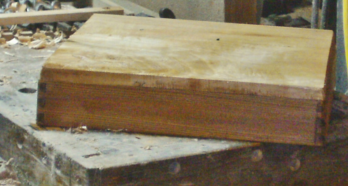

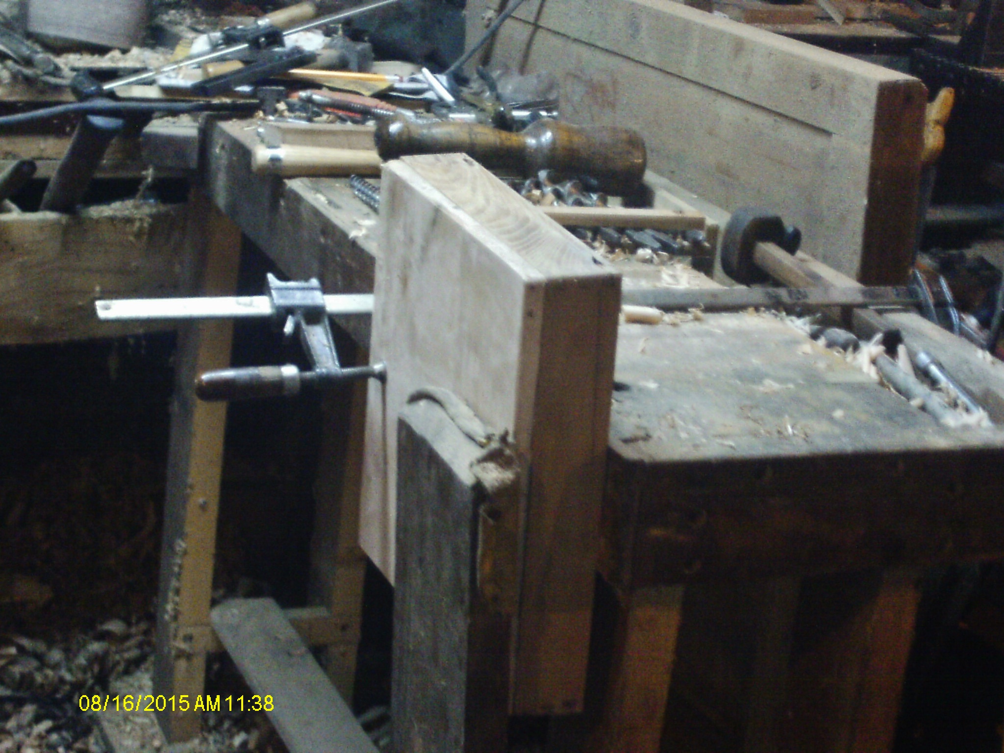

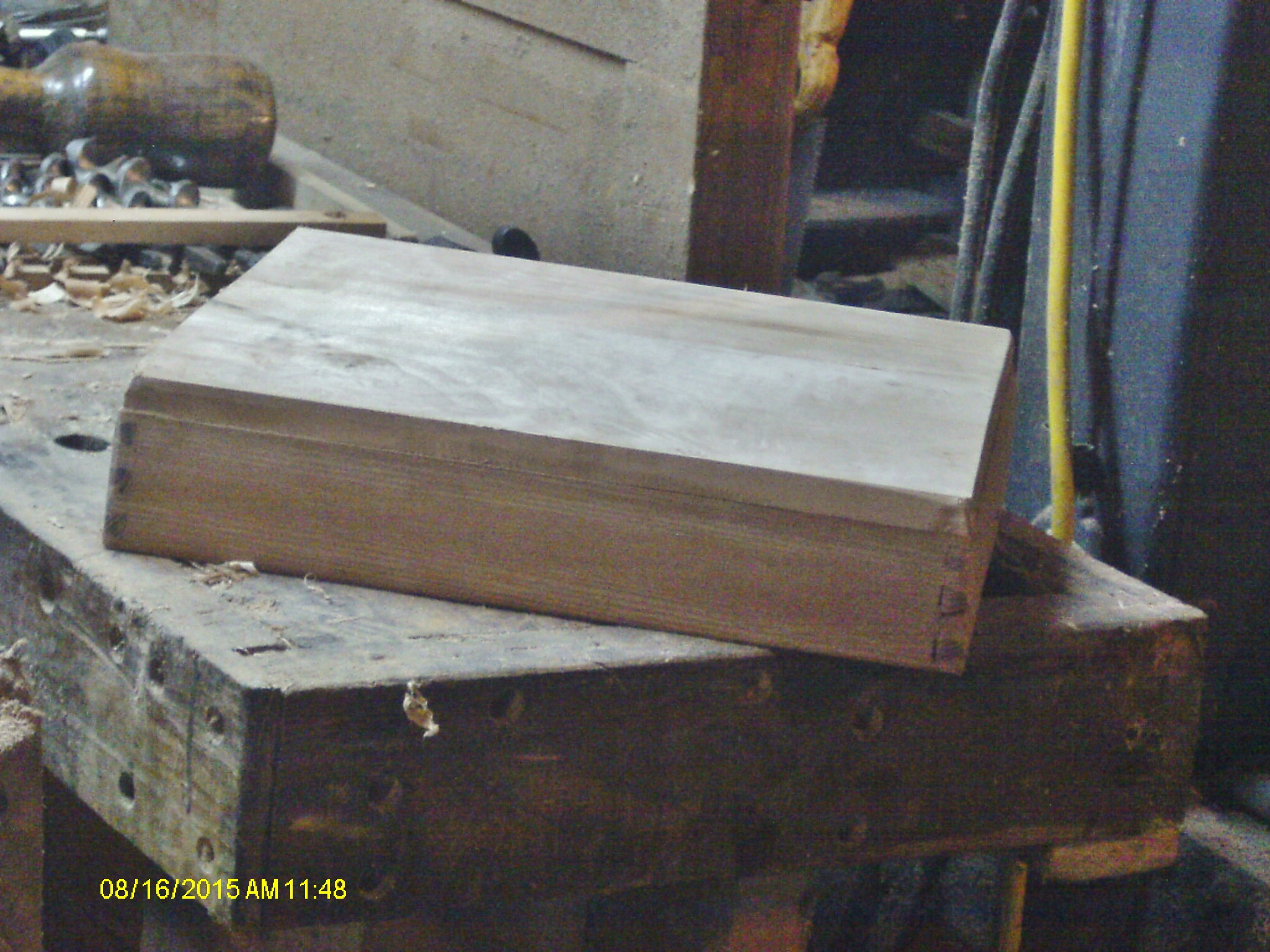

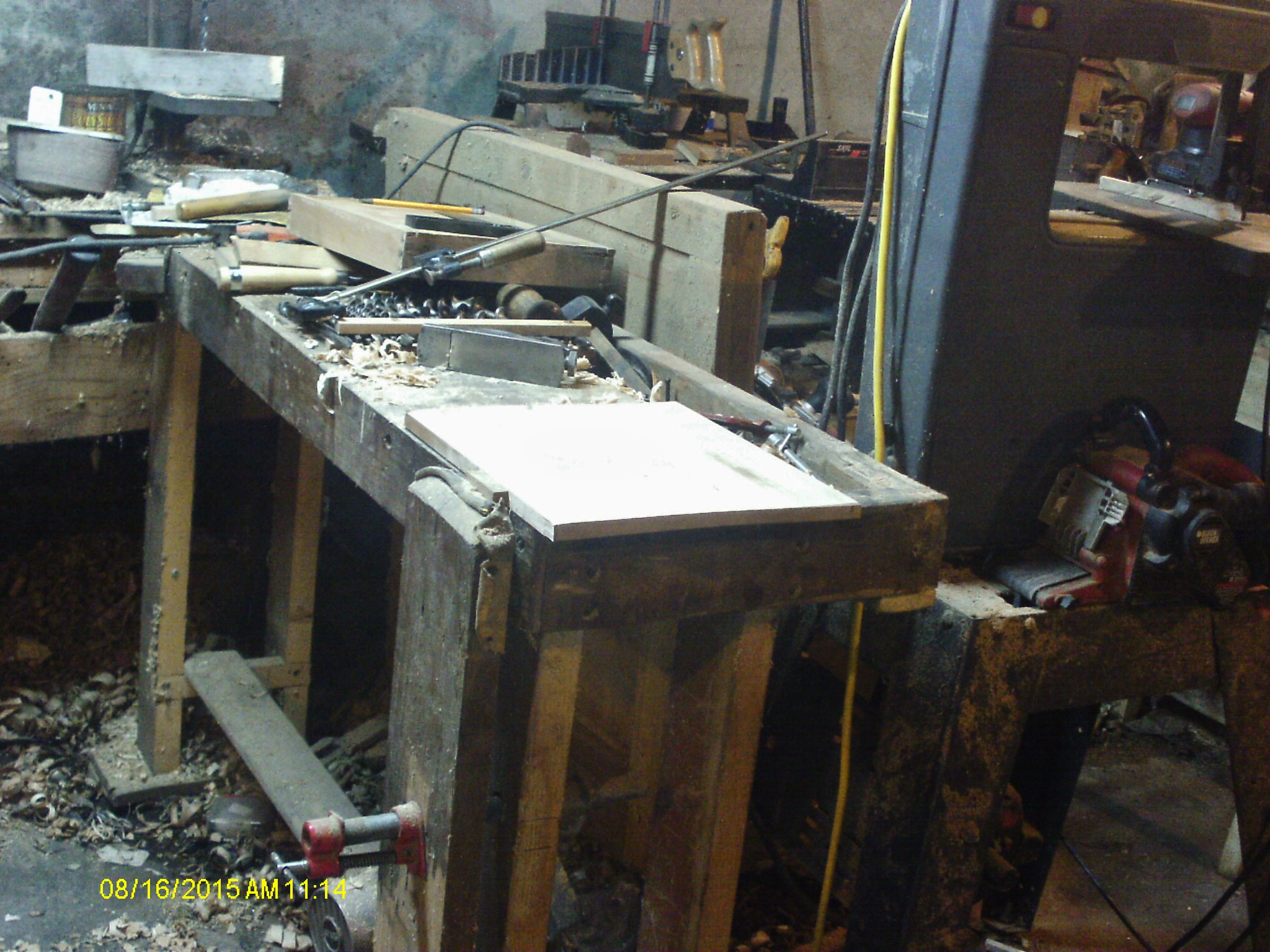

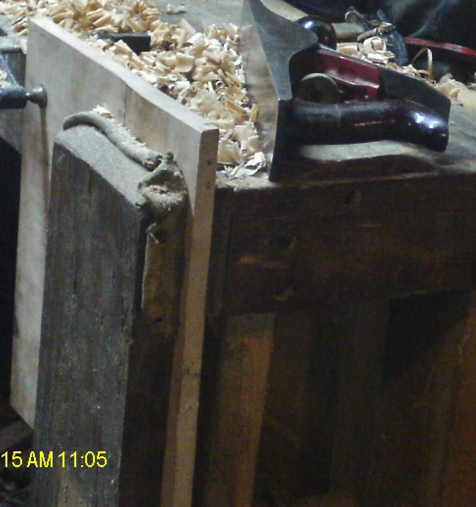

August 16, 201511 yr comment_62033 Got the "lid" out of the clamps today. Ends needed to be squared up. Bandsaw tried, and failed to cut a straight line, again. Sooo Millers Fals No.14 Jack plane to straighten the edges. Panel needed flattened as well...Sooo Gave both the 14 and a No. 11 a crack at it. Part of the panel was a hair thicker than the other. Beltsander on standby.. Dressed the edges a bit.. Low angle block plane. Looks a little better? Got the box, and the lid, set things up in the clamps, needed to plane a bit more... Decided to give the sides a bit of "Tumblehome" where the sides taper towards the inside. Planes and beltsander to do all four sides. Don't have the hinges..yet. Got a bit tricky rotating the box around. Finally. Got things matched up.. Almost like a Jewelery Case? Gave the outside a coat of that SMELLY BLO... Just to see where I'm at.... Need to go out and find some hinges, maybe a latch? Then I can work on how I am going to stash all of them bits....stay tuned.. Report
